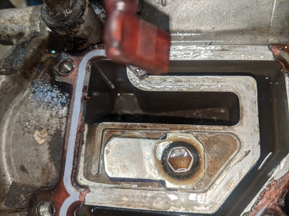

    This Kohler was heavily passing oil into the carb throttle body. Customer asked me to check on the crank case vent for plugging.
    Oddly enough there was no filter material. Someone else was in this motor and didn't bother to install the filter.

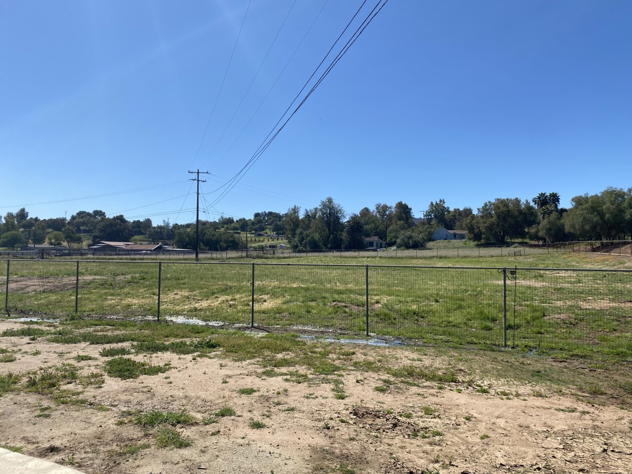

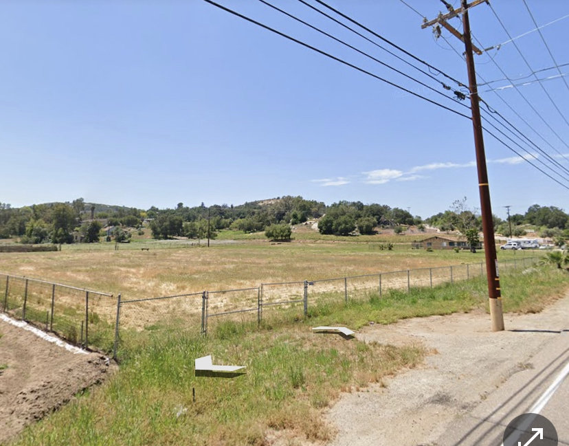

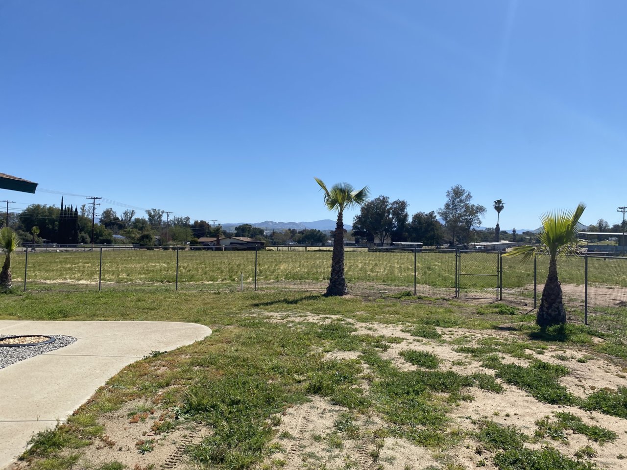

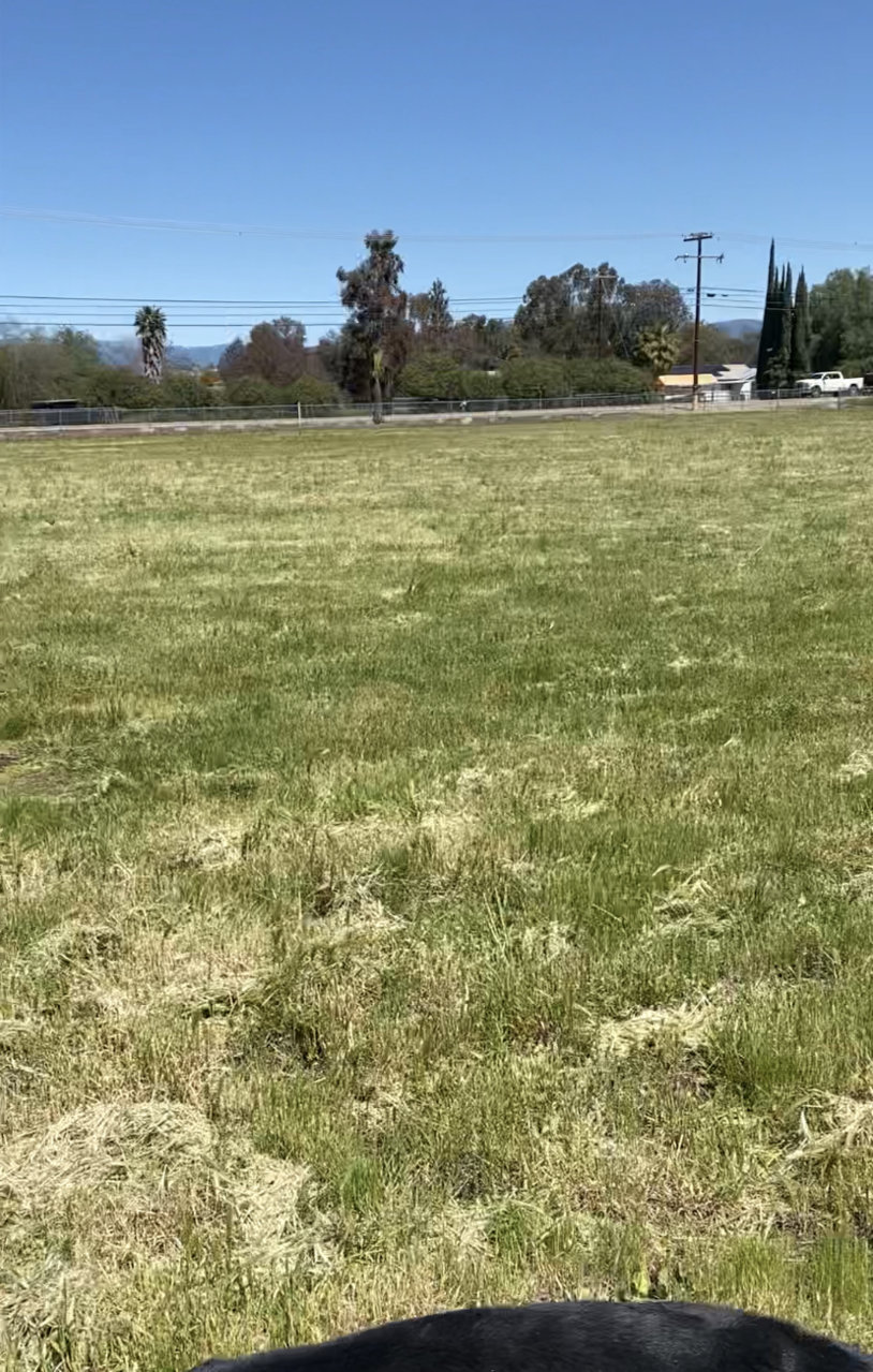

    Any recommendations for a mower for 4-5 acres ? I was looking at a riding mower 42-46” deck but thinking it wouldn’t be enough.
    8FC61552-E9AB-483F-866A-FAFC6F2643D6.jpg 14FBFA14-76AC-4B9B-BE7F-1B3B079D155C.jpg 90B80A28-313A-49F6-96CB-C06F2D479E19.jpg B5E5DF61-670A-4CF5-A1E5-D4B9C1628F2B.jpg

    A compact tractor with a 6' finish mower.
    If you had more obstacles, I'd recommend a zero turn with a 6' deck.
    That real estate looks pretty bumpy. A compact tractor with bigger tires might not beat you to death as much as a zero turn mower.

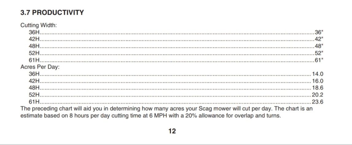

    The owners manual from my mower includes this chart. It might help you to balance mower size vs how much time you want to spend sitting on it . . . ;)

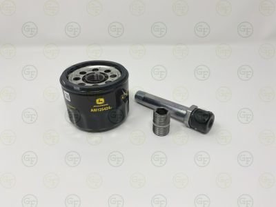

    Welp, serviced the small JD lawn tractor yesterday. While I was doing it I did the JD quick oil change conversation kit
    AUC12916-Conversion-Kit-scaled.jpg.
    Now oil changes are a lot cheaper!

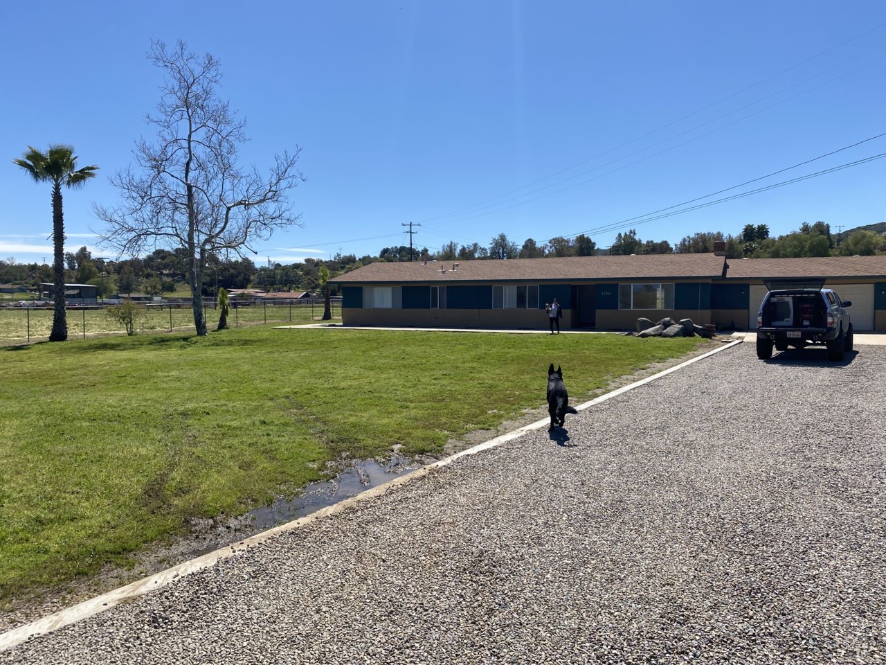

    Yeah for the pasture area I don’t mind as much but still need something to mow my front yard which is still rather large. Def gonna weigh my options
    here’s the front yard
