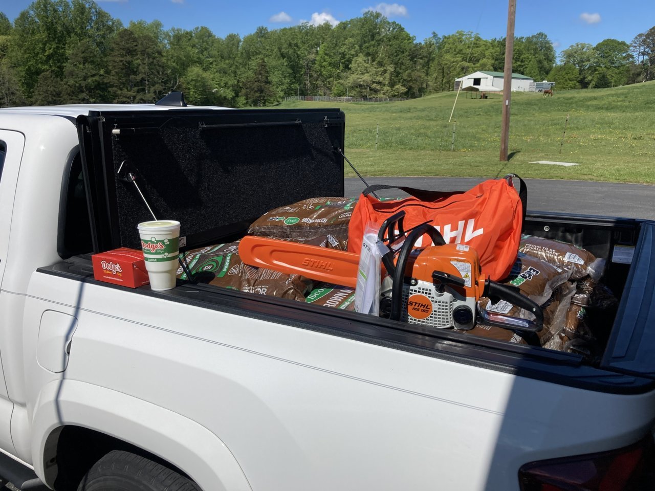

    Banner day for the bank account! Took advantage of the mulch sale at Home Depot and got 25 bags. Also bought my first chainsaw. Picked up the Stihl MS180 at a local outdoor equipment shop. After watching a bunch of YouTube videos and reading reviews, I decided the 180 was the best option for me. I’m not doing anything heavy duty and only should have to use it a handful of times per year. It seems like a decent little saw for the price.
    I also got a PPE kit with the helmet/mesh screen, chaps, gloves, and safety glasses. Look forward to using my new saw soon!

    The 180 is a great saw. I have a 170 which is my go do for small work, light and has enough power. Good call on getting all the PPE I took the mesh off my helmet after a few years. Started to rust and in certain sunlight it’s blinding.

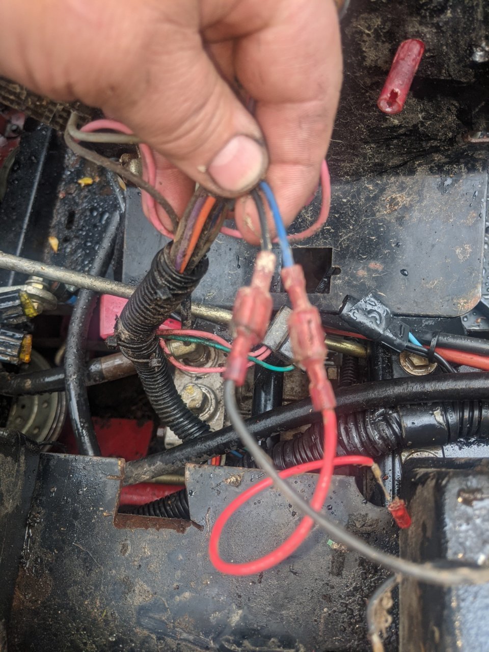

    Was able to get the Fuelie back in the chassis today. Found so many things that make you think WTF!
    #1 the unit had a bad voltage regulator.
    #2 a connector that goes to the throttle positioner sensor was unplugged.
    #3 The charging line from the voltage regulator was spliced with a 16 gauge wire. From the factory these are 12 gauge.
    #4 a ground wire for the fuel injectors was found un landed.
    Issues that I was not aware of until today:
    The center baffles are missing along with the #2 head baffles
    Besides the missing baffles, the machine seems to run smoke free (except when coming off max RPMs). Am looking forward to beating the crap out of this thing.

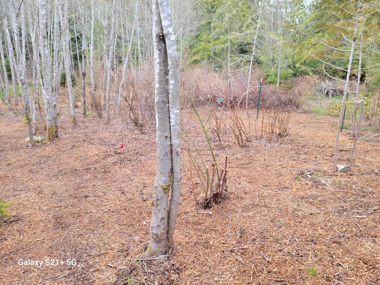

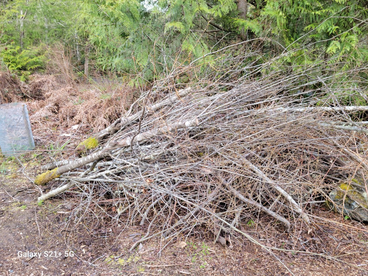

    20230418_175159.jpg 20230418_174622.jpg did about 9hrs chipper time last weekend. did 4 piles like pictured and raked. this tool paid for itself last year. would buy again. DR brand products are a pain to get parts from (website sucks) but the tools are great. only choice on american made/manufactured which was and is a priority of mine. too wet to burn and this makes sweet forest compost/trail fodder. for 1500$ id be amazed if theres a better unit to be had.

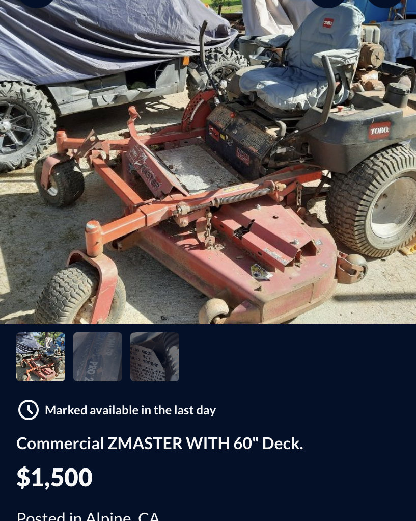

    What do you guys think about this? He says it works but has intermittent smoke belching. I am pretty handy DIY. Have some full motor rebuilds on motorcycles
    EFI 568 hours

    Thats a fuel injected model. Pretty nice units. I'm actually rehabbing it's twin. I'd grab it for that amount of money.
