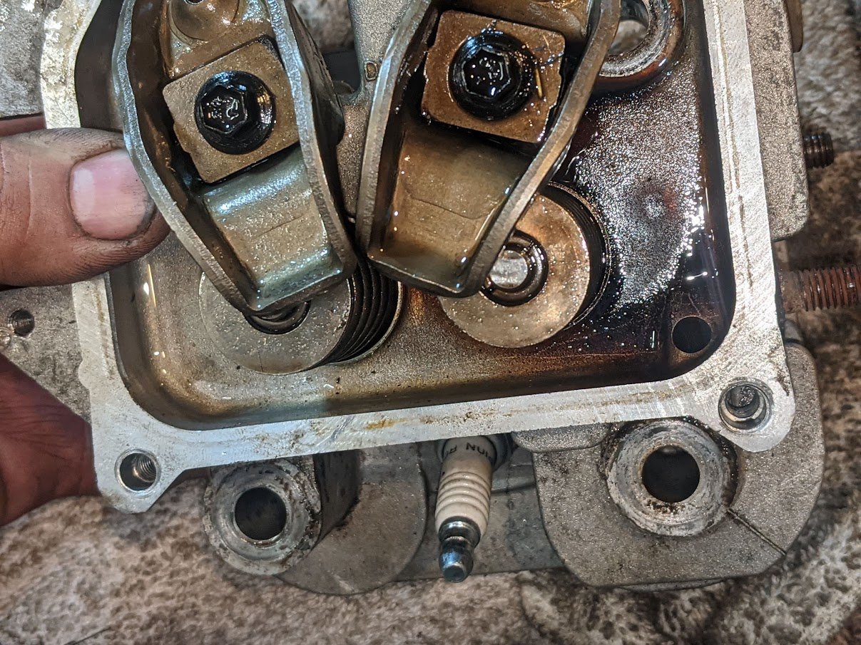

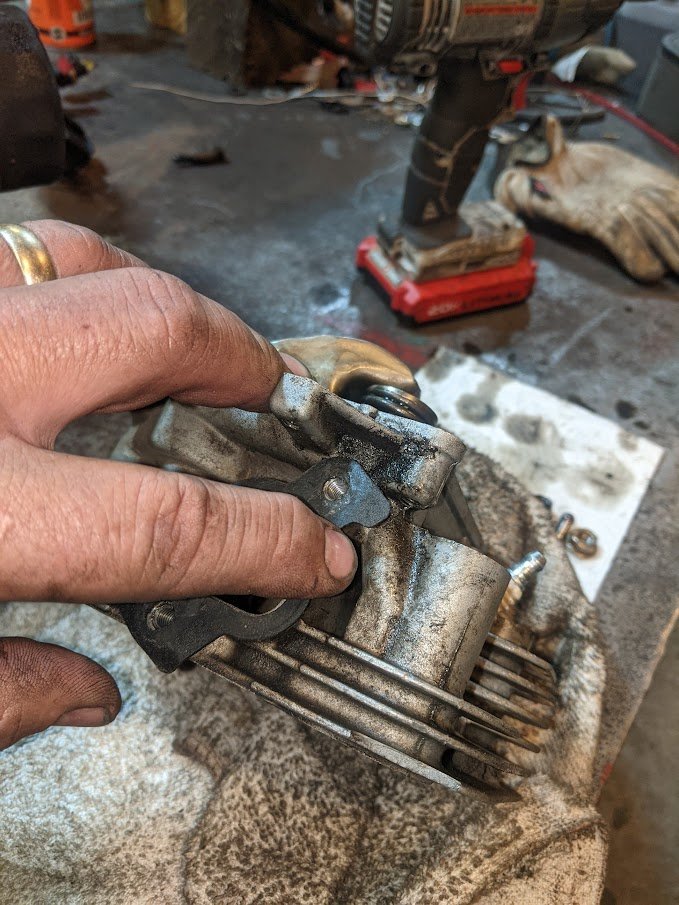

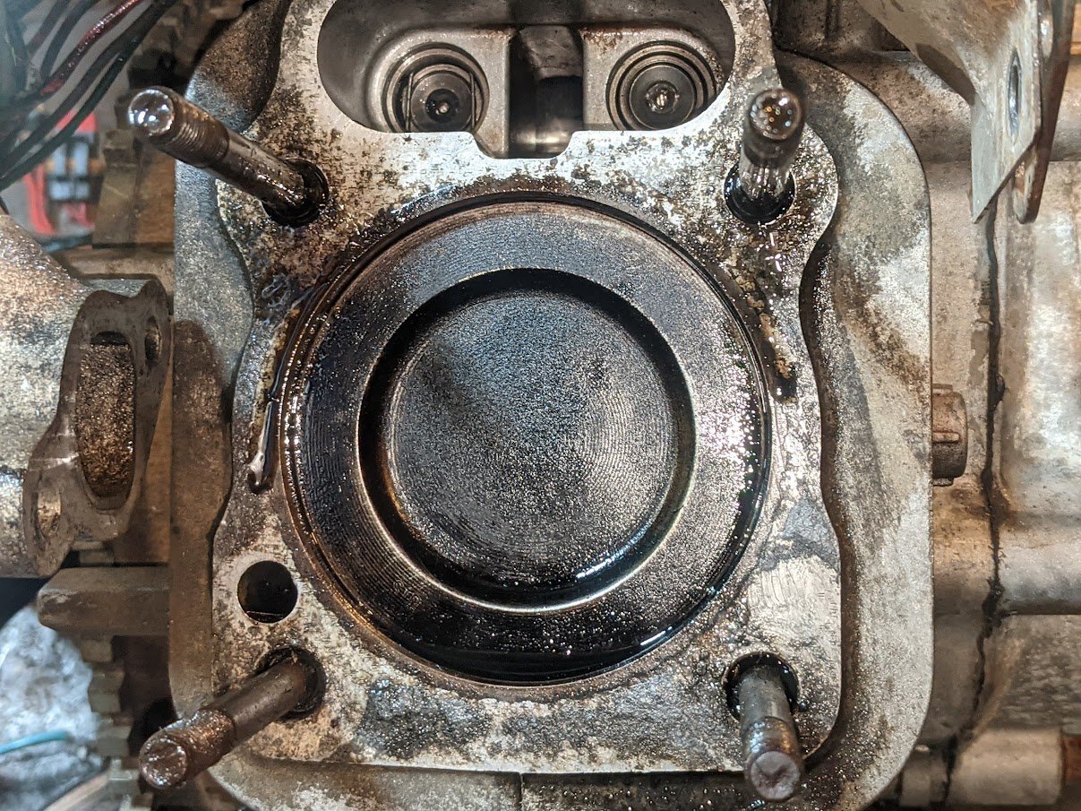

    I gots a serious WFT situation goin on here.
    I have no Idea how this thing was running for the few years. For some reason the hack that changed the HG's last didn't try to align the dowels for fuck all!
    Secondly, there is no way for the oil to drain back to the sump. It appears that the drain hole was never drilled on the left side of the head. I'm wondering if someone got the left and right mixed up?
    You can see the drain in the block is on the left, but the drain in the head is on the right. On the bottom of the head its drilled most of the way up, but stops.
    Should I attempt to hand drill that 1/4" in need to mate up the 2 sides?

    What's the other head look like? I'd take the valve cover off and look before I started drilling anything.

    I did check. It is correct.

    You think it's possible someone replaced that head at some point and got the wrong one?

    I sure this is not an original head. I need to check to see if vertical shaft Command engines are set up with only one or non holes drilled. Seems if its the same engine, just tipped, the oil would return down the pushrod galley just as easily. The hole would be pointless.

    No worries. I just now finished up buttoning up the motor and getting it bolted down. Test ran just fine and no oil overflow leak out of the valve cover!

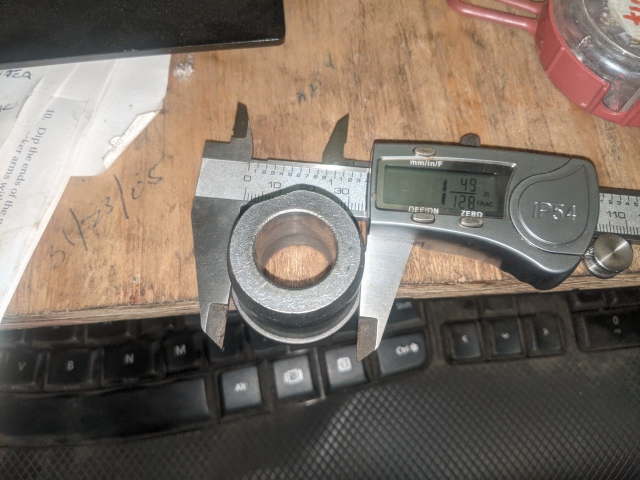

    04 trd x-cab 4 x 4 3.4l
    Reserected from the dead.

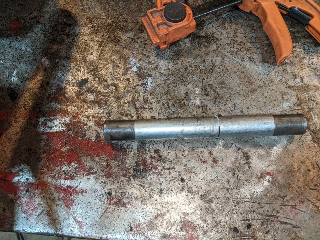

    This is Bull Shit!
    A $9k mower has bushing bearings in the front wheel assemblies.
    I is missing and the other 3 are worn out. 290 hours and they are done for. Your $49.99 wheel barrel has better flanged bearings!
    Gonna hunt up some proper flanged bearings tomorrow.PXL_20230429_002124604.jpg

  20. Apr 29, 2023 at 7:03 AM
    koditten
    koditten Well-Known Member
    Sep 8, 2013
    #112077
    19,959
    Kirk
    Central Michigan

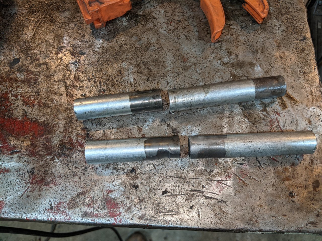

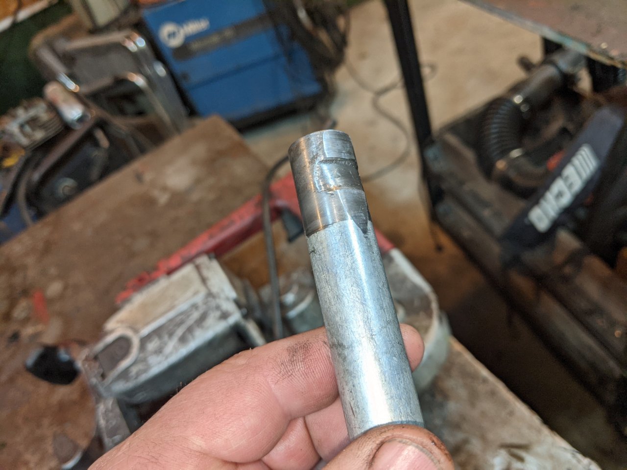

    Couldn't find any flagged ball bearings in my town, but did find the original style. In they go.
    I found my axle bushing rods were pretty significantly worn.
    Instead of buying entirety new rods, I just cut them in half and put the worn ends to the middle.
