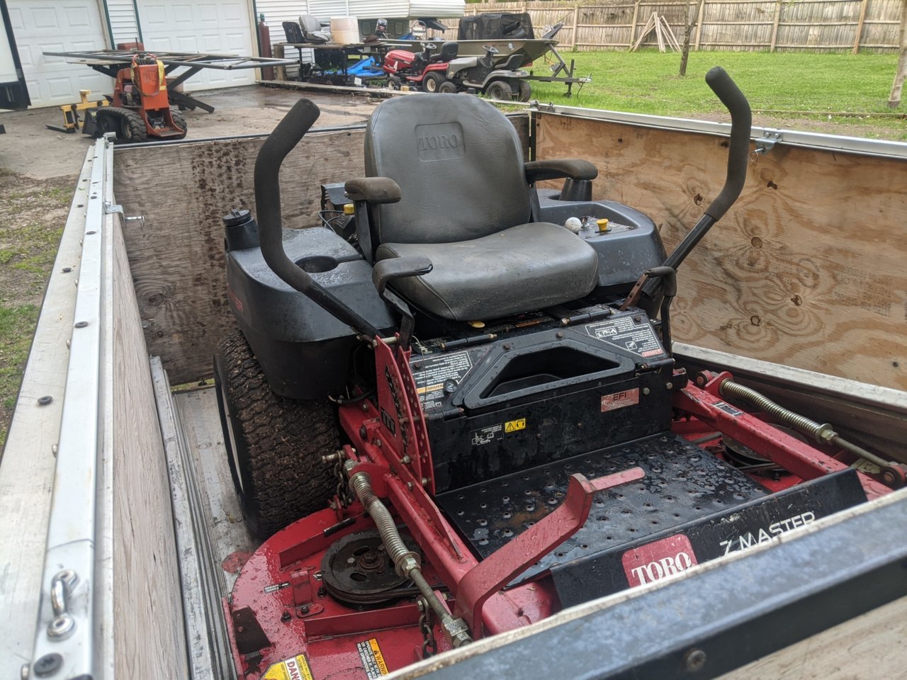

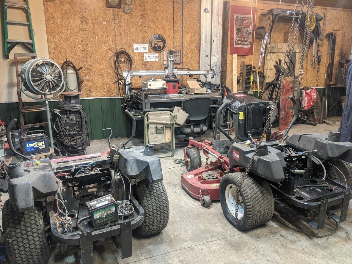

    mRy0BDISWin_1KY9tHpmwOJeghff0H152JR08RkA_adf9e951b72b00ea2bdb69208ba9fe40592edee0.jpg
    This aught to be fun. Removing efi and replacing with carborated engine. All wiring and plumbing needs to be changed as well.

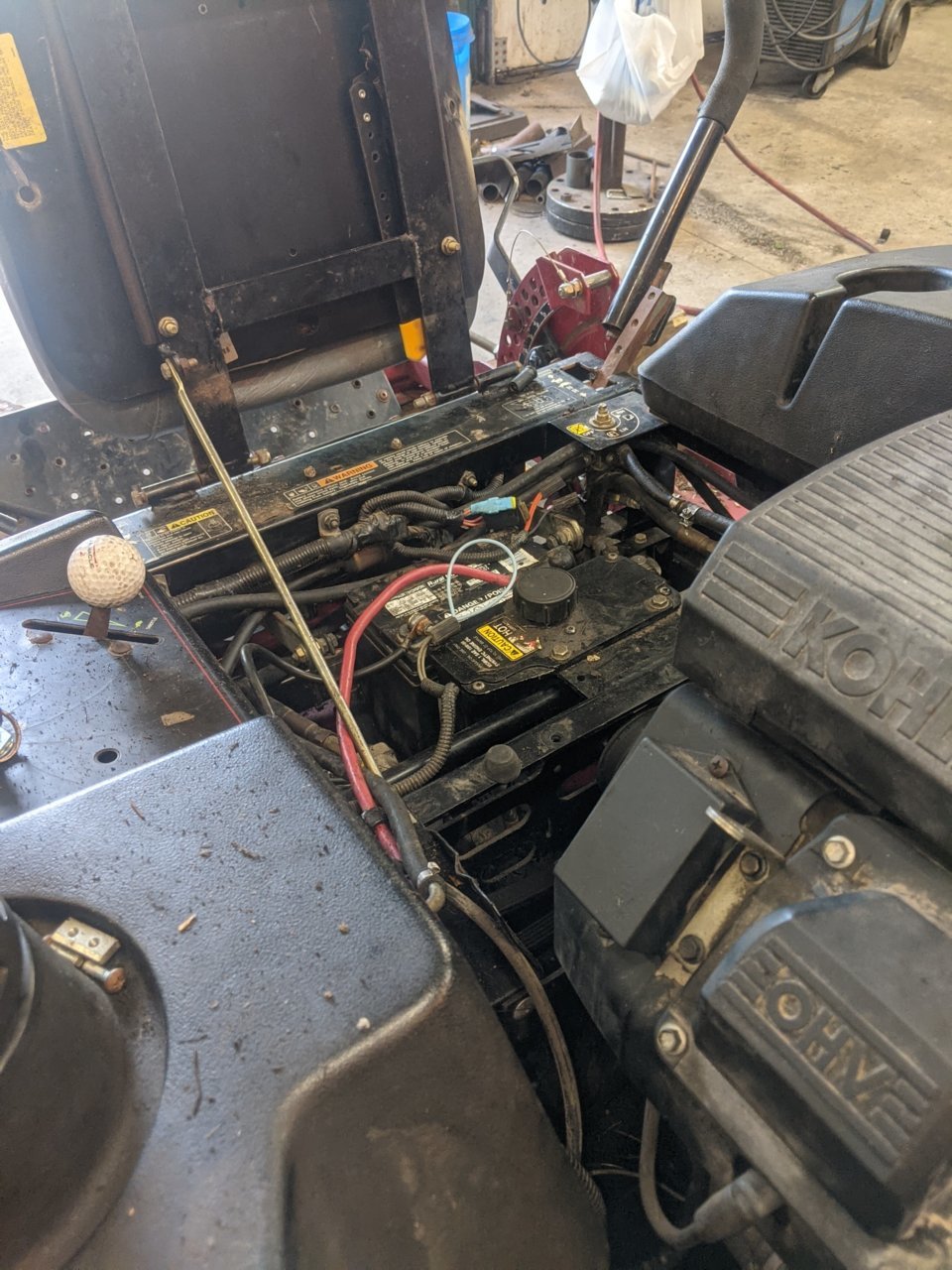

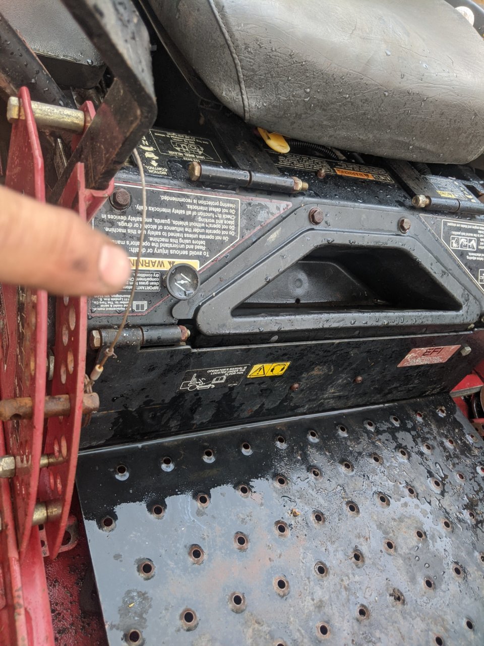

    yaMzERZhoEq4M7PkxRo5jdY134jvmtzHS5JZoYbF_1b8af715ee62997f2497a768a6946f611cf9df67.jpg
    A bunch of wires are coming out.

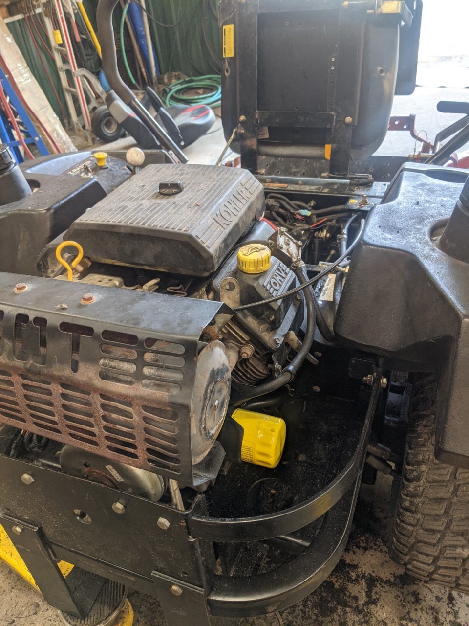

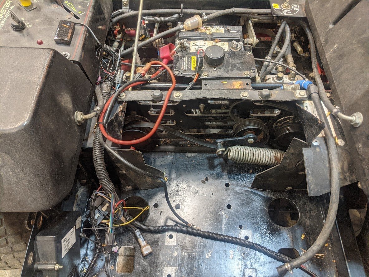

    Harness swapped out, engine installed and test ran. It must likes it's new home, it just purrs after I re packed the exhaust.
    Still need to give it a choke cable as the EFI units have no choke.
    This unit turned out nice!
