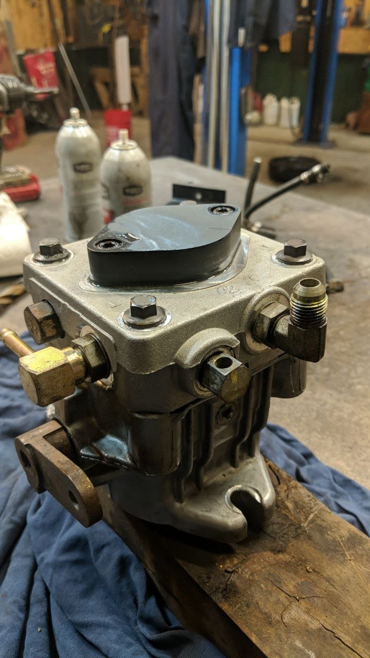

    Pump rebuild time-bad input shaft seal. Kind of a messy way to keep the hydro fluid fresh. Was gonna take it apart, but the 1 seal I need is the 1 seal I don't have. Shit.

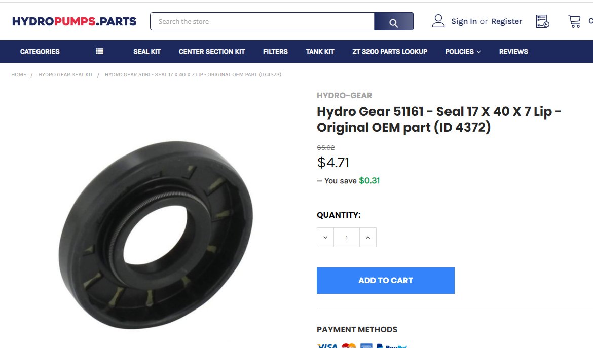

    Just posting these pics to I can see if there in number on the seal. I can blow it up on my computer.

    Surprising. I can just get the seal. Now to Xref it to see if I can find it local.seal -tor-hydrogear.jpg

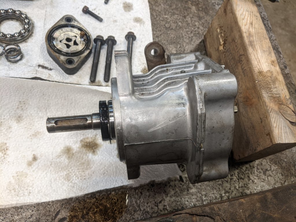

    Decided to pop the pump case apart. I scribed the 3 main body parts so there was no confusion on which way it goes back together.

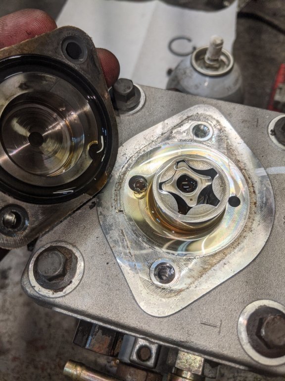

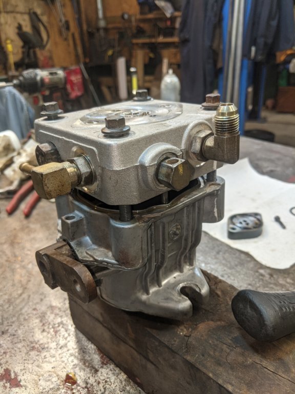

    After pulling the charge pump cap, I can remove the 4, 10mm bolts. The valve body lifts from the pump case from the springs in the cylinders. There will be lots of oil present
    RustyGreen likes this.

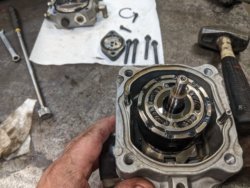

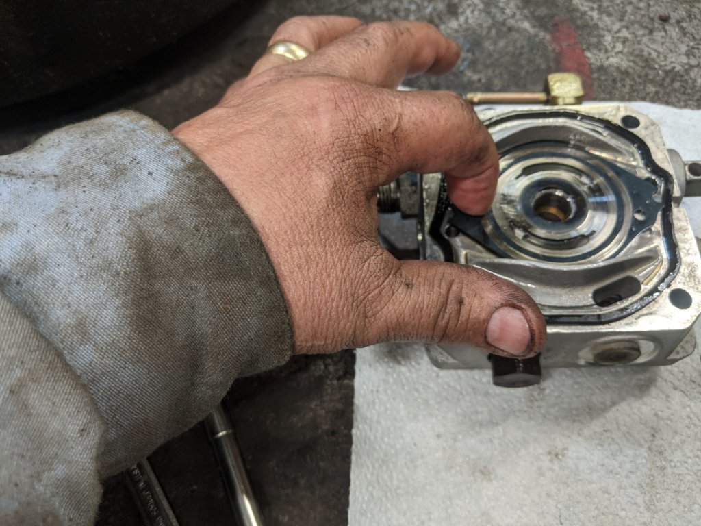

    I'm checking this plate for abnormal wear. I can see the piston body wear marks, but can't feel them with my nail. This one will be fine as long as I do a full oil drain. This oil was pretty dirty.

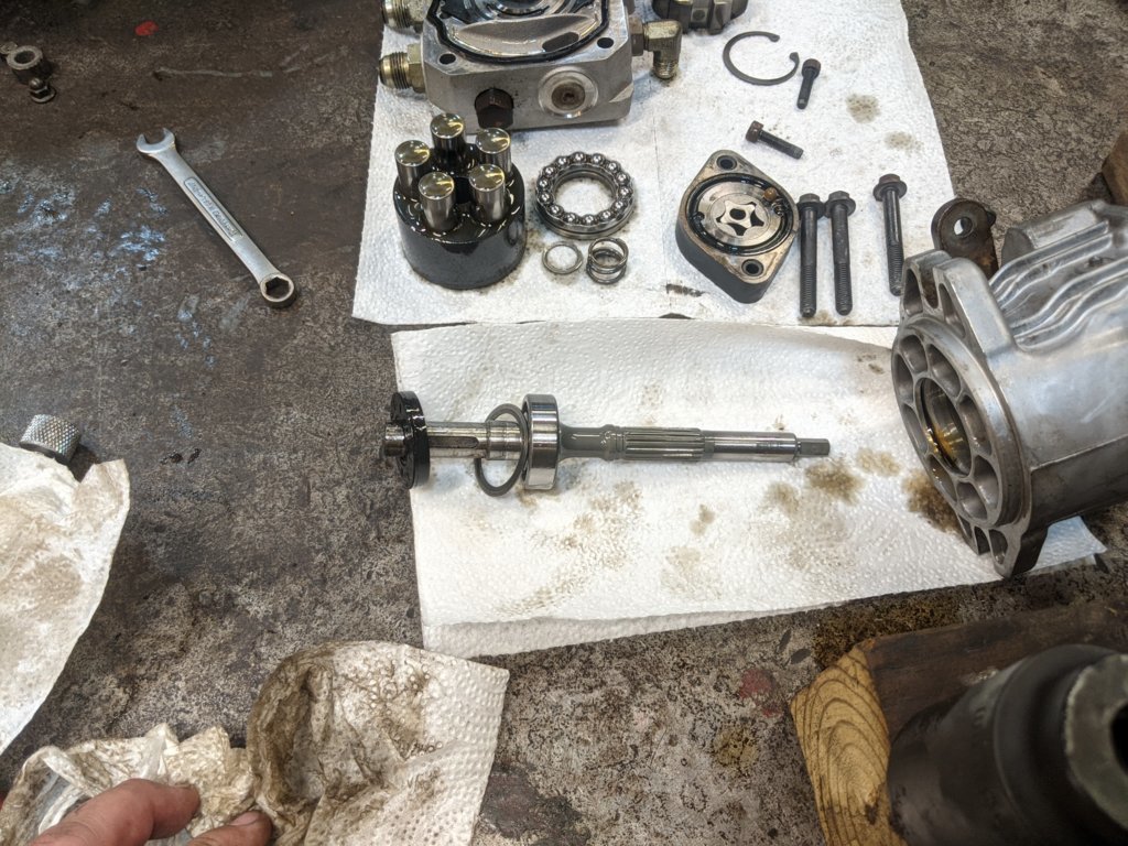

    Piston body. Best to tip the pump on its side so oil can drain out of the case. after draining I cup the piston body while turning the pump upside down. The piston body along with the pistons and springs will now be in your hand along with the center spring and washer...as well as lots of oil.

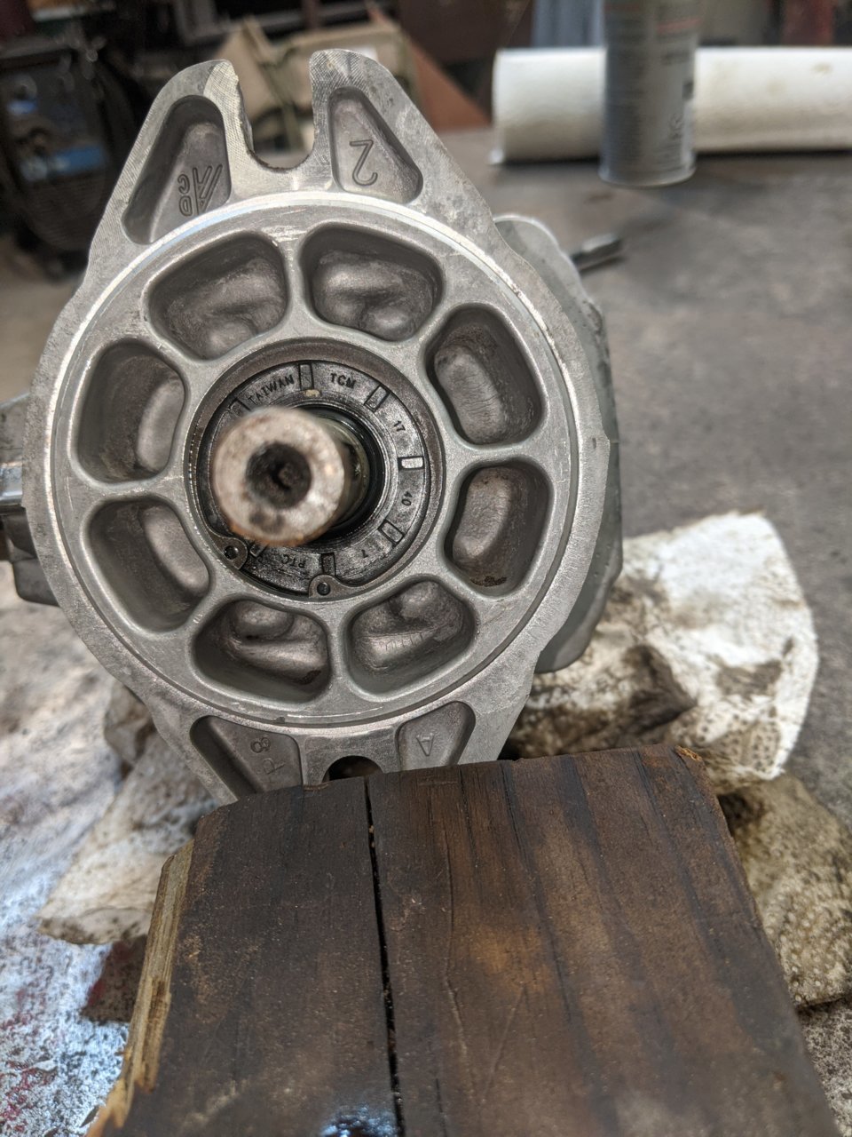

    I didn't get a shot of the swash plate and bearing before I removed them.
    Once those out of the way and the input shaft seal snap ring is off, you can drive the seal out by swatting the end of the input shaft.
    Oddly enough, with all the tools I have, I do not have soft faced hammer. I've just always used a block of wood. The wood won't deform the input shaft.

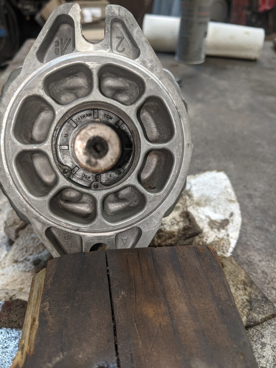

    upload_2023-5-29_15-13-3.jpgpic was for post above.

    upload_2023-5-29_15-14-7.jpgseal is driven out by the shaft bearing and bushings.
    Now I just wait for my new seal to show.

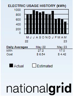

    My electric water heater started leaking this winter. I replaced it with a hybrid heat pump unit. February's bill cycle lined up pretty nicely with the installation of the new unit. Now that it's been a few months, the bill really shows the drop in energy use:
    It is a little noisy, but it's in the basement so that isn't really an issue. I have a friend who has an older Rheem unit that's noticeably quieter, but the new ones have a lot of noise complaints like my A.O. Smith does. I wonder if their compressors are from the same supplier.

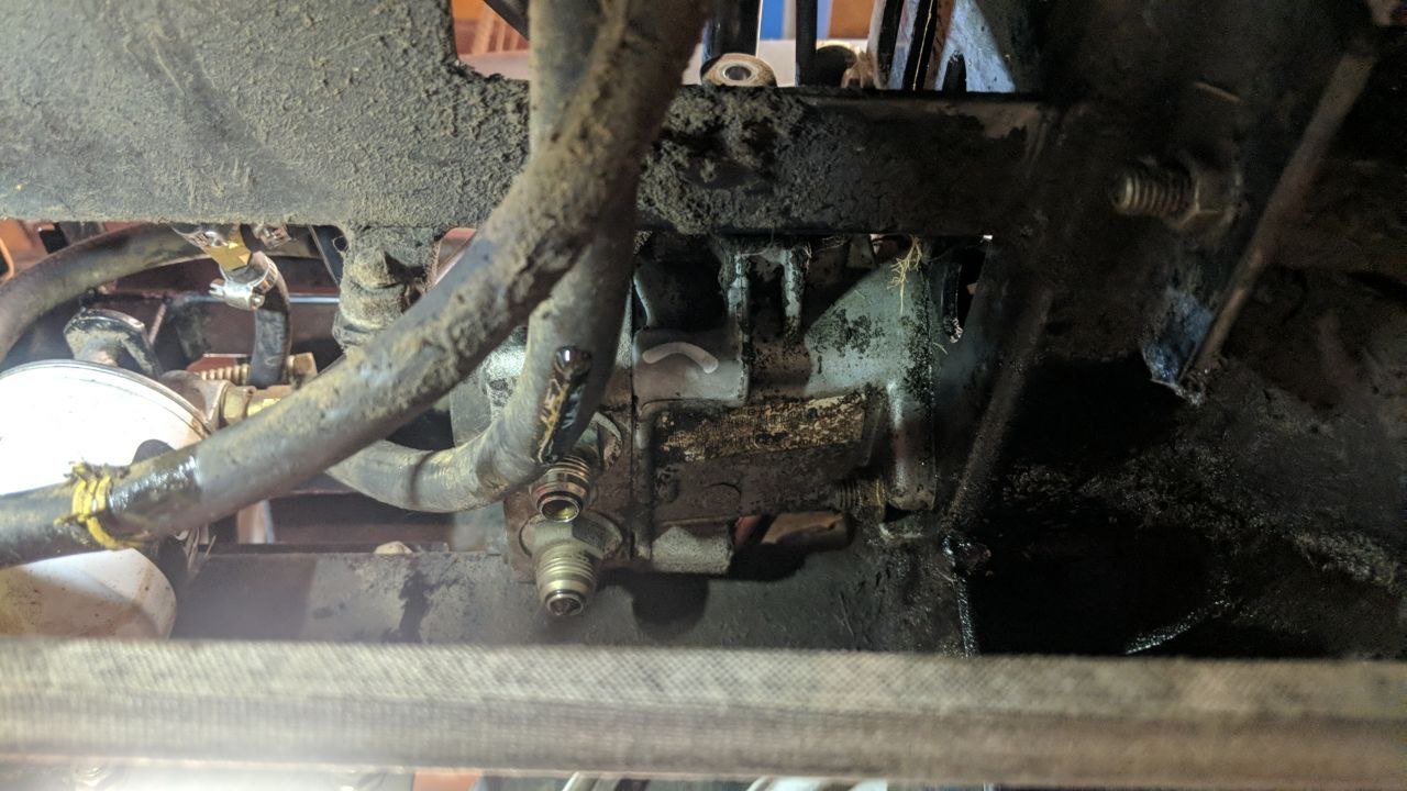

    Some general maintenance done on a friends Terrimite backhoe. Engine oil hasn't been changed in who knows when, but the old Kohler burns so much it's had quite a many top offs! Hydraulic oil also hasn't been changed in quite the many years. Decided to do that as well.
    Went to Napa and they actually had an abundance of Rotella T4 10w30, so we went with that. 1551 hydro filter and a 21348 engine oil filter (actually fits a 1st gen 4 cylinder Tacoma, lol). It actually specifies 10w30 in the manual for the hydraulic unit, thought that was kinda weird. T4 went in the engine and hydro.
    Crawled under the machine and they said they've been changing the hydro stuff from underneath. I knew there was a better way so I looked around. The plate where the drivers feet sit is removable. What do you know... :facepalm:
    No drain on the tank, so just pulled the feed hose. Fluids changed and everything running again. The twin cylinder 20HP Kohler still smokes like a bong, especially at idle. Pretty sure it needs valve guide seals, but the engine still cranks over and runs fine. Trying to get them to let me rebuild the engine, pretty sure I can get all the parts needed. It's an odd front shaft only engine that's kinda rare now-adays. We were going to adapt a Predator engine to it, but then C19 went into full swing. Still might convince them to let me re-ring it and put new valve seals in it.
