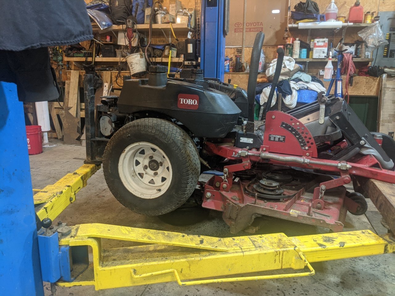

    The d130 is about 5 years old and needed a new belt. I installed one last week and it didn’t last long. Thinking back I realize that the tension cable should’ve been adjusted when I installed a new belt. The blades were delayed about a second to after engagement.
    Thought about it a bit and decided I needed to do a bit more than just a belt change.
    Spent the day doing a deck clean up and tune up. Removed the deck and the burnt belt. Took a look at the spindles and idler pulleys. One of the idler pulleys was a bit rough
    I removed the deck spindles and removed the bearings. Once the bearings were out, I drilled the 8th inch hole adjacent to the Zerk fittings. I then tapped the hole for a 8/32 machine screw. I then removed one side of the bearings grease seals. I cleaned, dried bearings and reinstalled. I am sure the grease seals were facing outward. I reassembled the spindles using anti-seize on the four mount bolts.
    Oh, I replace the idler pulley while installing a new belt. Once this was done, I greased the spindles with the machine screws removed. I insured that the spindle bearings were lubed up, realizing the spindle cavity was full when the grease flowed from the vent hole.
    I reinstalled the deck. I also added a slight amount of tension to the engagement cable. The deck is certainly quieter, smoother, and engages nearly instantly when engaged.
    Why John Deere and others install spindles with a grease fitting and sealed bearings is a mind-boggling event. While I did have a set of replacement bearings, I did not replace them as they were smooth and did not feel dry.

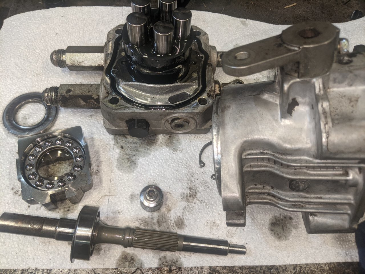

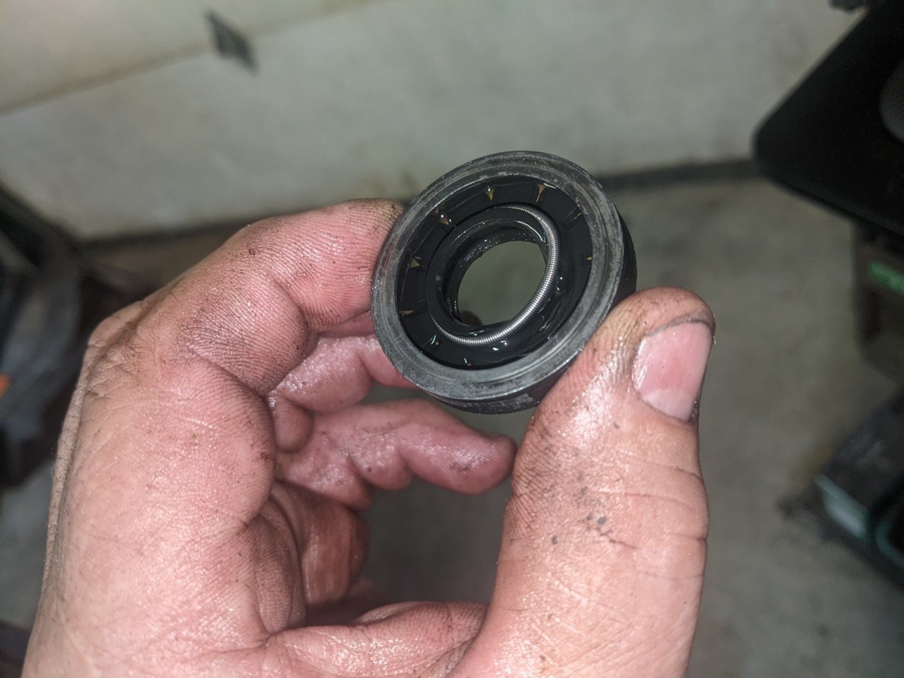

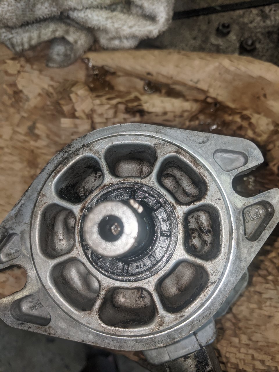

    I moved on to taking the left hydro pump out of this one. Bad input shaft seal.
    This is the second one in 2 weeks I had to repair the seal.
    I picked up this mower last week. Owner told me his repair shop said the pump was bad and there was metal shavings thruout the hydro system. I figured I was taking the entire plumbing out and flushing everything. I gave him a stupid cheap offer and he took it. He said the shop wanted $2k to do the repairs.
    The only thing wrong is this $9 seal, a $20 filter and another $20 in oil.

    Toyko Joe, KRAMERICA and RustyGreen like this.

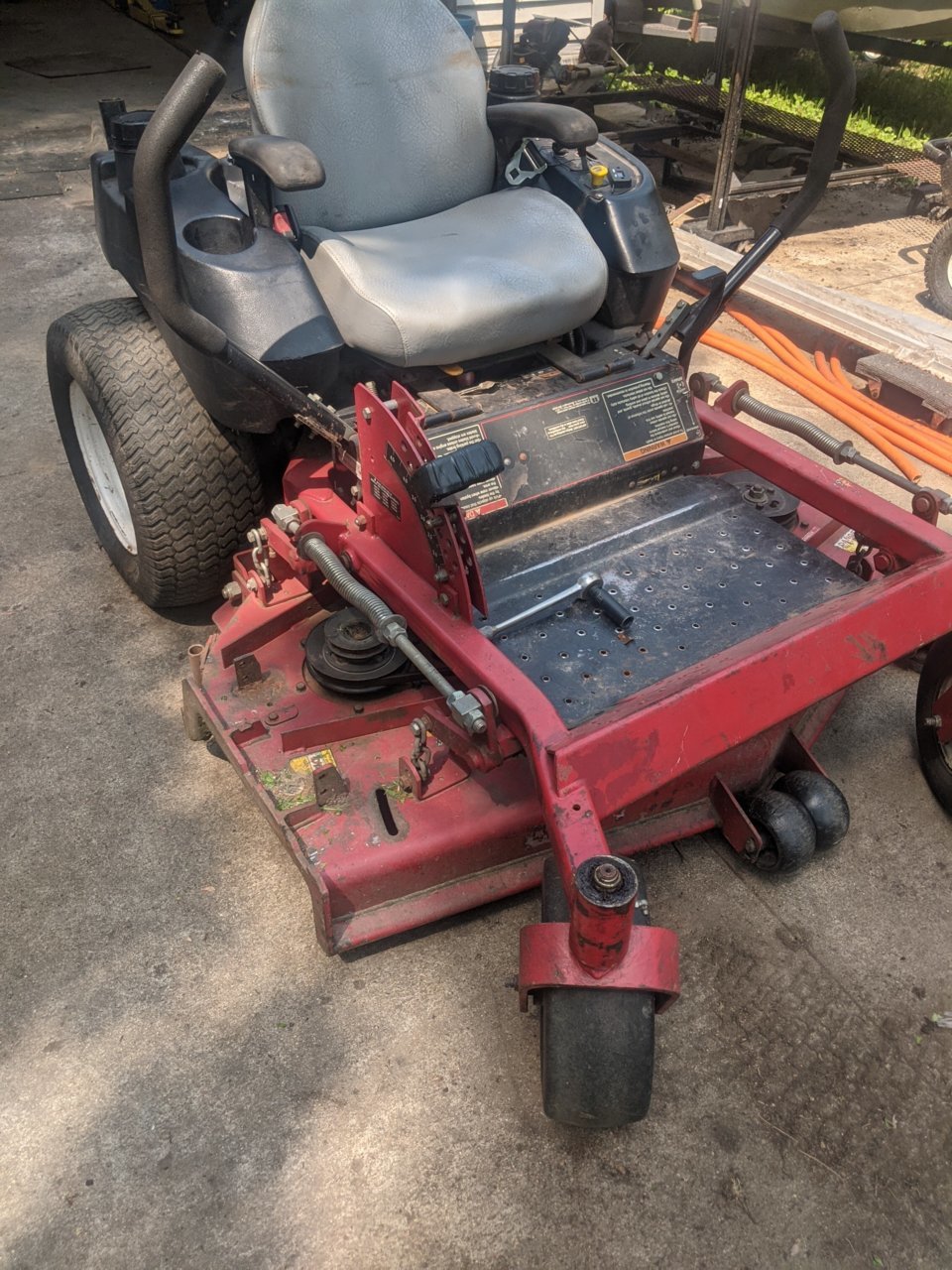

    Just got this one back together, oddly enough it has a very nice running Kaw in it.
    I found the pump seal for $6 here in town. New oil and filter and she will put slivers in your ass if the seat was wood! Both pumps have all the power they are supposed to have.
    $6 vs $2k. What a shame the previous owner was sold poor or plain wrong info.
