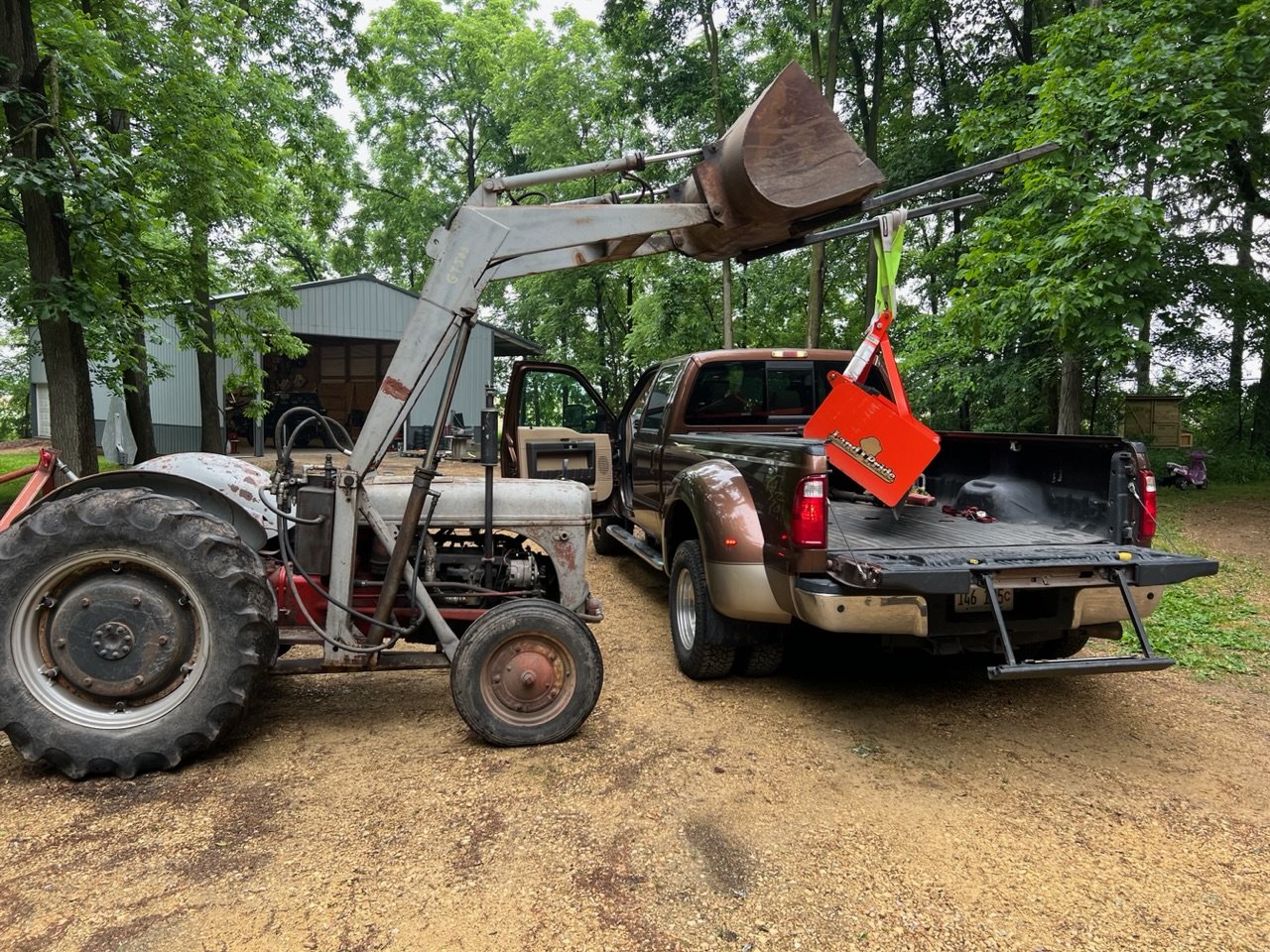

    Added a box blade to the arsenal for driveway maintenance and dirt work that needs done as I add parking around the shop.
    Only a little sketchy getting it out!
    Went straight to work on the lane that hadn’t been touched in at least 5-6 years according to the neighbor. It was all fines on top that turned to slime immediately in the rain. I turned up a fair amount of bigger stone but it probably needs a load or so for touch up

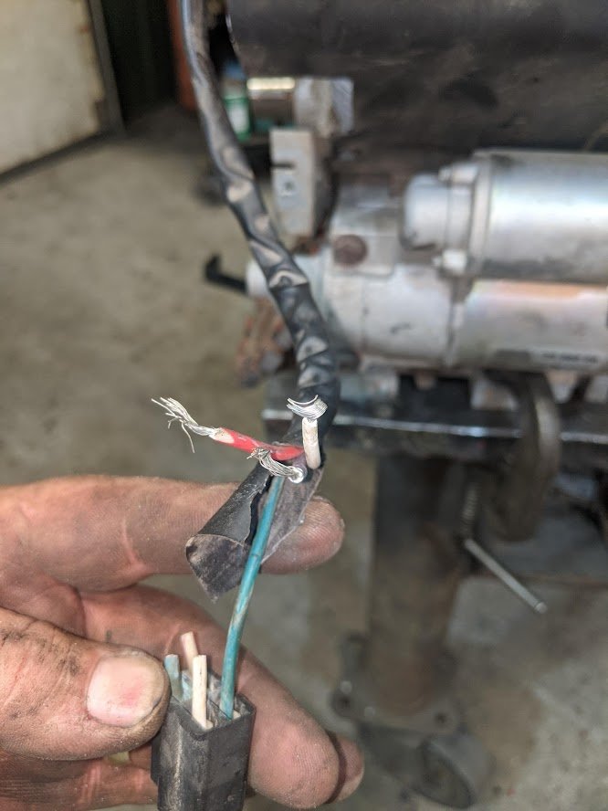

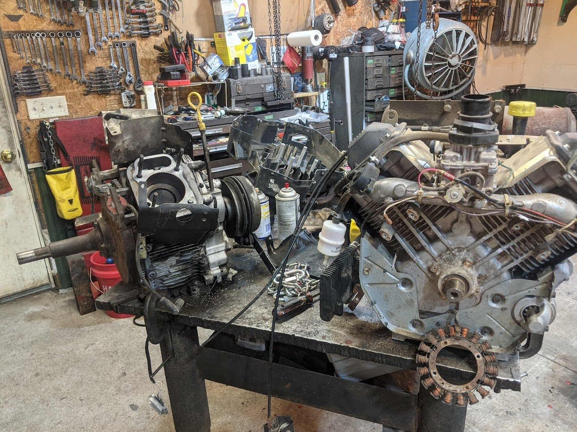

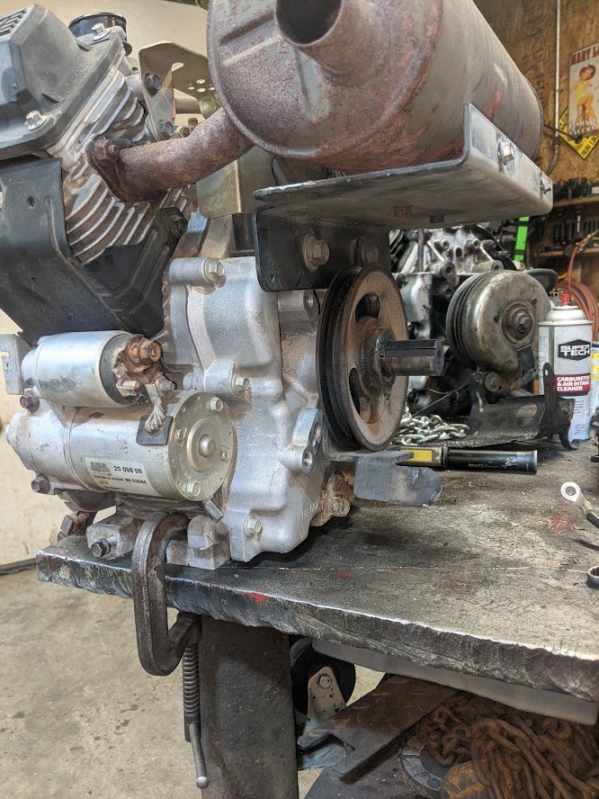

    Picked up this Kohler Command. It will replace the engine that I washed my hands of.
    kMVlFv0B7G6gynDxMrwujONQ8-8vdU9hgv7EKR0s_33b428eb2379d591b4323042f5159b7317e102b7.jpg
    7SgL19j7bOMrfkT-E8XUAuJhyKs2EdTNARpNfEY6_e023bf5773aeb37b8d2e1c5298a8d81ee79fa6f8.jpg
    Why do people do this!!!? The engine is in such great shape and they grab the cutters jut to piss me off!
    RustyGreen and Toyko Joe like this.

    Another pic if anyone cares. Hope to get everything swapped out tomorrow.

    I like seeing these pics! I wish I had more time/space/know-how to do more like this.

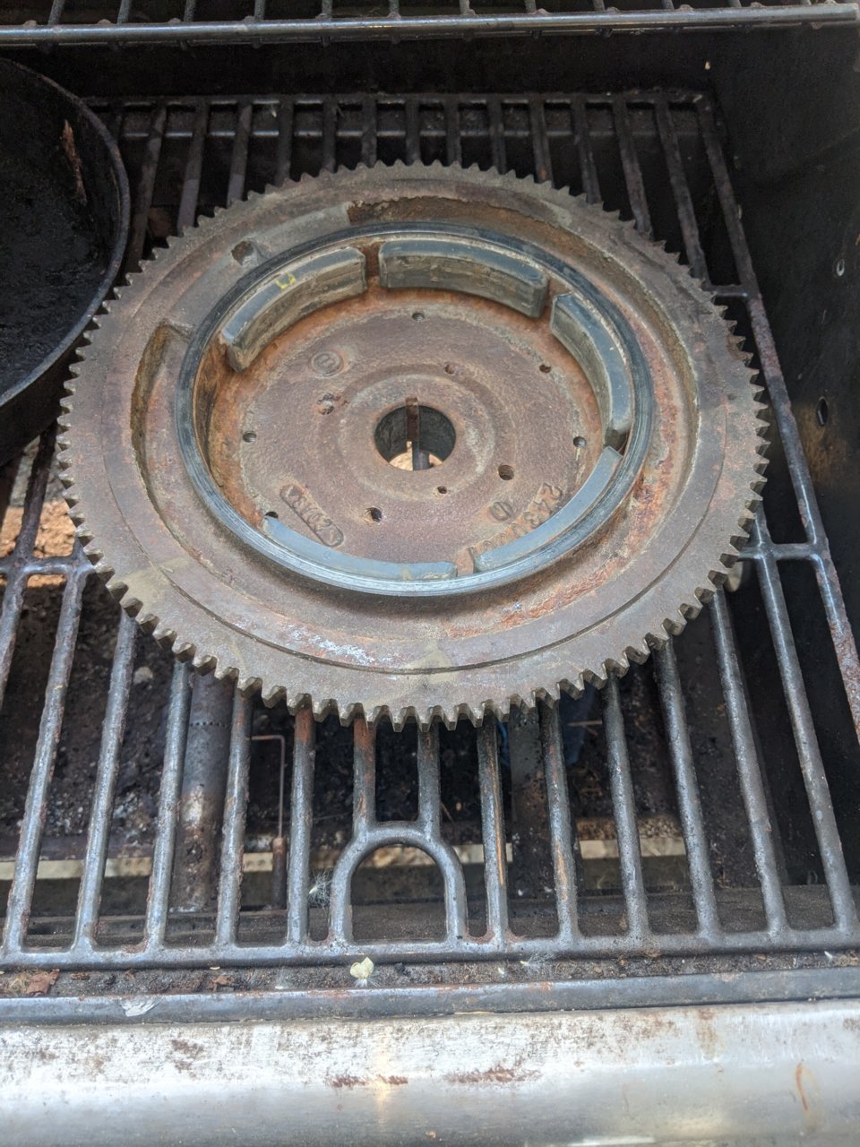

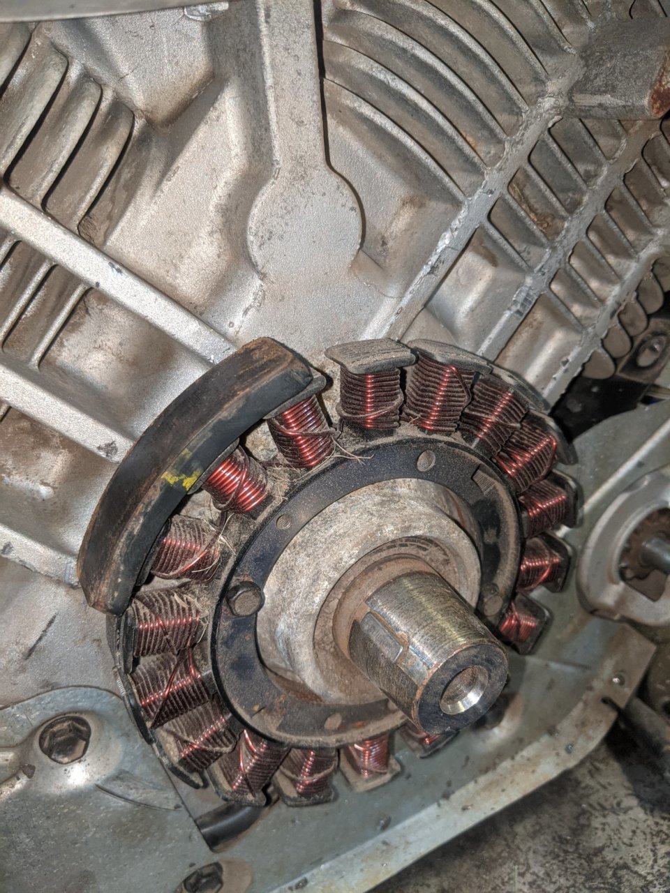

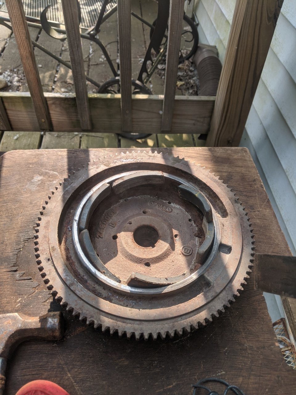

    The new engine was a victim of magnet delamination from the inside of the flywheel.
    Previous owner did a quick search to find new magnet only to discover that they are unobtainable. Up for sale the motor went.
    I probably should have told him you can rob the magnets from a Kawasaki flywheel and transplant them into a Kohler flywheel. They work just fine.

    quick moves cutting wires can be easy until reassembly.

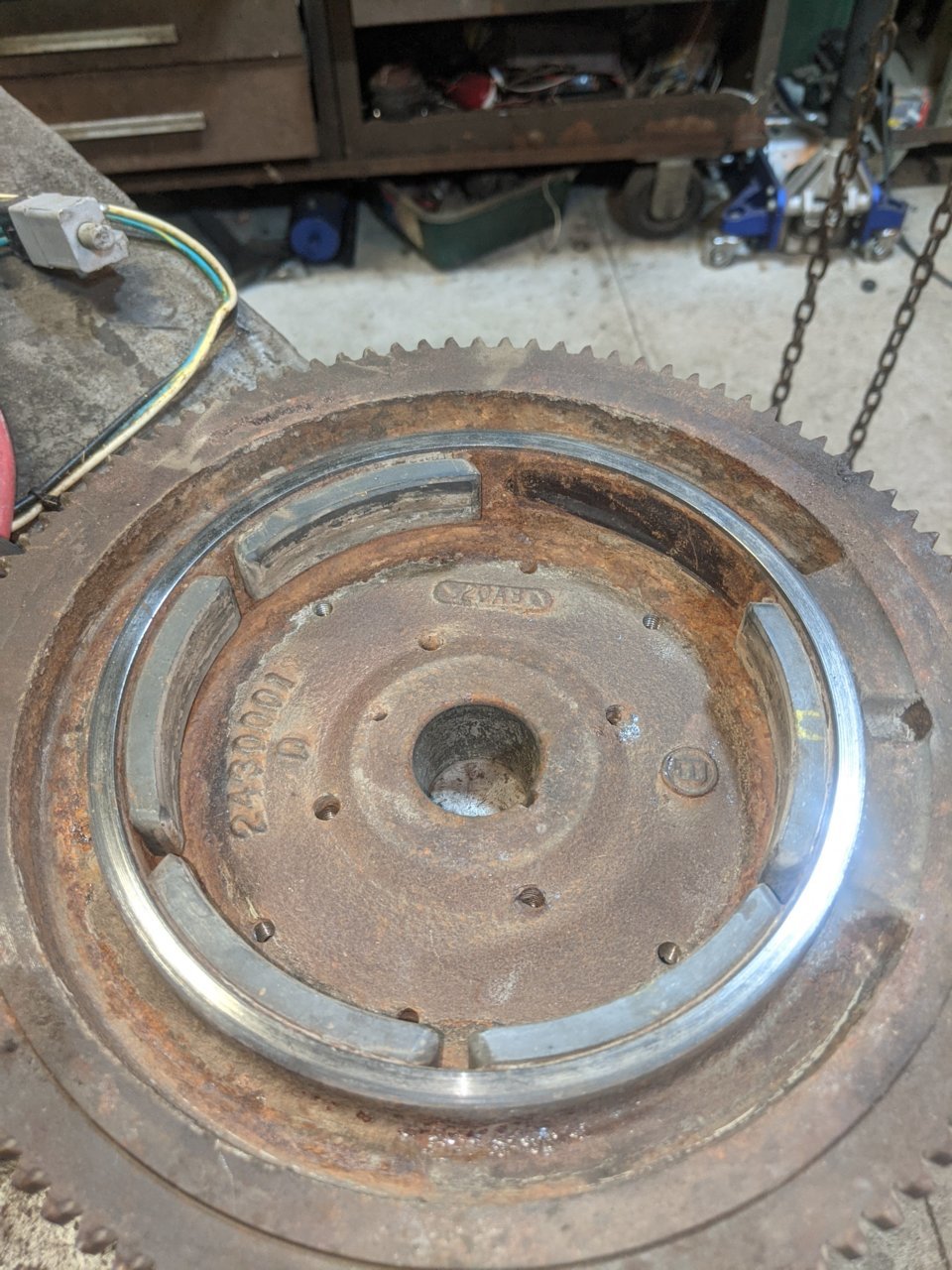

    I tested the charging on this engine when it was running on one cylinder and I had 13+/- volts. Figured the magnets were fine.
    Took off the flywheel to find this.
    Better to remove the rest and epoxy them in proper.
    Take the flywheel up to 350* and the double sided tape releases pretty easy with very light taps with a putty knife. The magnets are a ceramic and can shatter pretty easy.

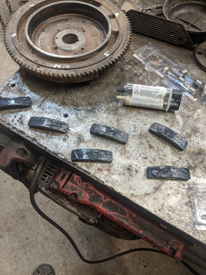

    Let the thing cool for a couple hours then I can wire wheel the inside of FW and the back of the magnets.
    Degrease, mix up some epoxy and glue them back in.
    I like to maintain the orientation, so I will number the magnets when it cools.PXL_20230610_124123719.jpg

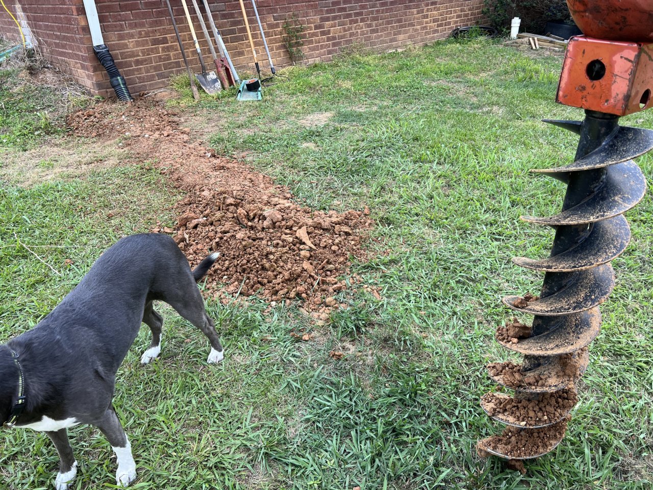

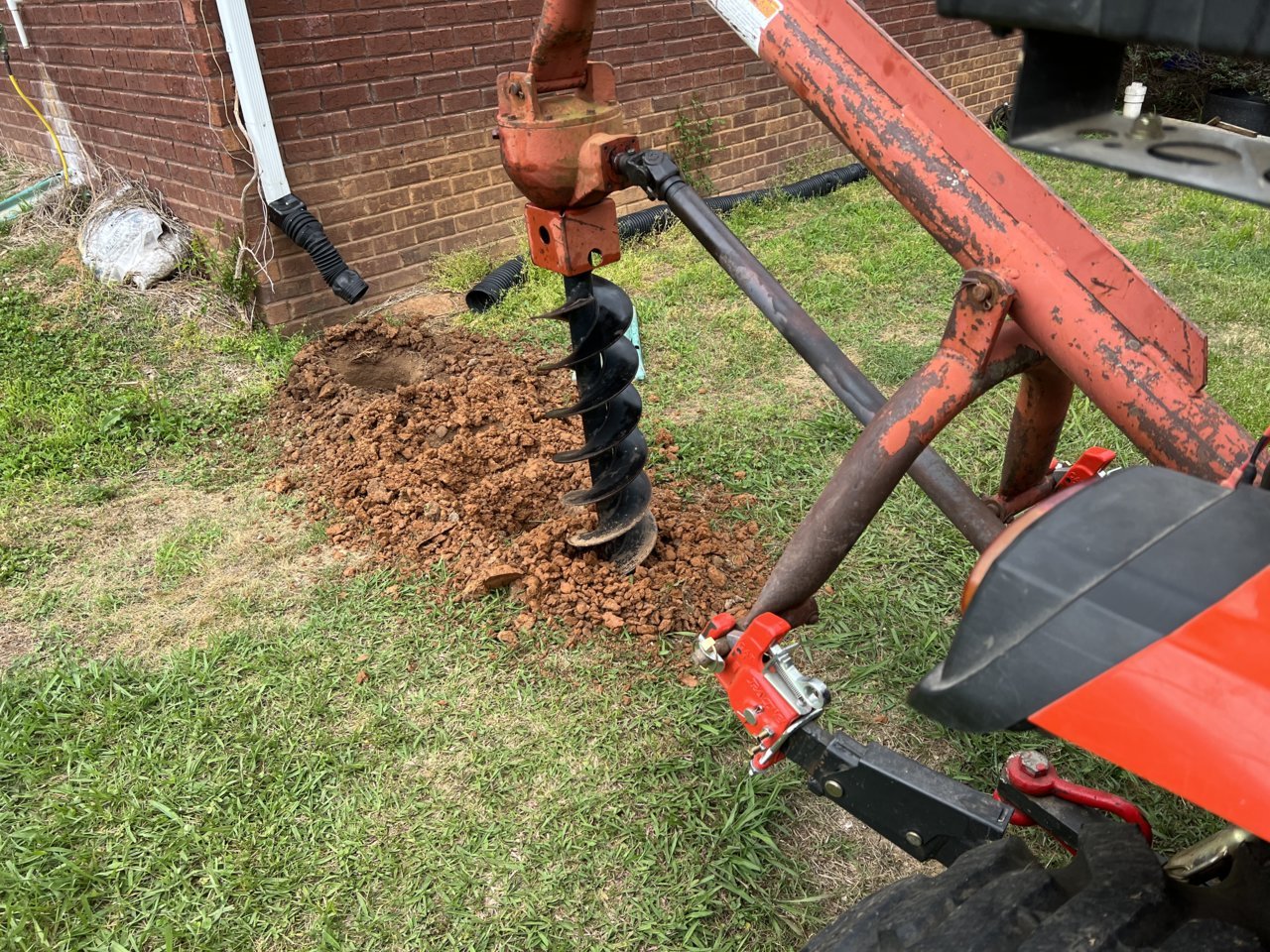

    A subsoiled would be faster, cheaper, and easier than a backhoe.
  13. Jun 10, 2023 at 7:13 AM
    KRAMERICA
    KRAMERICA Old Man Mike
    Mar 22, 2015
    #151504
    3,975
    Middle Tenn
    '18 F250 Super Duty
    A couple of rear window decals...
    Yeah, that might be true. But they dig very narrow trenches. I needed to fit a 4" pipe and a dig 3' hole at the end of the trench, with the least amount of physical digging on my part.

    V-GgkozSFWbbFeJZajFzciy7a-I7HCgz0u3r8rWS_09db7c21f2674bf9b9afd5b2358f0992e0c4bc3a.jpg
    All polished up and degreased.

    MEvIBPrVcLce6FMAHfAEUP8f7C-ufMwdIkHCv_Qa_14d56e60147b86bd768690856084209f32327e66.jpg
    Epoxied up. Now to stick them into their home.

    What brand/kind of epoxy?

    T-V2tz5qcNqAs-xBtL7oXpiOsDG332wb6KQLr-pz_4da636c3628e10cd5f96370372d5b13b217dc7fb.jpg
    I've used it a few times, but it takes a full day before it is cured to my satisfaction. It's been 4 hours and I can still dent it with my fingernail. Better to wait.

    i am around epoxy products often. very allergic though. two types. 24hr and some that kick in 20min. 24hr glue is much stronger. the wait is imperetive/valuable if thats what is required.
    acetone on surfaces to clean is the way. at least when glueing stone.

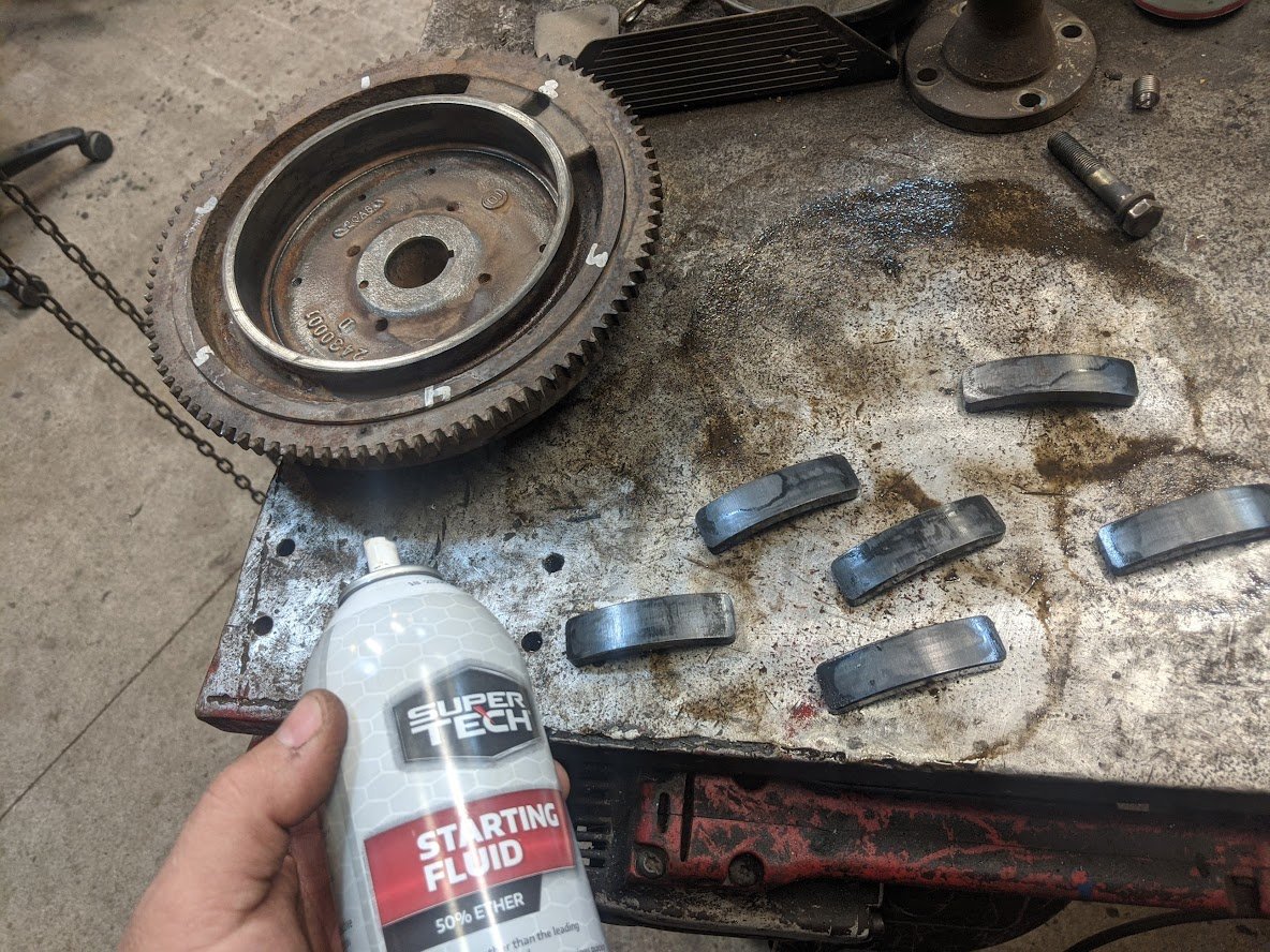

    I figure starting fluid is a close second for degreasing.
    I know that the epoxy is world better than the craptastic double sided tape that was used originally.
