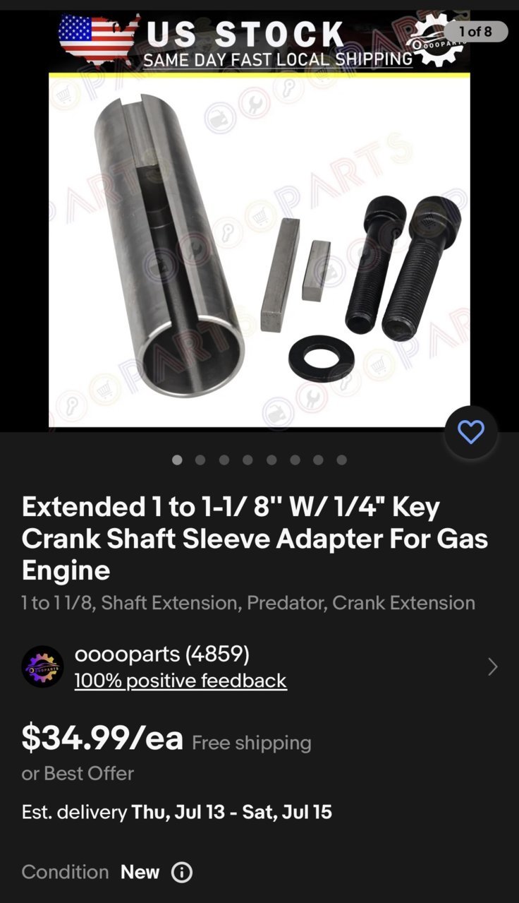

    Picked up one of these to true up the shaft size and length between the Briggs and the Kawasaki.
    We’ll see how that works out. Got hammered with rain lately, no progress. I have next week off though, so hopefully then!

    I've used them quite often. They seem to work quite well.

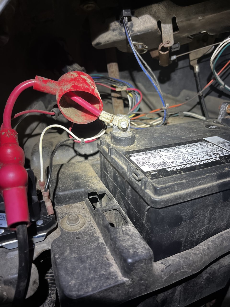

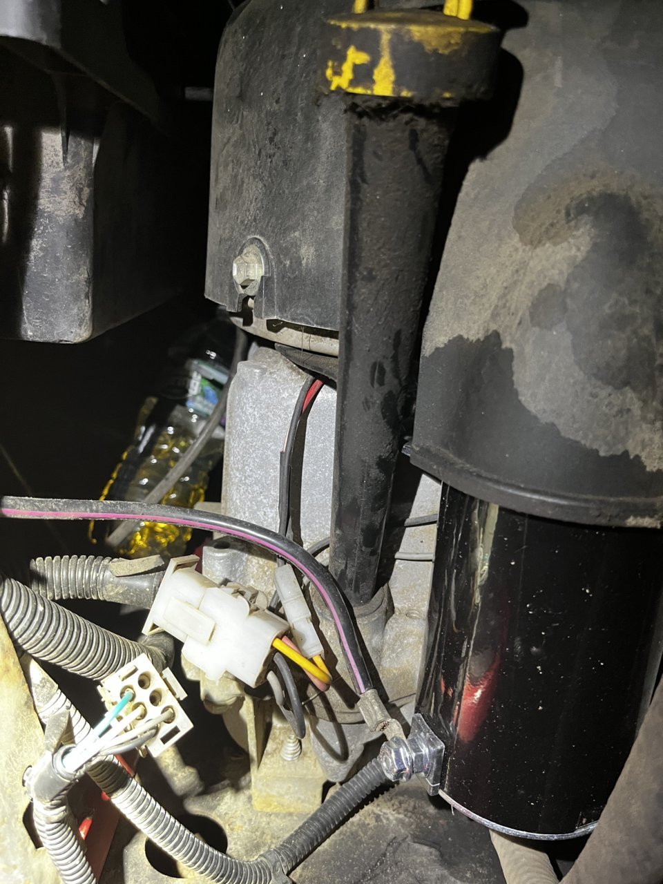

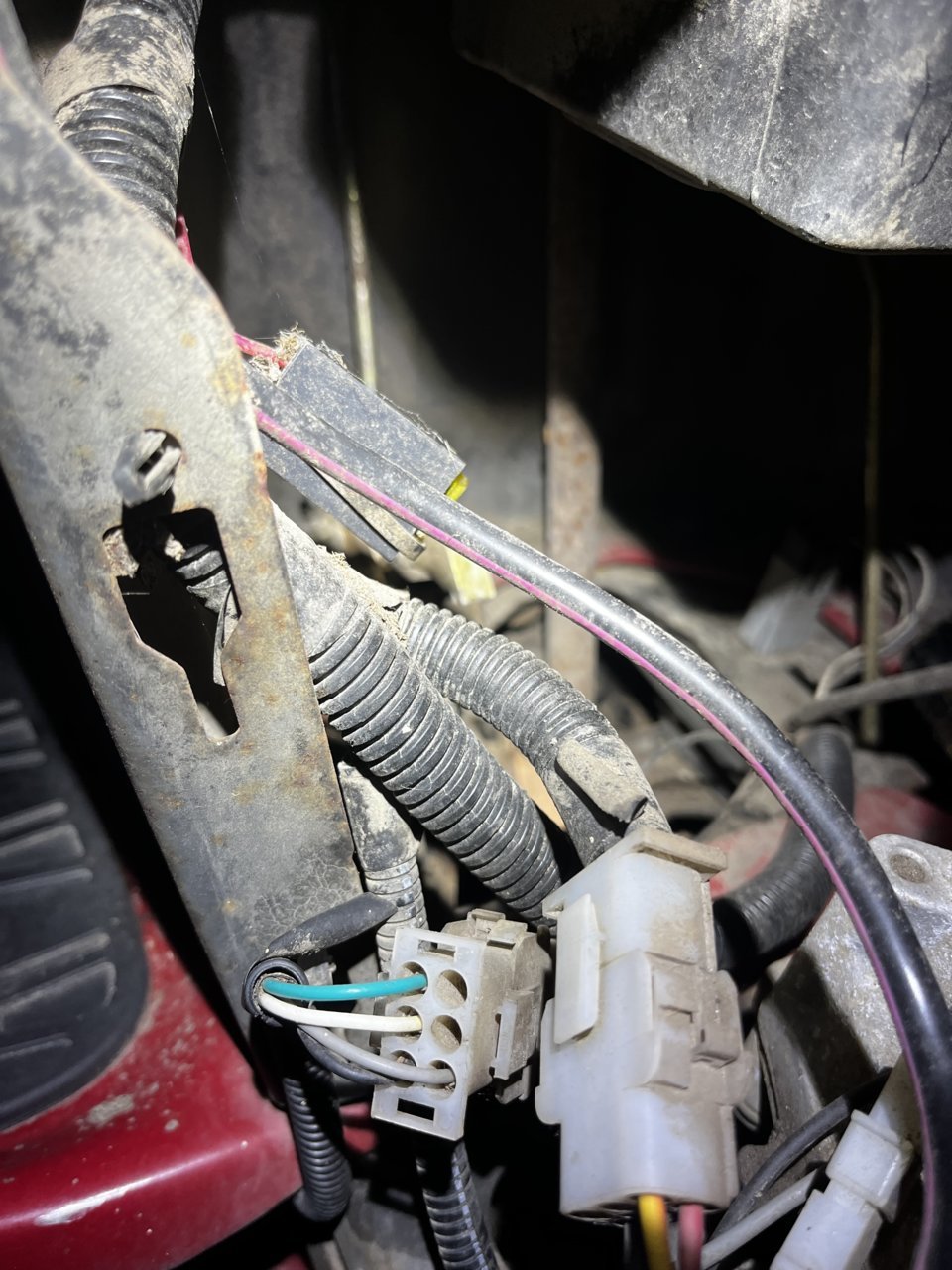

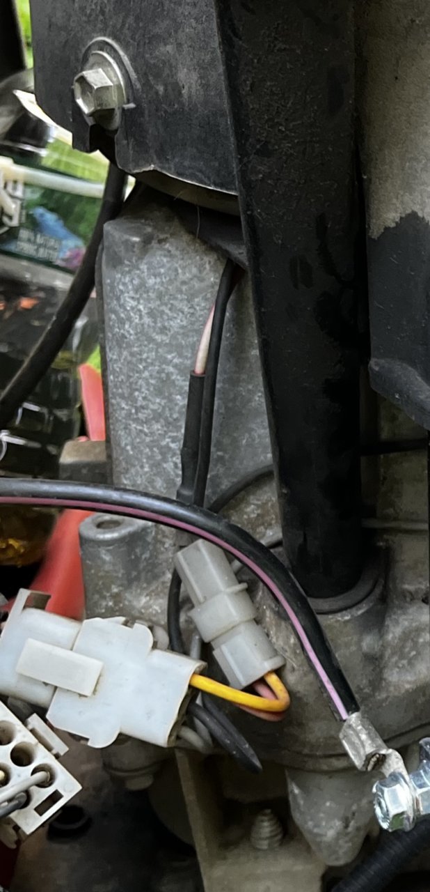

    Looking into it a touch further, took the doggo out for her business and snapped a few pics. I see no regulator on it anywhere unless it’s built into one of the connectors.
    Worst case is I’ll have to add one.

    Follow that red wire that goes under the shroud. It should go to the reg.

    Good to know, the reg on my Kawi is mounted outside that shroud. Wouldn’t have expected it to be under :facepalm:
    Edit: I plan to pull the shroud anyway to gap the coils and clean. Kid I bought from put coils on it but doubt he gapped them.

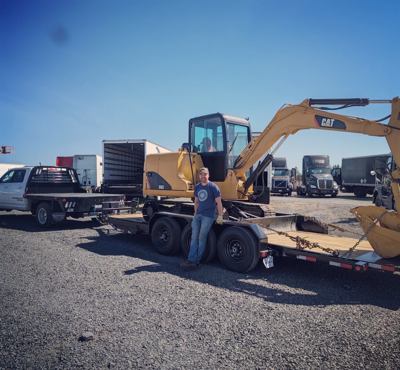

    I scored my first mini excavator for $12,500 at auction because it was inoperable. One $60 hydraulic hose later and she was good to go!

    thats a big un too!
    looking at a nice Cat 302.7d cr....... but if i buy it, my wife will make me sell the Yanmar Vio25. she says we dont need 2.

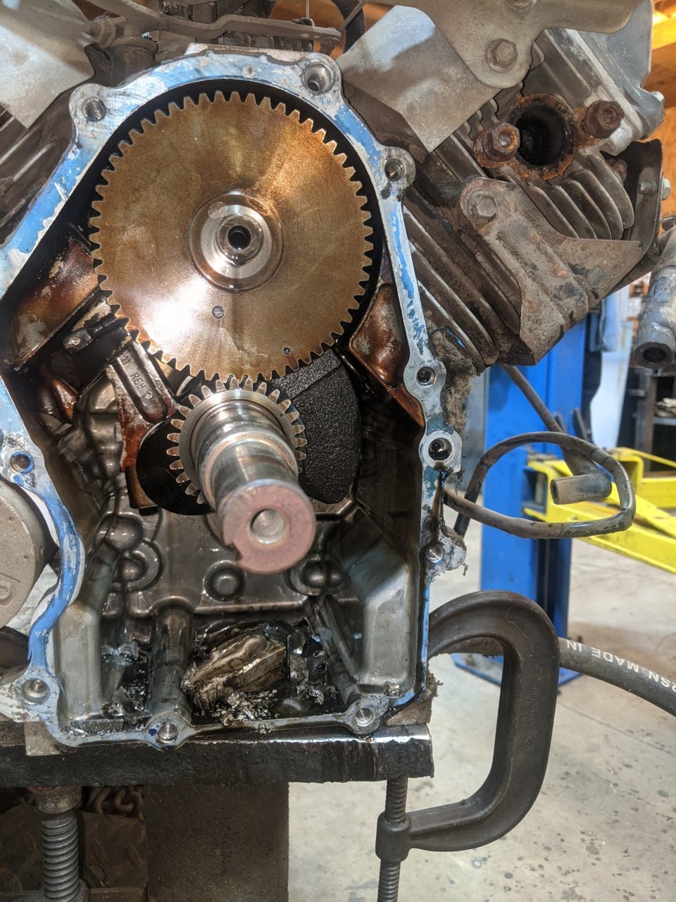

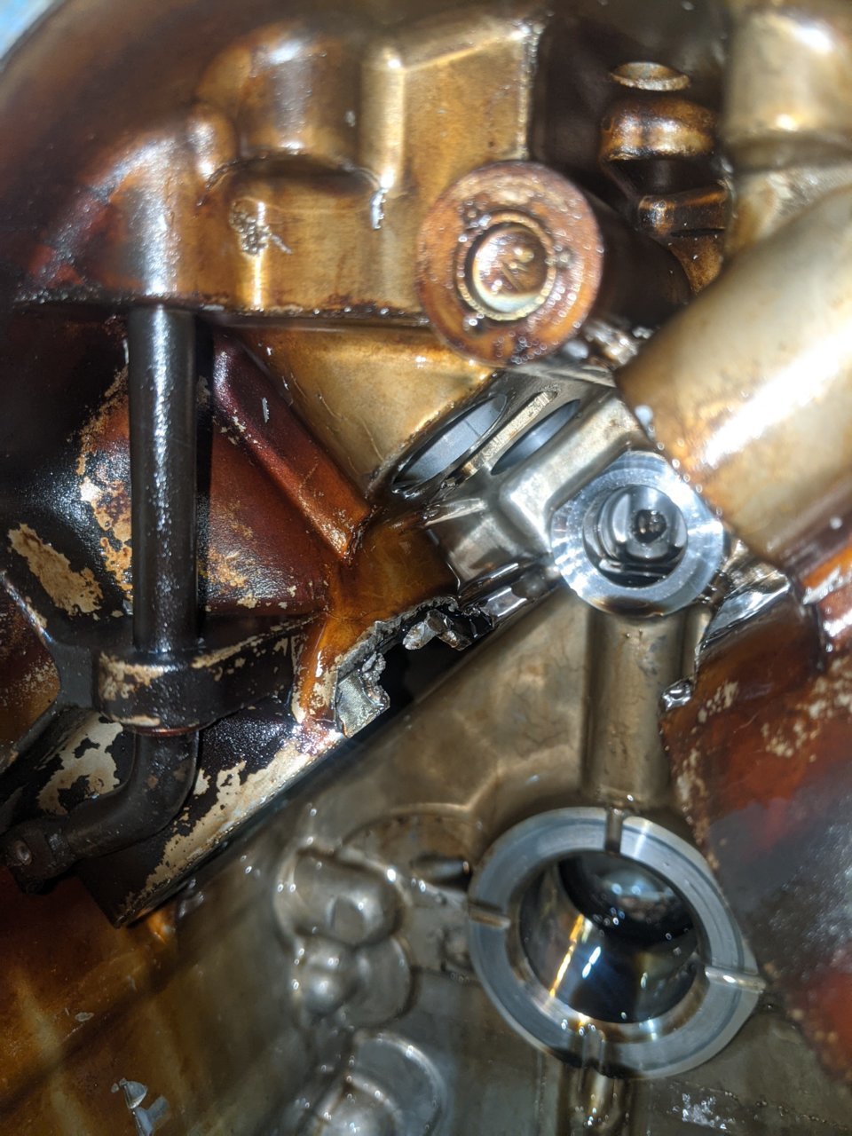

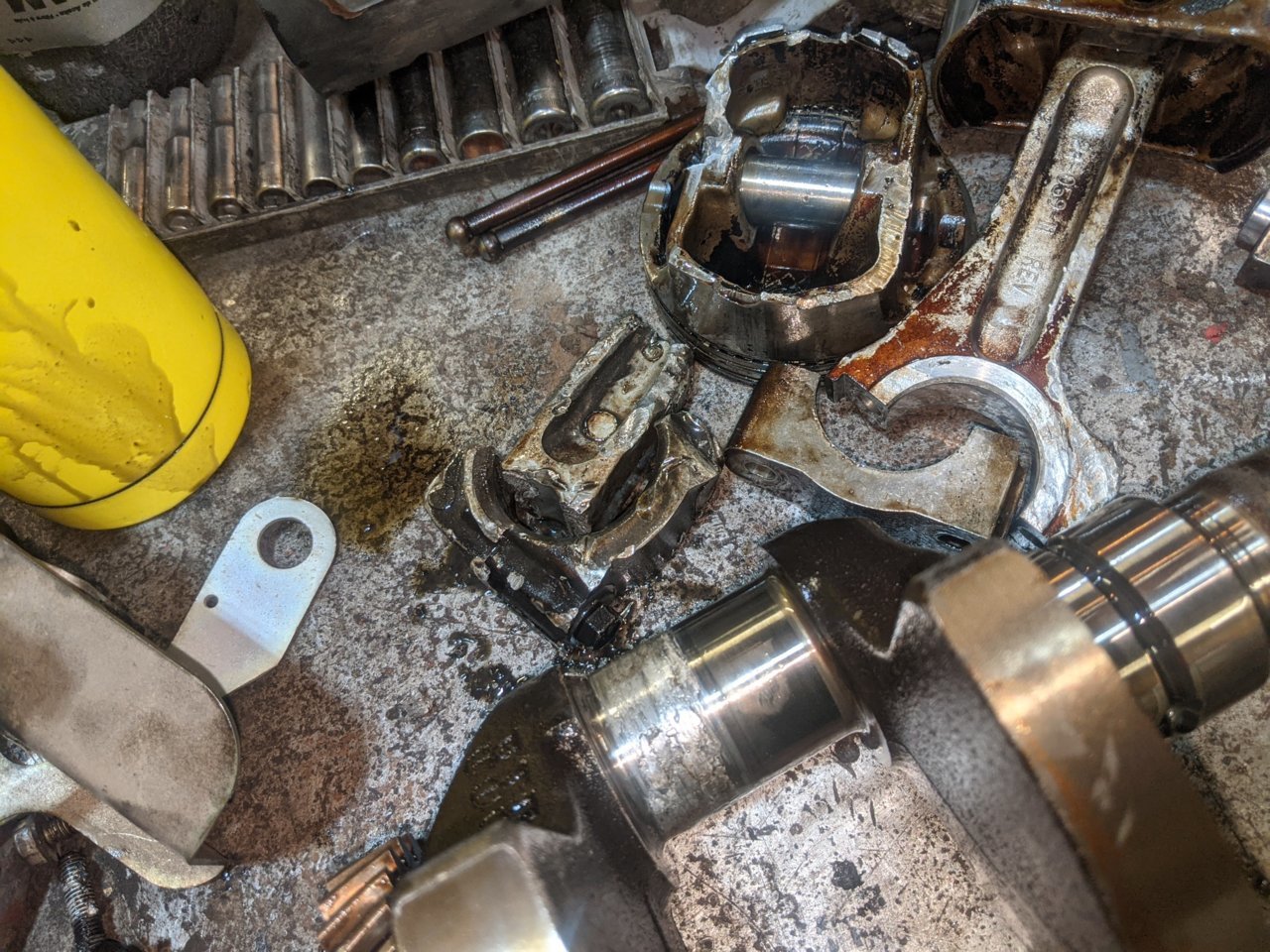

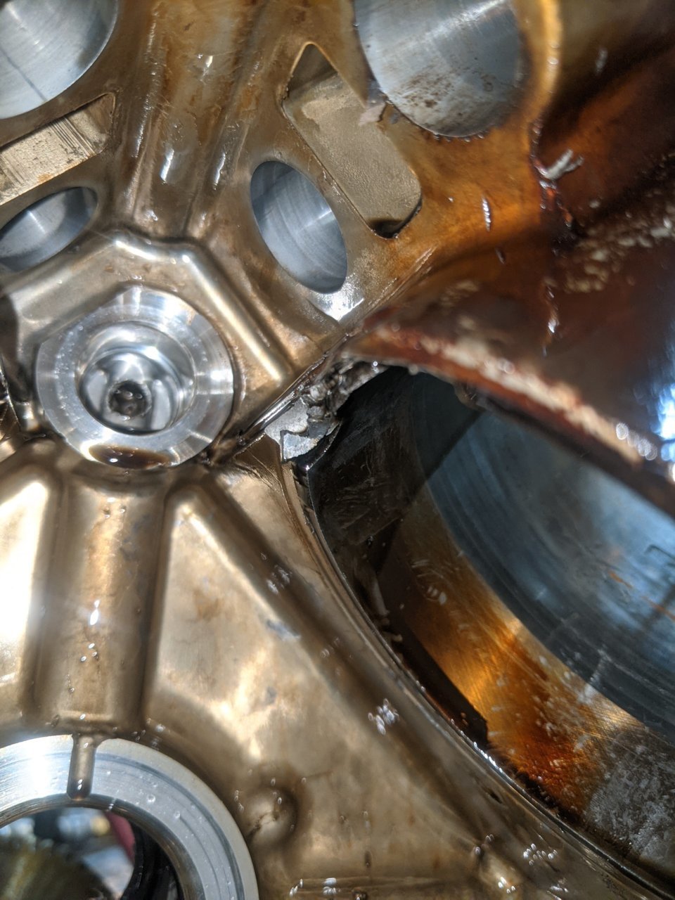

    Guys! Keep an eye on your oil. Connecting rod siezed on the crank. No oil in the thing. This is the 1st time I removed an oil filter and no oil was present!
    Block is fucked too. Broke pieces out of the bottom of both cylinders.
    Installing a Harbor Freight Predator. Waiting on adapters.
    Standby...

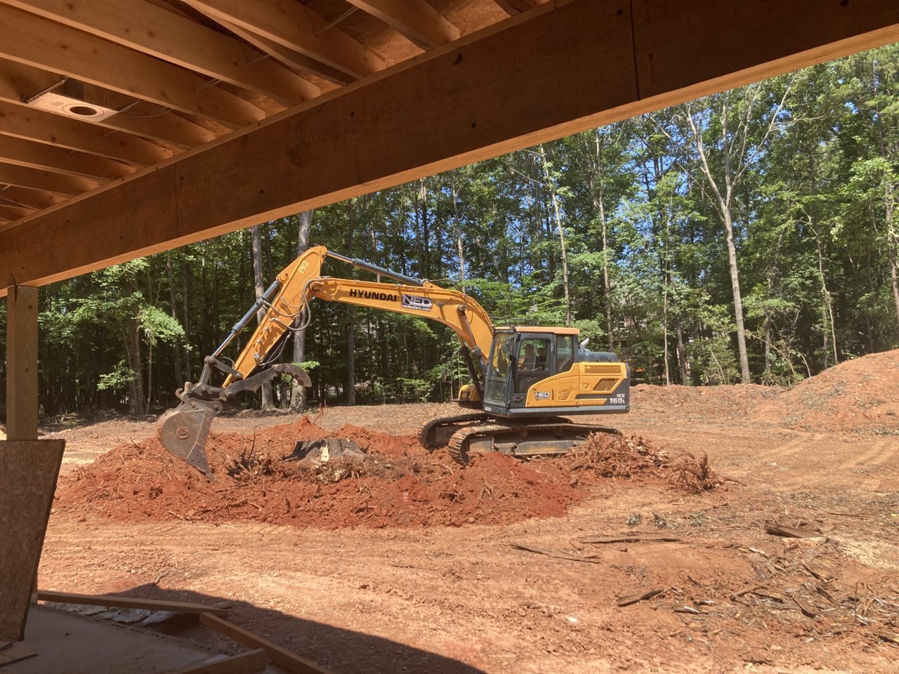

    I need to step up my game. This guy had the stump out of the ground in no time.
