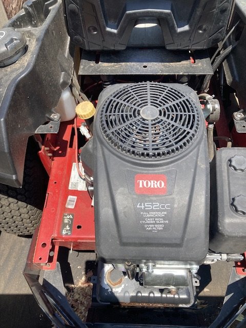

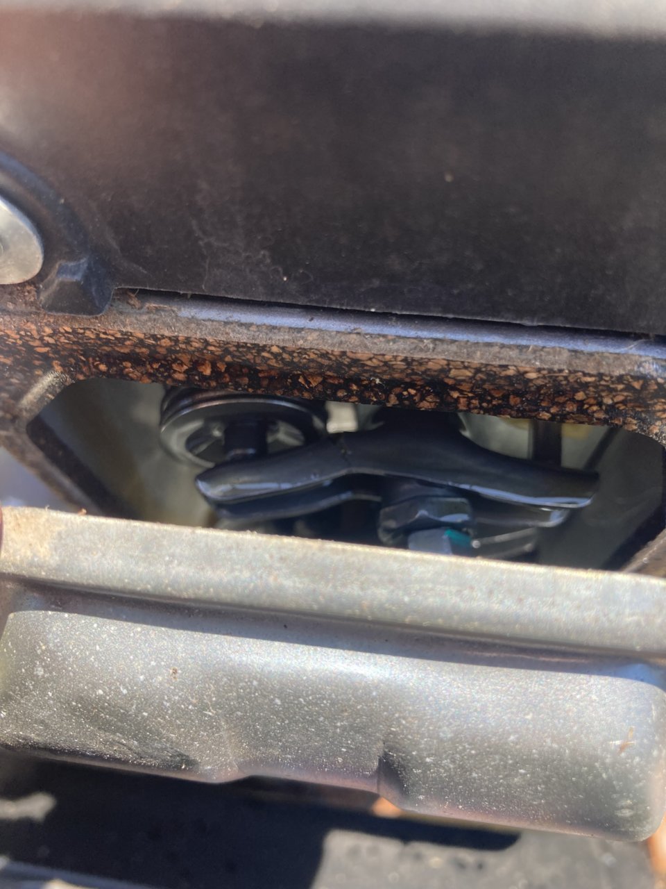

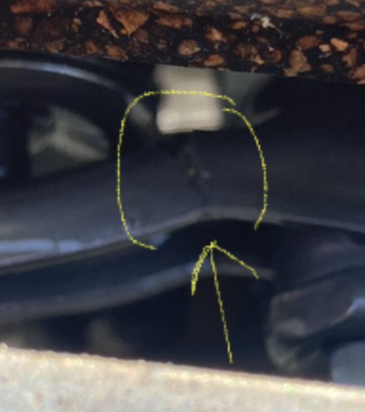

    Still awaiting the return of my mower after this warranty claim…:playball:

    That will make it run like crap - if at all. :laugh:
    Years ago I had an elderly Wagoneer (AMC 360 V8 power) suddenly start running very badly, I was about 20 miles from home and slowly limped it home.
    Found a broken rocker arm on an intake valve, replaced it and back to normal.
    It used a full quart of oil in the 20 mile trip.

    I hope they adjust the valves before they change out the rocker arm.

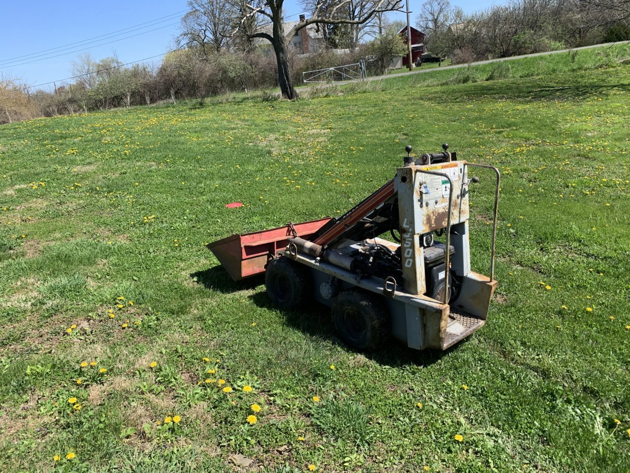

    I’m not spreading all that peastone by hand, so I gotta get the packings/o rings for the curl cylinder on my mini skid steer and slap that back together. Pic for fun:

    I got one similar to that. That unit should be in any home owners power equipment arsenal. My wife demands ours is fully functional at all times!

    The mini skid? I got it for free, was going to give the guy back the $300 he paid for it but he never would accept the money. I still have the cash in an envelope and next time I see him (it’s been three years) I’ll offer again. It didn’t run at all when I got it, had the worst fuel tank on it I’ve ever seen. Loaded with rust.
    Rebuilt the carb, found an identical gas tank, cleaned the lines out, charged the battery and it fired right up. I’ve repacked the lift cylinder already. It’s supposedly rated to 680lbs tipping load but I’ve had 1000lbs on it. The hydro motors weren’t happy but it moved it. Lifted it fine too.
    I’ve got a bucket and forks for it. It’s slow as hell, but it’s never leaving my possession. I considered it, but it’s just too damn handy.
    It’s an 11hp Wisconsin Robin single cylinder engine. I’ll put a Honda motor on it if it ever blows, or a Predator. It has aux hydraulics on it too, I saved the good wheel motor from that old Husqvarna ZT to build a hydro post hole auger for it.

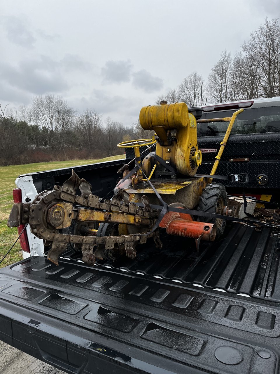

    Nice, didn’t realize yours was a Kanga. The Aussies love those things! Such useful little machines. I also snagged this trencher to use the bar off, but decided to maybe just fix the trencher itself first and see how well it works. I have too many projects and no time. :rofl:
