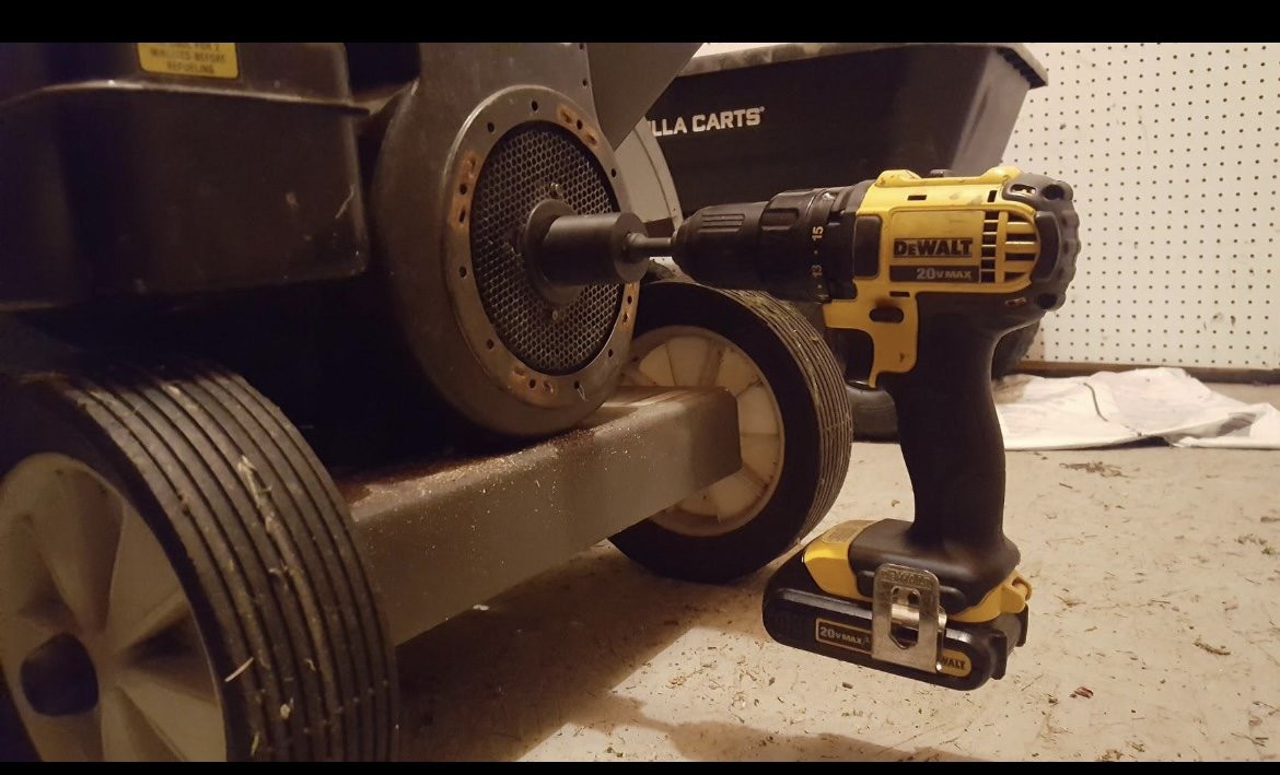

    Pic stolen from the internet but it’s worth a thousand words. This is how I start stubborn pull start equipment.

    my exact fuckin idea. does it work? im not trying to be a moisty but ive got shoulder issues and work to do. open to ideas and feedback.
    shaeff[QUOTED] likes this.

    Works great, as long as your drill battery is charged. Nothing moisty about it, I’m a 39yr old, relatively in shape dude and I get tired of pulling these things over when messing with them.
    Work smarter, not harder. Save the hard for when it’s needed.

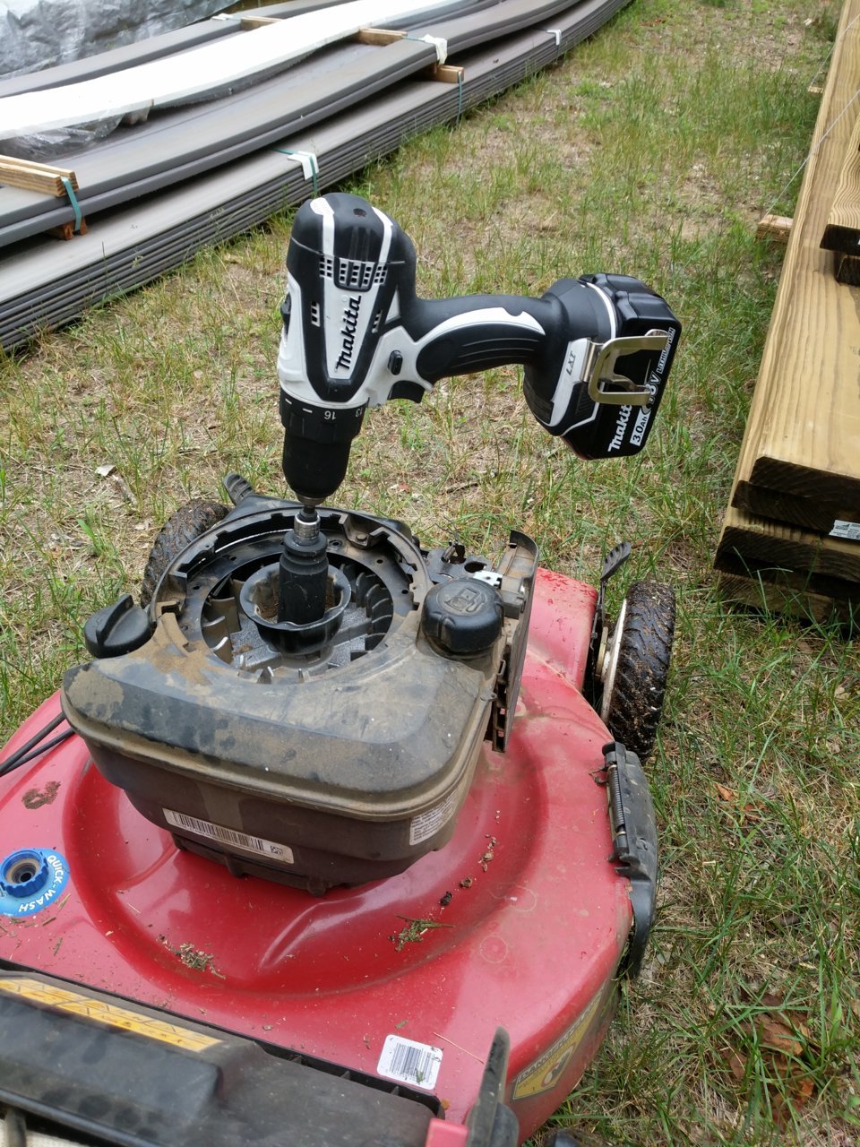

    Works great. This worked for a year after fixing the pull start twice.

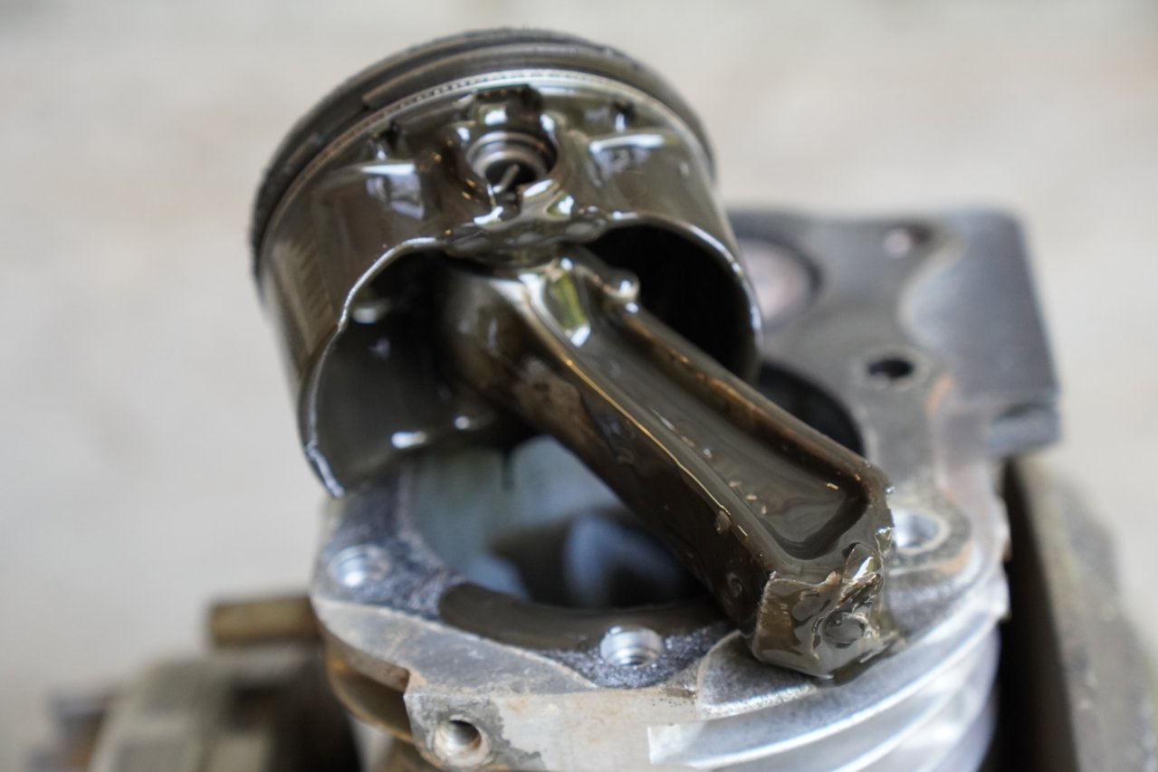

    It will work until it does this:

    the other bad thing that sometimes happens is the bolt breaks off in the shaft..... then you gotta drill & clean out & that takes forever ... or at that point you throw it out & get another motor. :-0
