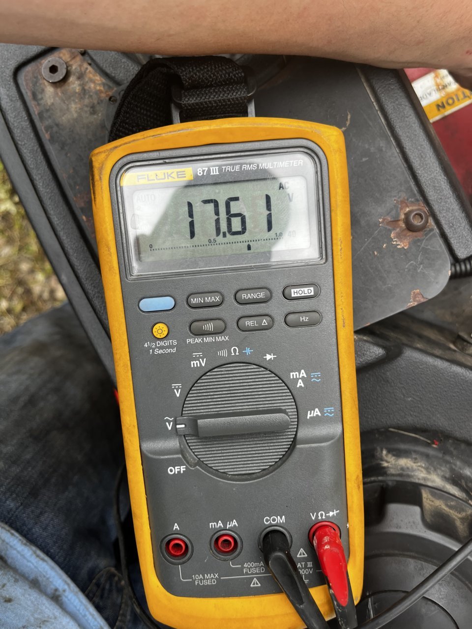

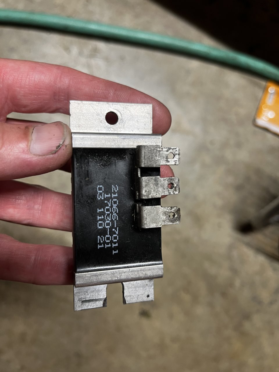

    Got it going this morning. Runs great, few little tweaks to do. Not charging.
    I’m getting nearly 18VAC from the stator. I expected more.
    When I connect the exciter wire (violet) it pops the 20A key switch fuse.
    Im thinking the reg is fried. When I connect my meter to the 12+ terminal and the violet wire to measure DC amps, I get nothing. If I connect violet to regulator, it pops the fuse.

    Ok my mistake, I accidentally called the violet wire the exciter wire. :rofl:
    I’ll put it this way, my only issue is charging and popping the key switch fuse.
    Kill wire on the Ferris is white, grounds out when key is off. Works perfectly.
    When I connect violet to the regulator, the key switch fuse pops.
    It did run for a bit connected, but eventually it pops. When it was running I tested DC amp output and had nothing. One lead on regulator, one on violet wire. I did this test starting the mower with everything hooked up.

    Have you checked the stator for continuity? It should only read about .04 ohms or close to that.
    I find it hard to believe it's shorted out, but it's easy to test.

    Yep, tested good, right around there.
    Also puts out around 18V AC.

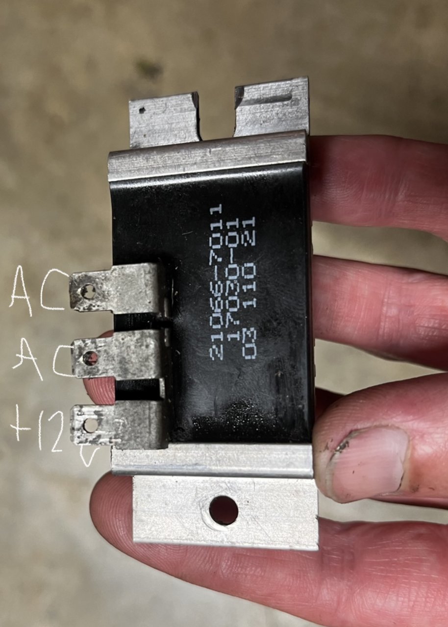

    Edit, here’s the regulator I’ve got. I have another identical one kicking around I gotta try to find.
    Edit: I wonder if something is shorting out from when I pressure washed the machine, not sure water would be enough to pop a fuse though. :shrug:

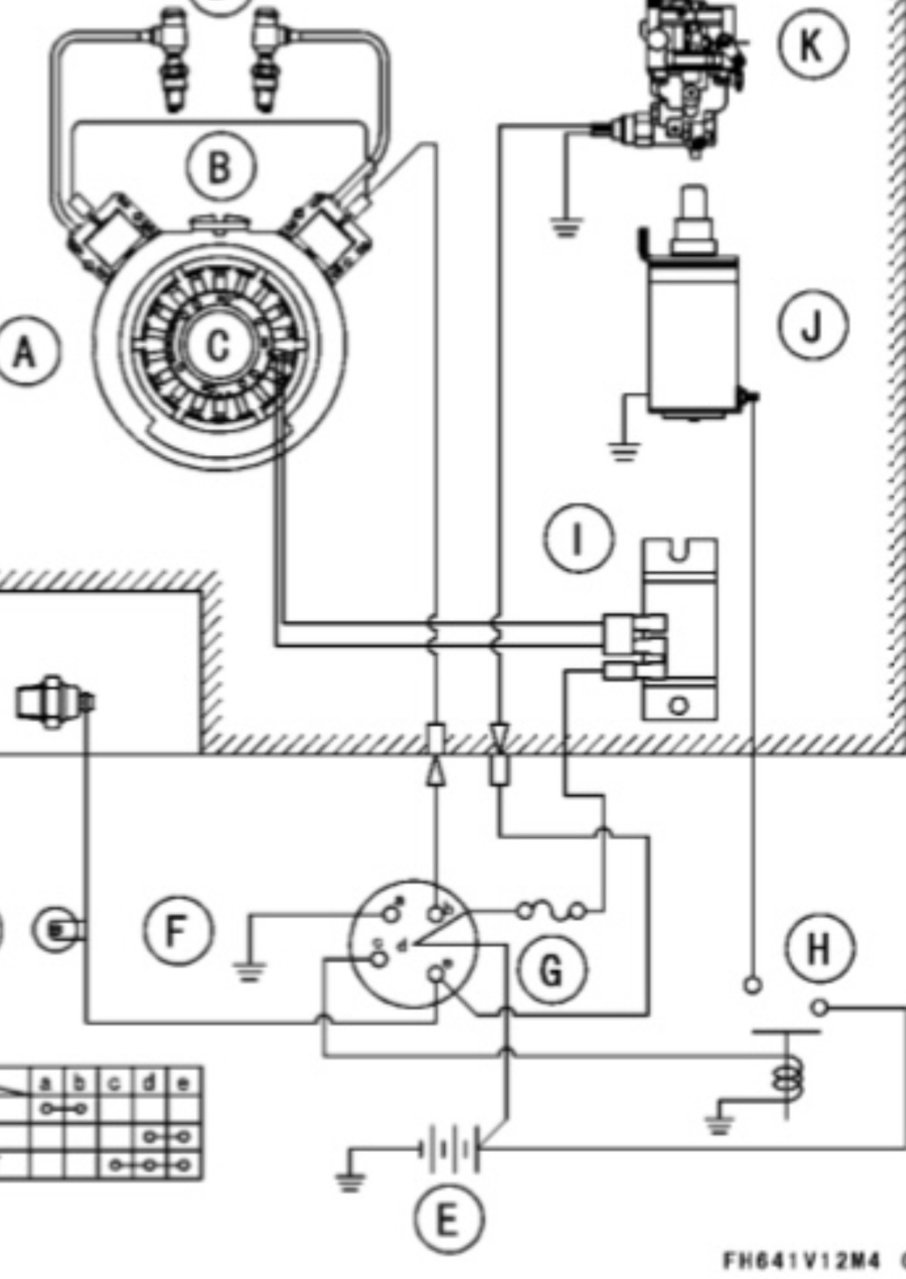

    From the manual, looks like my reg is the top two terminals are stator and bottom is +12v violet. Seems weird to me, is it normal for the +12v (violet) to be on the terminal that’s also got an AC wire on it @koditten ?
    Look closely at the diagram and you can see what I mean, and again at the reg.
    Tracing wires looking for a short now. And gotta make sure I got a good ground on the reg too.

    That is correct. I'm used to the regulators that have the 12v+ in the middle.

    It looks like they are bridged together so you should be fine in the middle or bottom. :notsure:

    I'm not following.
    The 2 top posts are both AC. Your engine makes AC. The voltage regulator turns the 2 AC wires into a single 12v DC.
    I hope I'm tracking.

    I think I'd source a different regulator.
    That taking 1 leg for ac lighting is screwing up our conversations.

    I wonder if that bridge is what is blowing the fuse. The way that reg works, you will be sending both AC and DC to the key switch.
    I honestly have not dealt with type of regulator.

    THIS. This is what I’m asking. :rofl:
    Im thinking that the bridged terminals should be both AC, the single separate terminal should be +12v. That’s why it doesn’t make sense to me.

    Hence, I'd find a normal VR.

    Got one on the way. AC terminals on the outside and the DC terminal center.
    Also, fun fact: I checked the RPM at WOT and it was a little low. I adjusted it to about 3550RPM @ wide open throttle. Stator is now putting out 30VAC. Awesome.
