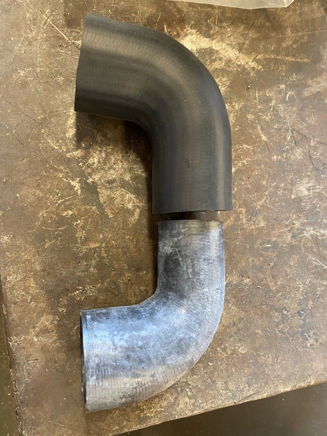

    Here’s that upper radiator elbow for a 140. I ordered and they replaced because it was made wrong. I wound up using my old one because I was ready to put it back together when I realized it was wrong.

    I had this exact issue with an upper radiator hose I ordered through Amazon. It actually ended up being the air intake hose that went from the Donaldson style (oil bath) air filter to behind the dashboard for fresh air intake.

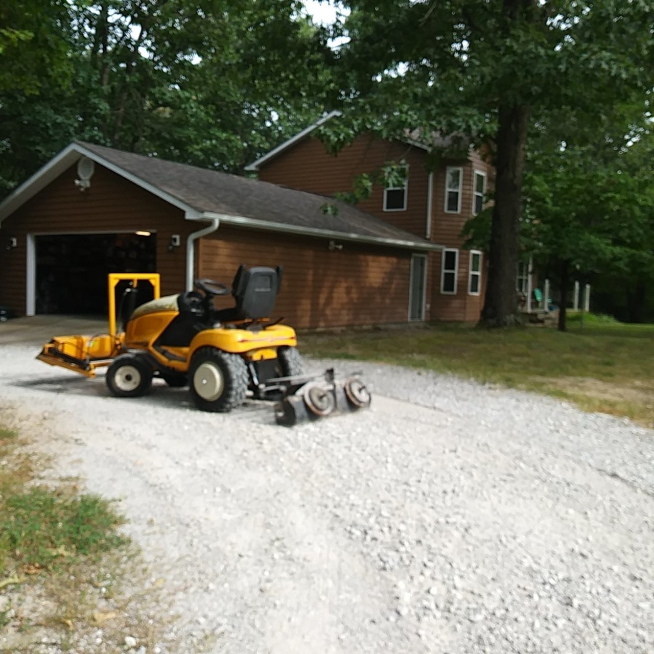

    Here's my wagon. 1400lb as ballasted GT. 100lb 42" wide box blade with 70lbs of weights on it. 170lbs total with 200lbs of down pressure available on the hitch. Loader to allow for backdragging and digging/hauling gravel and dirt. I also have a plow and a cultivator with a middlebuster I trench with.

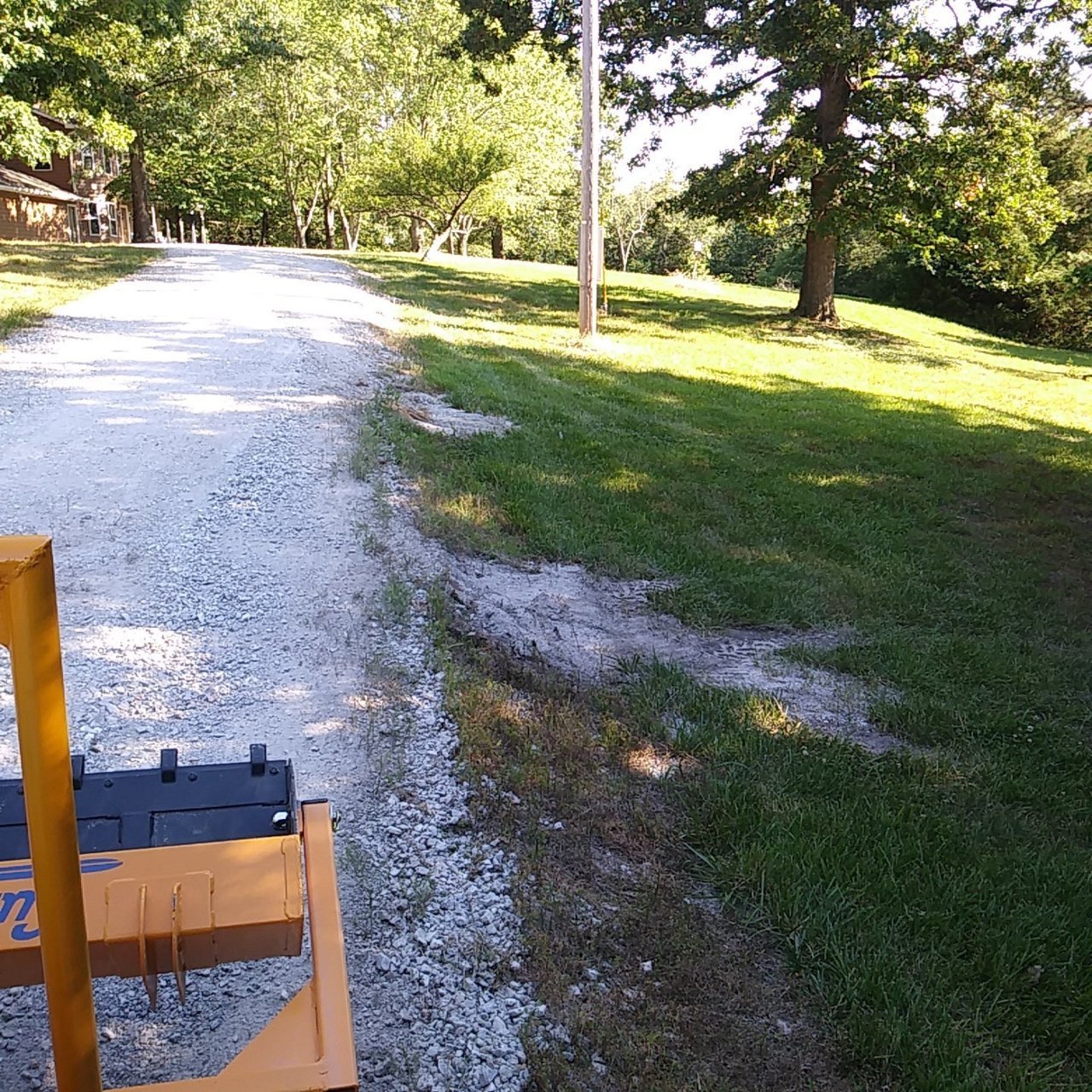

    One of my issues that I addressed yesterday. Left side of pic from me to my truck. Runoff cuts the grass edge down and leaves a ridge. I bladed off the ridge over the last 2 days and dragged gravel in and tried to blend it up to the grass. Only thing I can think of is to cut a ditch between the gravel and grass to keep the water off the gravel.

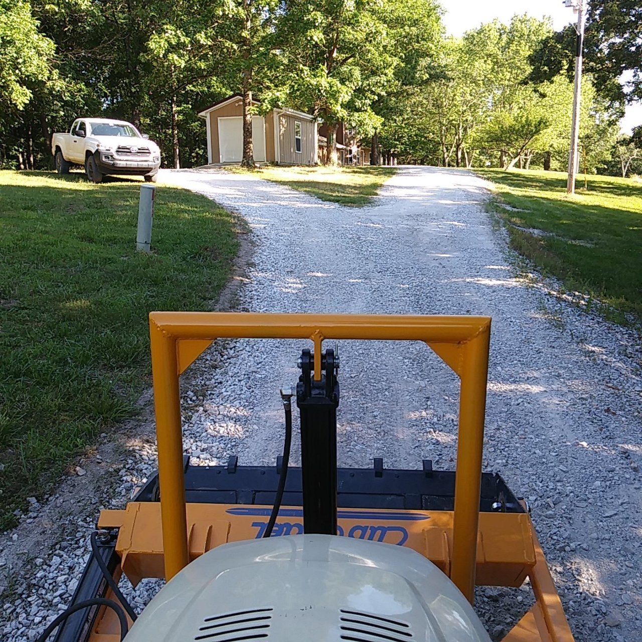

    The first one of these shows the angle of runoff I have. Water channels down from where my truck is and cuts into the right side of the driveway. Bottom pic shows 2 cut paths. There's another one just past my drainage pipe to the right. Do you think pouring quickcrete on the shoulders of these 3 spots would slow the gravel washout?

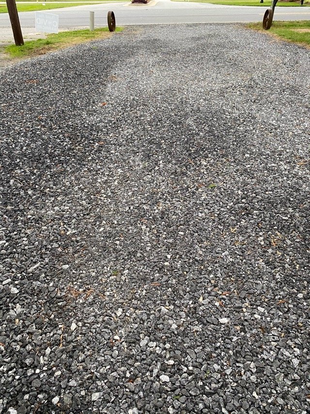

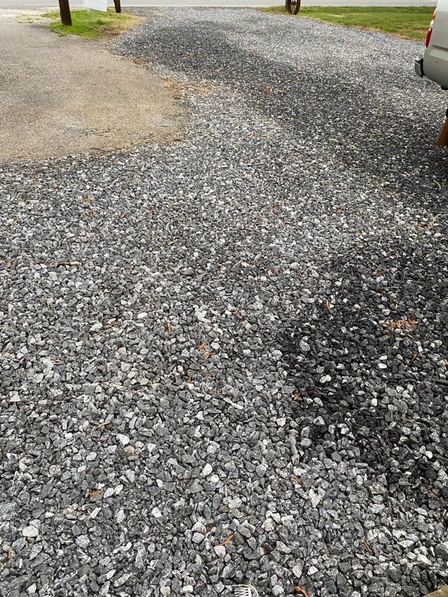

    Crush and run is one of the worst for washing out. We battled the same thing in our driveway, put a load of 57 (I think it’s 57) on it and haven’t had an issue since.
    Ours was washing bad where our parking lot meets our driveway. Hasn’t moved since :thumbsup:

    You've got to slow the movement of the water. Either by diverting it, or trenching in a french drain where it wants to run. You could run it the length of that area that washes out, or collect it and dump it out by trenching through the driveway and letting the water run off on the other side. Water itself doesn't wash anything out. It's running water that does damage. Slow it down, give it someplace to go and you should be good.
