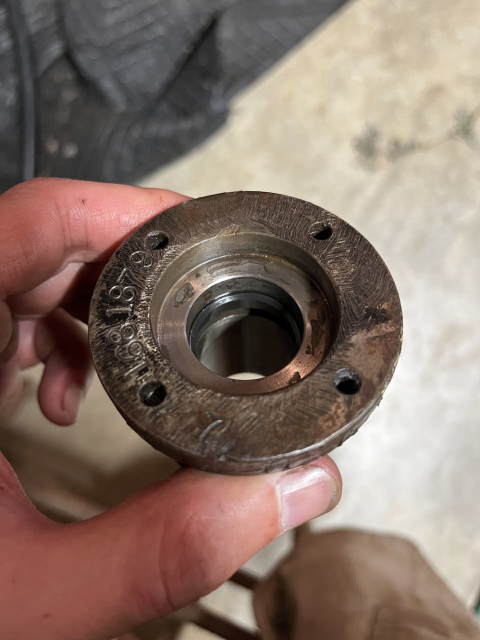

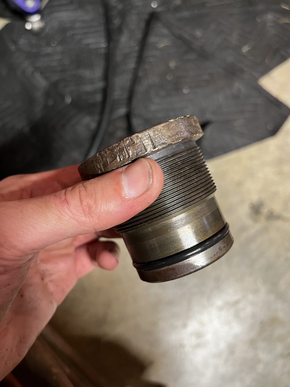

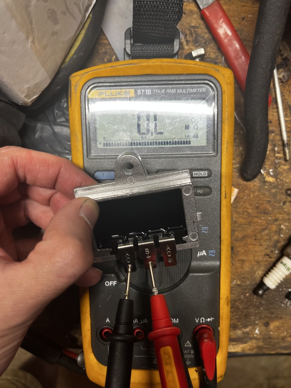

    Veered away from the Ferris for a few minutes yesterday since I’m waiting on a rectifier/regulator.

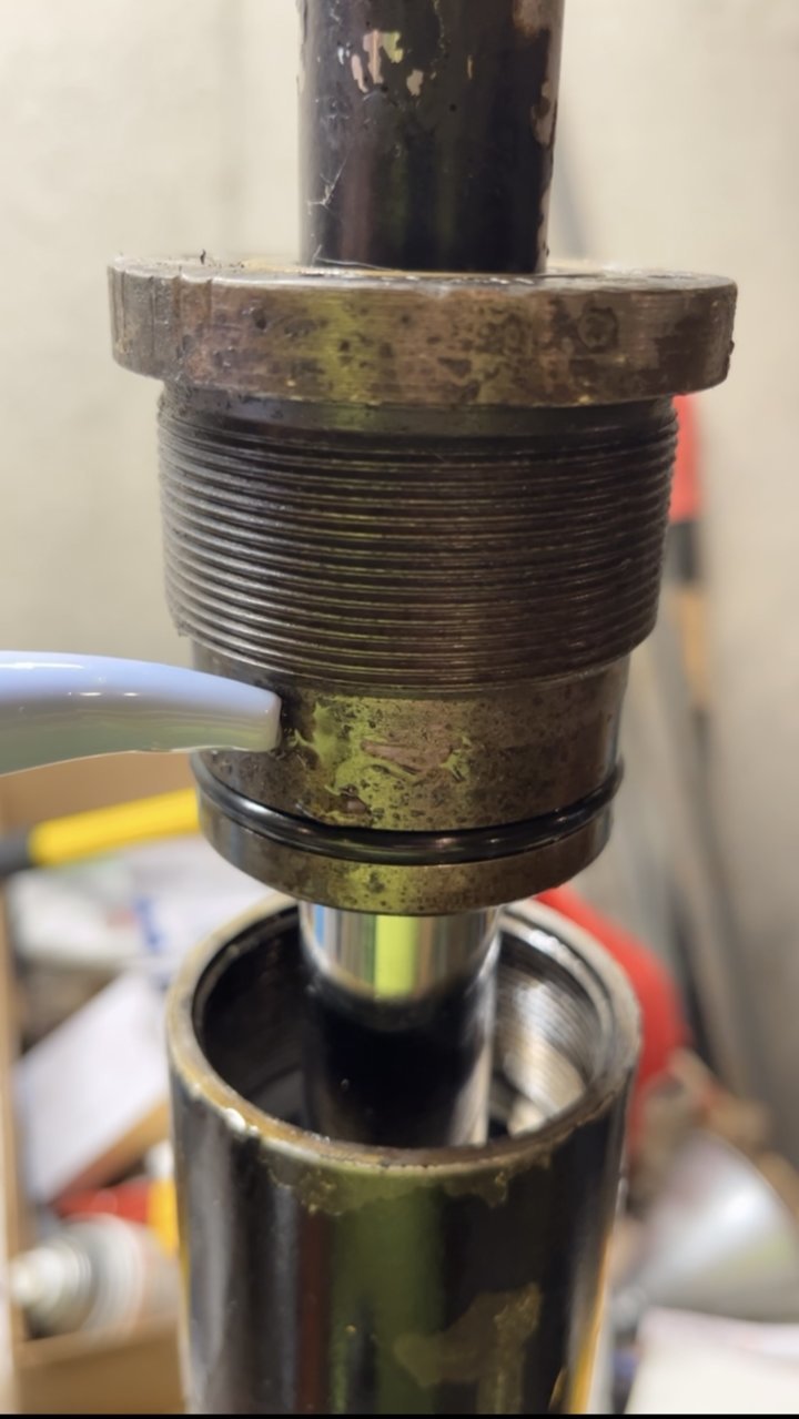

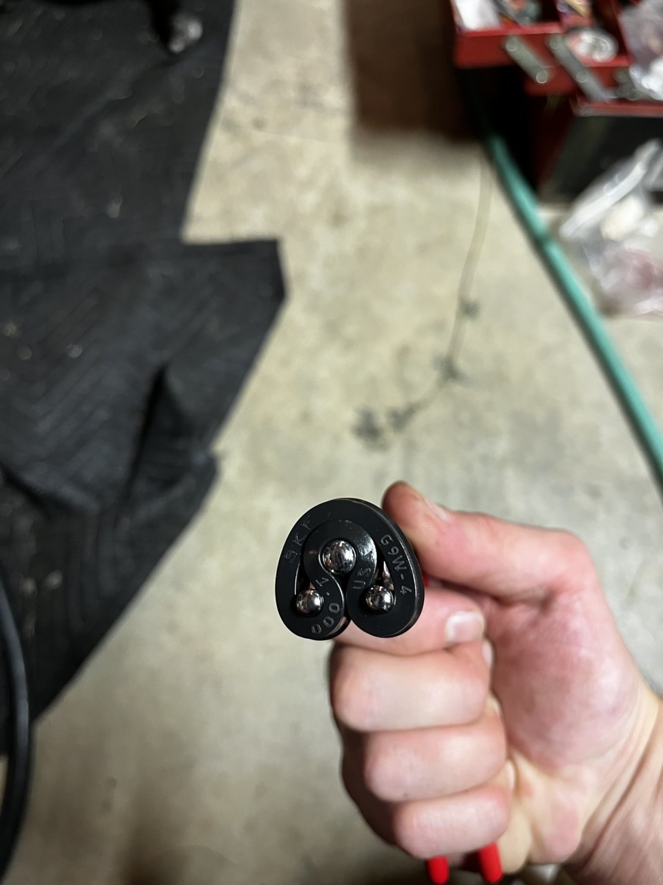

    On to repacking the curl cylinder on the mini skid steer. I seem to have misplaced one small o-ring. :facepalm: I’m hoping to get it operational by the weekend. I have a large swing set to grab for my kid and I was planning to ratchet strap a hand truck to one side and lift the other with the skid steer, roll it up onto the trailer.
    I’d love to NOT disassemble it.
    Having the right tool helps, but this little sucker was a huge PITA to get in.

    Reminds me when I rebuilt the B7100 FEL cylinders.

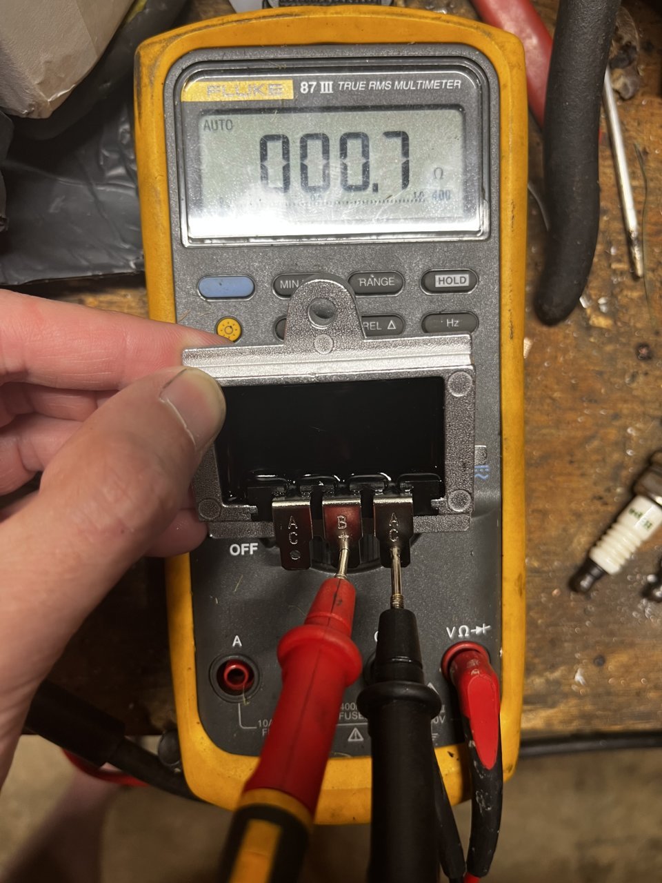

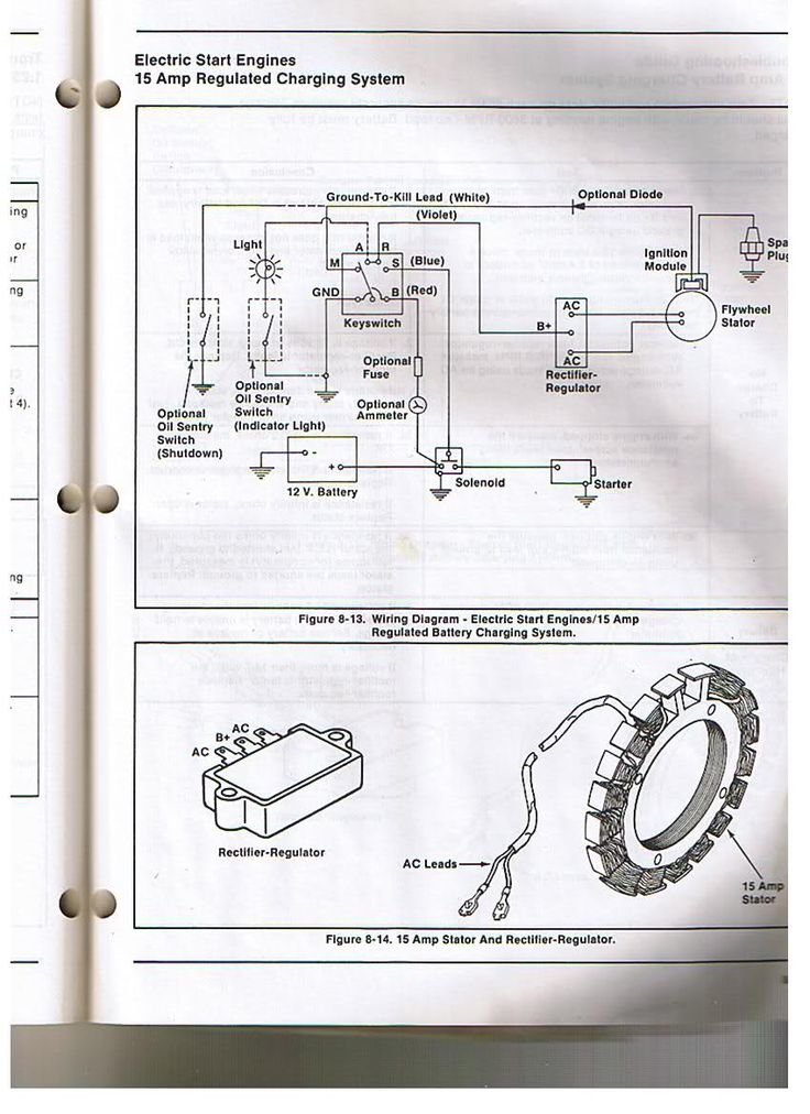

    Annnd back to the Ferris:
    :shrug: new regulator has continuity across the same terminals as the old one did. What the crap am I missing here?
    this one is laid out:
    AC B+ AC
    Old one was:
    AC AC B+
    Both show continuity from B+ to AC. I’ll give it a go, but hopefully it just works. Anyone have a diagram of how the diodes are set up in these things so I can maybe understand what’s going on inside?
  6. Jul 26, 2023 at 6:05 PM
    DES2009
    DES2009 Minister of Truth
    Jul 22, 2014
    #134426
    1,000,542
    Southeast Louisiana
    2017 MGM Limited
    I'm a Millionaire! One Million Posts!!
    This video shows measuring voltage, not continuity...
    https://youtu.be/vb3NSE6-oUc
    shaeff[QUOTED] likes this.
  7. Jul 26, 2023 at 6:13 PM
    shaeff
    shaeff Roaming Around
    May 22, 2016
    #187639
    580
    Hudson Valley, NY
    '07 DCSB SR5 6MT 4x4
    yep I posted a video a few posts back showing the same.
    My issue is that I run 30v AC into the regulator and it’s supposed to put out DC voltage/amps.
    But when I hook up the old reg it was popping the ignition fuse. With this one showing continuity across an AC and tbe +12v DC terminal I’m afraid I’m pushing 15v AC through the system and popping the fuse.
    I’ll try it tomorrow with the power probe and see if it trips.
  8. Jul 26, 2023 at 6:32 PM
    koditten
    koditten Well-Known Member
    Sep 8, 2013
    #112077
    19,743
    Kirk
    Central Michigan
    04 trd x-cab 4 x 4 3.4l
    Reserected from the dead.
    This test won't work.
    The VR doesn't function unless it's hooked up. It needs a battery to function proper.
    2 outside post come from the stator. The middle goes to the battery.
    I think you will find it does the job proper once hooked up.
    shaeff[QUOTED] and DES2009 like this.
  9. Jul 26, 2023 at 6:33 PM
    DES2009
    Jul 22, 2014
    #134426
    1,000,542
    Southeast Louisiana
    2017 MGM Limited
    https://youtu.be/i3j4hrTOAMI
  10. Jul 26, 2023 at 6:38 PM
    shaeff
    May 22, 2016
    #187639
    580
    Hudson Valley, NY
    This is what I needed to hear, and now that you mention it, makes sense. Thanks. I’ll give it a go tomorrow.
    Neat, thanks!

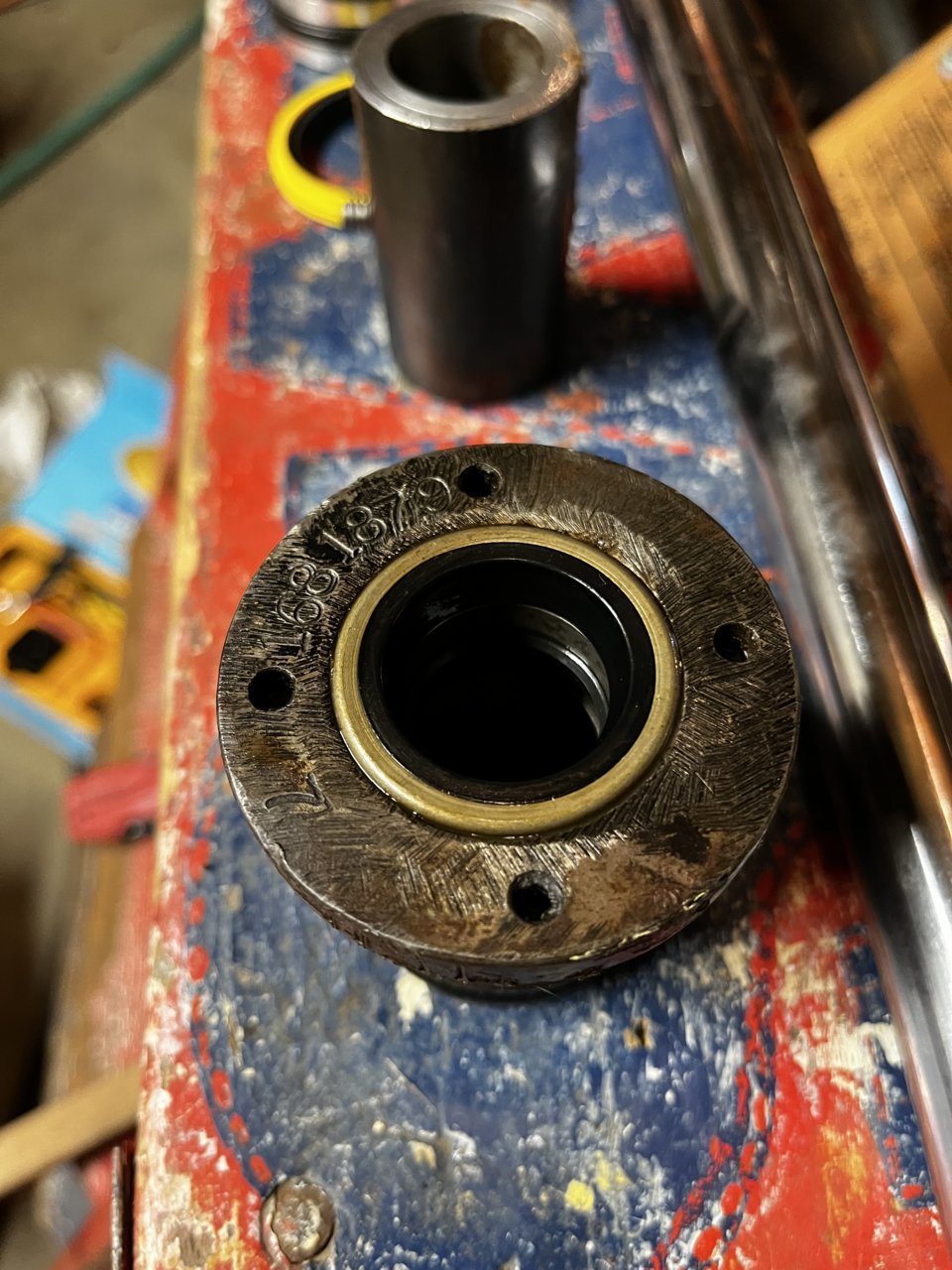

    Got the end nut back on, too. Cylinder is all ready to tighten down and reinstall.
    Going to attempt that this evening. One thing after another piled up today. Hate that, but it’s life.
