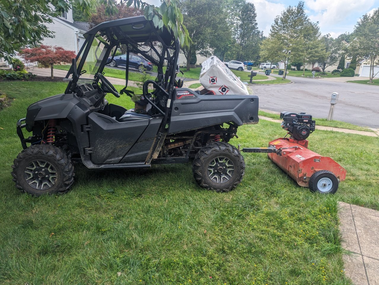

    Some footage of the Flail in action and by action I mean just running and sitting still:
    Turn your audio down!!!
    https://www.youtube.com/watch?v=XEfV4r61Ndo
    So I ordered a new pulley then got impatient and ordered one 1/2" smaller diameter from Amazon to test with, so ignore the belt flopping, I just wanted to see this thing run. currently the pulley is 4.5" and the motor was set for a 5.25" pulley. Also apologies for not getting a better view of underneath it while running, this thing is not to be trifled with running, so I got scared and told myself "good enough".
    I did order an electric clutch for it and a replacement 5.25" pulley from surpluscenter, but I was able to pull start and also electric start it as is, so I might let that slide for now. Plan is to pop the motor off, give the blades a quick once over and throw it back together to see how it cuts. I do think it rides too low for what I need, and I really want to get 15" tires to fit on it as the 13" on it are too narrow for the weight, even if it says different. With the motor sitting on the one wheel, it looks stressed. I will need to figure that out. I also want to weld on some angles to deflect around trees as opposed to smashing into them as it currently would. I also need to lengthen the tongue as it is very hard to back up since it sits very close to my SxS. Probably wouldn't be a big deal on one of my riders or tractor, but the SxS with the bed and motor on the Flail being right there feels like a problem waiting to happen.

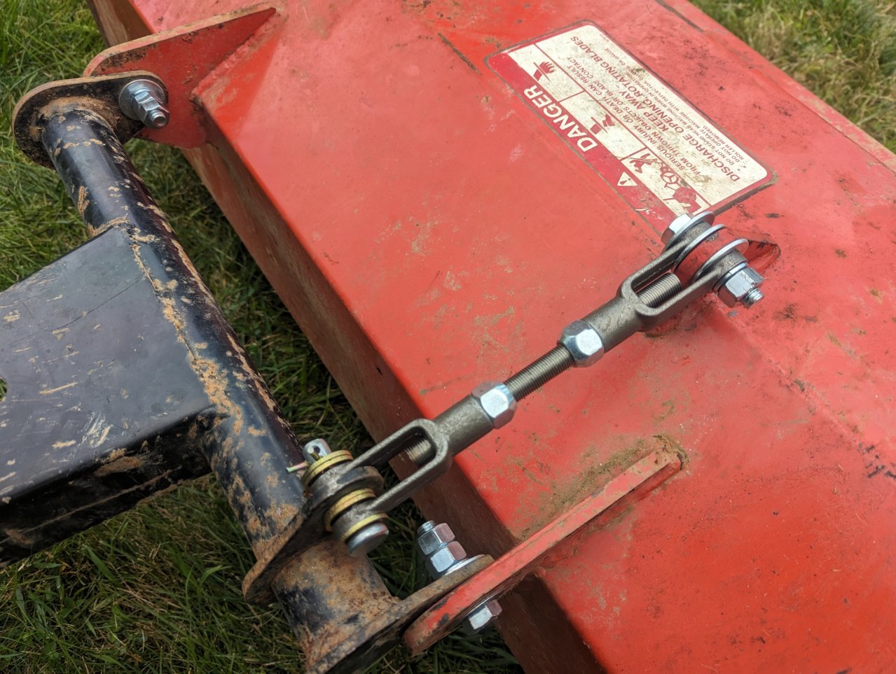

    I did make an adjustable link since it had a piece of angle with holes drilled in it upon my possession. Since I can pull this with multiple things, I needed a way to adjust it easily.
    End of season it will get stripped down, sanded, panted and probably make a rig to front mount it to my Pioneer if possible.

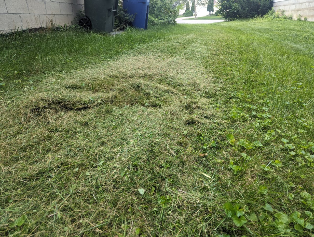

    I did take it through my yard for a pass, it never skipped a beat, but I plan on cutting heavier, taller stuff at my cabin so not really a good test. I can tell it is going to need more height adjustment built in than it currently has. I can only raise it up another 1/2" or so. Grass is only like 2" long post cut here. I could make a putting green with this baby fully lowered lol.
    shaeff, RustyGreen, koditten and 2 others like this.
