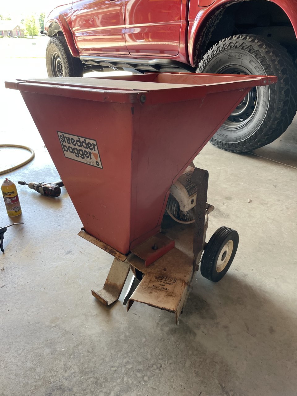

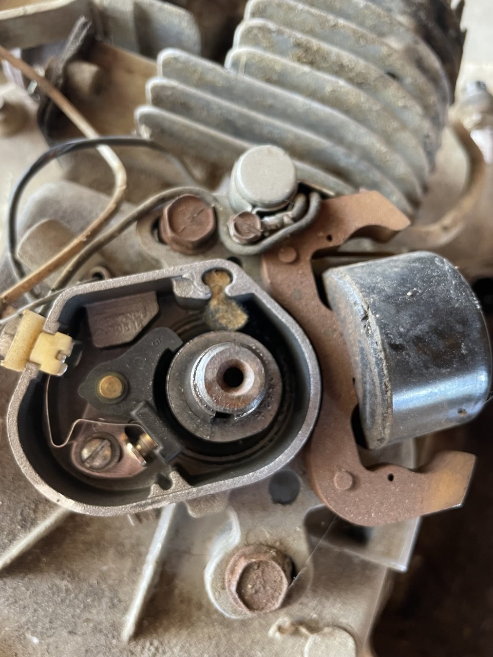

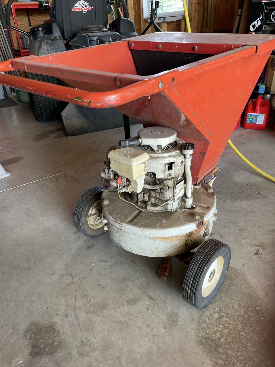

    nice! I picked this one up last week with a “free” sign on it at the end of someone’s driveway. I wasn’t so lucky though. It didn’t seem to have spark so i put a new coil on it tonight and doesn’t seem any different. I cant physically see the spark on the plug but it did shock me a bit but wont fire. Not sure what I’ll try next, if anything.

    Check the flywheel key for partial sheering. Chipper/shredders had issues with this if they jammed quickly.
    Even if the key is just slightly off, it won't run.
