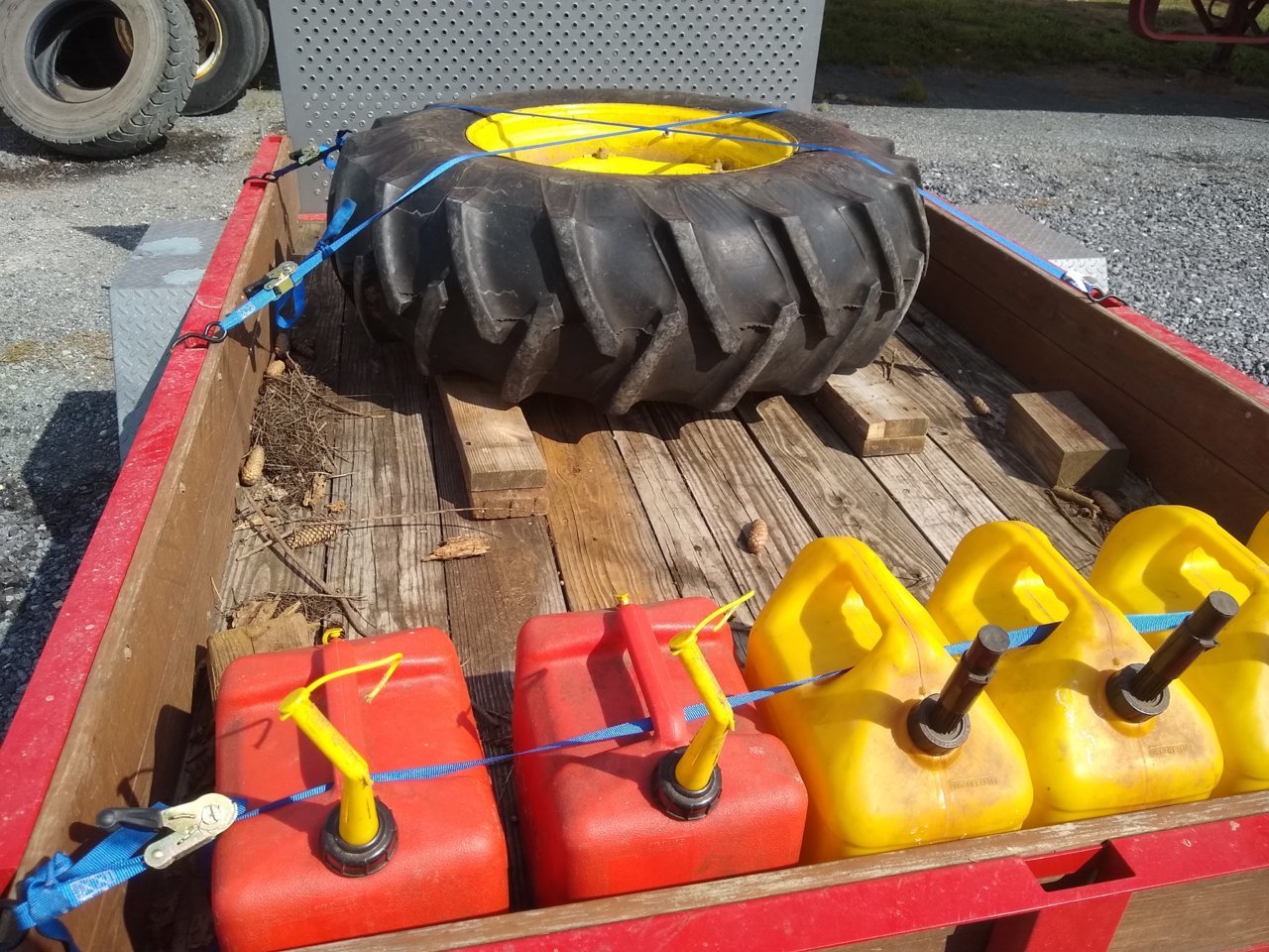

    Morning all. Got the rear tire mounted on the JD yesterday with some help of young guns who showed up @ the cabin. Fed them all with a batch of my chili. Mounted mower, greased and adjusted, changed engine oil. Ready to mow the fields! Then move on to archery season. Happy Sunday all!

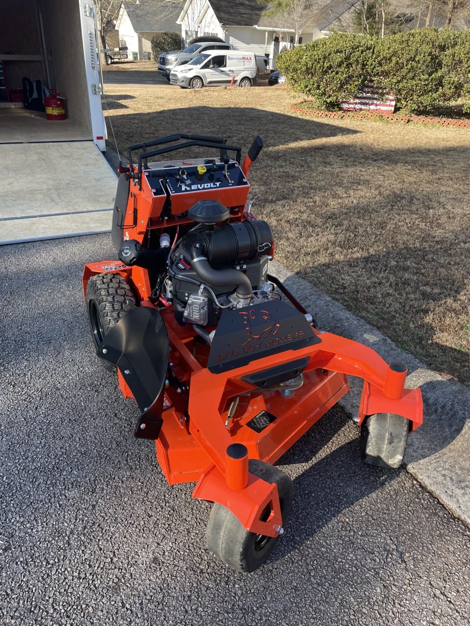

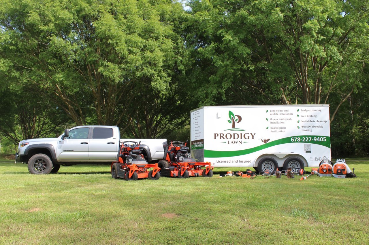

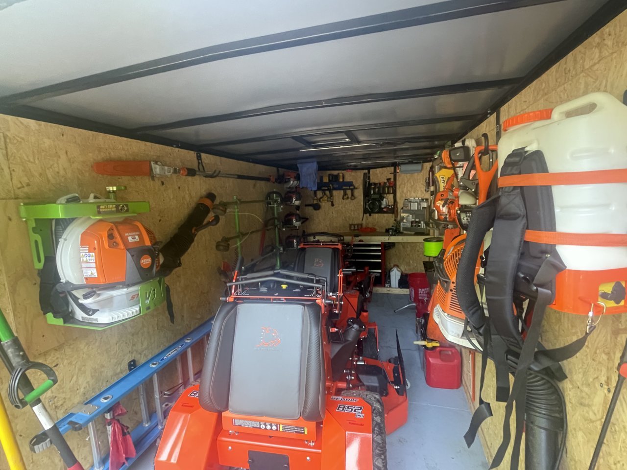

    Good morning folks! Just wanted to throw my setup on here and answer any questions some people may I have…this is my first year on my own running a landscaping company but I have been a landscaper for 11 years now! Running two 2023 BadBoy Revolts, one is a 54 inch deck the other is a 36 inch deck. Both are commercial grade. Both over 50 hours and have ran reliably with no problems.
    E8595F88-0CBC-4AE0-8F88-715EE6D17C02.jpg 884A9AC8-1FFA-4548-8779-B41558BF4DF8.jpg 47EABF01-7FC0-418F-A843-45521785CDC5.jpg CE16CAB3-4C04-4345-AD6B-60C747977359.jpg

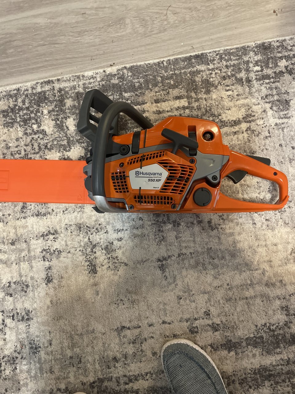

    Man I can’t find any pics of my saw but I’m running a husqy 550XP Mark 2….baddest chainsaw I’ve ever touched and I can’t see myself needing another saw ever…this was the day I got it that’s why she’s so clean lol

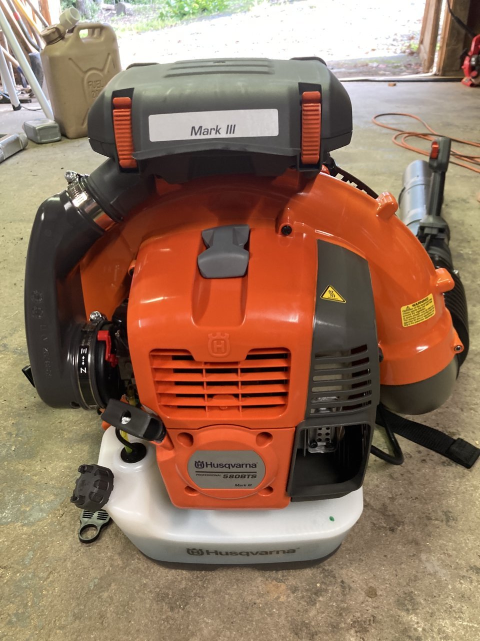

    Leaf season is upon us so I decided I am not messing around this year. I was tempted by the Echo 9010 but couldn’t pass up a husky 580bts on sale for $512. Way better than my crapsman handheld I bought on clearance for $35.

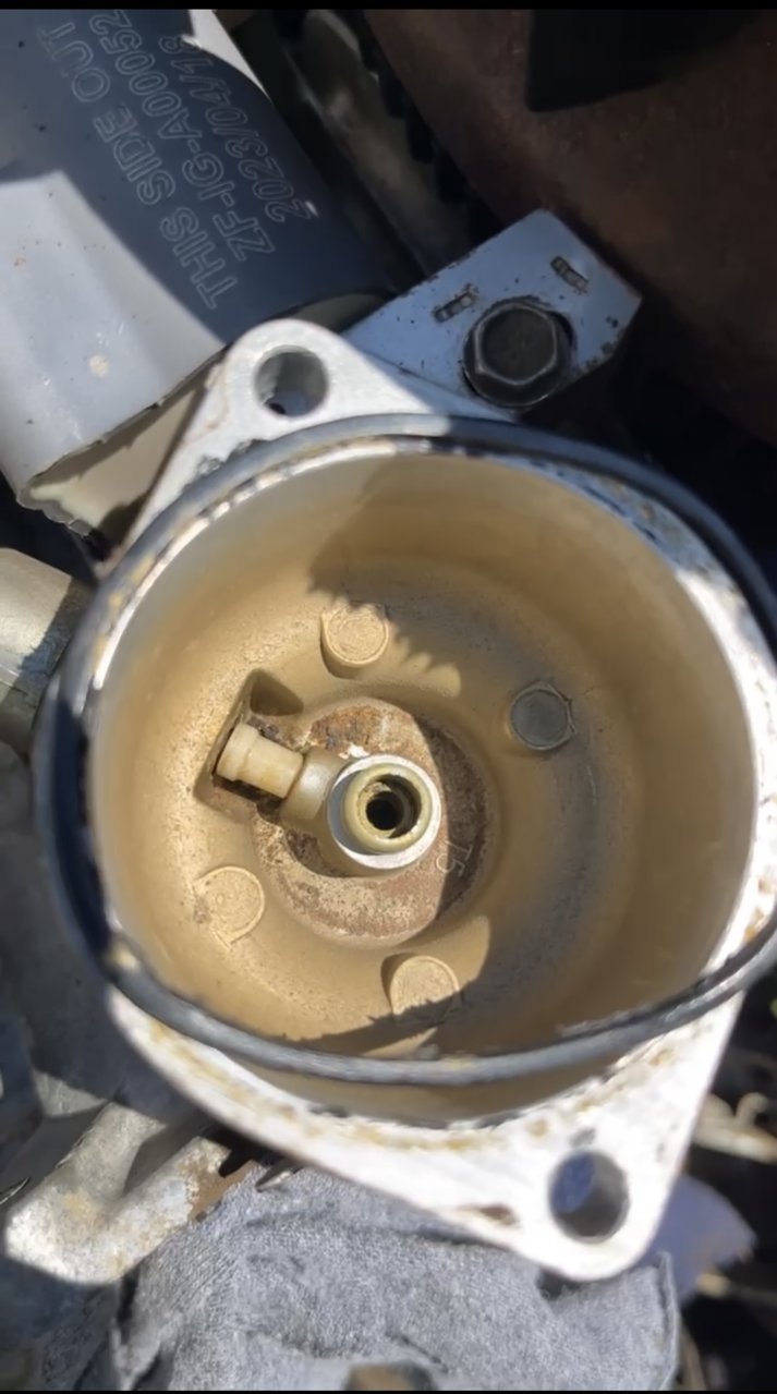

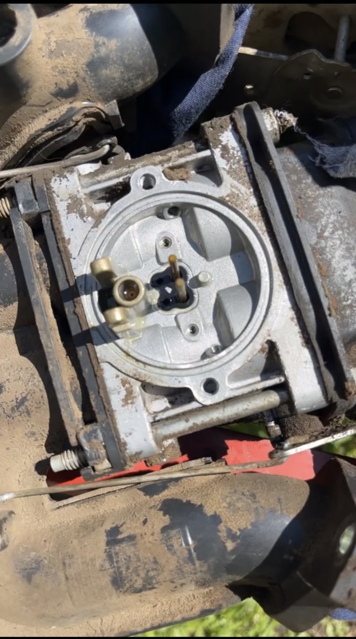

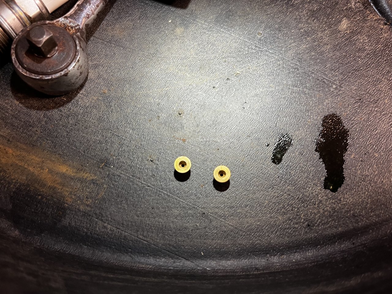

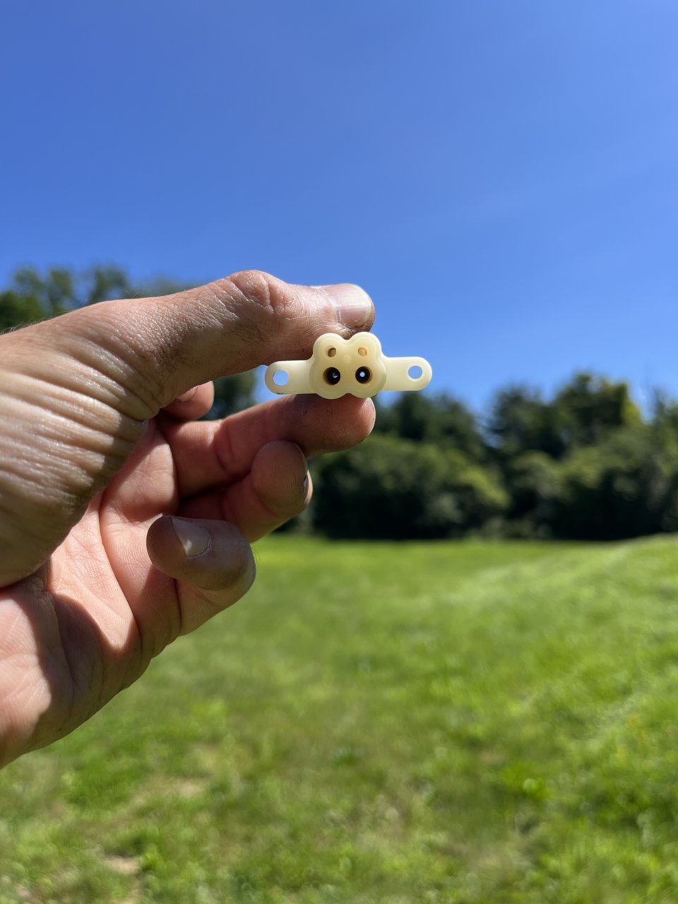

    Update from this: I’m finally at 100%. New plugs made no difference. Spark is hot and coils gapped perfectly. So…
    Pulled the carb off, one jet was 90% plugged, bunch of crap in the bowl. :facepalm: Must have dislodged with use, as it was running well before. Boiled it out with some muriatic acid, the bowl too. (14k gold test solution- if you haven’t tried this it’s AWESOME!)
    Anyway, put it back together, runs *perfect.* Knocked the yard down to 4” from the hayfield it’d become. I’m super happy, got a sharpened set of blades to go on tomorrow, then cut the lawn again at 3.25”. Then next week down to then normal 3”.
