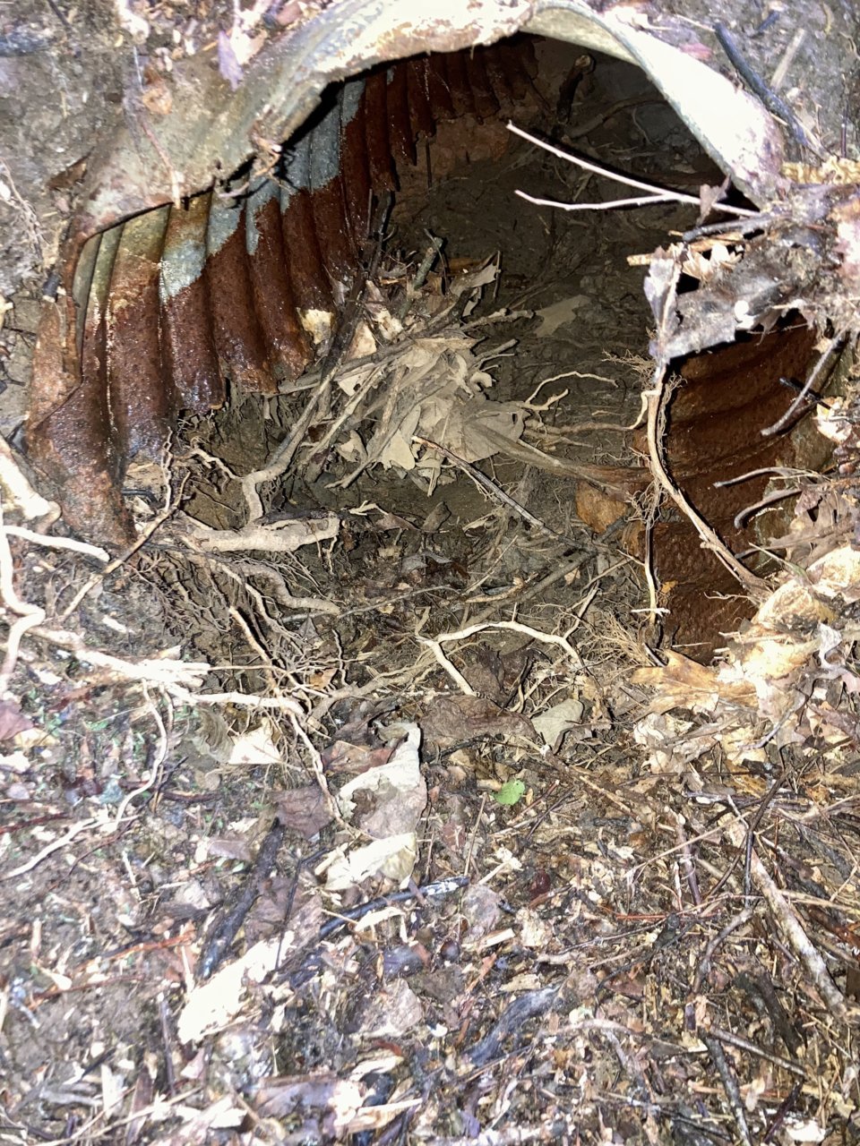

    Any of you guys ever replace a culvert? Noticed mine is failing today. :annoyed:

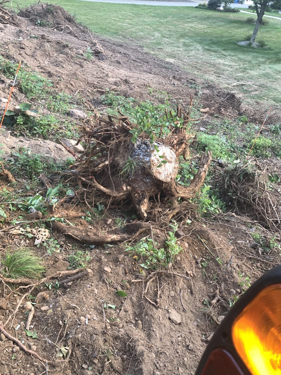

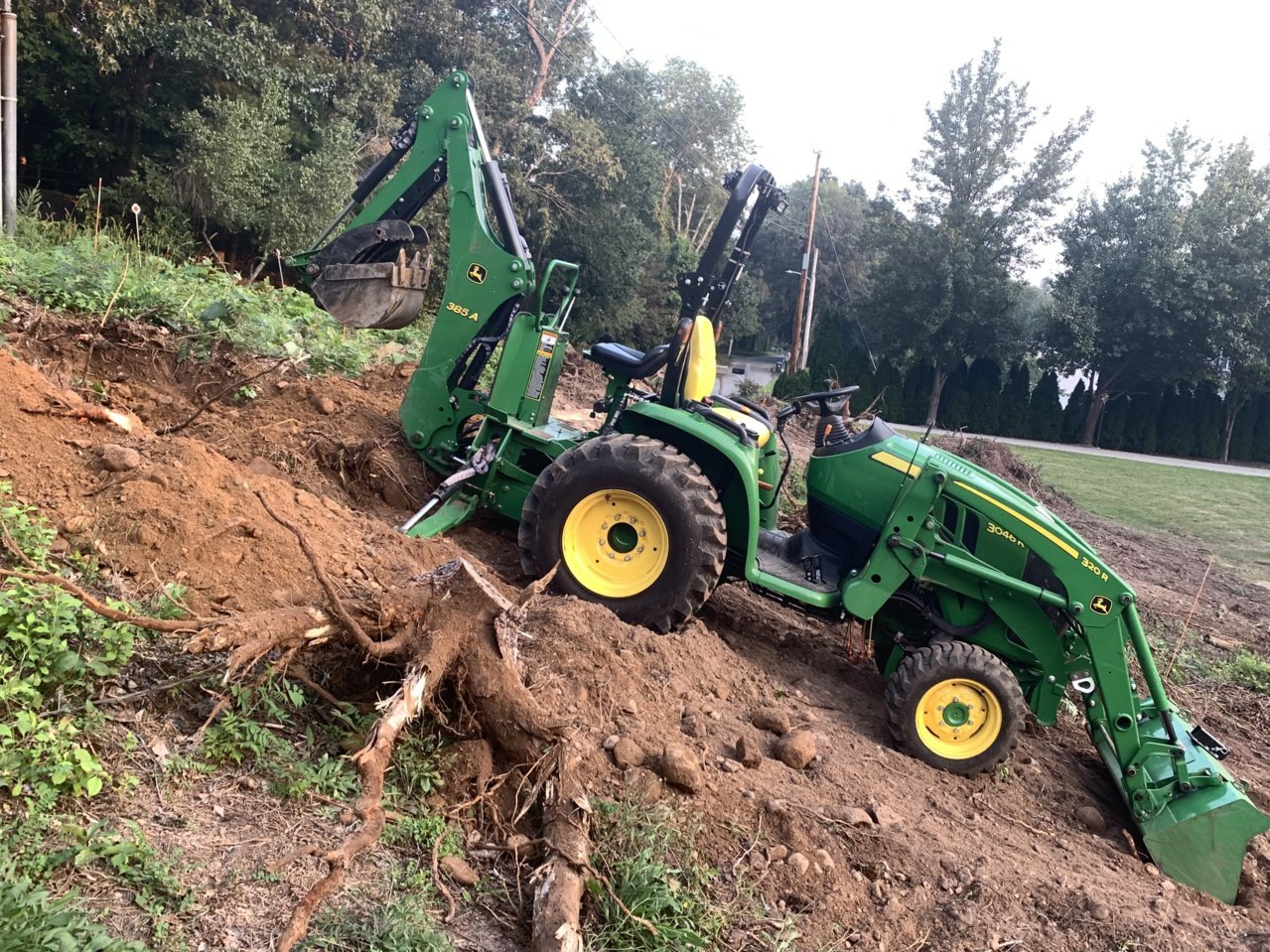

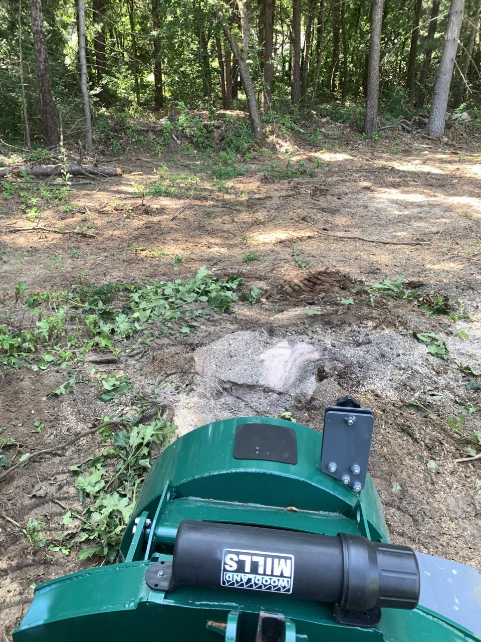

    Few recent projects.
    Stump grinding
    Stump pulling

    Hand shovels :rofl:we shall see how long it lasts, have been wanting to widen the driveway anyways.

    Definitely wouldn’t be by hand :rofl:I have been on the lookout for a bobcat for awhile now and I would rent a back hoe. Was more wondering if anybody has replaced a driveway culvert before and if it’s worth it to just pay somebody since I will have to get cement poured for the driveway itself.

    If thats the case find out what they would charge.
    I put one in with a tractor and bucket. went well just did the fall from high side to low side. If they gotta come out and dig anything with machines when doing concrete, they have probaly done it before.
    Have fun.:thumbsup:

    Definitely have the crew doing the concrete do it if they will. If concrete is going over the top then the material over the culvert replacement will need to be packed down really well to avoid the concrete settling and cracking. Even if you rented a small compactor it might not work well enough to avoid settling. Plus if you do it or someone else does it then if something does happen to the concrete the concrete contractor can claim it wasn't their fault and you are on the hook for the repair. I suspect a culvert replacement is high on the list of PITA jobs. The crew that does it all the time makes it look quick and easy but it will probably be neither.

    That’s one of the best stump grinders made for the price

    its been great for me so far, bought it lightly used from a friend. After replacing the retaining pin on the PTO which just vaporized, its doing a very good job behind the JD.

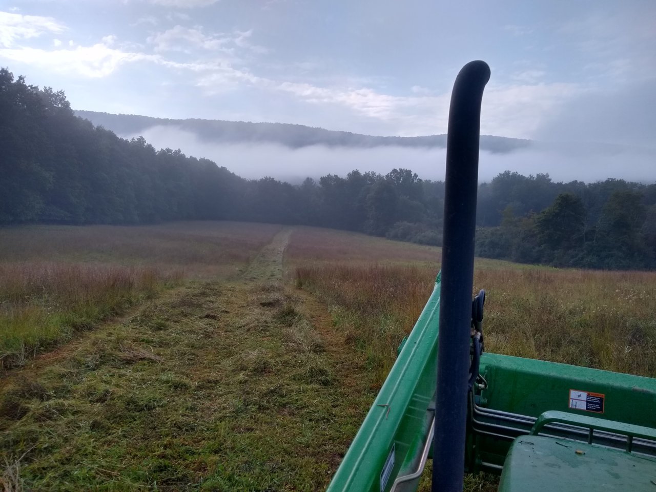

    Yearly mowing has begun

    Great pic!

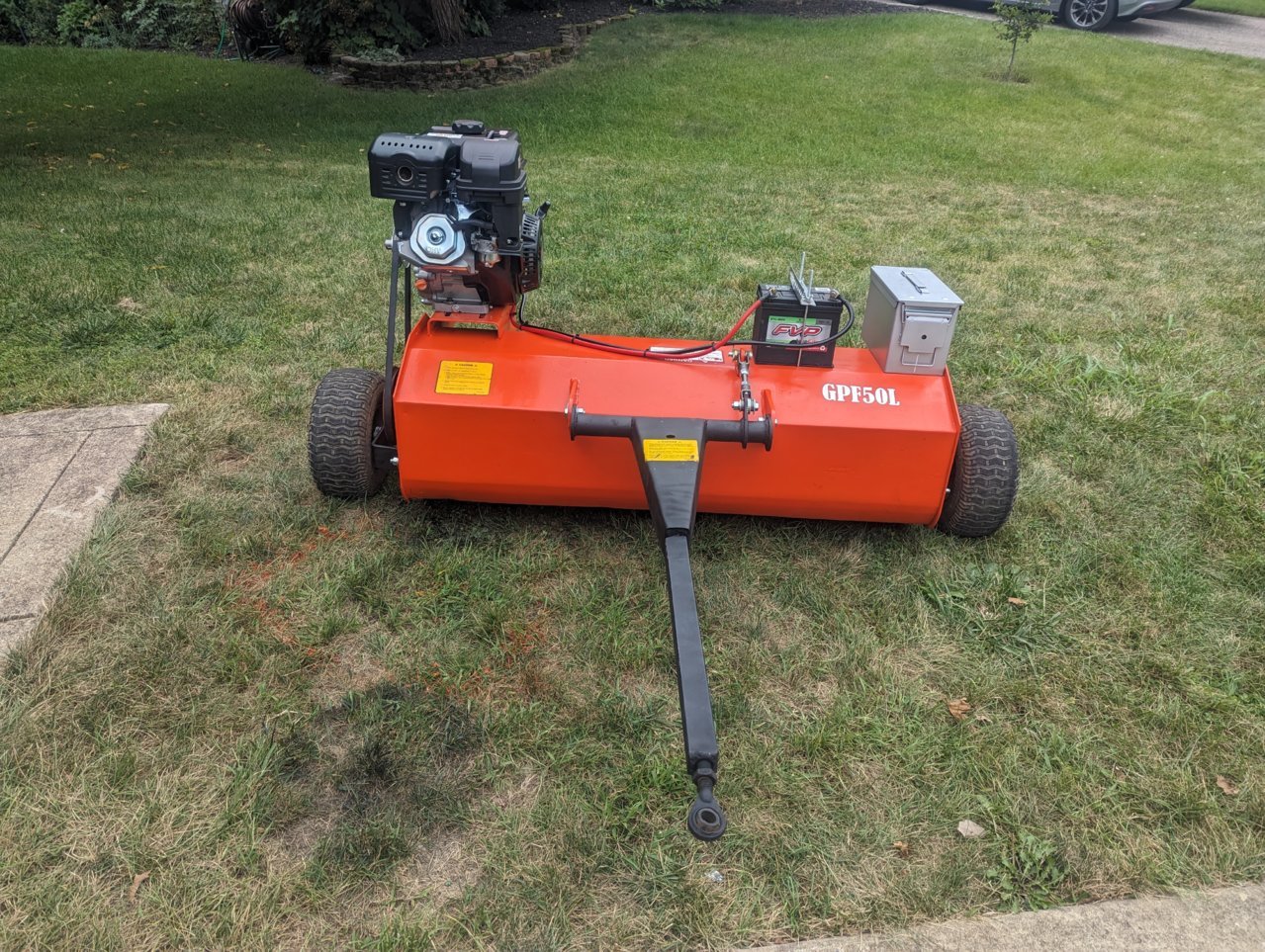

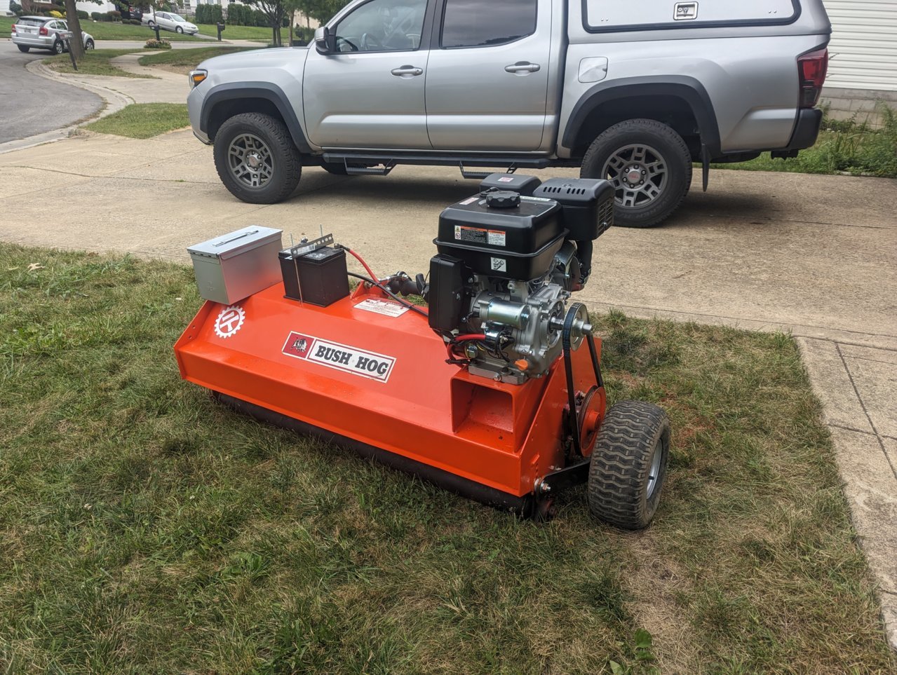

    Finally done with this project. Only thing left to do is use it. Then maybe replace the knives and install an idler and or clutch if need be... Then also make a front mount for my SxS...
    Anyways, pics...

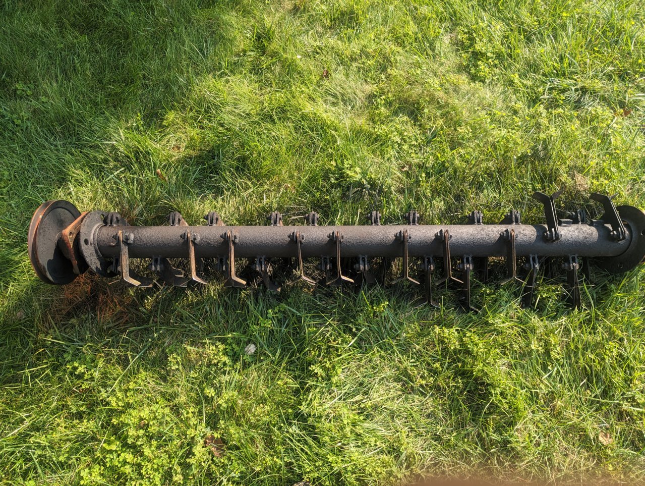

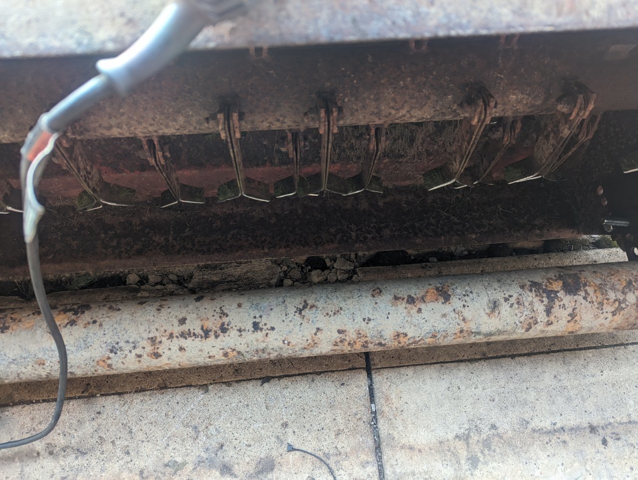

    Started really a couple of weeks ago with the idea to just sharpen the knives and give her a go... There are 80 knives and a light pass with a grinder made short work of the job. Took like maybe 20 minutes total. A few are totally mangled and I used channel locks to straighten them out enough to be passable.

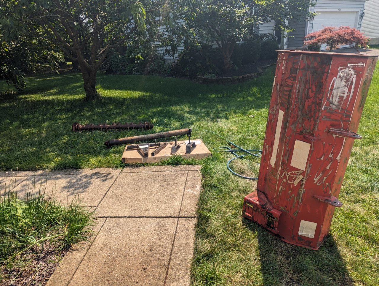

    During the knife sharpening I couldn't help but notice the surface rust everywhere underneath this thing. I was not surprised, but thought since I was already underneath it, why stop with just the knives? I had planned to use it then break it down during the winter, but...Combination of wire wheels and flapper discs to take off all the surface rust. Probably shortened my life by many years, but my Iron levels have never been higher. Surprisingly it all cam right apart. Every single bolt on this thing is a 1/2" and truth be told, there are surprisingly few in total.
    Bush Hog red was replaced with Kubota orange because why not. Also the flail and anti-scalp roller got hit with Rustoleum rust reformer which is exactly what I use on the frame on my truck and seems to work well. Under the case I used John Deere yellow since I had it and it was glossy vs. matte so maybe stuff won't stick under there as bad? Maybe not, but the yellow makes it easy to see under there if need be.
    Just some rust reformer. I expect this stuff to get worn off pretty quickly, but at least I can say I tried.

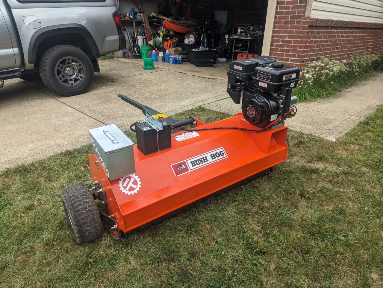

    Reassembled. Eagle eyed viewers will notice the old school Kubota logo haha. Again, why not. I actually taped off all the factory stickers that were in decent shape, so it looks sort of factory still. Predator 420 non-hemi, battery for the electric starter, .50 cal. ammo can onboard tool box.

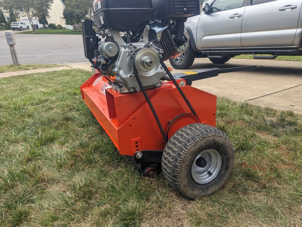

    I mounted the battery over to the otherside as far as I could to disperse the weight on the one side. It was important for me to use lawn tractor front tires for the weight cap, but also incase I have a flat, I can just grab a front of one of the riders at my cabin. Only real issue with the whole deal was the axle on the motorside. On the non motorside, a rider tire fit perfectly. On the motorside, the tire would rub the axle mount since it oddly shaped to fit around the rotor pulley, so the tire hub sat back for the end of the axle stub by only about 1/8" once shimmed with 3/4" washers. I ended up drilling and tapping a 1/4" tap into the end of the axle stub and simply have washers held on by a bolt. The other axle stub has your traditional cotter pin/washer setup. I'm curious to see if this method will hold up, I can't see why not as the wheel rested fully on the axle stub, just covering the cotter pin hole requiring modification. I honestly just didn't feel like reworking the one axle since I ultimately plan on front mounting this thing anyways. Or just lazy...
    So originally it was a Bush Hog GPF50, I rebranded it as a GPF50L. What's the L for you ask? Limited. What makes it a Limited? The metallic wheels and metallic Toolbox of course...
    Here you can see the extended tongue I made. I simply used some square tube and a 3/4"nut and bolt so I gould thread it on if needed and remove it if not needed. The tongue on this thing is crazy short so backing up and turning with a SxS in stock form was impossible. It warped a bit and looks wonky, but I figure a slight offset won't matter much where I mow anyways. The extension is just a square threaded rod and is not attached all the way in the pics.
    Sorry for the novel, just really excited about this one. I hope to get it out next weekend and see how it goes.
    I'm pretty sure knives are the next task on this thing.
