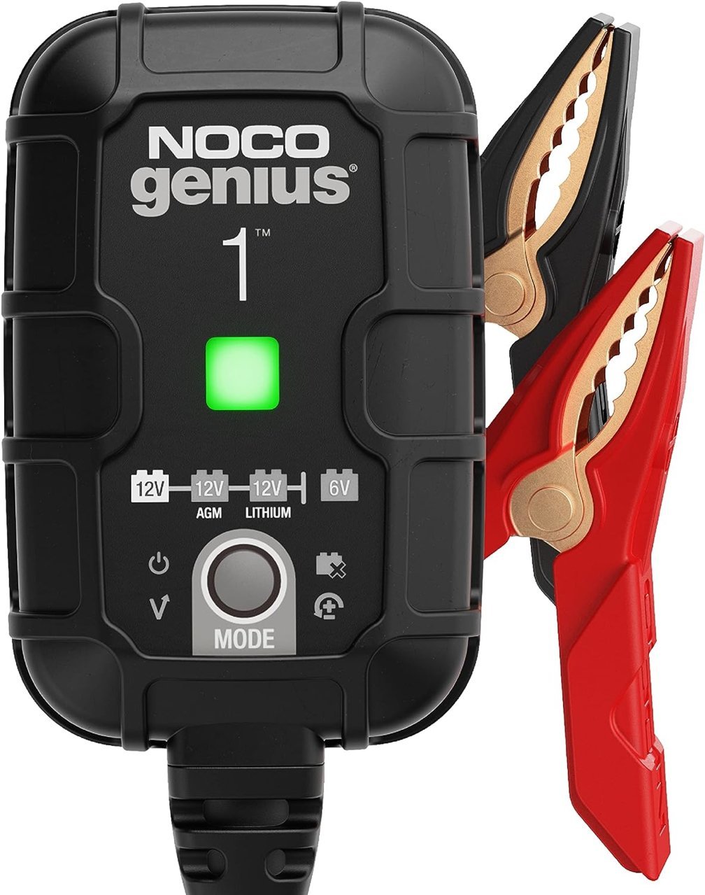

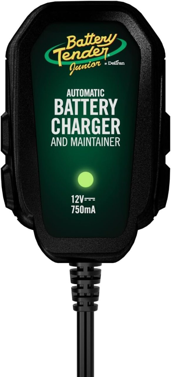

    1) Treat the last gas of the season with a stabilizer product.

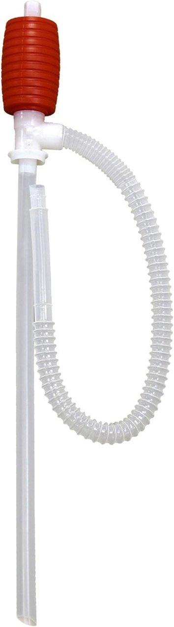

    2) Run all the gas out of the machine, a kerosene siphon is useful to remove the bulk of the fuel from the tank.
    3) Remove the battery and store it in a cool, dry & above freezing location.
    4) Hook the battery to a small tender, Deltran Battery Tender and NOCO Genius 1 are two very good units.
    The smallest one is excellent for a mower battery, either will be around $35. The Battery Tender is simpler, the NOCO has more functions. I have been using both of these for years, they really work - the battery on one of my mowers is from 2016, I top up the water every spring & fall.
    Spend the extra few dollars for either of the brands above, there is a good bit of tech in these little chargers and they are the leaders -- this isn't an item to get at Harbor Freight.
    You can get them on AMZ or your local auto parts store or The Mart.
    These are really handy to have around for emptying mower tanks, clogged sinks, etc.

    Those NOCO chargers that do the desulfation are really nice for recovering a spent battery. The battery on the Miller propane welder was completely spanked. We ordered one of those chargers and low and behold it recovered it. I hard wired it to the unit itself so you just plug it in when you get done. It hardly ever gets used, but nice that it'll fire right up now.
