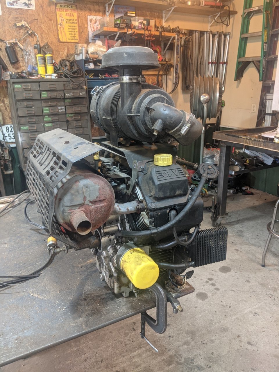

    Soooo? I picked up this ZT Toro unit early this summer. Bad hydro system and rusty deck, good running Kohler 25, with a bad oil leak.

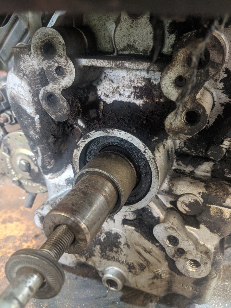

    I found the crankshaft end to have a cockeyed seal.
    Asking for a friend...if one was to remove the seal from a parts engine and installed it the oil leaking engine...is this possible and how long would I, er I mean my friend, be shunned?

    Pretty sure a pressure washer. The location of the side pushed corresponds to direct access for the water stream.
    I found high crank case pressure issues, that just pushes out a side of the rubber on the seal.
    Just to clarify, the seals are not seated completely in the case, they are about 3/8" of an inch from being pushed in as far a they can go. There is a hole that drains the oil circling the crank end.

    It is only a 5 minute job. These horizontal shaft engines are really easy access.
    1 bolt releases the clutch.
    1 sheet metal screw into the seal body and pry out the one seal with a claw hammer.
    Grease up new seal and carefully tap in place with the same claw hammer.
    Install clutch and clutch bolt.
    I'm just curious if that part is as good used as new.
    And yes, I know it's $7 at Napa, 8 minutes away.
    We will know right away if this experiment was a failure.

    Yep, they do. I added form a gasket sealer to the outside of this seal to insure it did not leak around the outer perimeter.
    I want know if this used seal has any life in it. A 1500 hour engine is just the motor to practice on.
    I'm betting something else goes before this seal starts leaking.
    Just to help those that aren't aware of these Kohler Command engines:
    They were built with a horizontal crankshaft or a vertical crankshaft.
    Both styles are very similar with many shared parts.
    The horizontal pto side of the engine is called the engine block cover.
    The vertical shaft version is called the block base pan. I know, just what we need, more confusion.
