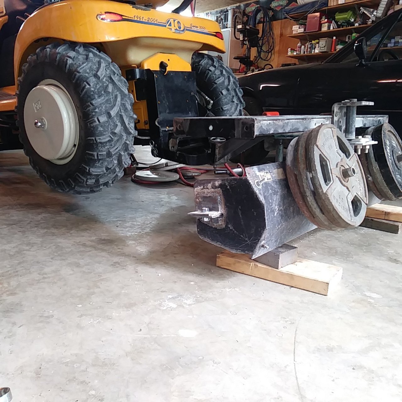

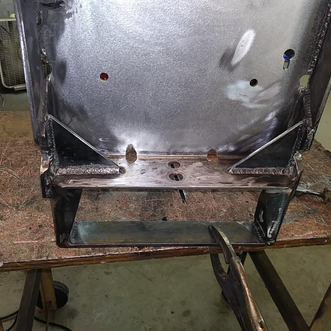

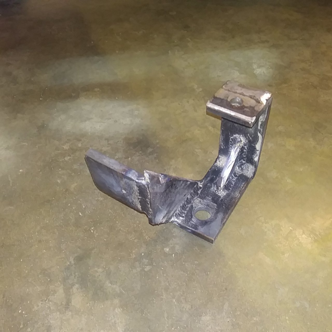

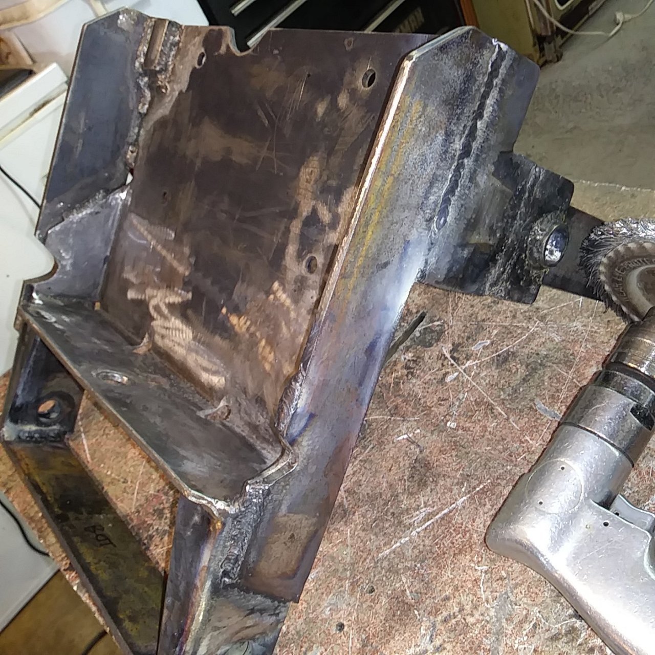

    I haven't posted my results with the new sleeve hitch cylinder because it was not working right. It would only lift 250lbs. Tiny old cylinder would lift 180lbs.
    So I put it away tired and frustrated. Fresh eyes let me see the problem. The pull side of the hitch was getting torqued forward 3" by the cylinder before it lifted, binding it up.
    Saturday I pulled the hitch off and reamed the 5/8" holes to 3/4" then replaced the 2 bolts with a solid shaft. Drilled and tapped the arms for zerks. It lifted 320lbs right away even still torquing the bottom of the hitch forward. It'll probably lift a bit more after more reinforcement.
    It will now lift the implements 16" higher than before.
    Fabbed a cylinder to frame mount out of 3/8"x2". Bolts to frame and axle and cylinder pins thru it and into the frame and hitch with a 3/4" pin. Axle bolt hole is punch marked but not drilled yet in this pic--bottom left side.
    Zerks in the arms

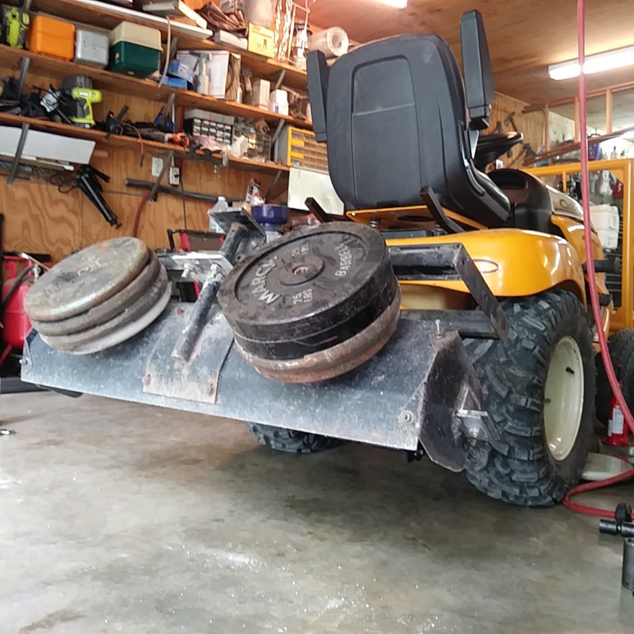

    100lb box blade with (8) 25lb plates and (2) 10lbs sitting inside the box
    It will easily lift itself
    I pulled my sleeve hitch off yesterday and shored it up. Hope I dont have to mess with it again.

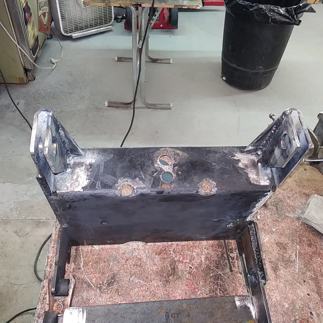

    Welded steel to 4 different places on it and got the slow drying Majic paint on it. Hopefully it'll be dry by the time I get the lift part of it done today. I'll paint it Lowe's Project Source black and it'll be dry in 15 minutes.
    Doubled the pivot pin contact area.
    Connected the two sides of the bottom with 1/4"
    Right side 1/4" top to bottom.
    Bottom to side gussets

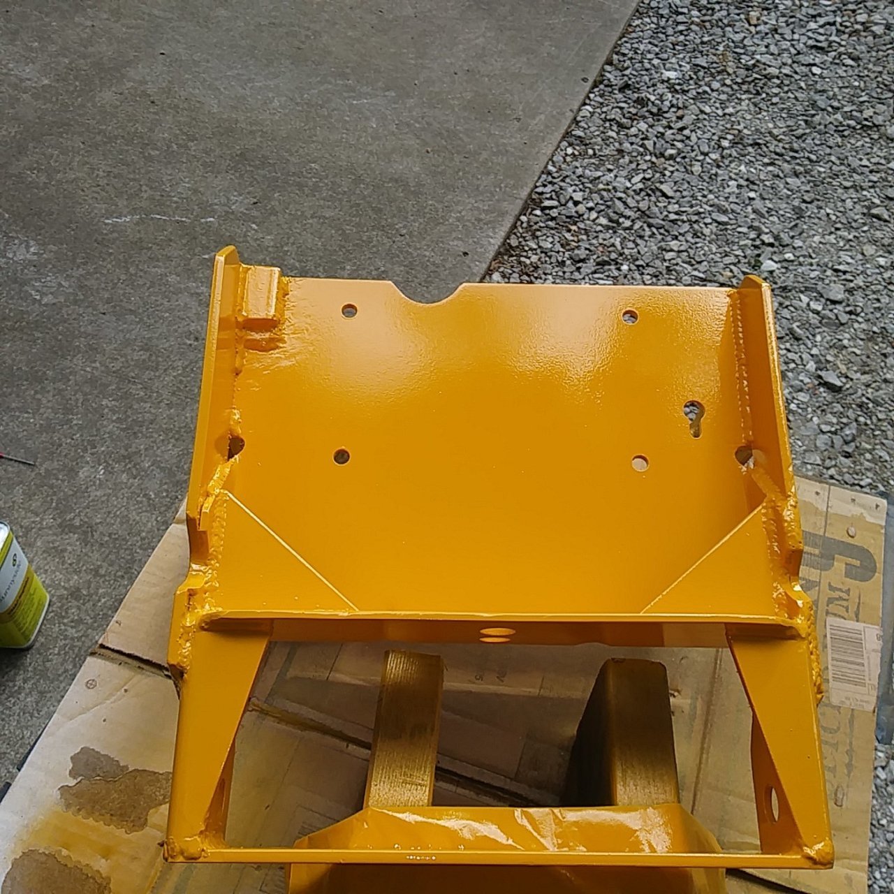

    Before welding I stripped the paint because it had a dry spot that wouldn't take paint the first time I painted it. After stripping I scrubbed it with hot purple degreaser followed by a wipe with acetone then naptha. Painted with Cub Cadet Majic paint from TSC. It's Magic because it magically never dries--alkyd enamel.
    Me after fabbing and welding in 90deg heat for the last few days.

    Looks great! You have that little machine doing way more than most would even attempt, wonder what it weighs like it sits?
    And that Majic paint, I tried it once. It's like melting a crayon in hot water and hoping for the best :rofl:

    Thanks man. That Majic is sadly the best paint match in a rattle can. I may pick up some Duplicolor School bus yellow. I heard it may be close.
    Tractor=800lbs
    Front Loader with cylinders and front hitch=250
    Rear hitch with cylinder=50lbs
    Wheel weights=200lbs
    Box blade 100lbs, with 200lbs weights=300lbs
    Total: 1600lbs

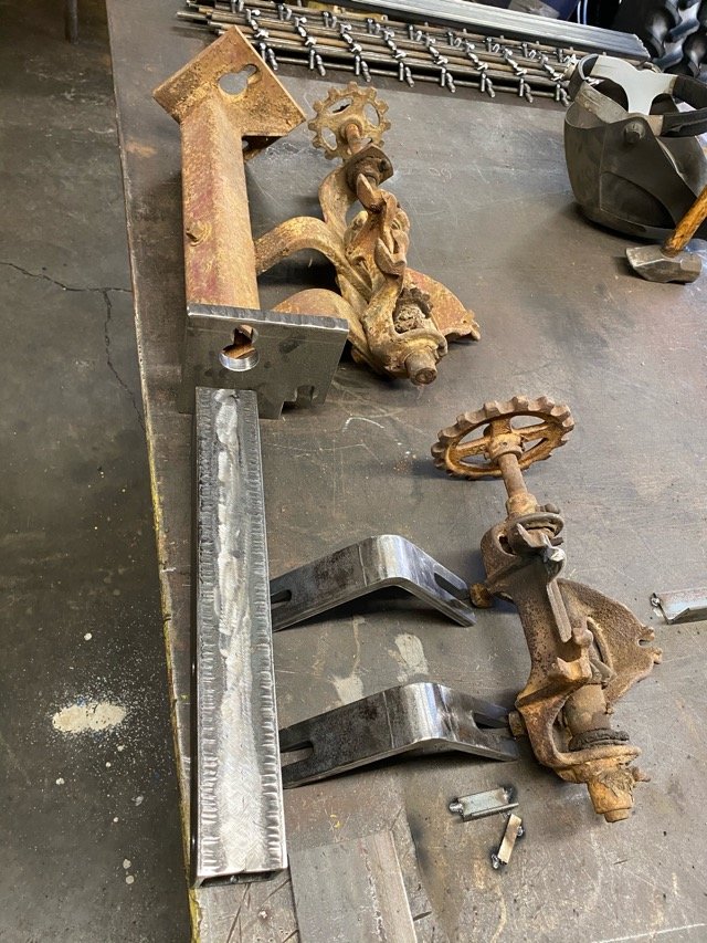

    Been duplicating this side dresser for a 140. I had an extra bracket the hopper goes on and said why not?
  17. Jul 1, 2020 at 8:01 AM
    #1117
    shaeff
    shaeff Roaming Around
    May 22, 2016
    #187639
    581
    Hudson Valley, NY
    '07 DCSB SR5 6MT 4x4
    Do I remember you saying you're a welder by trade? Either way, beautiful work!

    Here's my hitch working. Gonna make a slotted plate tomorrow to allow for float.
