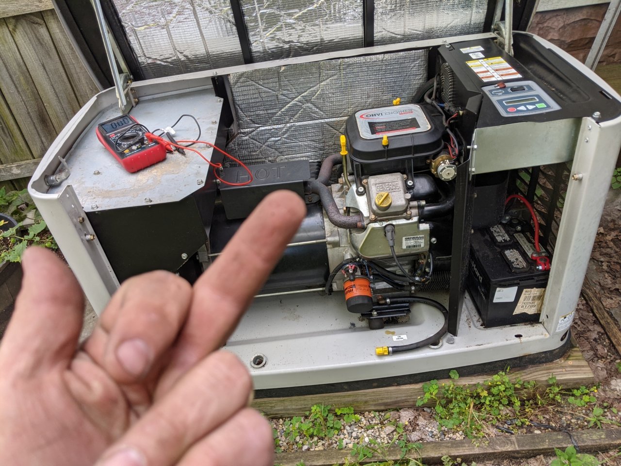

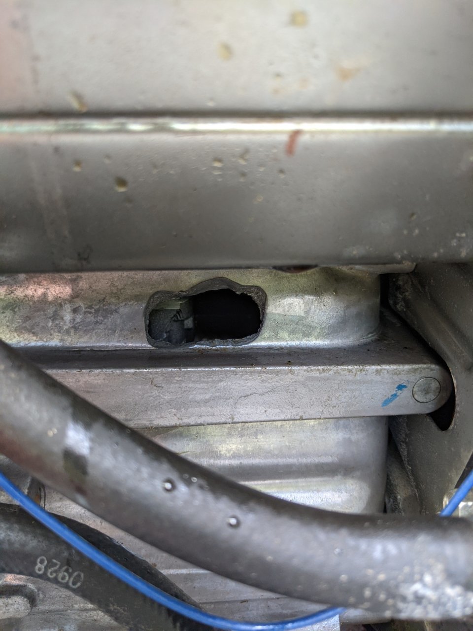

    Found a replacement engine for the generator. $700 down the drain.
    Hopefully I can get it changed in the spring.
    I am curious to do an autopsy on the bad engine.

    We have a local Generator install company here. They sell replaced units/parts that were warrantied out by Generac.
    It's quicker for them to just swap out an entire gen set, then they can sell the good parts after a waiting period.
    This one had bad windings in the generator head, but the engine was fine.
    At least it doesn't have hole in the block.
