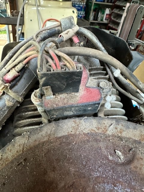

    I just talked to a friend of mine who works for J.D. and told him what my mower is doing, he said it has 2 coils and one is breaking down when it gets hot and causing it to not run right, I have a spare engine with 2 coils so I'm gonna swap them out and let Cole mow and see what happens.

    Does this engine have the spark advanced modules? Yeah, Kohler would replace them with regular coils.

    Don't need to pull the cover. It's mounted into the surface of the cover. A box about half the size of a pack of smokes.

    So I don't need to swap these? It's the little silver box with the wires in it mounted to the cover?
    I was going to swap those with the spare engine but it has 3 wires instead of 2.
    After I realized that Cole got the 1960 something 110 out and got half the yard mowed :D

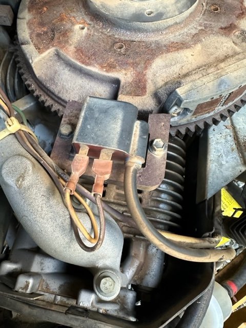

    The second pic shows an engine that has a spark advanced module. Those engines were problematic. They did get you a little more power.
    Kohler gas a new coil kit that eliminates the SAM and uses normal coils.
    Notice the red wire? It goes to the battery. It really confused me the 1st time I saw one. I was taught that you never want 12v+ going to a coil. 12v+ will burn up a coil, but not with these spark advanced modules engines.

    May be why the guy gave it to me, lol. It also has no compression. I can spin it by hand with the plugs in.

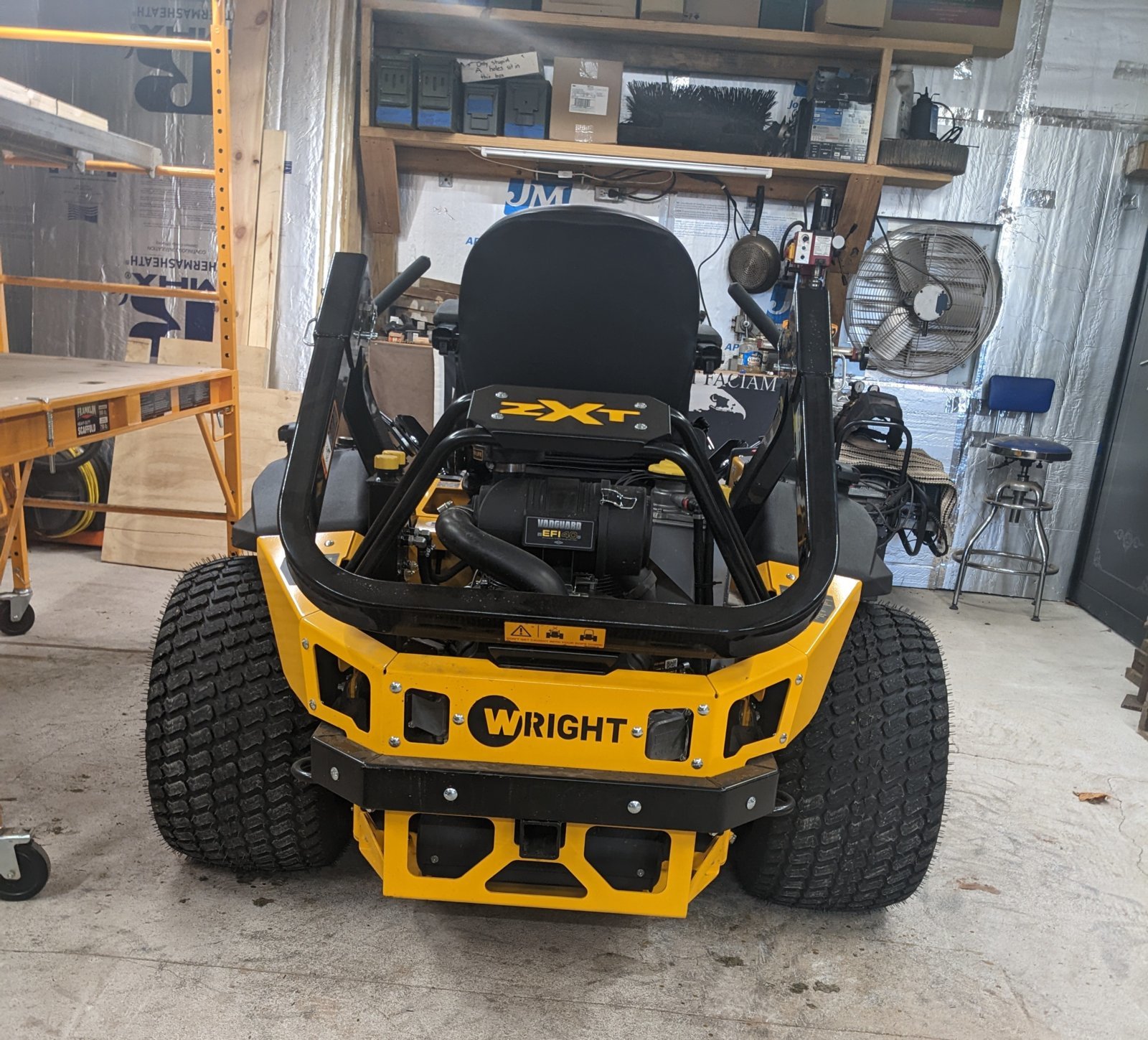

    ok for you mower fiends: lets talk blades.
    any recommendations ? whats everybody running?
    im not a striper or grass nazi. just mow & its a rough farm yard. want good lift & blow out. the factory blades dont seem to hold an edge for long & seem pretty soft.
    61" Wright ZXT is my mower.
