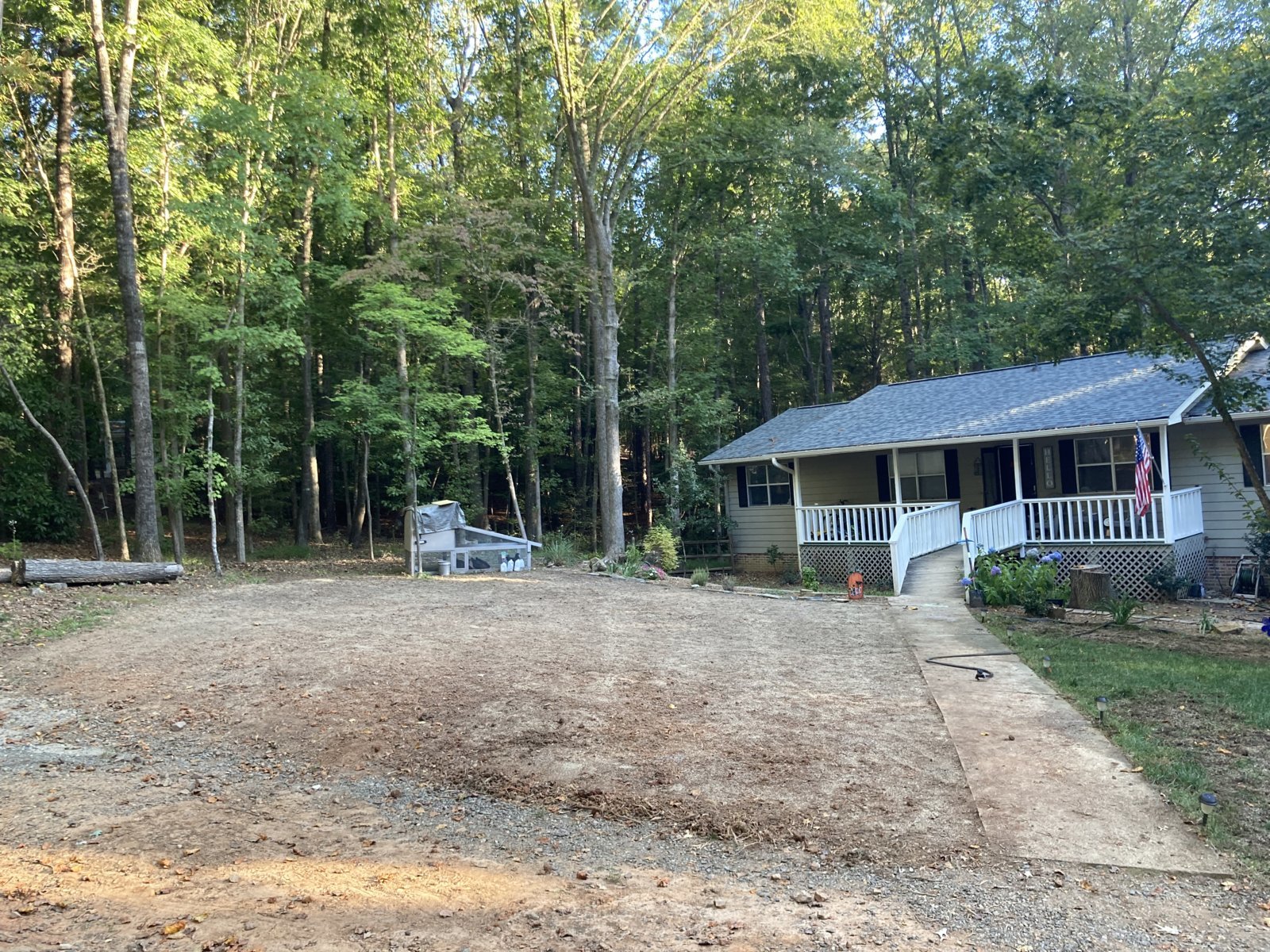

    I need a tractor… put the little tiller and stump grinder to use over the weekend. Removed a lot of roots and stumps from the front yard to prepare for seed.

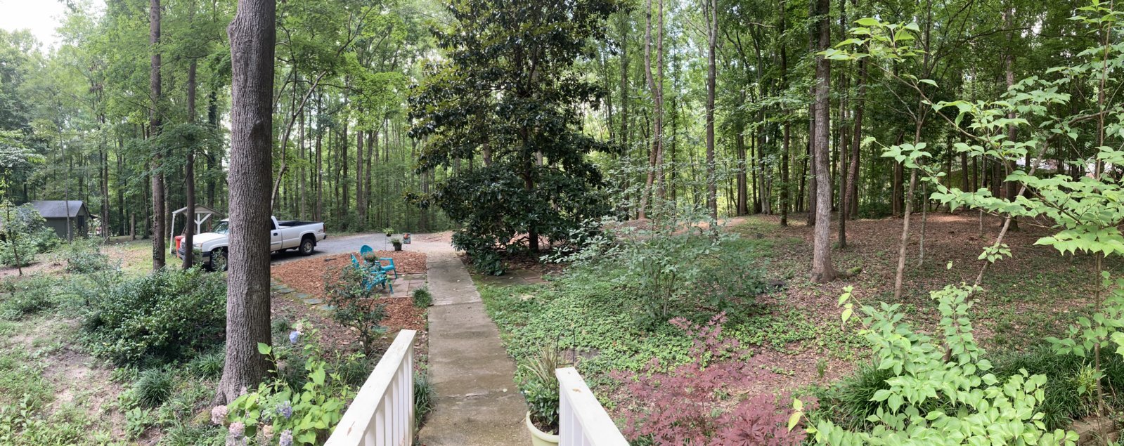

    Found a picture of what it looked like 3 years ago.

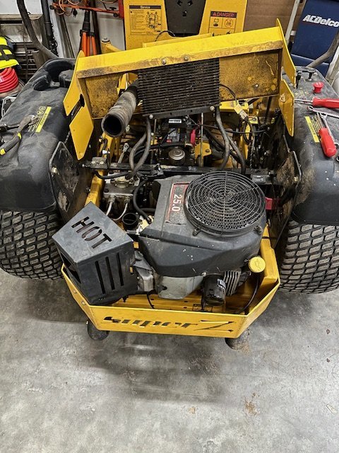

    Coils came in Friday, got them on and cranked right up. Cole mowed the whole yard without a hiccup.
    Saturday after his baseball game I told him to get the mower and mow again to see if it was okay. Right out of the shed it was doing the exact same thing as before the new coils. I'm at a loss on this thing. New fuel pump, carb, and now coils. One day it's fine, one day it's not :frusty:

    It's got to be something ocking the fuel. Debris partially blocking the fuel line, bad check valve in the fuel line? Vacuum line to the fuel line cracked?
    This problem is bothering me as much as it's irritating you.

    I replaced all the fuel lines, valve that switches between the tanks, pulse line going to fuel pump, etc. I may have gotten a bad valve is the only thing I can figure.

    Can you grab some extra fuel line then run it directly to a small gas can? Eliminate the onboard tanks for testing purposes.

    as a long time Hustler owner/runner was gonna suggest that you empty & clean out both tanks. make sure the goo is out of them & that its not making a flap on the inlet.
    farther down the road: if you havent changed ALL the rubber? do so! those hoses get a flapper in them sometimes.
    someone else already mentioned that you should run it off a different can of fuel for a bit. thats a great idea. run the supply hose straight from a can of fuel & if the problem is gone? you know its in the tanks/lines.
    you said you put on a new carb... but even new ones can have sticky floats. it happens a lot.

    That new carb wasn't running up to par so I took it back off after running it a little bit and put the original back on, ran great...until Saturday.

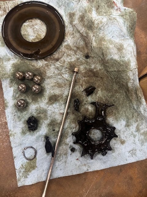

    I got home yesterday and trimmed a few trees back and it started raining so I decided to tear into this one that started running away......
    Drained the oil and turned it over to pull the base off and I heard some rattling inside.
    Just as I suspected, the governor came apart. Found all 6 balls, not sure where the rest of the plastic is.
    This is the 1st Kawasaki I've ever been in, got on partstree.com and ordered the governor piece, crankshaft seal, governor shaft seal, and base gasket for $82 and change. The base gasket was $45.99, the governor piece was $5.99 :facepalm: Now if I can just get it back together.

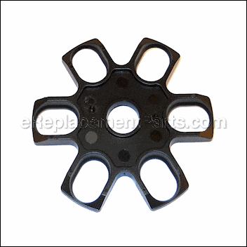

    This is what the piece is supposed to look like :rolleyes:
