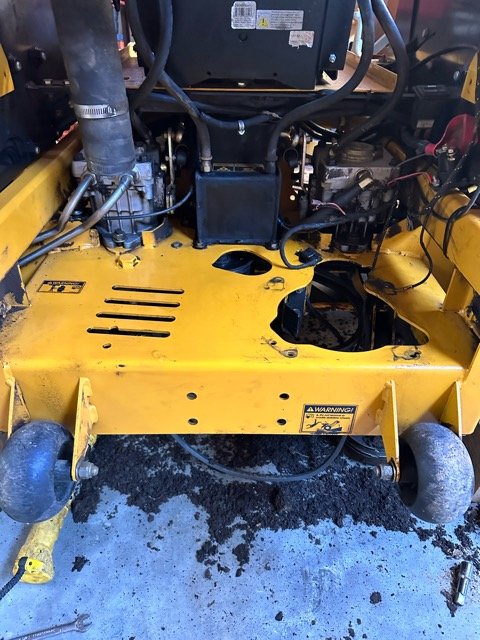

    Reserected from the dead.
    Installed the mulching kit this morning. I am ready for those leaves!

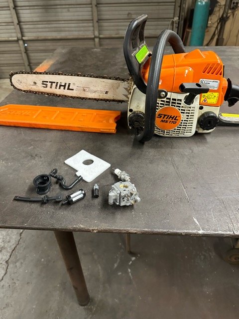

    All cleaned up and ready for new parts which should beat me to the house this afternoon.

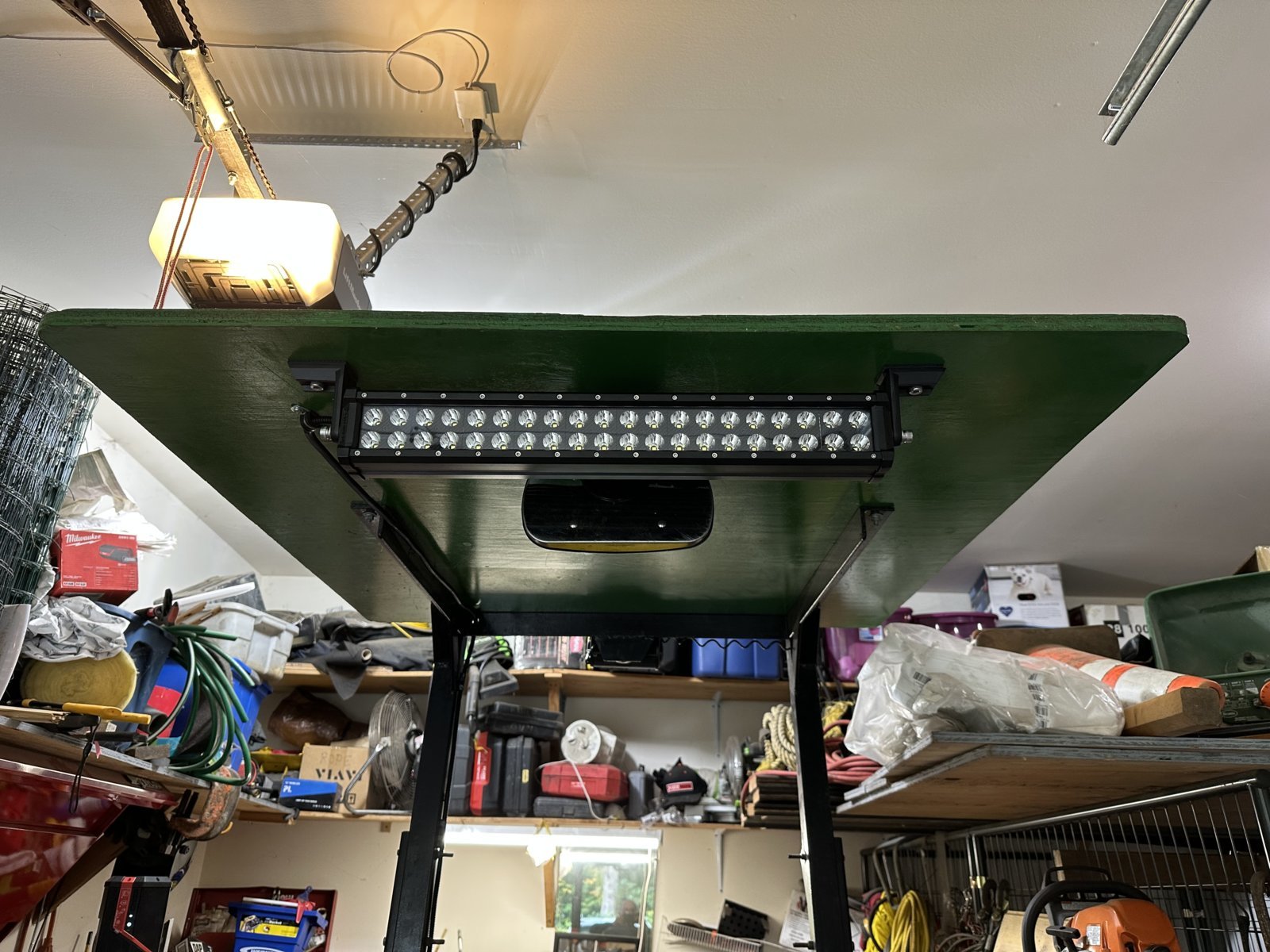

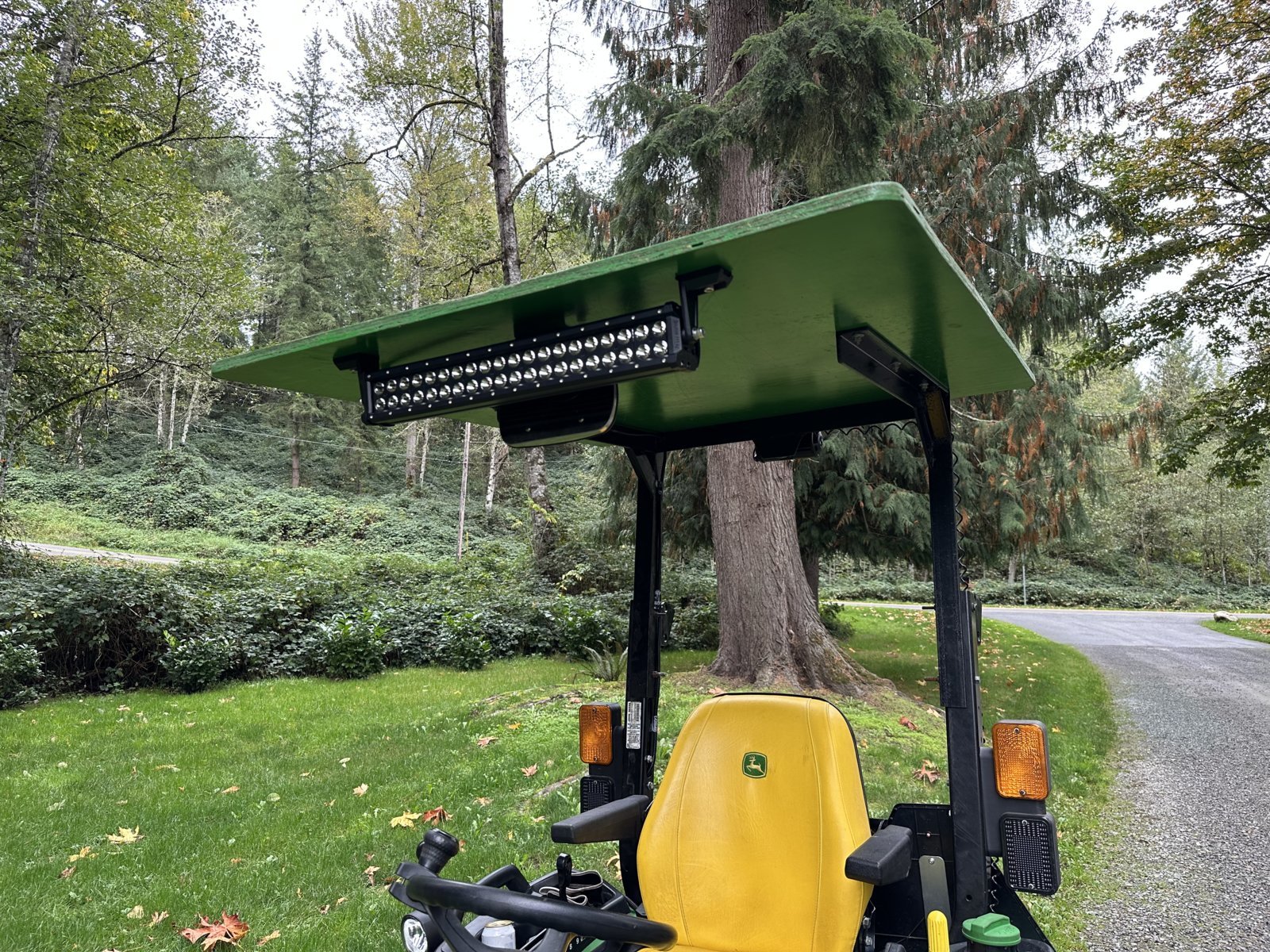

    LED light bar installed

    those can be so useless on trucks but that looks great on that rig! what part of western wa?

    I was hoping to get this back together Friday evening, UPS dropped the ball. 1st time they've ever done that to me and it makes me mad because I had the option to use USPS or UPS, I paid an extra dollar for UPS. It said it was out for delivery by 7 p.m., at 7:32 it changed to today :annoyed:

    This will be the 3rd carb in 15 years on this one. I run the same gas from the same can with the same stabilizer in both Stihl’s and the Husqvarna. The other Stihl and husky haven’t been touched, the husky was bought in 1994.

    Look what came yesterday, hopefully I can get it back together this evening.
    This is what the piece is supposed to look like.

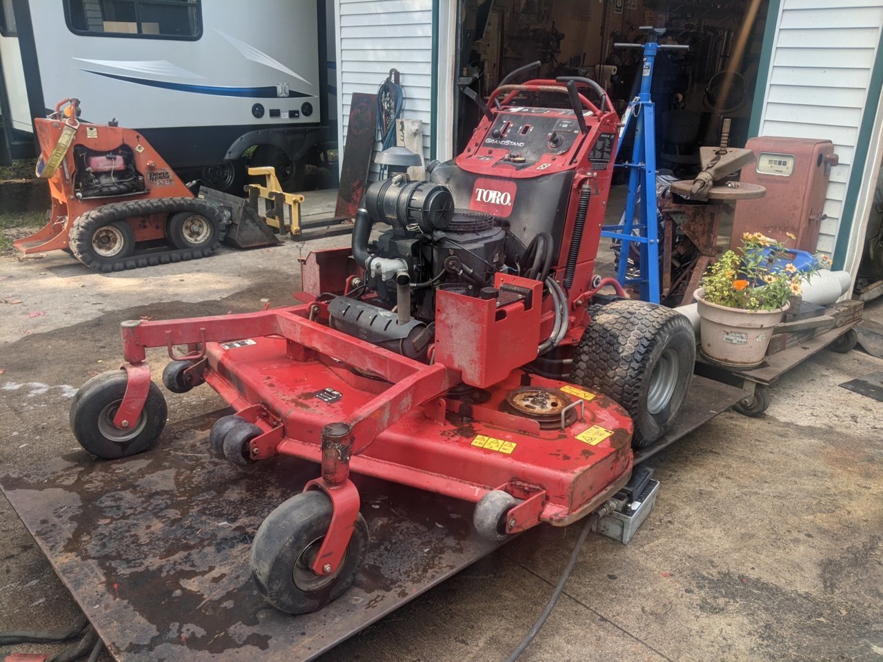

    Head gasket time. I'll change them both to be safe.
    Hope to have it tore down by 11.

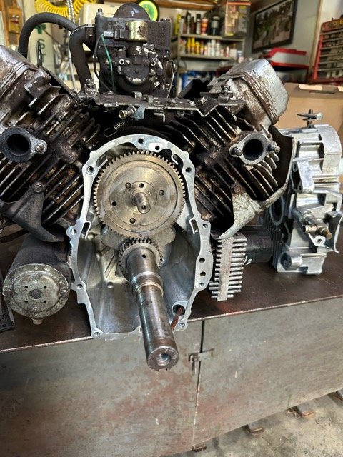

    It ain't head gasket problems...
    Was turning the flywheel by hand and thought that it turned kind of easy for having both plugs in place.
    Probed the pistons with a long screwdriver after removing the plugs.
    Only 1 piston was moving as I rotated the flywheel!:facepalm:
    Yep, broke connecting rod.:angrygirl:
    The oil was extremely discolored. There was a huge amount of water in the crank case that was not imulsified. This engine had water intrusion to a heavy degree. I'm wondering if it was hydrolocked.
    The carnage sure indicates that may have been the case.

    I've never seen a piston in the jug sideways!
    Anyone need any 25hp parts?
    This block is faqued!
