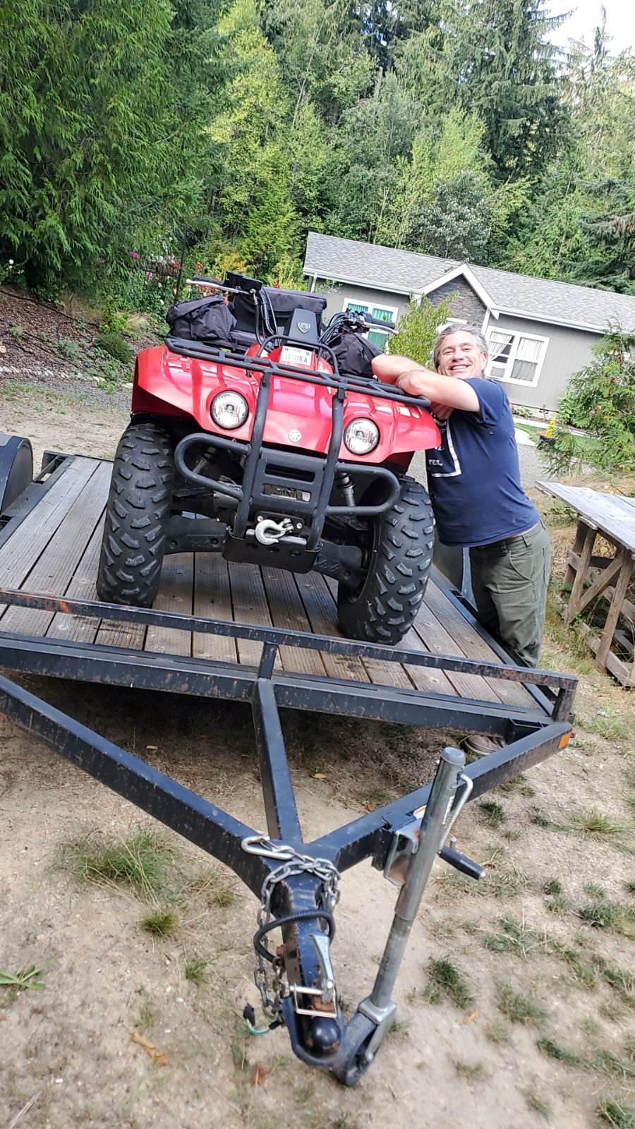

    i just got this with my farm quad. iron eagle 6.5x10 havent even used it. got it for 1k and new is 3k+ . forget the retard in the pic. as i dunno nor care to eliminate my mug from things. i waited 37 years to have this toy. been a jaw dropping beast thus far.

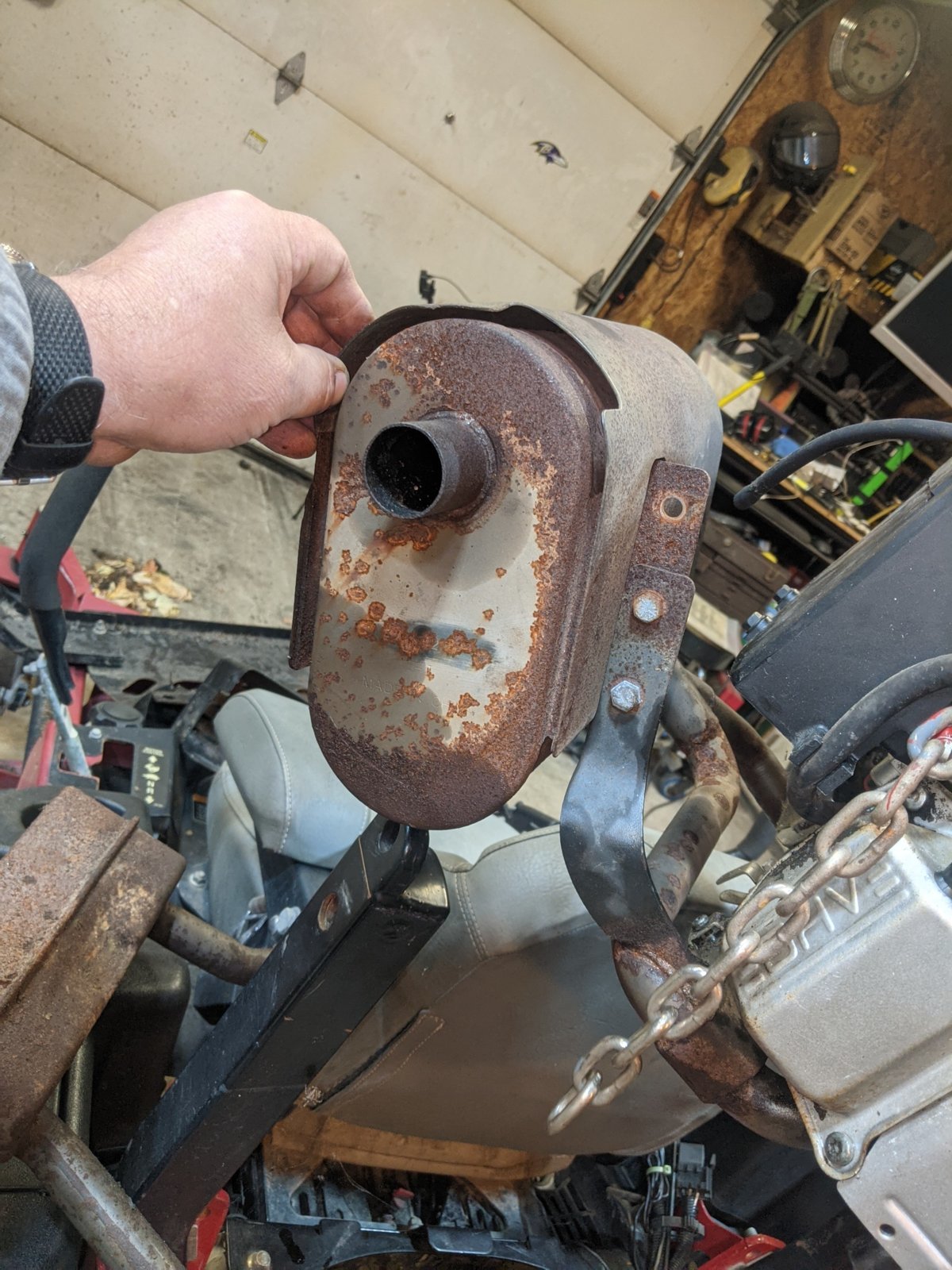

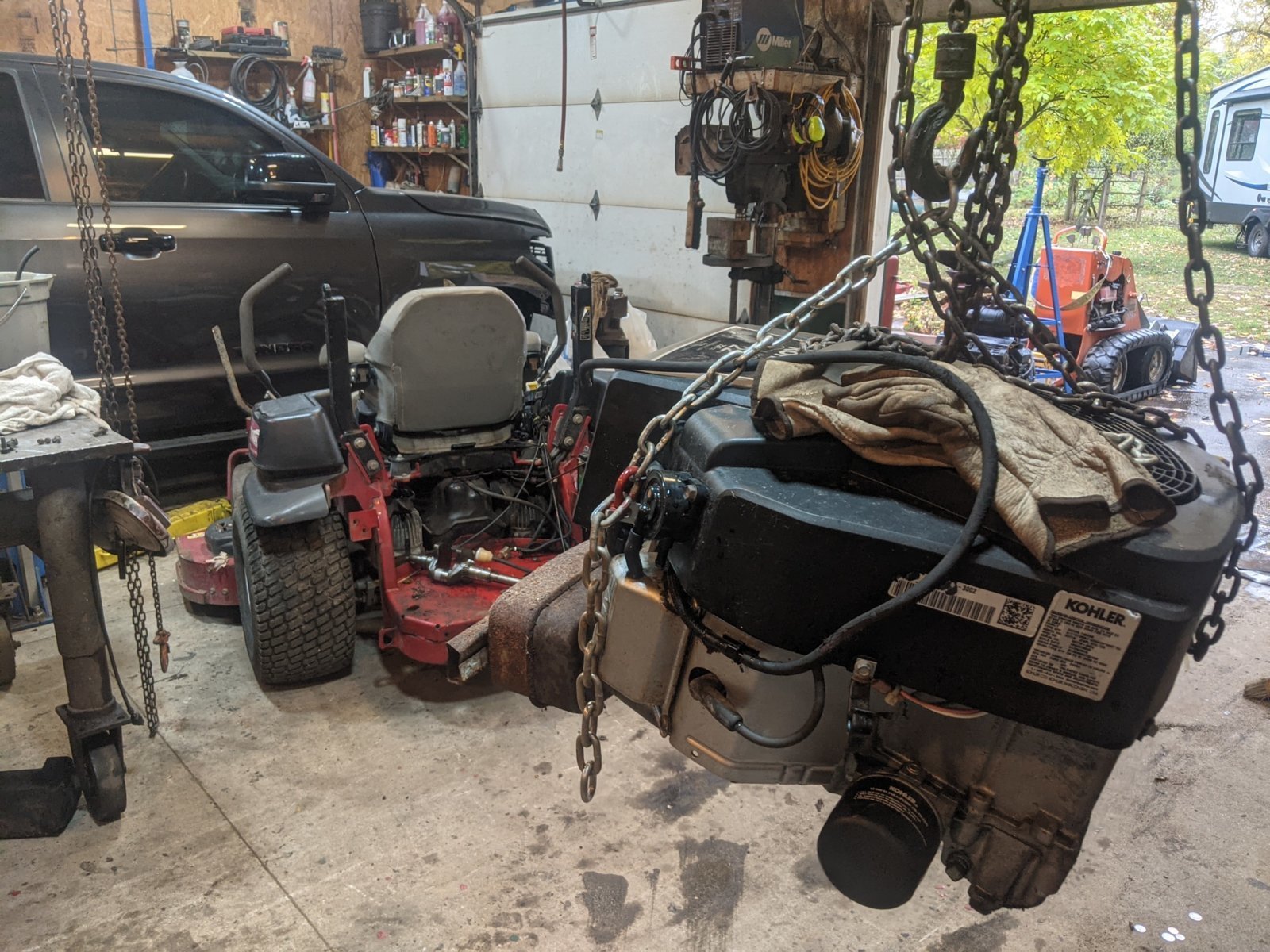

    Notice the exhaust on this Courage engine. I hangs lower than the bottom of the base of the engine. I know, poor pic, but take my word for it.
    The Kohler Command engine exhaust discharges perfectly horizontal and does not contact the chassis base.
    I thought that these 2 different engines would have different exhaust discharge dimensions.
    Turns out, they are identical.
    I did not need to do any fabrication of the exhaust.
    The Kohler Command and the the Kohler Courage have the exact block specifications. I'm very happy to accidently find that out.
    In short, the original Kohler Command Exhaust bolts in perfectly on a Kohler Courage engine.
    Crappy pics, but I hope I was able to convey the gist.

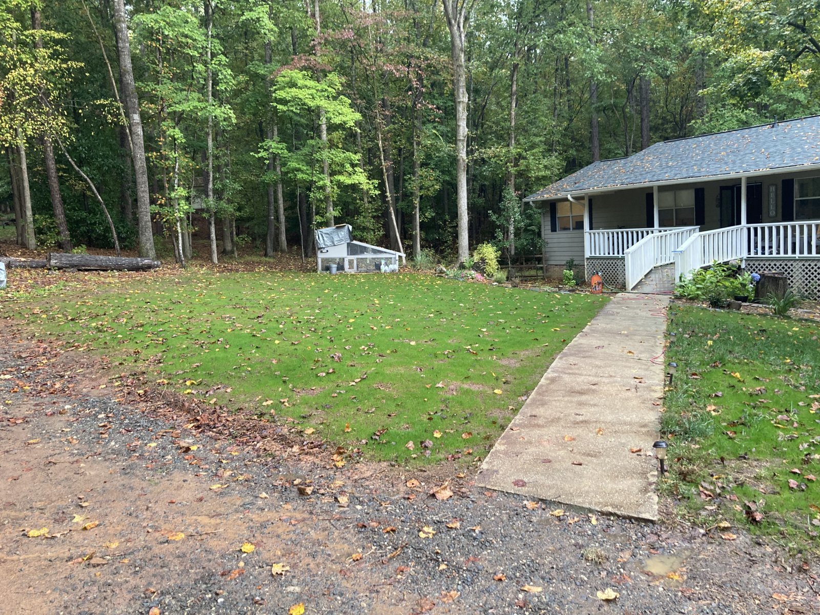

    Update on the yard. We have grass!

    Congrats man. I mean that seriously. I have terrible luck trying to seed grass so I am very jealous. I get it to start, then nothing lol.

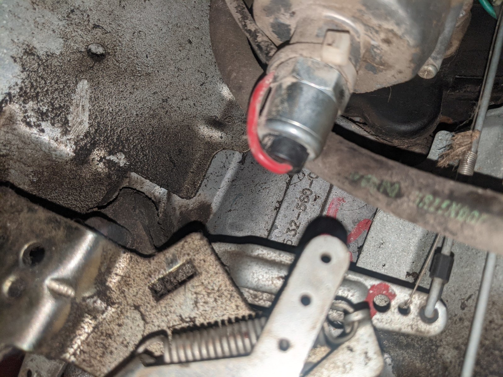

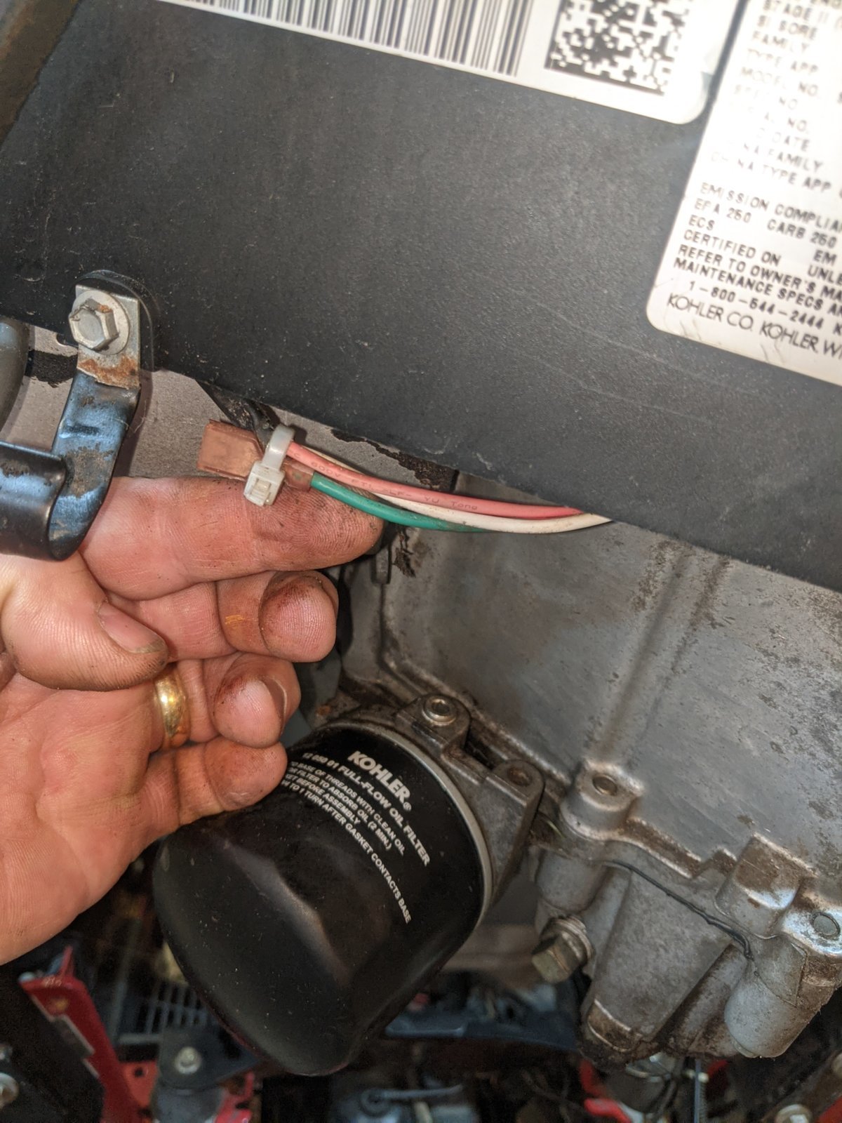

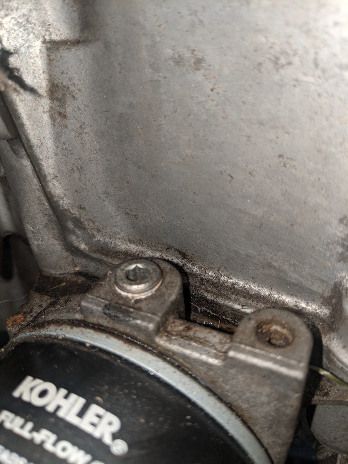

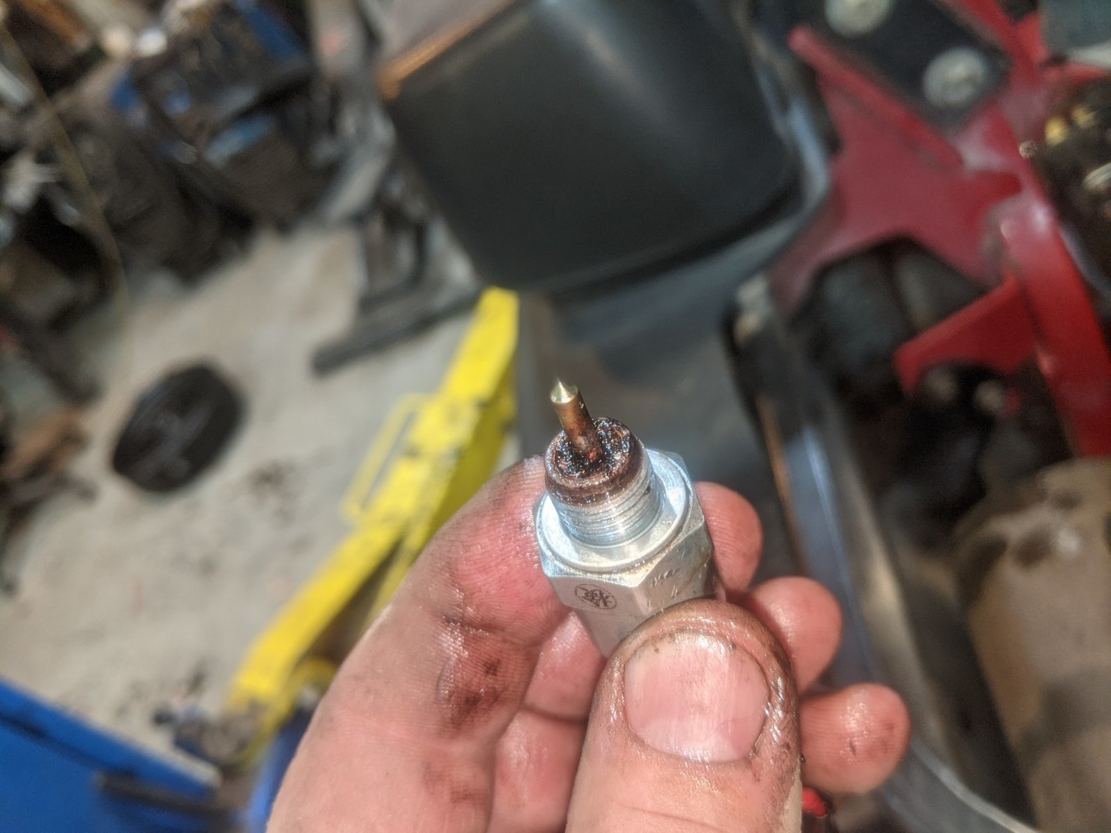

    The Kohler Courage engine does not have a low oil shutdown sending unit.
    The Kohler Command engines do.
    I was looking over this donor engine and I found some things that make think...
    Looking at the wire harness, I was puzzled to see a connector zip tied out of the way.
    I also noticed an Allen head plug in the area of the oil filter assembly.
    My assumption is that " low oil shutdown" is an option.
    I'm hoping to install an oil sending unit from a Kohler Command engine will make this a low oil shutdown engine.
    All most all small engines low oil level sending units will ground out the coils if the oil level or pressure falls, thus killing the spark to the plugs.
    I hope installing a sending unit makes this a robust unit.
    We will see...PXL_20231020_203213054.jpg PXL_20231020_203213054.jpg PXL_20231020_203448492.jpg

    but yove found a way to double protect engine fail.

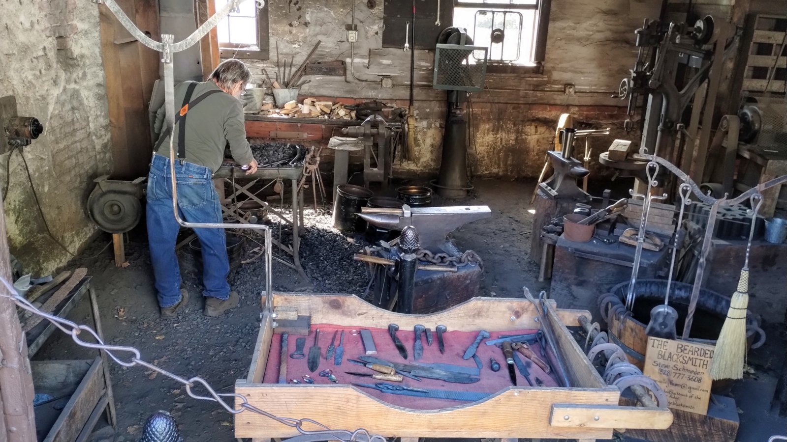

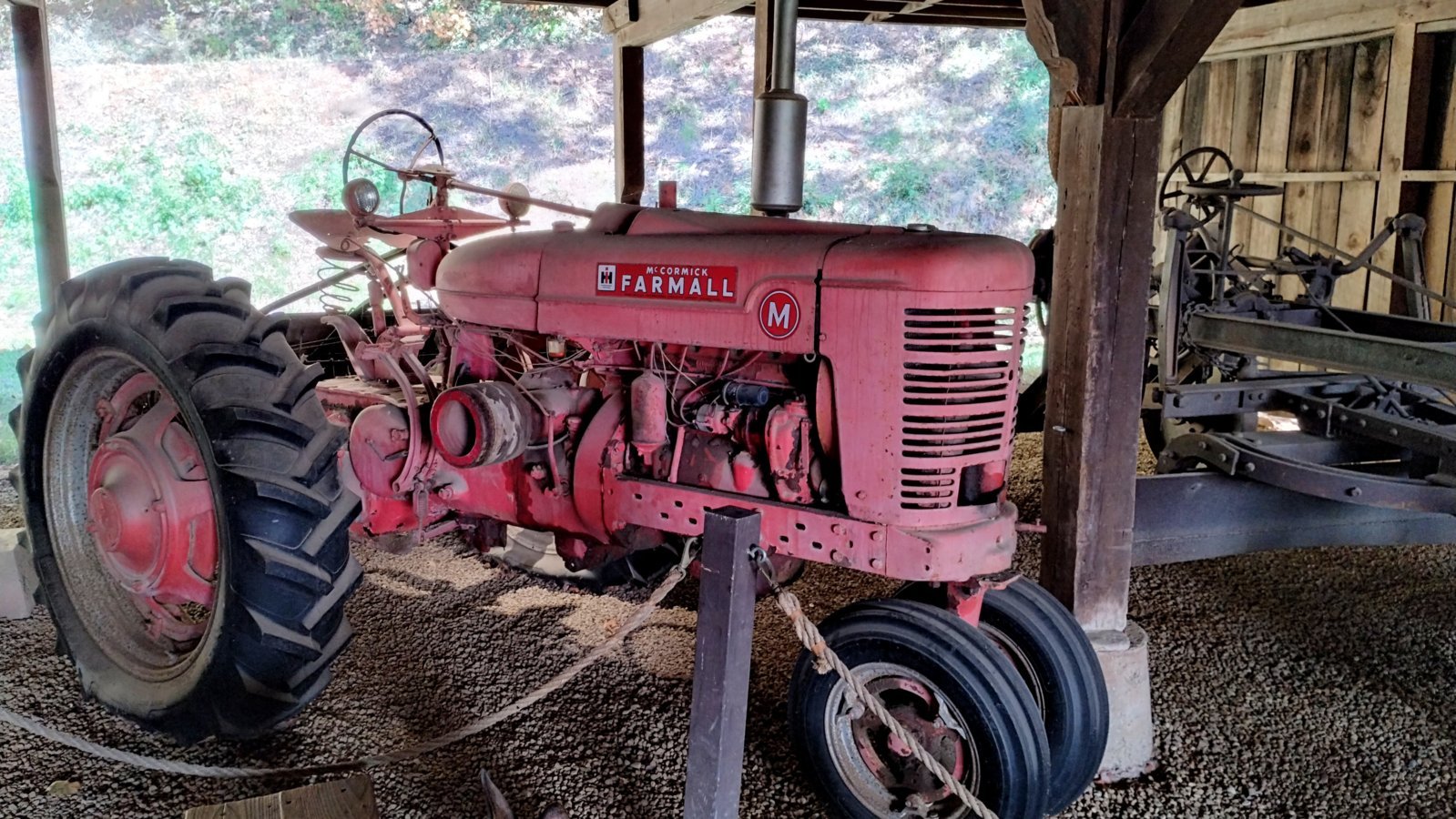

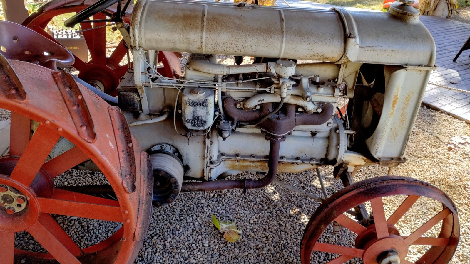

    Went to the Biltmore estate today and did some walking.
    And I got a few pictures from our visit.
    IMG_20231023_132104557_HDR.jpg IMG_20231023_132111636_HDR~2.jpg IMG_20231023_131852850_HDR.jpg IMG_20231023_131855847.jpg IMG_20231023_131823547.jpg IMG_20231023_131831012_HDR~2.jpg IMG_20231023_131526013_HDR~2.jpg IMG_20231023_131956263~2.jpg
