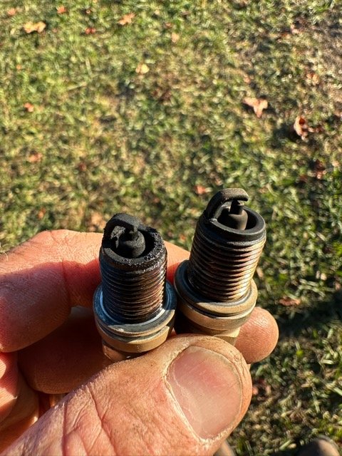

    Had to move the mower Saturday with the kohler, I noticed it was only firing on one cylinder even with the new coils. I took the plugs out, figured one was fouled since it had only been firing on one for a while. Changed them and Cole mowed the whole yard without a hiccup.

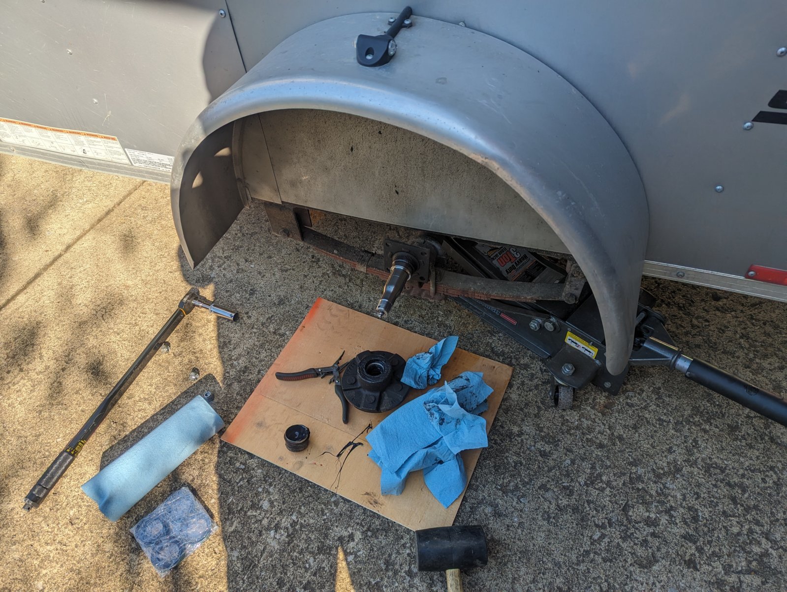

    Got to spend the start of my day changing an inner axle grease seal. I bought new tires for my trailers about a month ago and found the inside of the rim coated with grease. Annoying, but easy problem to deal with, if you catch it early lol. Yay for doing preventative maintenance on the regular I guess.

    Were there Bearing Buddies on hubs?

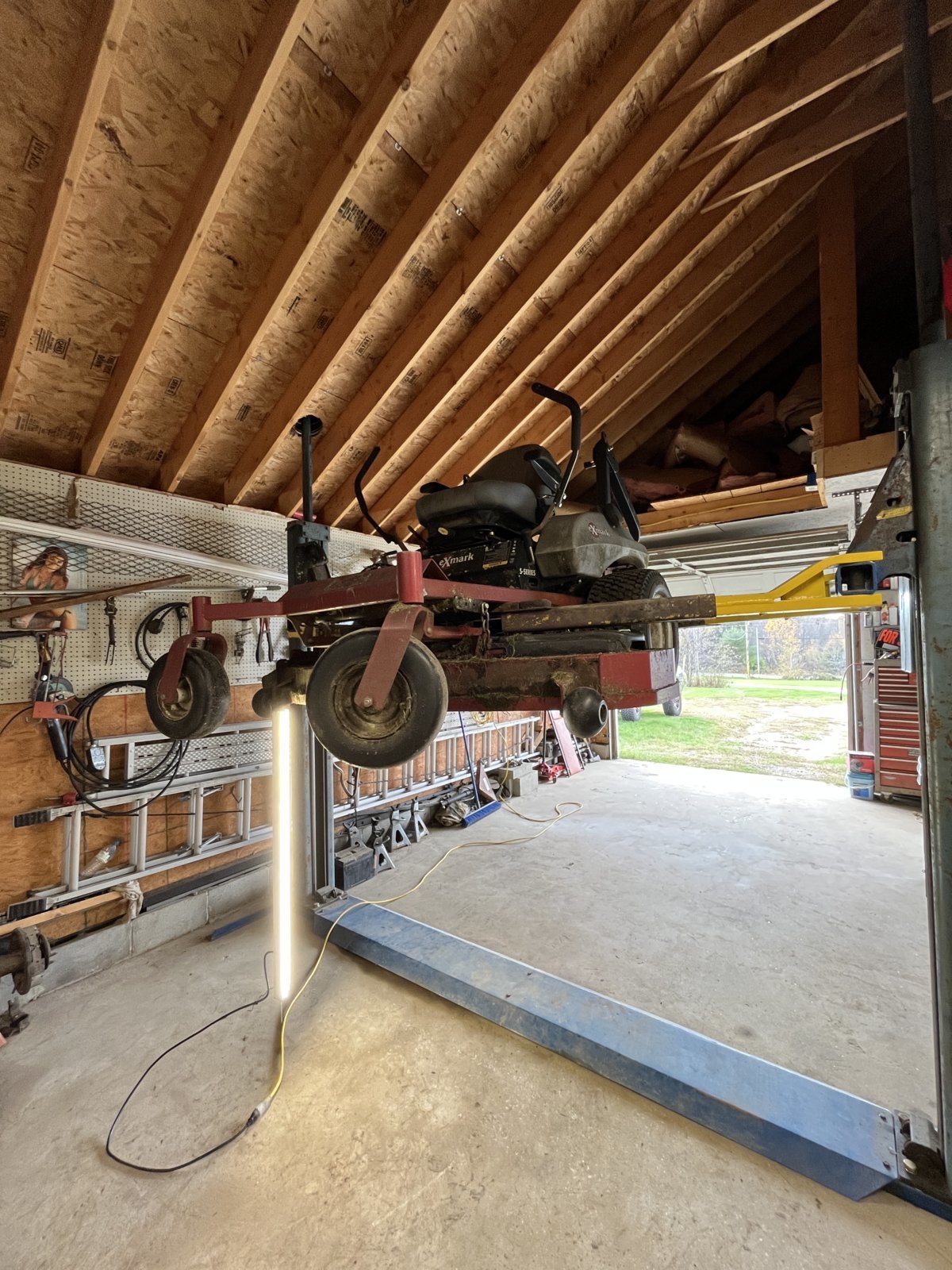

    IMG_0972.jpg End of season cleaning under the deck

    No. The axle itself has a grease port. EZ lube or whatever it is called I believe. I still think it can be overgreased though like bearing buddies tend to do if that's why you are asking.

    That was gonna be my second guess.
    Thanks

    Yeah, so I use this gizmo:
    https://www.amazon.com/ATIVERE-Pneumatic-Electric-Universal-Conversion/dp/B098Q523DD?th=1
    It works well, but I like the feel of a manual grease gun that this lacks. It's entirely possible I overfilled the bearings, but for the cost to replace I just went the safe route.

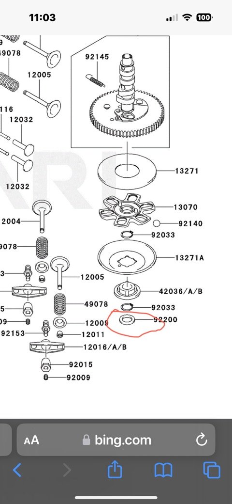

    Anybody else ever do something wrong or is it just me? :annoyed:
    The Kawasaki engine I replaced the governor piece in, I can’t get any adjustment out of it.
    I looked at a picture online and know exactly what I did wrong. I put this washer circled in red on the wrong side of the snap ring, now to pull the engine and move it :frusty:
