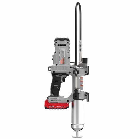

    It's not bad at all. For $50, I thought why not. I was gonna get a Dewalt powered grease gun, but figured I would try the cheaper option first. It works better than a old school grease gun, but I bet the purpose made powered guns have better ergonomics. I did find that a small 12v powered screwdriver works better and is lighter than my 18v stuff attached to it.
    I did put an EZ quick connect jobber on it as well, but I kinda prefer the normal grease adapter as the EZ clip one tends to leak unless you hold it which totally defeats the purpose.
    Best part of the powered gun is it pretty much self primes. Easily worth the $50.

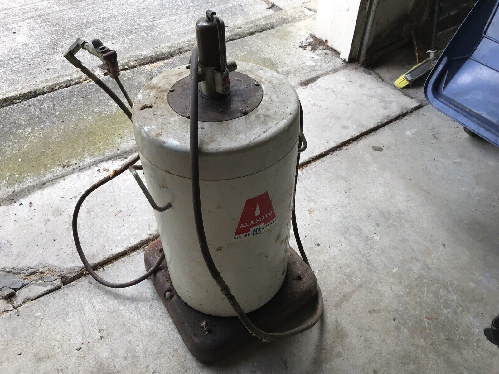

    Over-greasing bearings is quite common in industrial settings.
    Excess grease makes bearings run hot as the grease is churning around in there.
    You can spot it with a thermal camera.
    Some industries use vibration analysis when greasing, with the testing equipment the tech can "hear" when the optimal amount of grease has been added.
    When vehicles had grease fittings on ball joints & tie rod ends it was common for people to blow the boots or seals by adding too much grease, especially when the garage used an air powered grease gun like the one below.

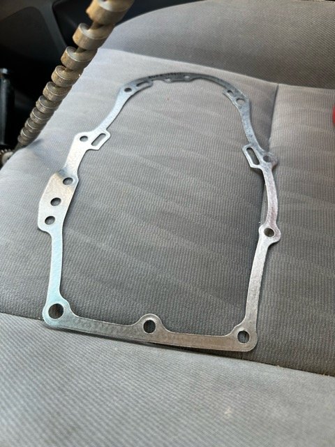

    I ordered another base gasket yesterday for $44, I don't want to chance reusing it and have to pull it back off for a leak.

    all my stuff is dewalt.... so it either has to be dewalt or interchange with dewalt batterys.

    Exactly my situation. I have excess old 12v dewalt stuff lying around and always have 18v dewalt stuff in my truck due to my job. If my $50 option fails, Dealt gun is my next stop.
    I just use the 12v on my grease gun since it is lighter.

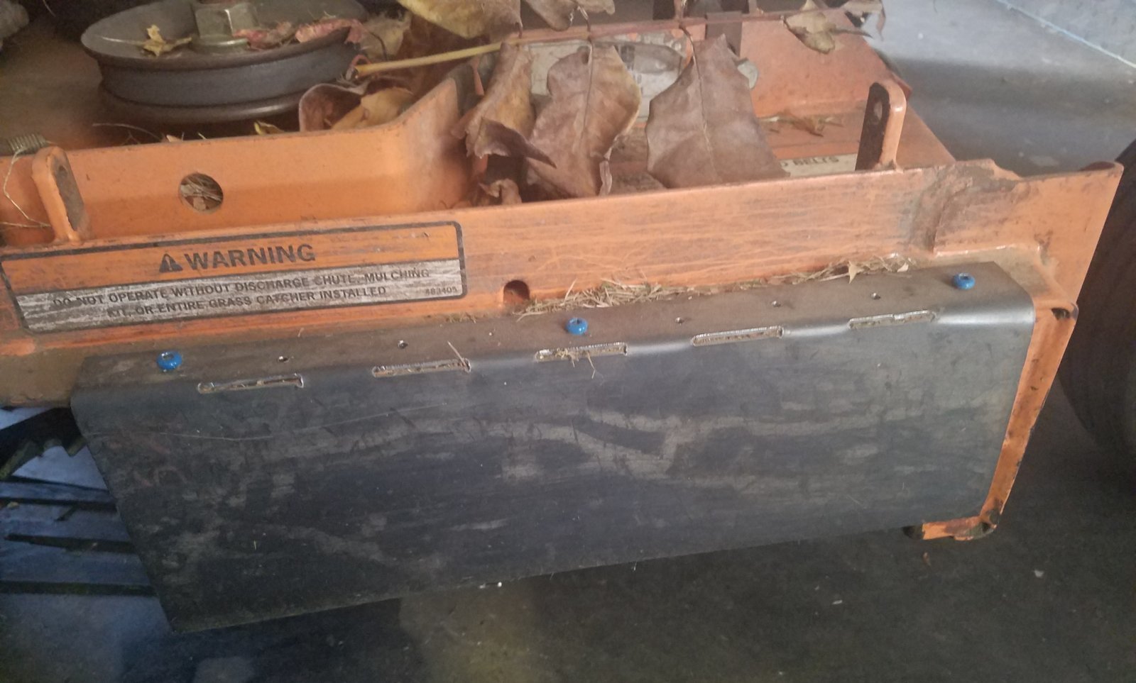

    Made a new mulching system for my Scag ZT :anonymous:. It actually did okay on the light leaf cover I have now and did especially well on shredding pine needles.
    Leaves are just starting to fall here in S Indiana. I can use this briefly until they really start to come down. They get so deep in my yard I windrow them with backpack blower and use Agri-Fab pull behind with my JD LT.
    Over the course of 3-4 weeks, between my yard and my parents next door I'll pick up 35-40 Agri-Fab loads. Amazing how much better the grass is since I started doing this when I moved here 6 years ago.
    I have an old pond area that I'm filling with limbs and leaf debris.

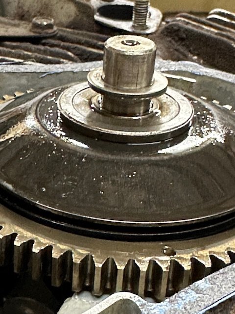

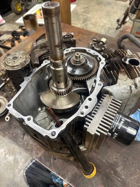

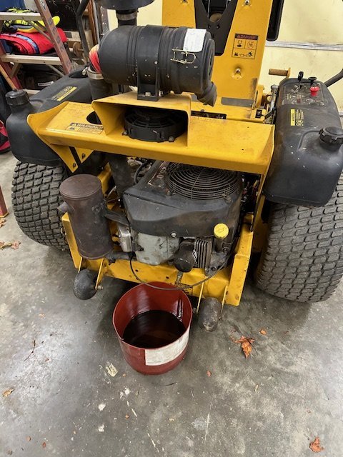

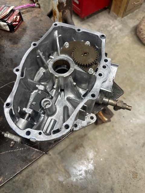

    1st time I took this off and got it cleaned and ready to be put back together it took me about 3 hours. Last night I did it in 43 minutes :D

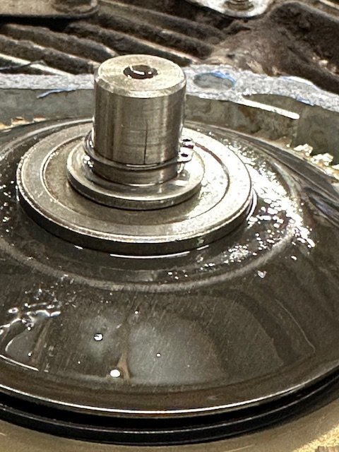

    This is what I did wrong, all I had to do was move this washer to the opposite side of the snap ring :angrygirl:

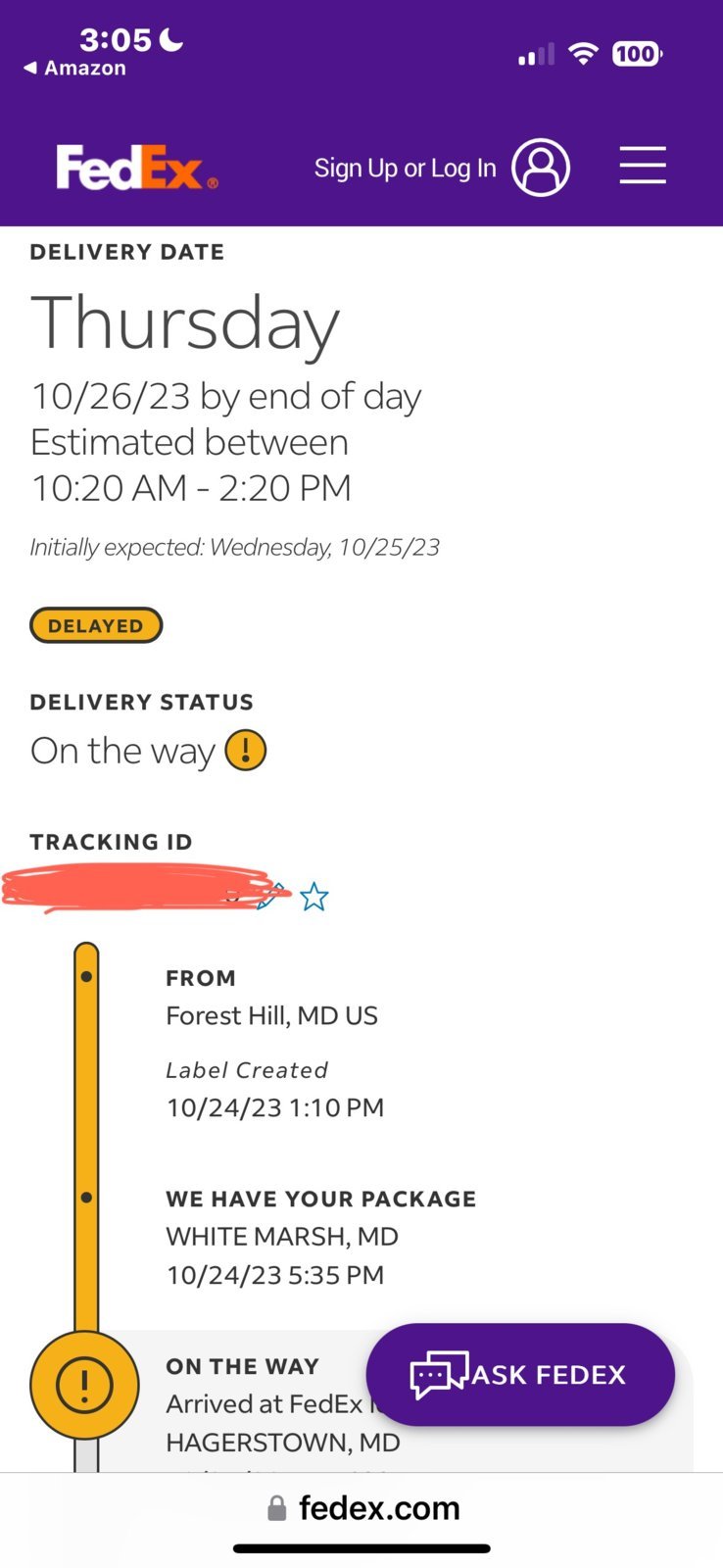

    I started on this last night at 8:00 thinking the base gasket was coming today and I could get it back together when I get home *delayed* :frusty:
    @Delta09 you see a package hung up on a conveyor anywhere :facepalm:

    Hopefully I can get it back together this afternoon. I went to the local mower shop and they had the gasket in stock $7 cheaper than Amazon. Guess I’ll hang the other one up when it comes in for future use.

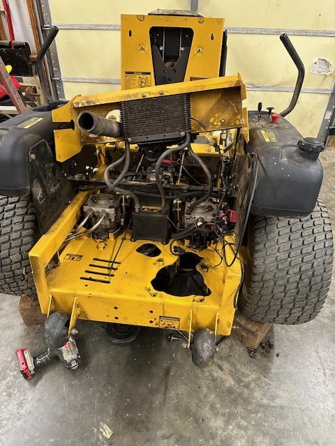

    Got the Kawasaki back together yesterday, runs like it should now :bananadance:
