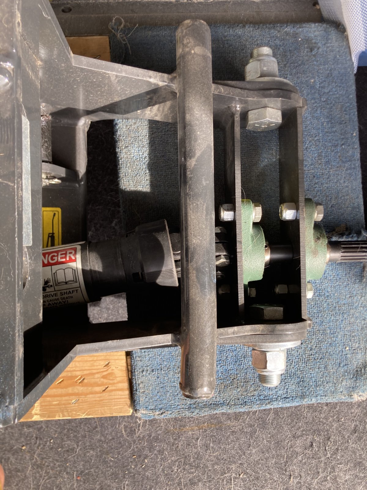

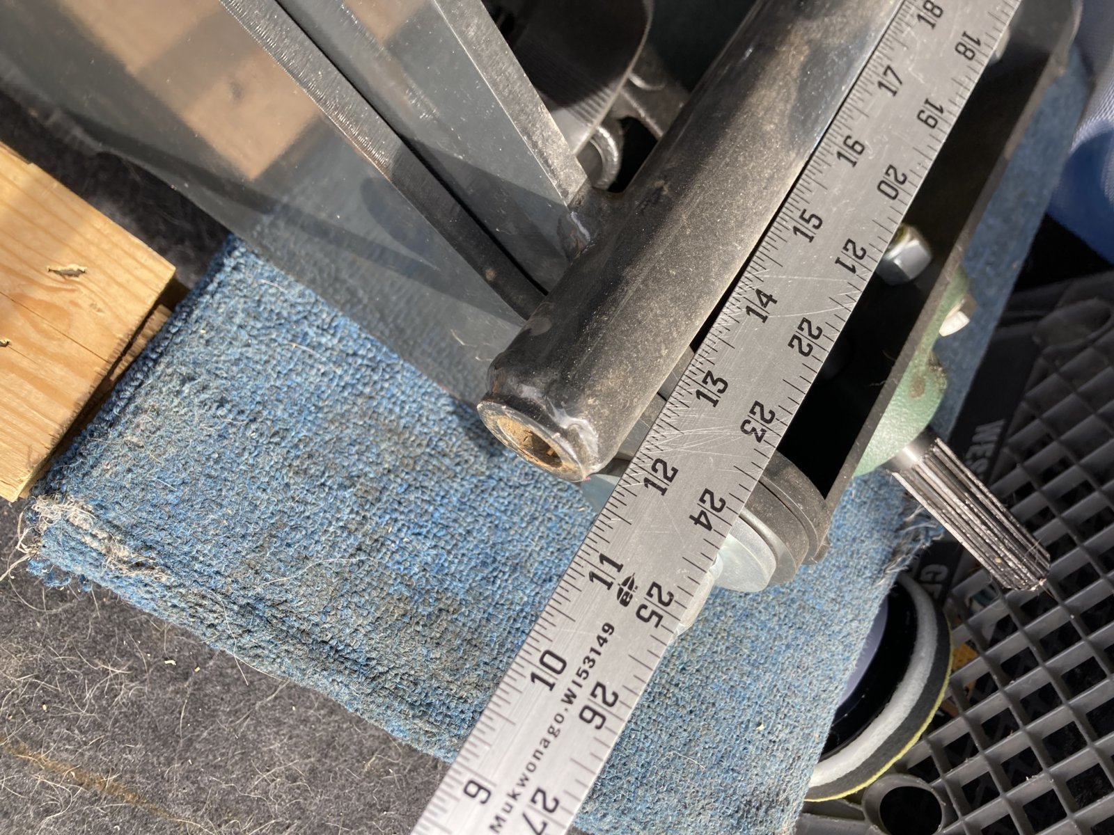

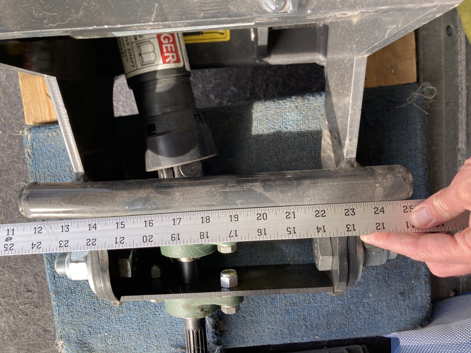

    Could use some advice from the crowd. I've got a front-mount snowblower on our kioti sub-compact. Part of the mount for the snowblower got tweaked last winter. It was really difficult to get the hitch off this spring, and I'm sure it won't go together well for winter like it sits. What's the best way to go about trying to straighten this? Put a pipe on there and give 'er?
    Here's the mount.
    A long pin/rod goes through the pipe and tabs on either side of the frame:
    With a straight edge showing the tweak:

    Hello fellow Howler!! (Kioti owners are called Howlers for those of you who dont know this)
    you might be able to move that back over with a big cheater pipe.
    it really shows up with the straight edge.
    if you can heat it up first would probably help.

    This was my 1st thought^.
    Even a handheld propane torch will heat that red hot if you have a new 1 lbs. can. Just takes some time.
    Once red hot, it becomes " plastic". At that point, put a pipe bigger in diameter than the existing pipe over it and bend it to straight .
    Please report back.

    I just noticed you have a loader. Chain it and use the loader to straighten it after heating. You might want a second person to watch as you apply tension.
