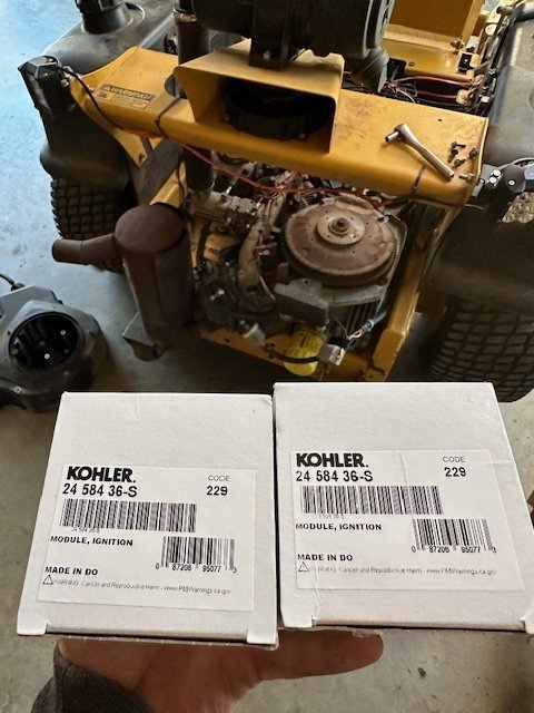

    I got these in last week and put them on Friday, my wife ask if I could send the knock offs back through Amazon, I looked and had until Sunday to get them back, dropped them off at CVS Saturday. I didn't know but some CVS drug stores have UPS access points inside.

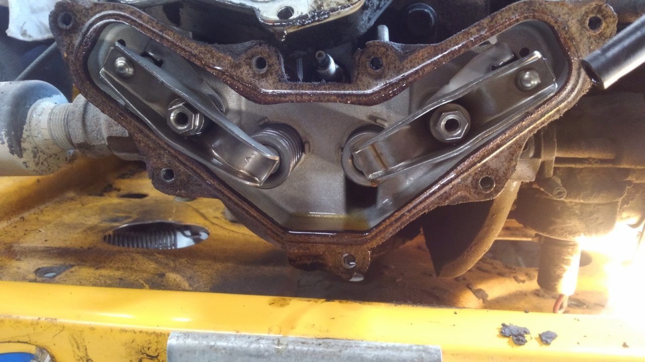

    I think the 100 & 300 hour intervals are way out of line. :eek:
    My ZT with the Courage engine is going on 16 years & 600 hours using a 50 hour interval.
    This was last year at 518 hours.
