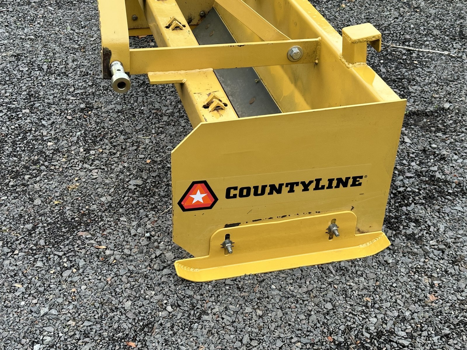

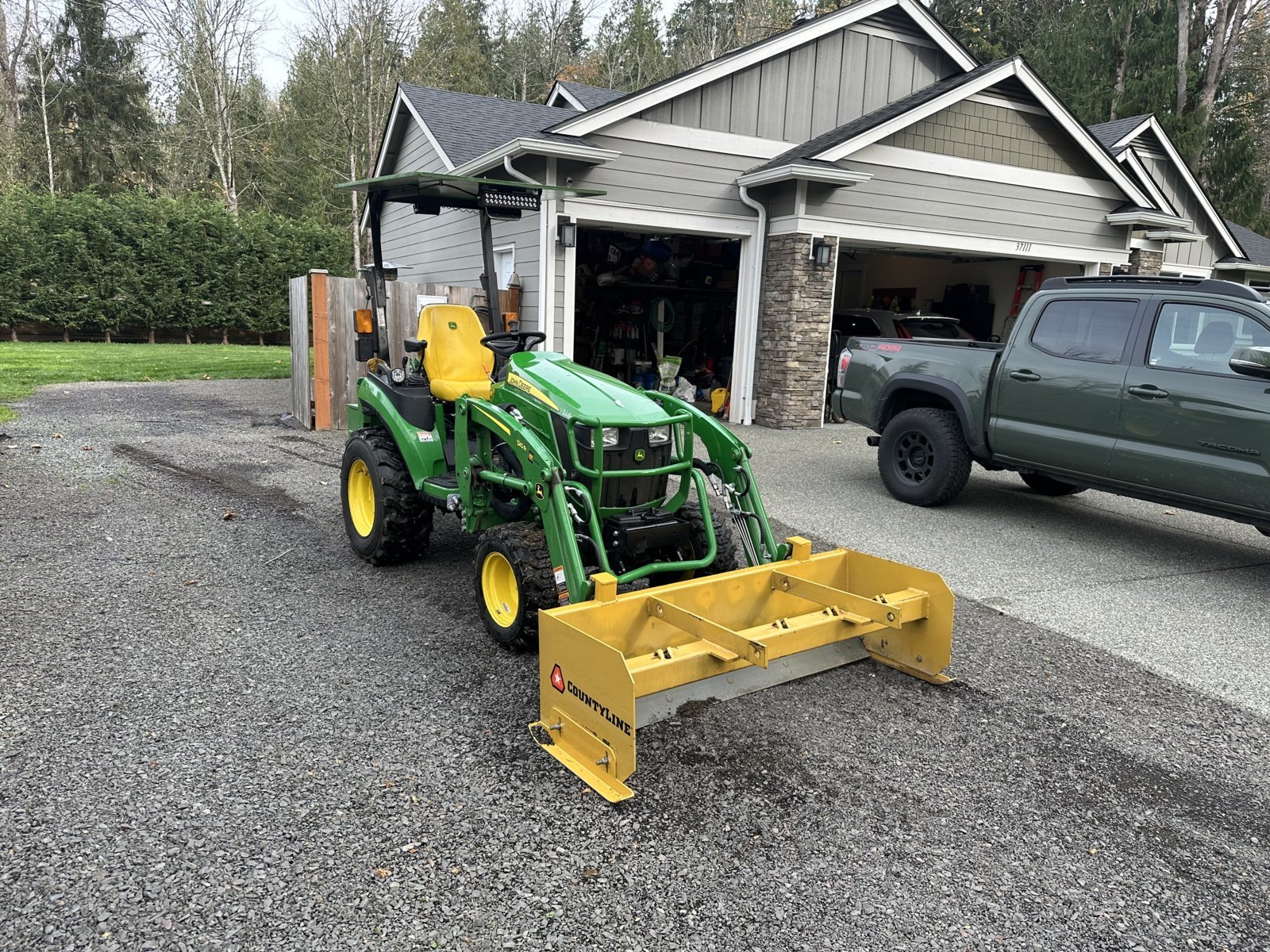

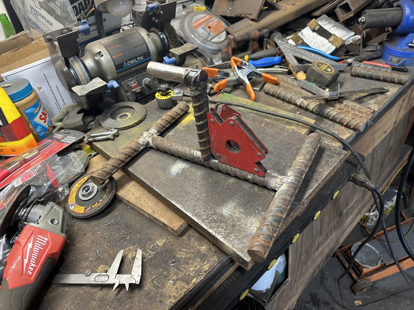

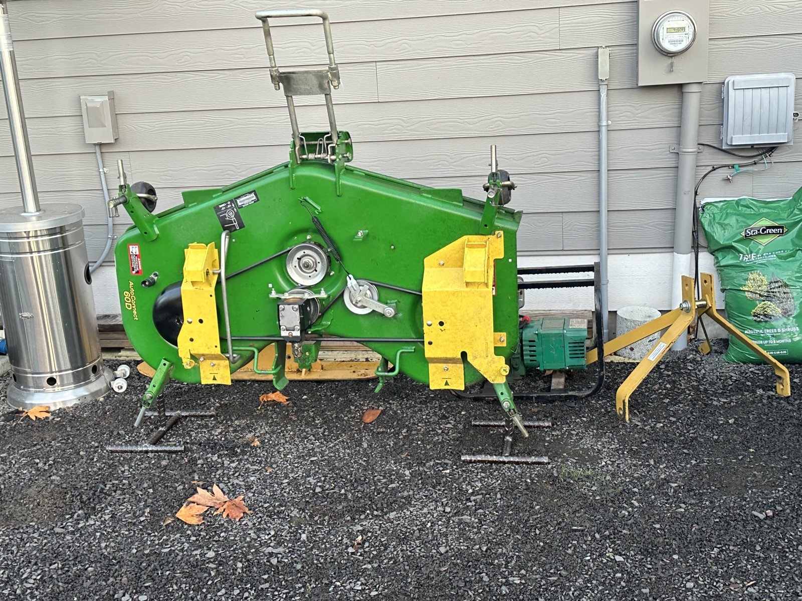

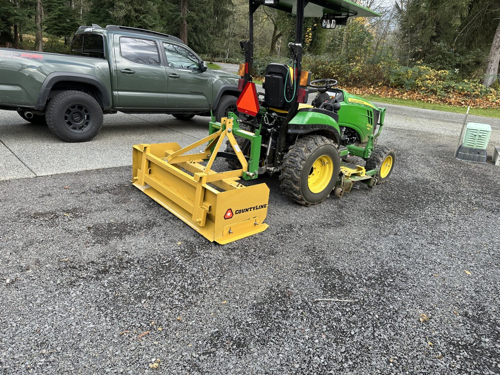

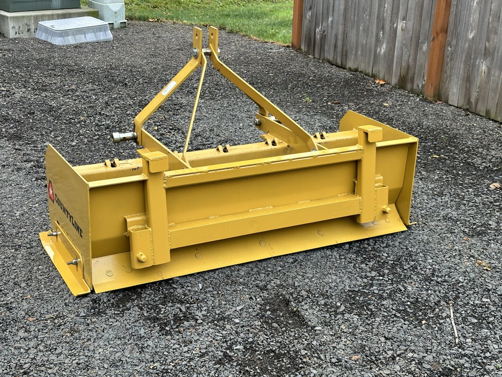

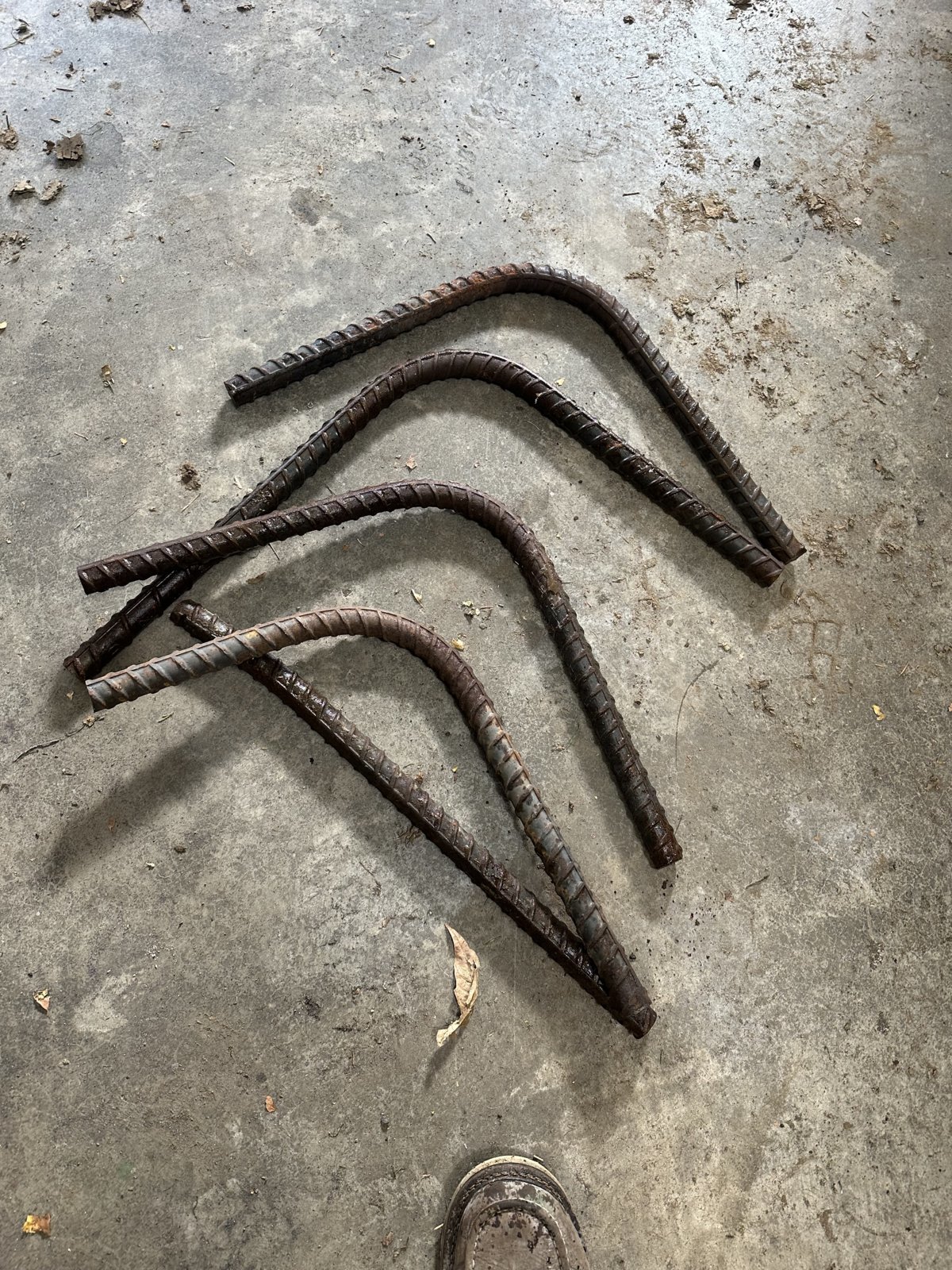

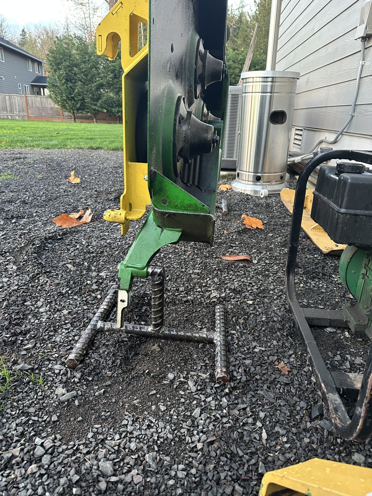

    Finished my box blade/snow pusher mod and threw together a couple deck stands

    That's clever!

    You might want the mower deck on the tractor for the extra weight when your trying to push snow.

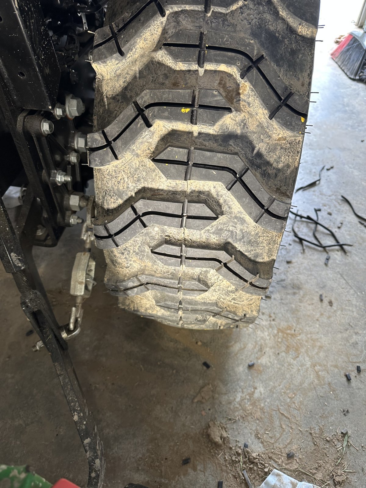

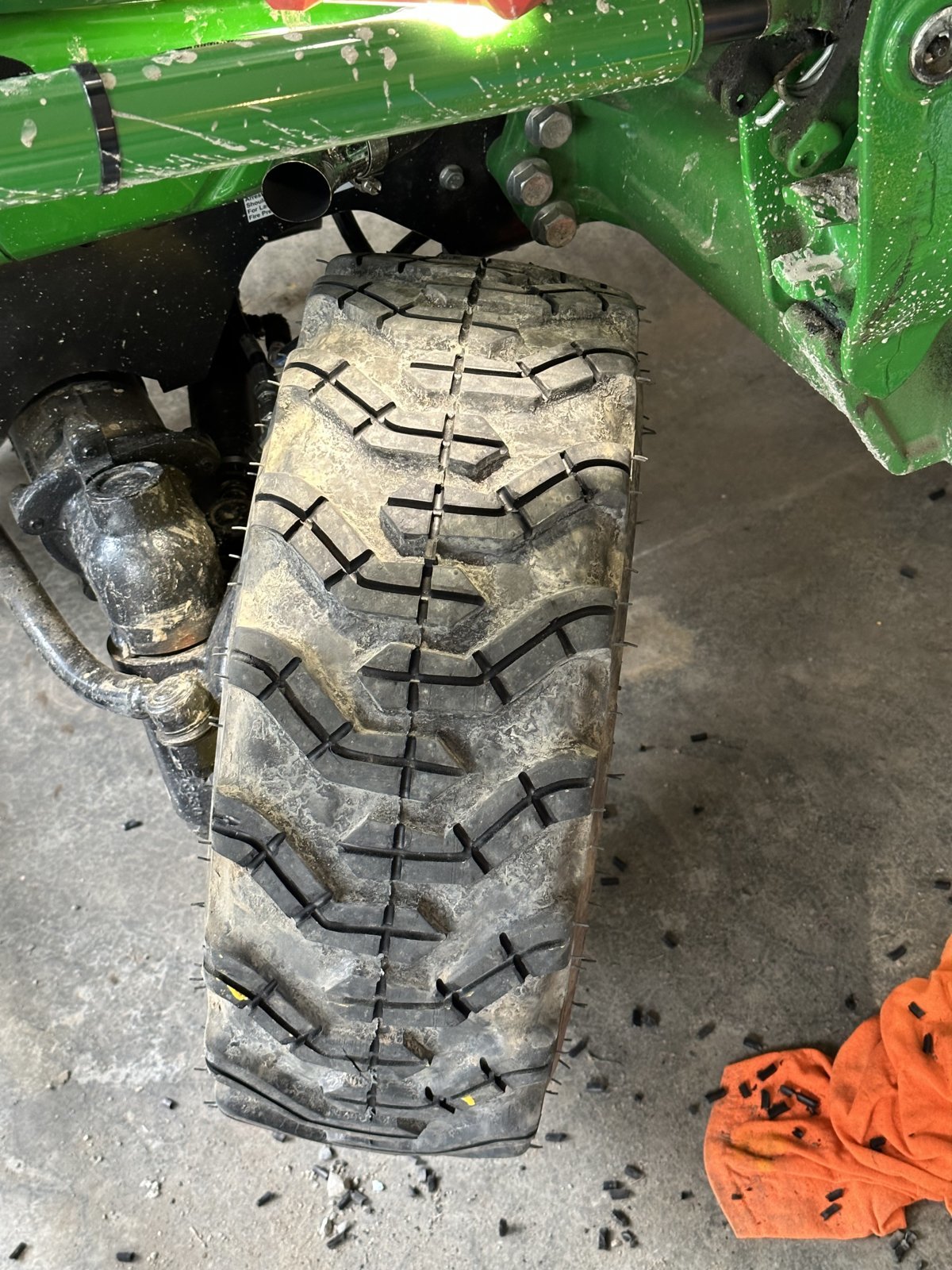

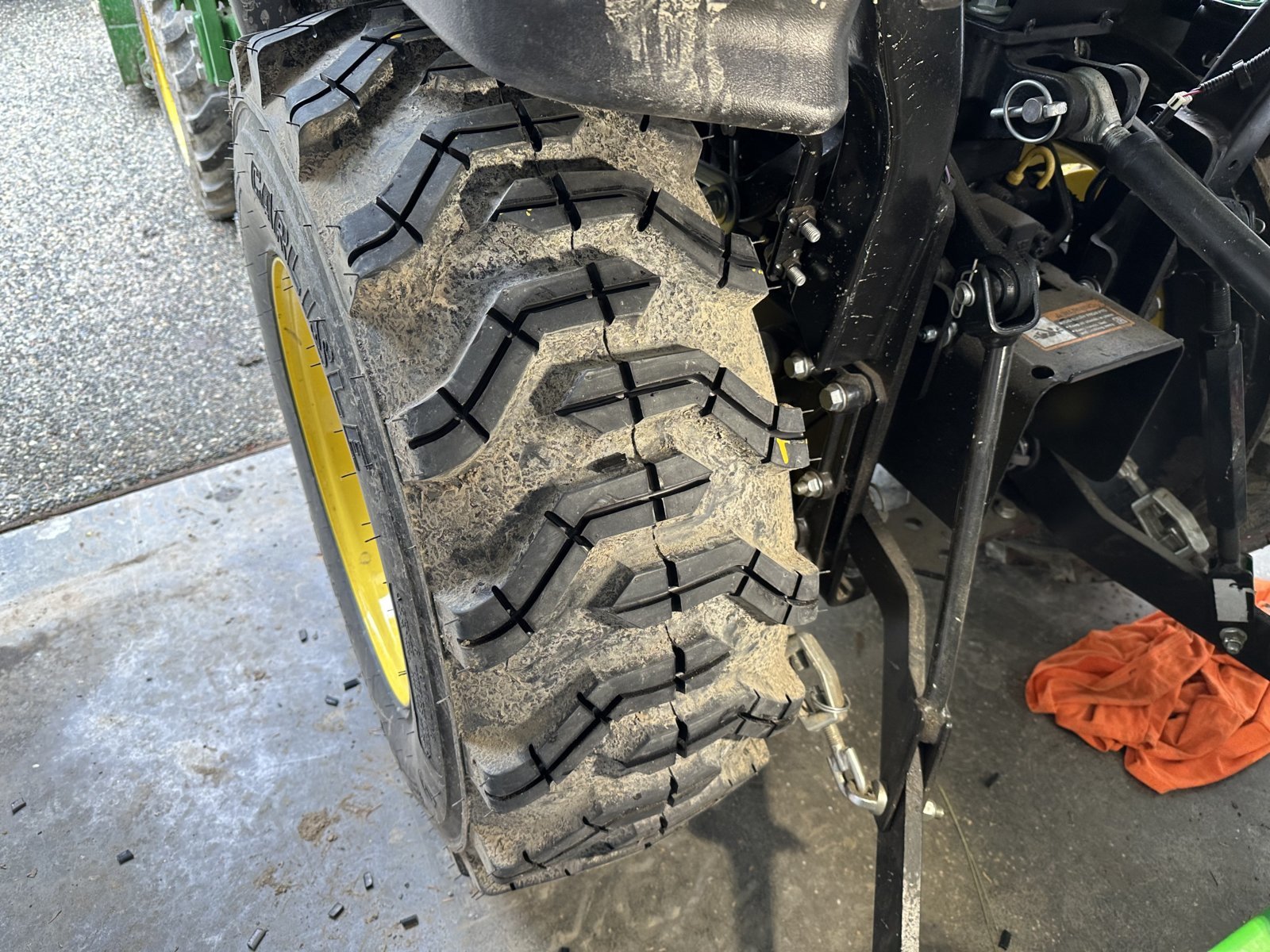

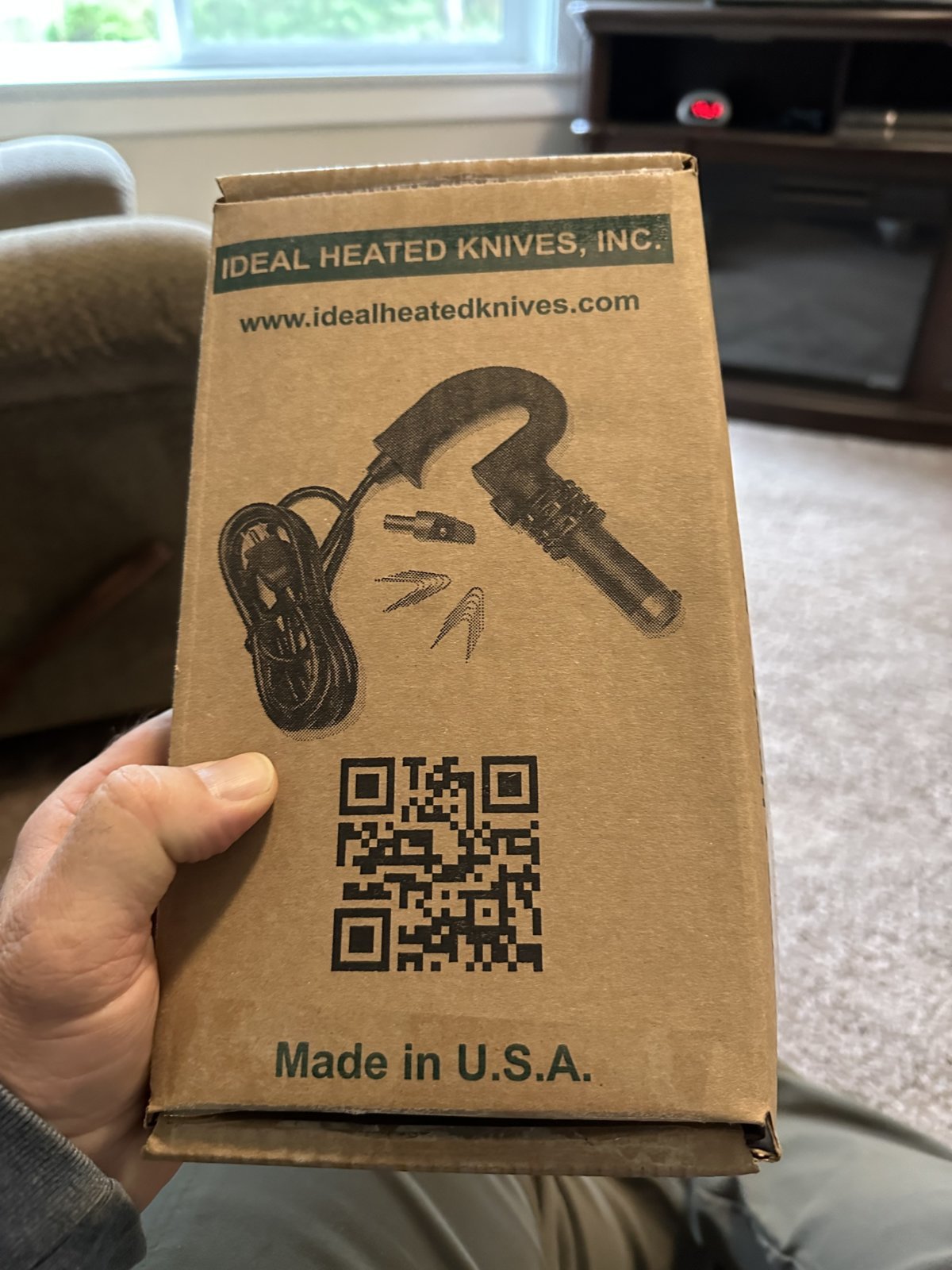

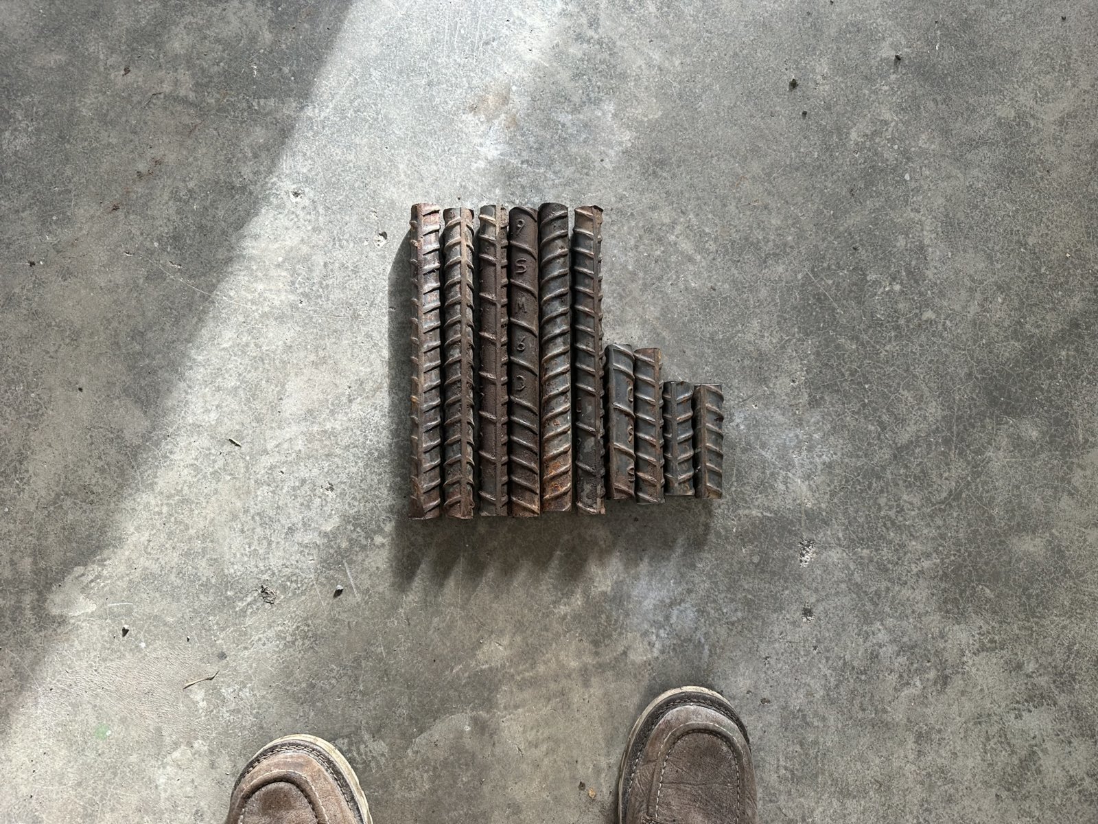

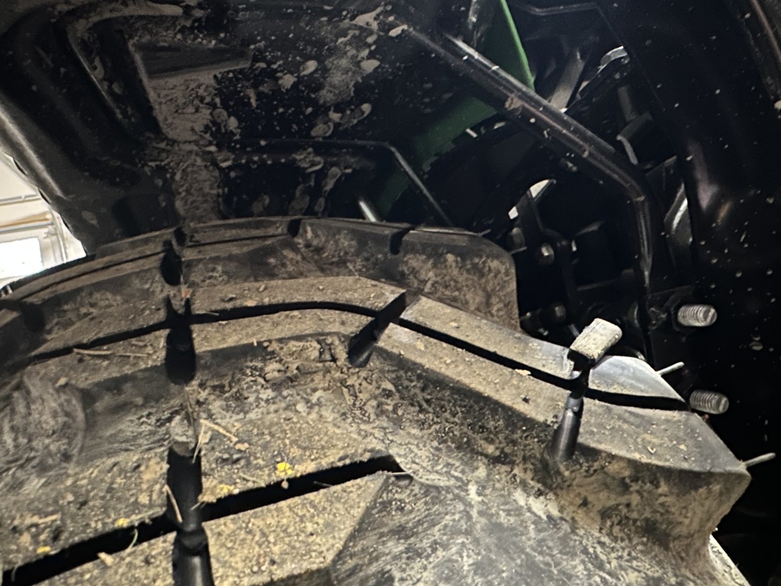

    I got filled grooved tires, and a ballast box full of steel. Plus a front weight bracket if it has too much understeer.
    For you guys not aware they make a tire grooving tool that does a great job giving the AG tires like the R4 more traction

    that was anice space saver on standing that deck up! good use of spare stuff!

    Want to make sure I understand these, is the point to raise the lip of the bucket off the ground a few inches so it doesn't dig down into the gravel/dirt but only pushes whats just above the surface.

    Correct. Works as advertised. Leaves about an inch of snow on the ground. I even used it for leaf piles on my lawn and didn’t leave a scratch.
