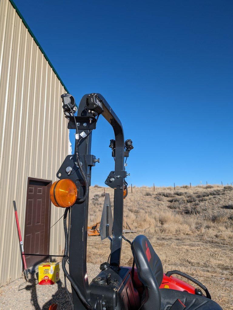

    I thought about it, but $20 is more than i have invested in this already lol The switches are a 2 minute job to cut the hole once i figure out where i want. This was also a premade harness minus the extensions up the ROPS
    After the winter we had last year its been on the list. Had the parts on the shelf just never got around to do it lol. But trying to remove snow in the dark with the loader in the way was not the most enjoyable thing

    I definitely did consider them over switches. But I'm cheap. And the tractor gets to live in the shop during the winter anyways.
    Though I did get smart switches so I could turn the outside lights on from the house lol

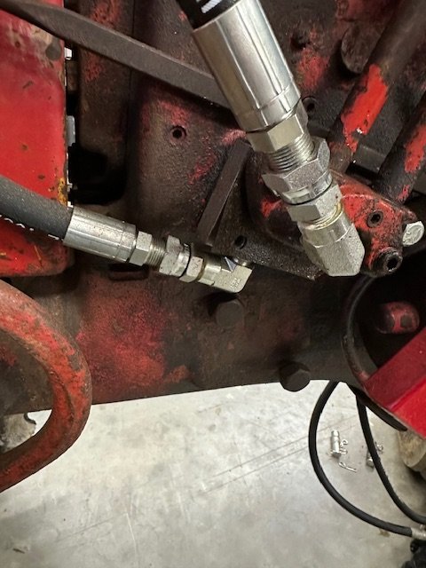

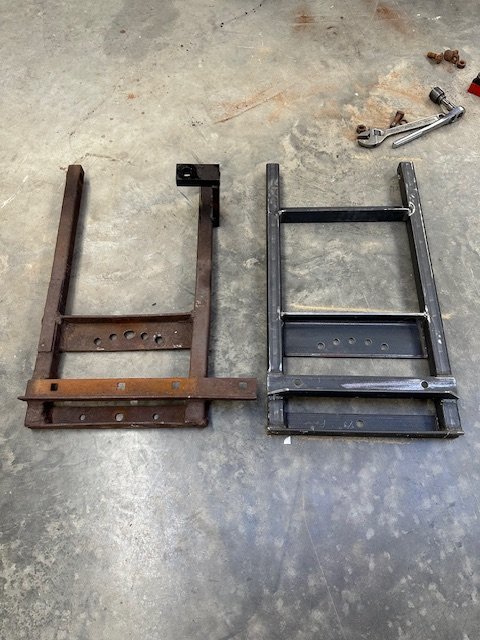

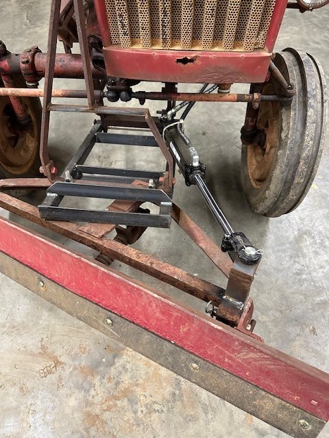

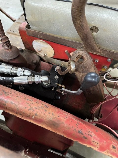

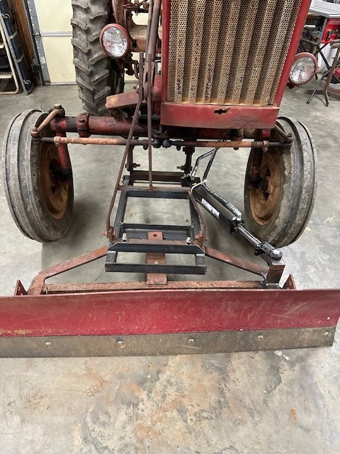

    Worked on the front blade last night, made a new frame for it. The one I got with it was wore out. I added hydraulics a while back to make it turn left and right.

    well thats very nice work!
    thanks for sharing!

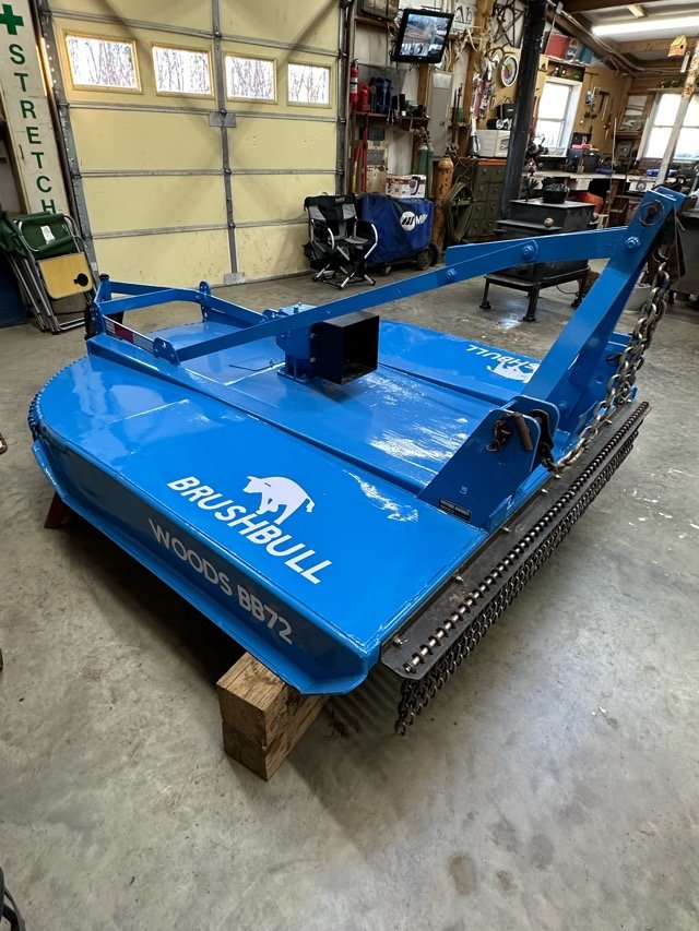

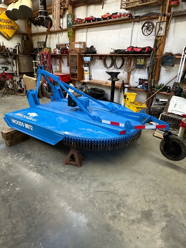

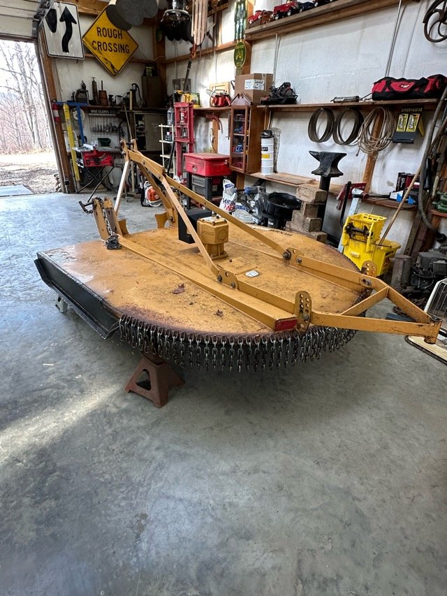

    Repainted my bush hog last week and made new decals for it. Sharpened the blades as well.

    That looks fantastic!

    Very professional looking job! nice work!

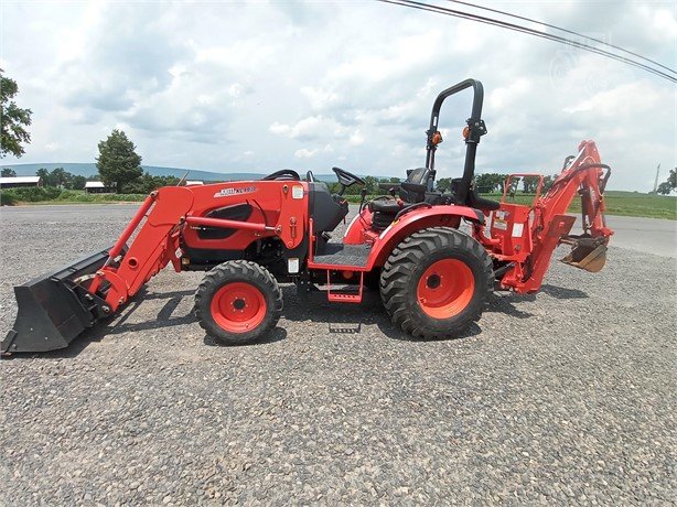

    tractor is a 2018 Kioti CK4010 HST w/FEL
    grinder is a 2020 Woodland Mills WG24" PTO operated no hydro needed.

    That looks like the perfect size tractor. How are the backhoes on these? Good for digging up little stumps? Grinder looks like it would handle the bigger stumps.

    its a great tractor for hogging/plowing/grinding/moving dirt/rock/sand & so on.
    i think its too heavy for mowing though. with the tires loaded & weight box on the back its around 4,000lbs. that makes a mess out of the yard if its not perfect dry. im down in the woods a lot doing logs/trees & with the manual grapple on the front it really is a beast for the size.
    now on the grinder? man its all about application. stay out of rocks/gravel & you can get the life on teeth like we are. close to 200 stumps now of various sizes, almost all hard woods & they are still good. work in gravel or sand stone? NOPE. avoid that. you cant see it in my pix, but when im gonna do a lot of stumps at the same time? like my first few years.... i threw a camera on there so i could face forward at all times & watch the screen instead of twisting around backwards all day long.
    super helpful!!
    PS: this grinder is set up for HST style tractors... NOT manual clutch tractors. watch a couple vids you'll see why. i put her in low range & usually just let her crawl forward. only take a small bite at a time & you can make quick work of a 24" diam stump down to 8" below grade in about 30mins.
    on the backhoe? never been happy with tractor backhoes. they just dont have enough hydro pressure for sweeping dirt back into the trench/hole. They dig pretty good, but really fall flat on back fill. BUT they are way better than using a shovel! :)

    im happy to see im not the only ocd guy out there that values caring for equiptment. this looks awesome!
