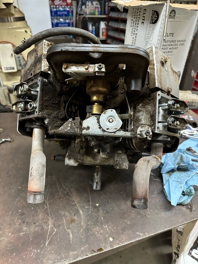

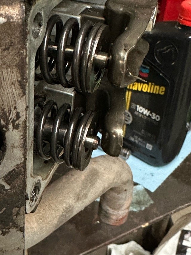

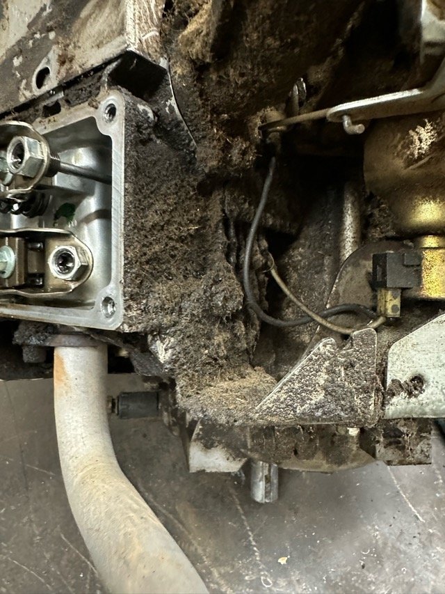

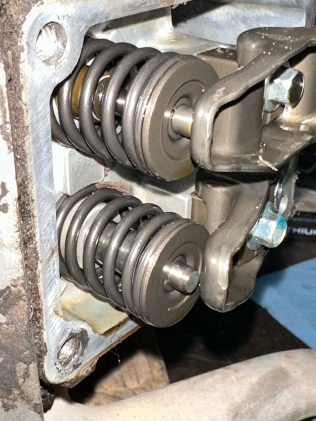

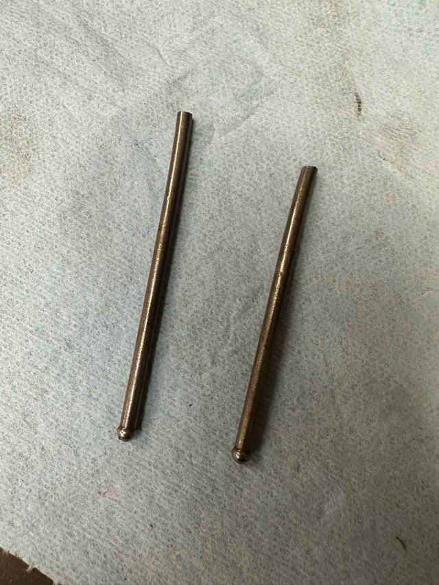

    My neighbor ask me to work on her mower, it has a B & S 20hp twin with a broke push rod.
    Surprisingly it still runs but has a loud exhaust leak. I'm assuming head gasket is the only way since the exhaust valve is stuck shut.
    I did a search on the internet and found this is a common problem with these engines. They get an oil leak and the grass and dust covers the cooling fins on the head thus making the aluminum swell faster than the steel valve guide and the valve guide slides out causing the valve to not move and the weak link breaks, the push rod.
    That is exactly what happened to this one.
    You can see the guide backed out on the bottom valve, the exhaust.

    Time for a new head?
    I always wondered if there was a way to pin the guides from moving?
    sdk1968 and six5crèéd[OP] like this.

    I'm not sure if the head is toast or not, I'll get it off in the next day or two and see.
    What I read is you can take the guide out and add a set screw. I guess you just seal the set screw after reassembly.
