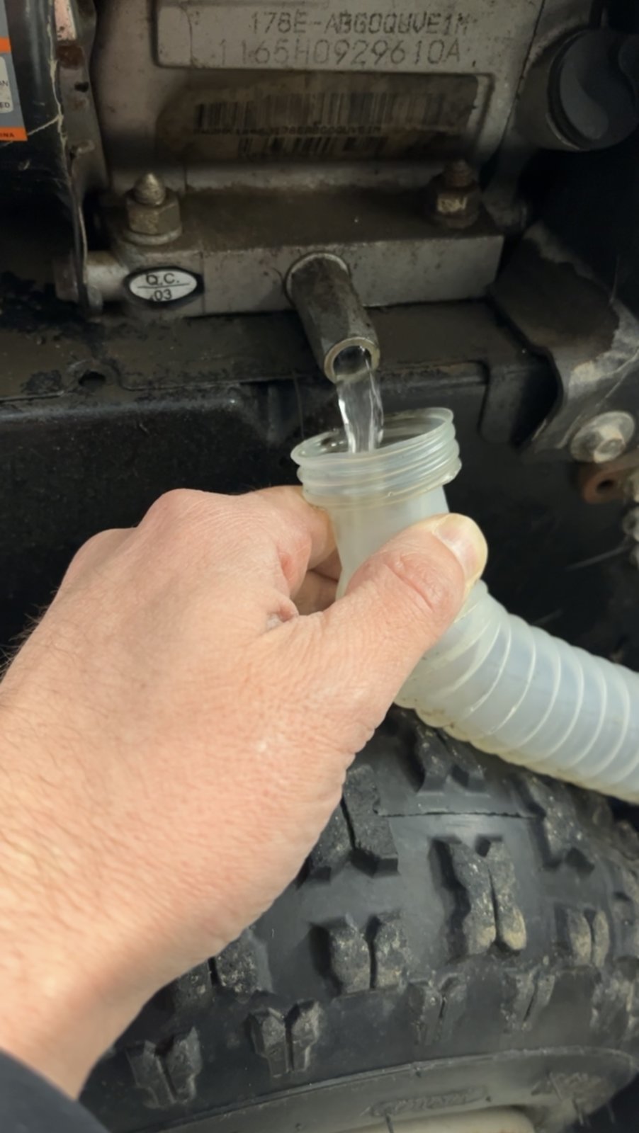

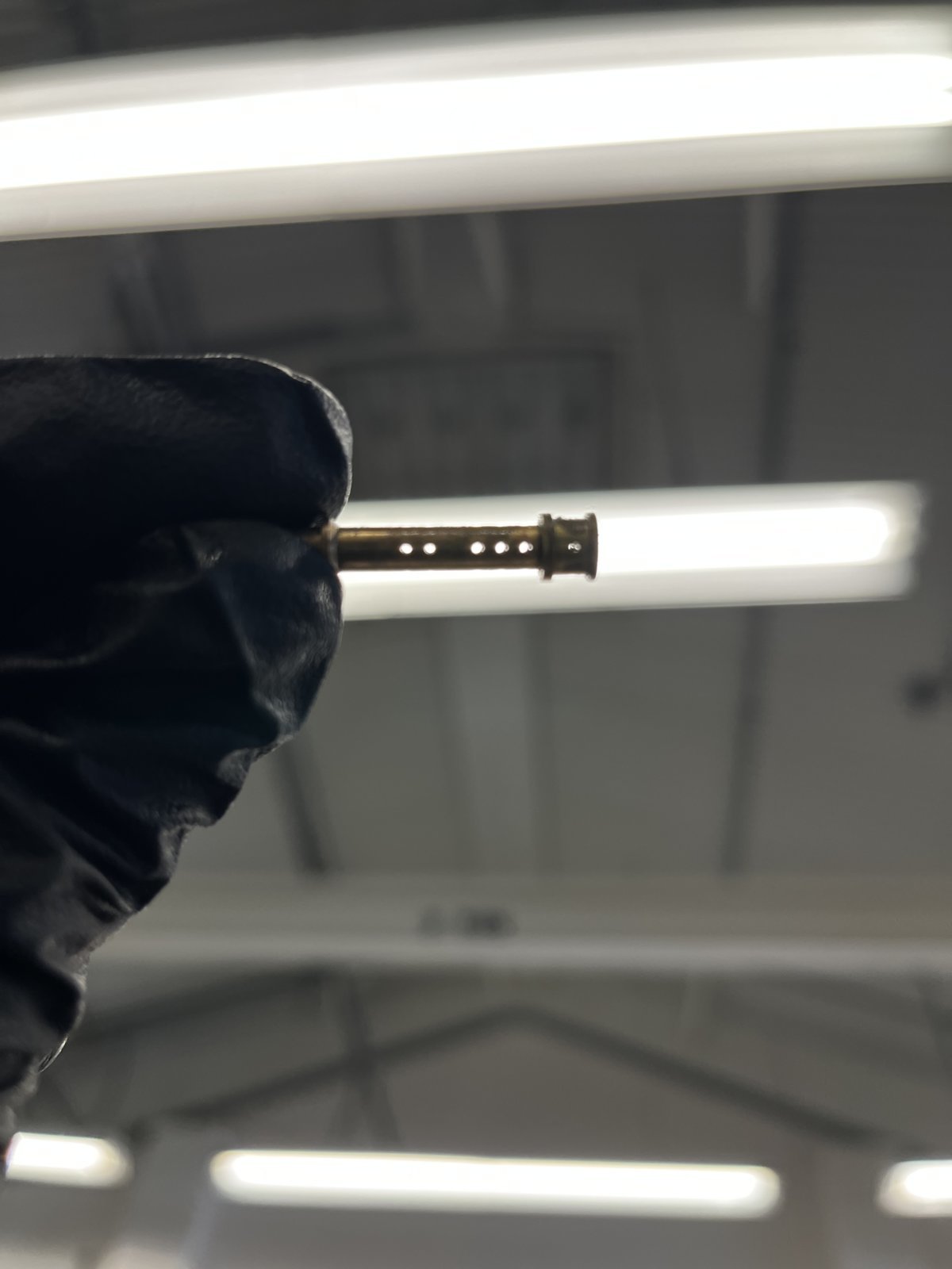

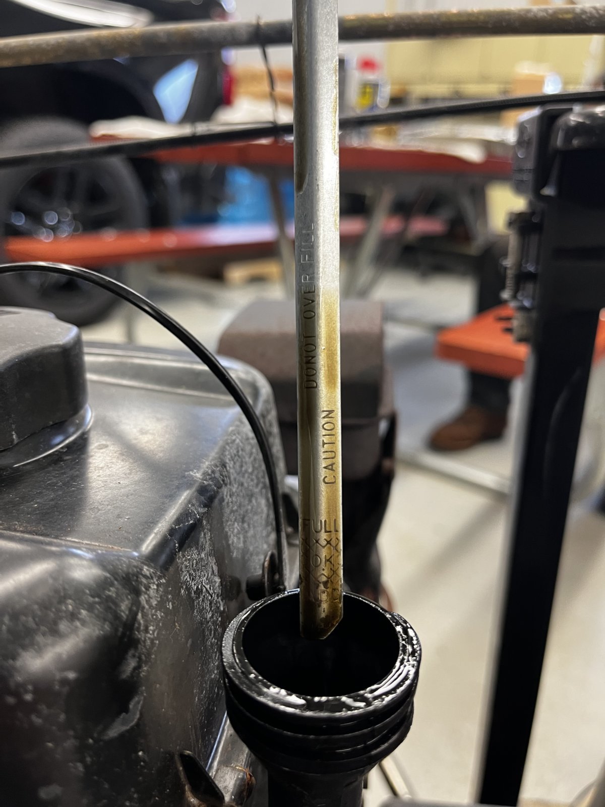

    We had a steady driving rain a few weeks back that caused flooding all over my area. Nothing at my house which is on a hill, but my BIL/SIL’s house got it good. 3’ of water in their basement, shed got flooded real good. His snowblower and 2-stroke tiller were in the shed. Water line made it up to mid chute, so I’d say the engine was submerged. He’s had issues with this blower since they bought their house. Always had to run it partially choked. I pulled the carb, used some acid to clean the jet, drained the bowl and cleaned it, checked for water in the cylinder, checked the oil WHICH HASN’T BEEN CHANGED IN 9 yrs. Oil level was 3-4x what it should have been, indicating water in the crank case.
    Drained water for 25 seconds before the oil started to flow out, refilled with new fresh oil, cleaned the plug, it fired up on second pull. He says it’s never run better. There was barely any actual oil in that poor blower. After it ran for 30 minutes, I checked the oil again to make sure there was no water left, oil looked great but there was milky condensation in the dipstick tube. Cleaned that out, let it run another 30 minutes and it was squeaky clean.
    FYI: 14k gold test solution (muriatic acid) is *awesome* for cleaning jets. Try it.

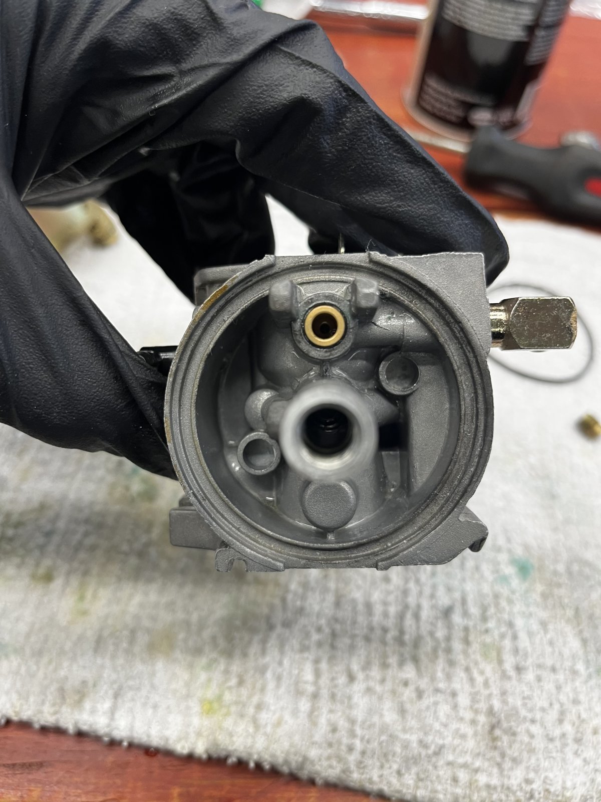

    The tiller was never run, brand new. After it flooded we had a good freeze. It wouldn’t even turn over, frozen solid. Let it thaw out, sprayed wd40 in the cylinder, cleaned the sediment from the carb, mixed up some fuel, pulled a million times and it finally sputtered to life.
