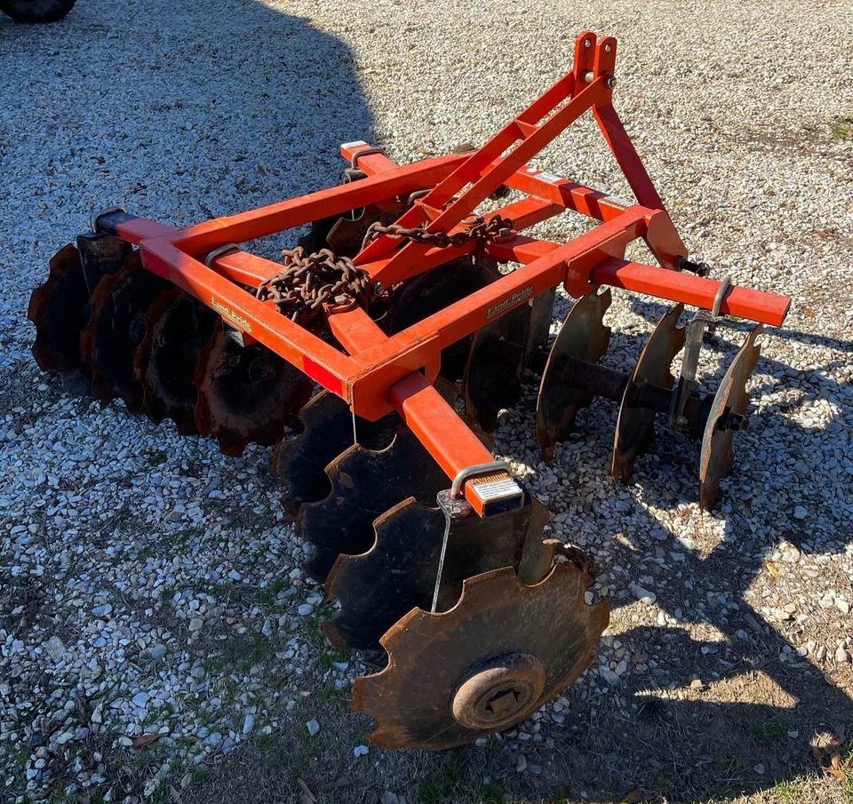

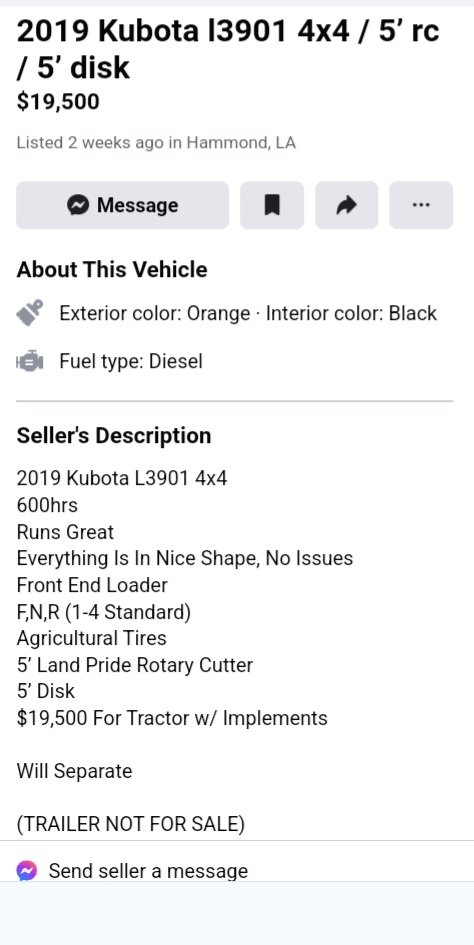

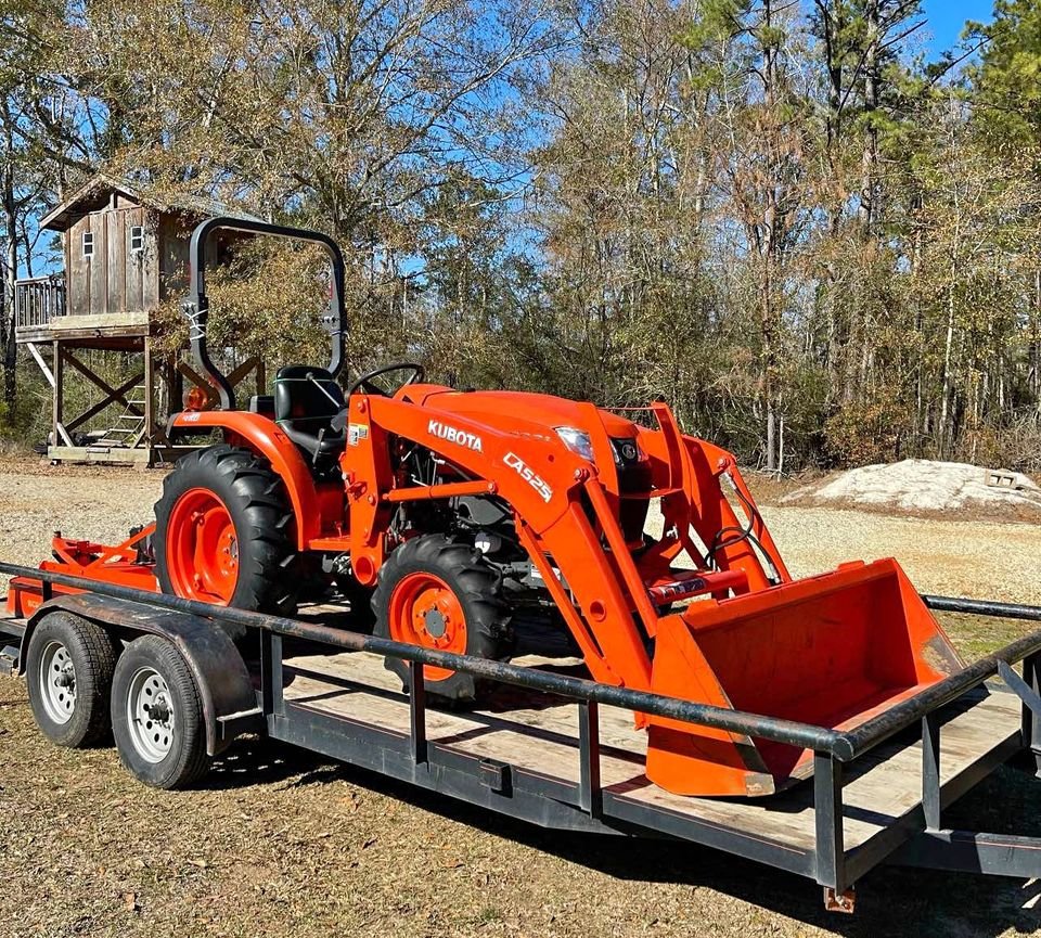

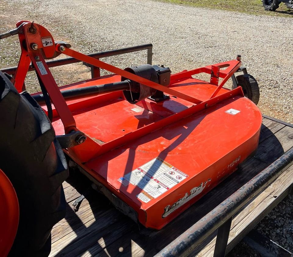

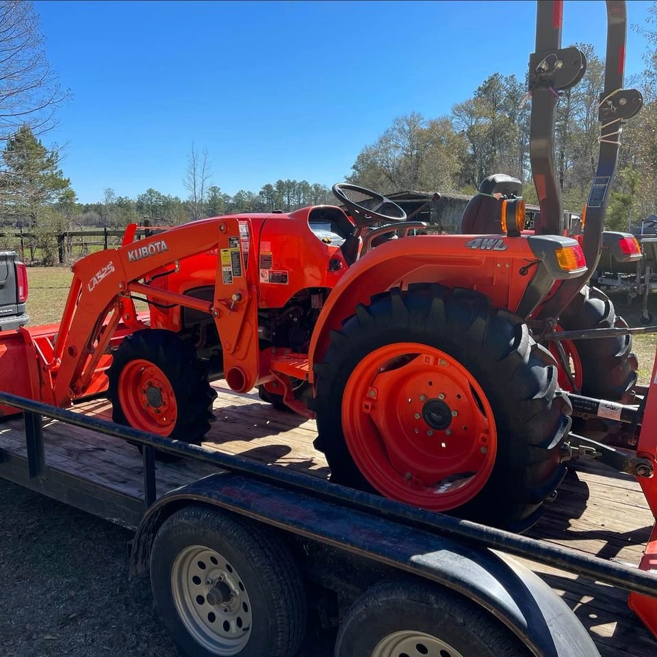

    Been giving more thoughts to a tractor. Never owned one before, only driven one once... my brother-in-law's for a test drive. This is available about 50 miles from me. Grass cutting is handled pretty well by my zero turns. Would use the tractor mostly for moving stuff around, cleaning up branches and stuff after storms, etc. Thoughts?

    Looks like a nice package but how did they get 600 hours on it in 4-5 years is my only question.
    I know that’s not many hours on a machine but it seems like a lot on something not being used on a farm for production.

    I dunno. I haven't yet contacted the seller. Looking online I see others with less hours, and some with more hours. Figuring it's 5 years old, that's like 120 hours per year, or 10 hours per month. But in my ignorance about tractors, I don't know if that's a lot... or too much. :confused:

    It’s really not that many. I’d say they used it to clip a pasture or field with the bush hog just from the pictures and that’s where the hours came from. It looks great in the pictures.

    That’s only like 25 minutes a day every day for 4 years. Or 2:20 minutes a week that could be what it takes to brush hog the back 15.

    It is a manual shift tractor not a hydrostat - this can be a plus or minus depending on your preference.

    I was pretty sure it was a manual. The thing is... I don't KNOW the plusses or minuses. I drove manual transmission cars for 40+ years if that makes a difference. But I don't know how (or if) that applies at all.

    Everyone will have a different opinion obviously, here is mine.
    First, manuals in tractors aren't shifted on the fly like an automobile, you stop and select a gear to use, if you want to change gear you stop and select again.
    If you are mowing/plowing fields for hours where you put the tractor in one gear and drive the manual is fine. The manual also uses less horsepower through the transmission therefore leaving more horsepower for your mower or PTO device.
    For any other use (my opinion again) the hydro is superior especially for the new or occasional tractor user.
    Hydros are easy and intuitive to use, push the forward pedal and the tractor goes forward.
    The farther you push the faster you go, release the pedal and the tractor stops moving. Reverse works the same.
    Using a loader or snow plow is far easier and more efficient with a hydro.
    Mowing in closer quarters is faster & easier with a hydro.
    Creeping along or moving in tight quarters is easy with a hydro.

    Ok, thanks for the explanation. Based on that info, a hydro would probably be best for my types of chores. :thumbsup:

    I really feel the hydro is best for most homeowner type chores/operators.
    The L Series Kubota is a nice utility tractor, be aware it doesn't have a mid PTO so you can't mount a mower deck under the tractor. That L3901 and any modern tractor 26 HP & up has emissions controls - computer control and a diesel particulate filter.
    Kubota also offers a L2501/02 rated 25 HP that still has mechanical fuel injection.
    That said big K seems to have these systems working very well and reliable, just more info to digest.
