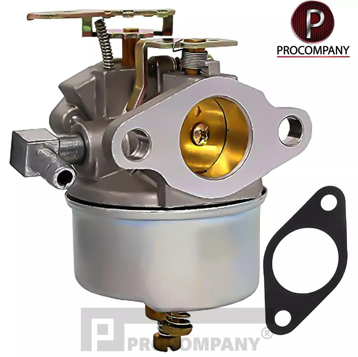

    You can use carburetor cleaner as an either substitute.
    The carburetor should look similar to and be oriented as in the photo below.
    At the bottom there might be a spring loaded drain as pictured, you just push up on the spring and the bowl will drain - unfortunately most modern equipment doesn't have those anymore.
    Right dead center on the bottom of the bowl there should be a nut or bolt, the one pictured below also has an adjustable screw - don't mess with it if you have one.
    Remove the center nut and gently pull the bowl down, there is a gasket or two so be careful.
    Dump it out and wipe it clean with a rag and reinstall.
    Spring drain style:
    Bolt drain style:
    You would only need to remove the Phillips head screw to drain this type.
