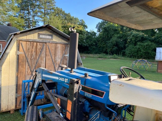

    Trying to move my outbuilding across the yard. Was doing good until a runner came out. Try again sometime. It was over by the fence.

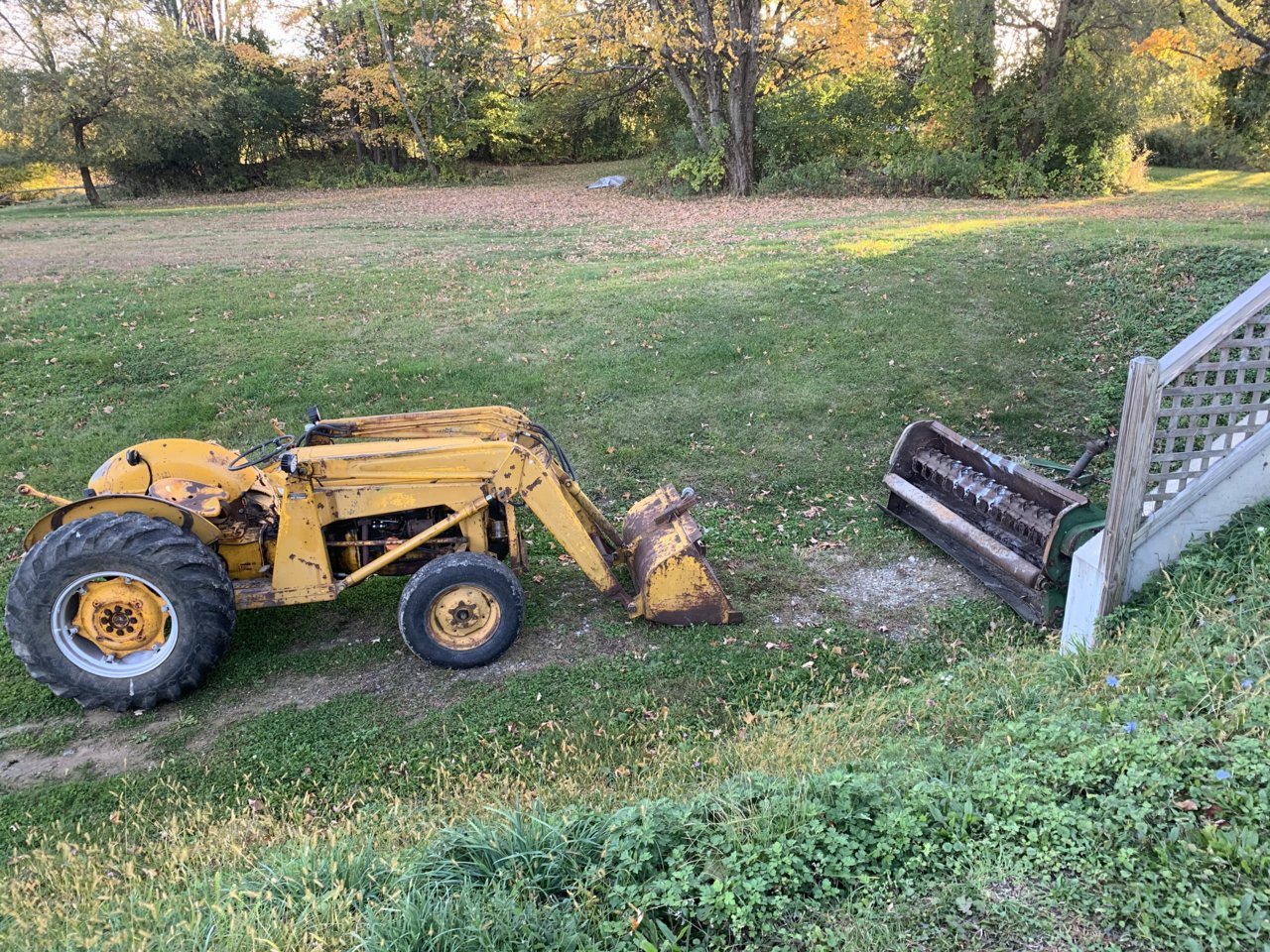

    This was last fall, had to repair the flail mower. In late 2018 I backed into a tree with it (oops!) and bent the hood. The knives were contacting the hood in spots, made an awful racket! Used a few jacks to push it straight and heat it to help it to stop springing back. Had to weld a piece of angle iron onto the leading edge to get the bow out. It ain’t pretty, but it works.
    You can see the white paint where knives were contacting, I spun the rotor by hand with the knives held out so I could verify no more contact.

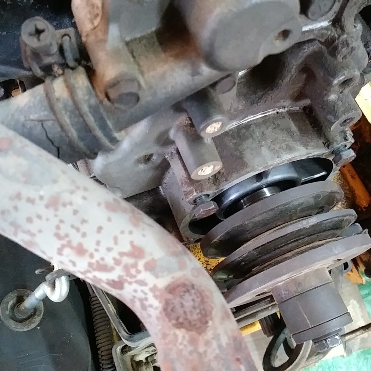

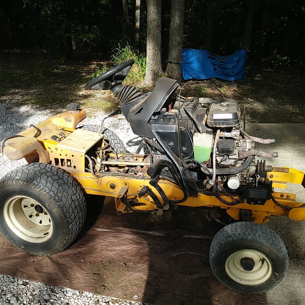

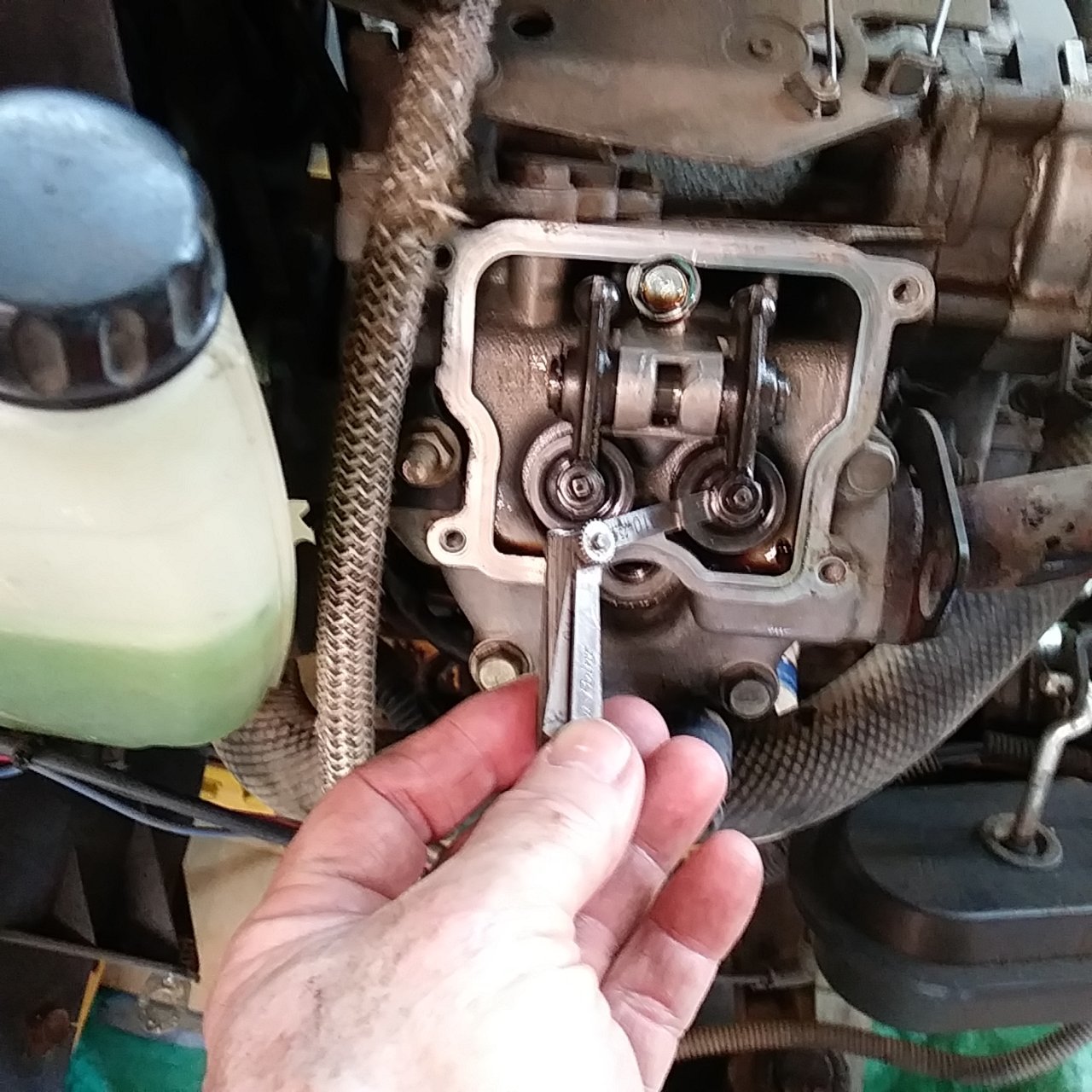

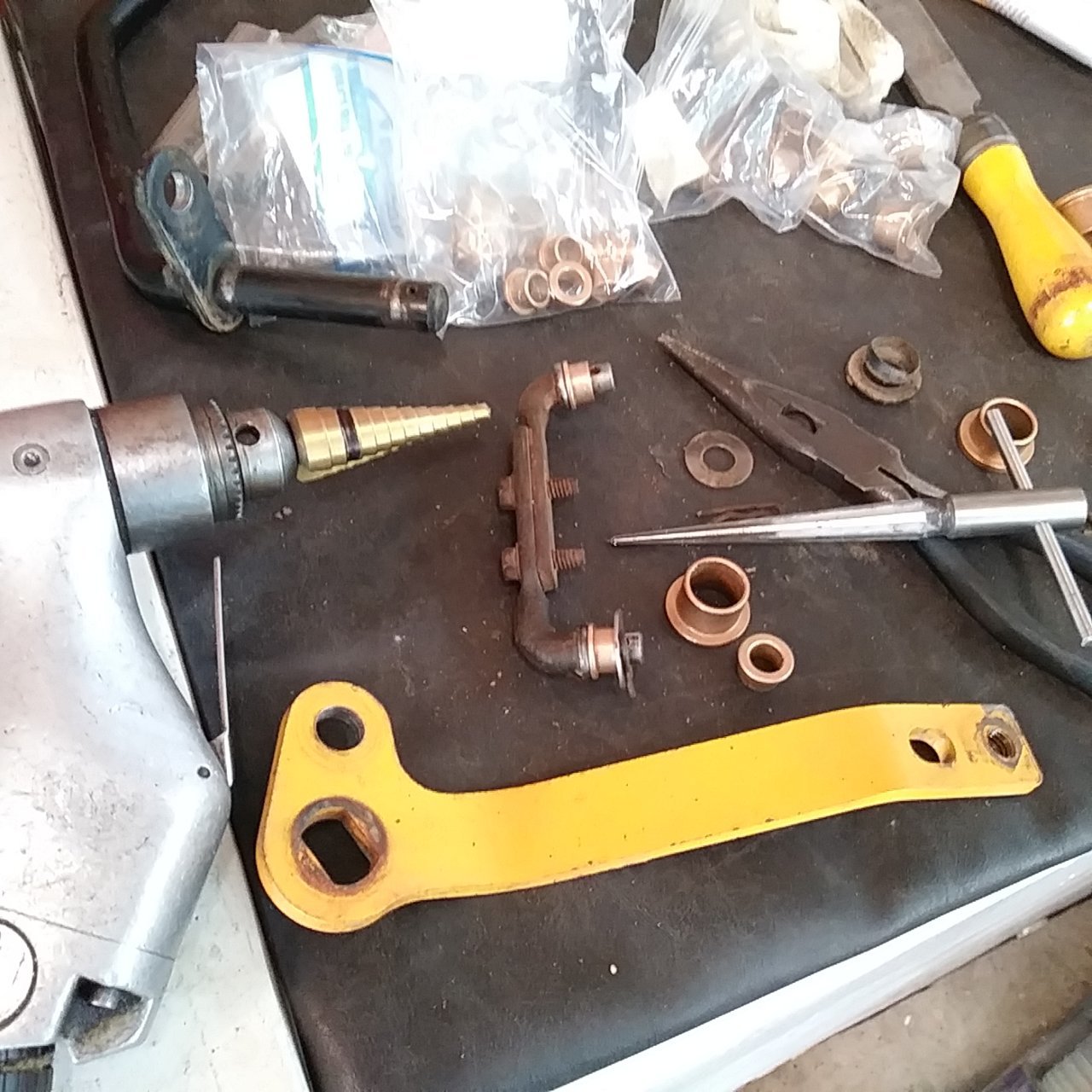

    Been at the Cub 3205 today. Modified it to replace the problematic plastic hydro pedal bushings with BFBs from Aircraft Spruce. Should be the last time they ever have to be replaced.
    Also did the front crank seal, set the valve lash, valve cover gaskets, new plugs, removed all the tins and started blowing decades of crud out.
    Still needs radiator hoses, fuel lines, gas tank seals, and I may do the rear crank seal as the front was hard as rock. Debating on painting all the tin as well.

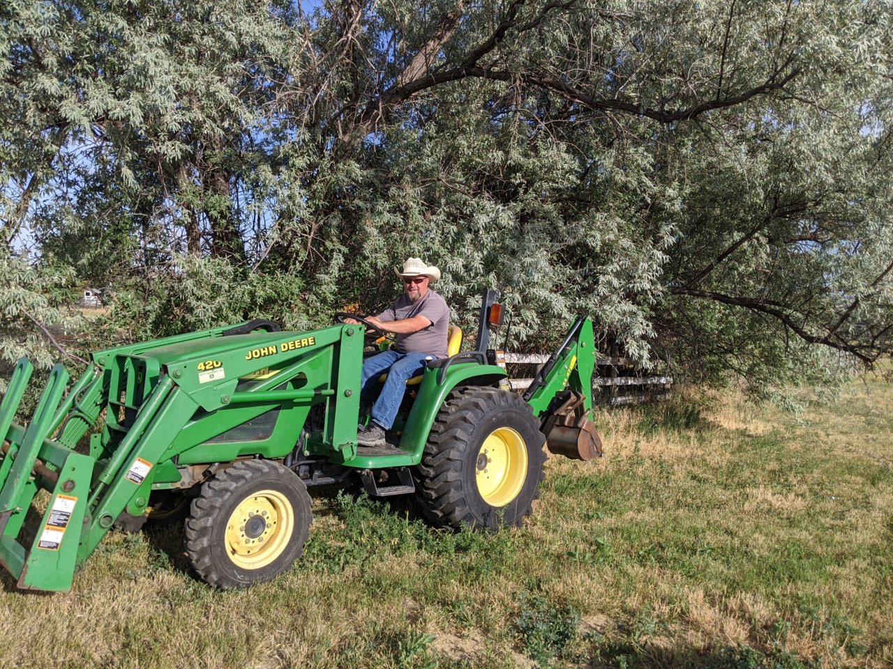

    Been watching this thread with interest as I recently got a small property and I was scouring Craigslist.
    Finally found the one for me.
    For the front, I got forks, a bucket, or snow plow and for the rear, there's a backhoe, 8' mower, auger, and box blade.
    Lots of projects just got doable :D

    The BFBs I bought were $.50-$.90 each. The junk OEM plastic bushings they replaced cost $3-7 each. Plus they use USPS shipping so my total for ~24 bushings shipped was $13.

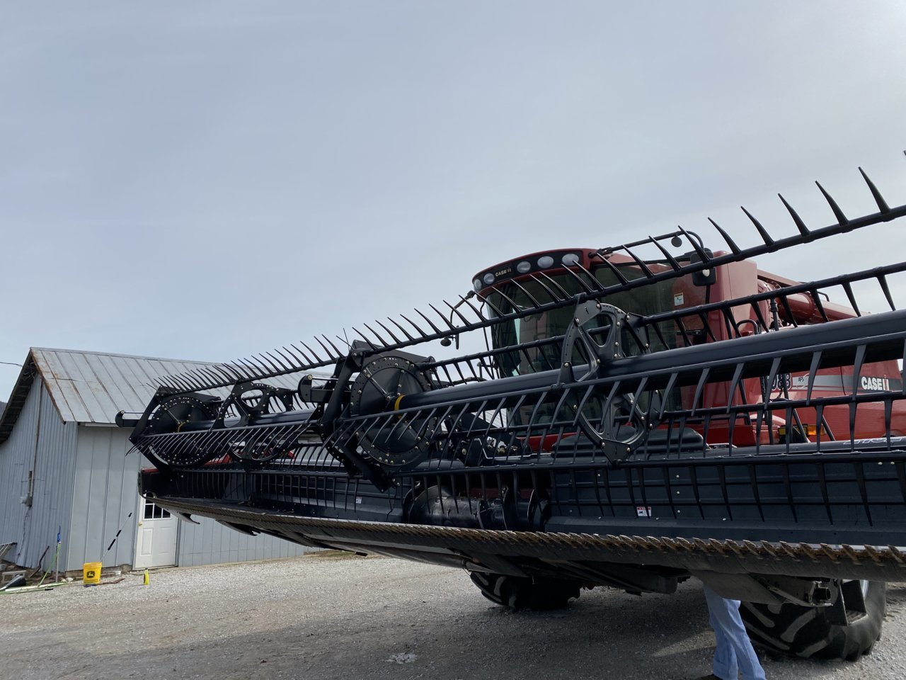

    Friend just sent this to me. He’s in Montana, not sure where he took the picture but it says 5 millionth IH built.

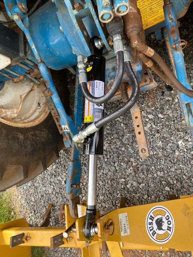

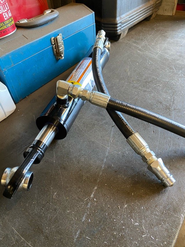

    Hoses and fittings were almost as much as the hydraulic top link. I’m excited to get this on later :thumbsup:

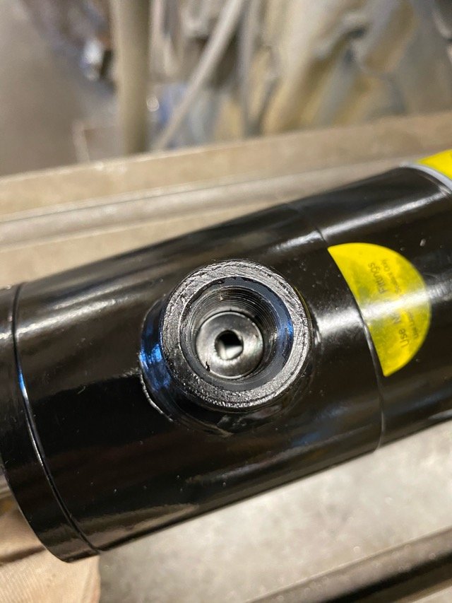

    I went with 1/2” hose because the quick connects are 1/2” NPTF thread, check out the hole restriction in the cylinder, it’s 3/8” NPTF, the hole is about 3/16”.

    Should allow nice, smooth, controlled movement. :)

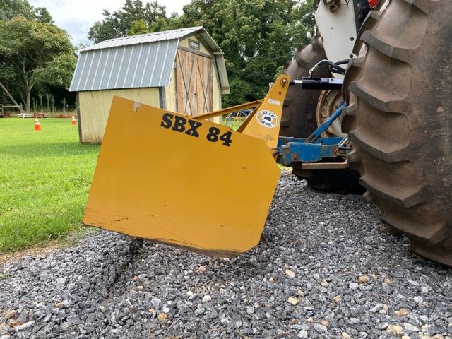

    This is gonna be awesome when I get to use it :thumbsup:

    Do tour arms also adjust? If so also add the tilt option.

    I only have two remotes, the loader is plugged into the other one. My right arm adjust with a screw type adjustment.
