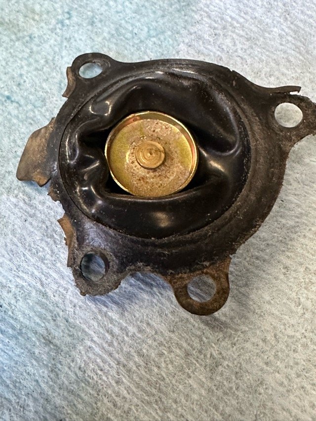

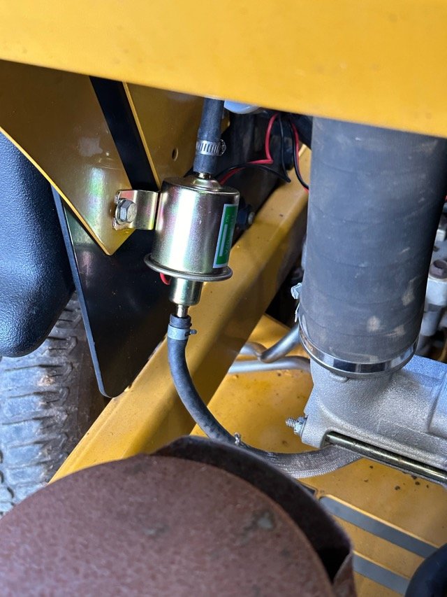

    Some of you know and some don’t, my mower with the Kohler starting acting up last summer. I have fought and fought it. All new fuel lines, filter, plugs (2 times), genuine Kohler coils, Amazon fuel pump, Kohler fuel pump, Amazon carb, another used Kohler carb, back to the original Kohler carb, head gaskets, it runs great for 20-30 minutes then shuts off. It recently started starting on one cylinder and would eventually catch the other one.
    I took the carb off yesterday and took it apart. The accelerator pump was hard as a rock, replaced it with one out of the other carb. Still hard start, one cylinder.
    I told Cole let’s try something, I had a brand new 12V electric fuel pump. Put it on, starts easy, runs strong, mowed some with it, not sure if I got a bad Kohler fuel pump or some other issue with the vacuum line feeding it, I did replace it when I did the fuel lines though.

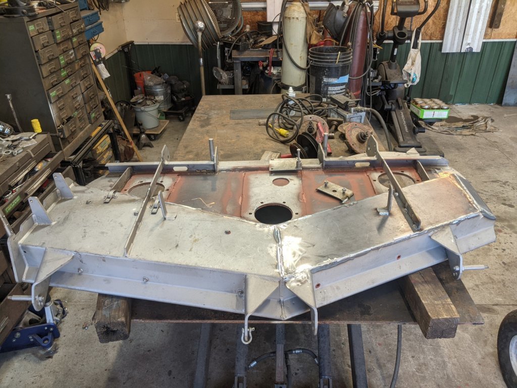

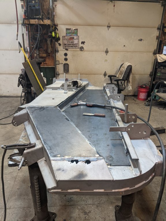

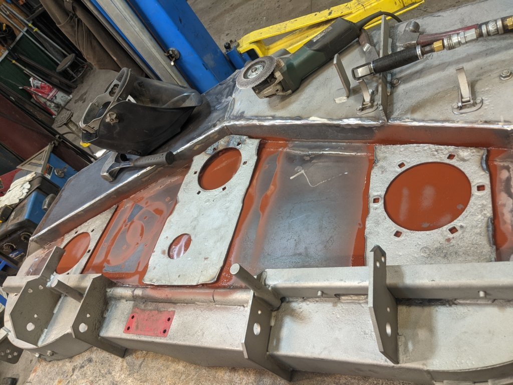

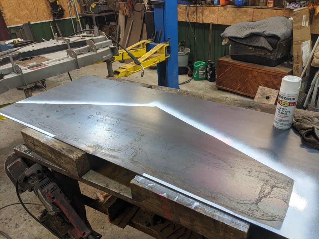

    Now finally to the fun part.
    The fab work is never fun. Welding is fun.

    Looking good!!!

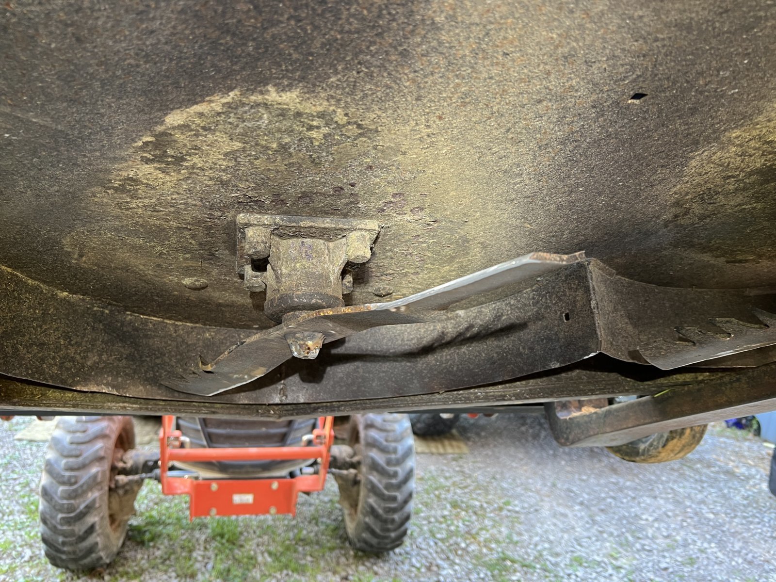

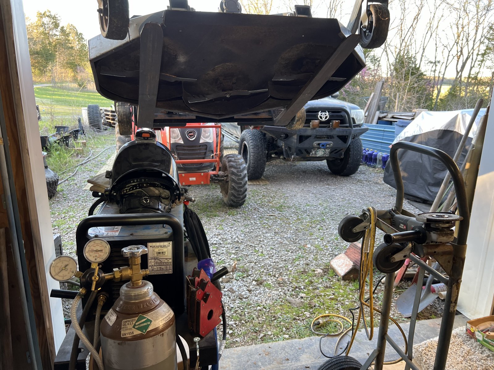

    I rewelded the center blade to the spindle again. Hopefully, I'll get one more season out of that spindle. :fingerscrossed: I cleaned up the cutting edges while I had it up in the air.

    That is basically building a full on new deck for that mower. Nice work!
