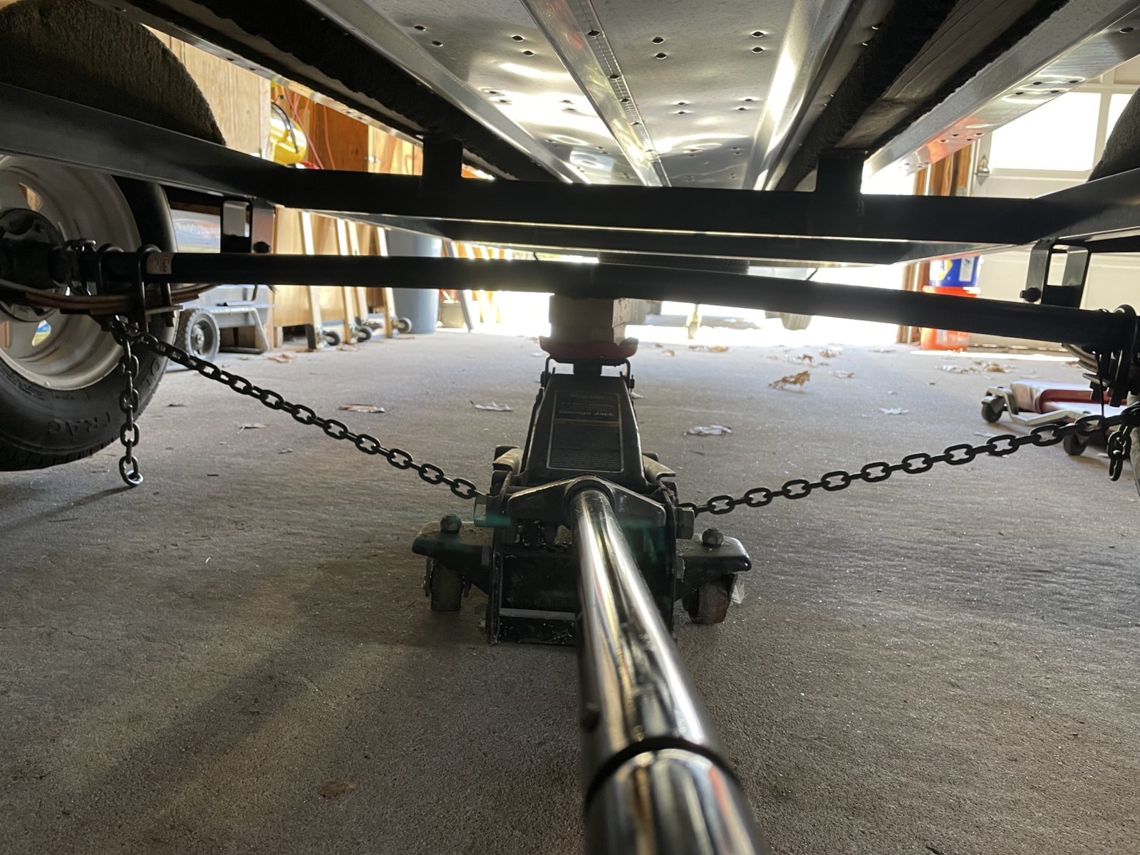

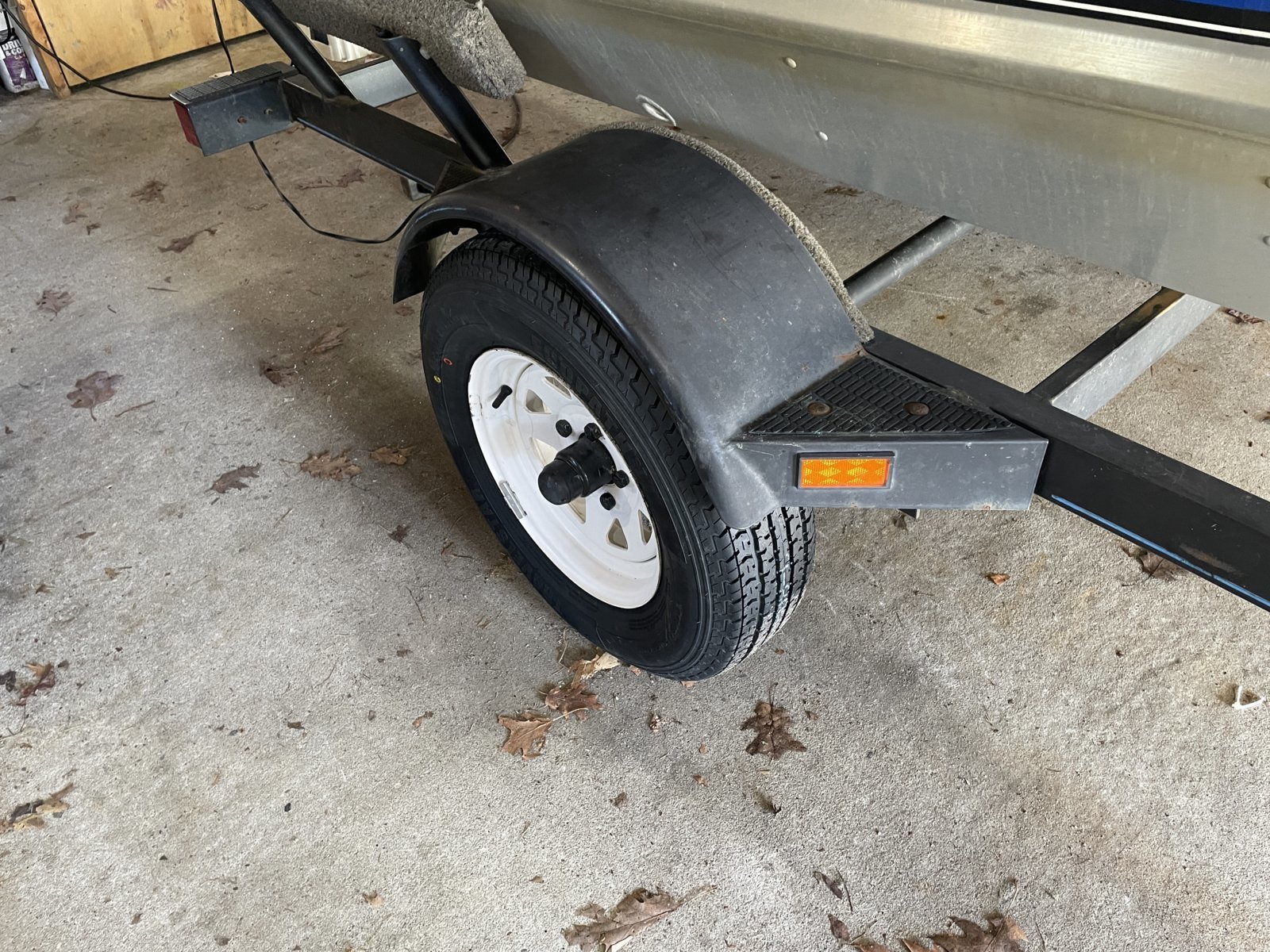

    I put new skins and aligned my trailer yesterday..

    What's the procedure for aligning a trailer?

    shoot brother that looks amazing.

    I’ll run it for 100 miles then I’ll recheck. If I get a chance I may get the race car alignment kit and
    Check the toe but it never feathered the tires. Just inside wear.

    Flexing axle by pressing up allowing adjustment of camber in tires.

    Gave it more positive camber.
