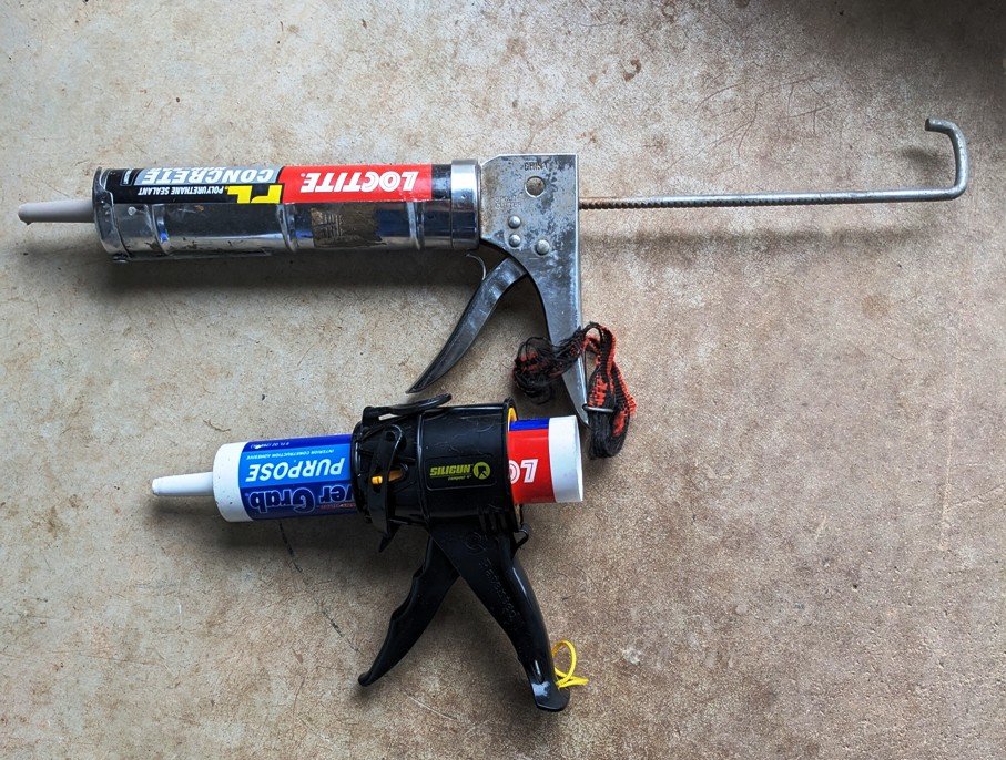

    now anybody else got one of these yet? its called a Siligun. its basically a tiny caulking gun for full size tubes.
    what i can tell you so far is that it squeezes good & makes the flow as advertised. It does fit in smaller places.
    what it doesnt do? carboard tubes. gotta be plastic tubes to use it.PXL_20240504_214339897~2.jpg

    That is a cool gadget. :cool:
    Kind of like a Dremel, you don't need it often but when you do nothing else works as well.

    Neat gadget. Be nice for tight areas thats for sure. But it aint replacing my battery powered one!

    I don't know, if you know what you're doing that normal hook can be a useful tool

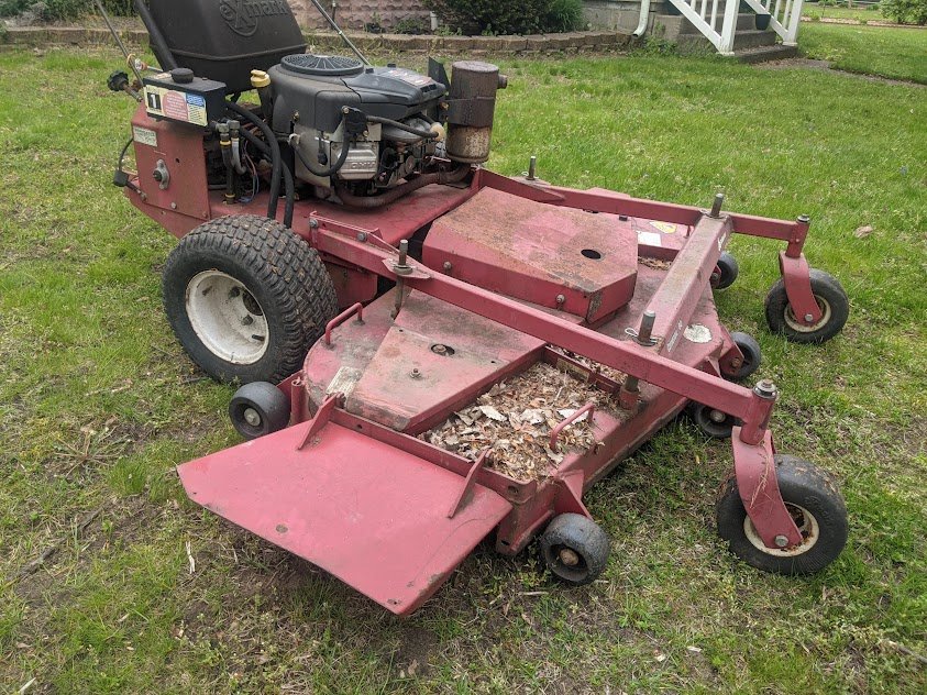

    Repowered this unit. oOriginal engine was a 17 kawasaki. Now its got 22 B&S. It moves! Make sure you are on you A game. She is squrellylly.

    Nice!
    Harbor Freight used to have a nice Kawasaki clone engine but they stopped carrying it.

    Looks cool as hell!
    Not sure I'd like working on it.

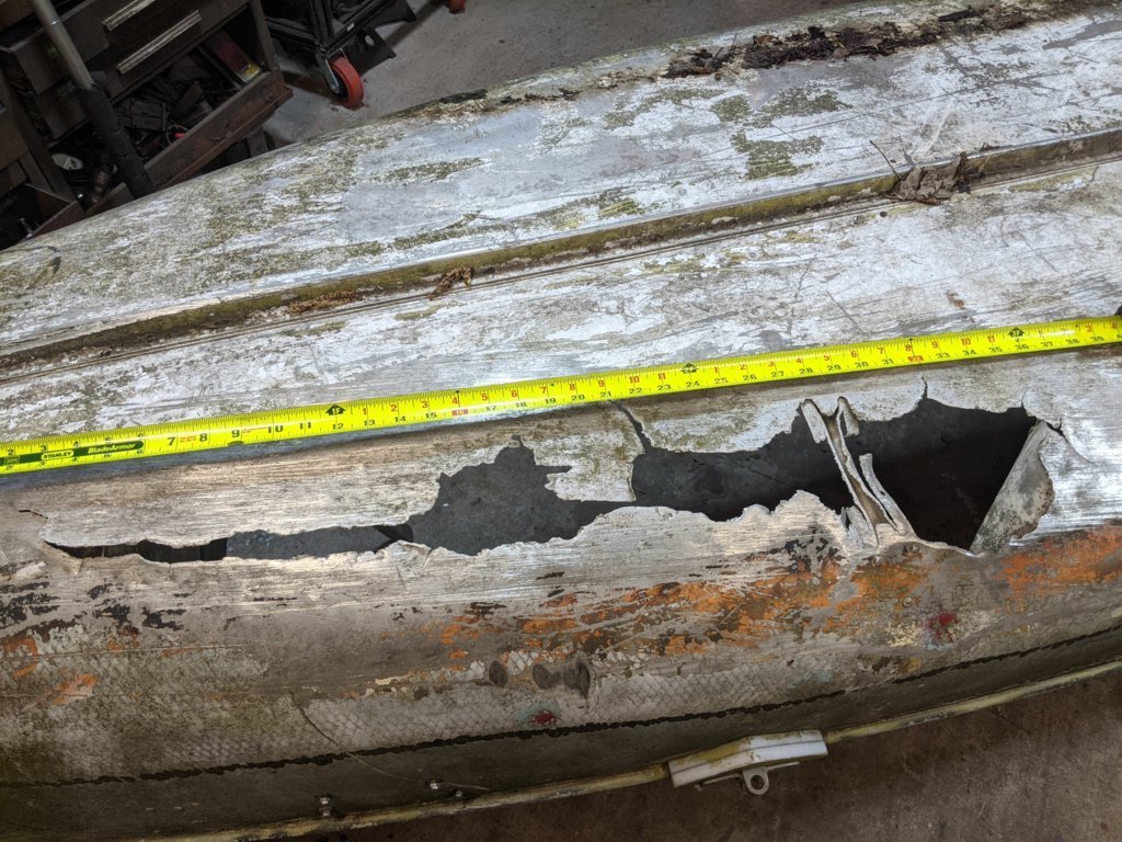

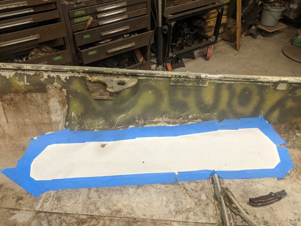

    A customer asked if I could repair an aluminum canoe. Said I never had, but was willing to try.
    Back story: his bud and him were night fishing for trout on the Au Sable. Boat was half assed tied into the bed of the truck. Had lots of beer in us, listening to LZ cranked all the way to 11. Commercial came on the radio and they heard a strange noise.
    The noise was the canoe getting dragged for several hundred yards of back roads.
    My job was to just make it float.

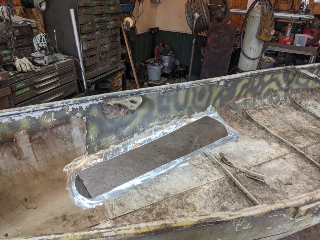

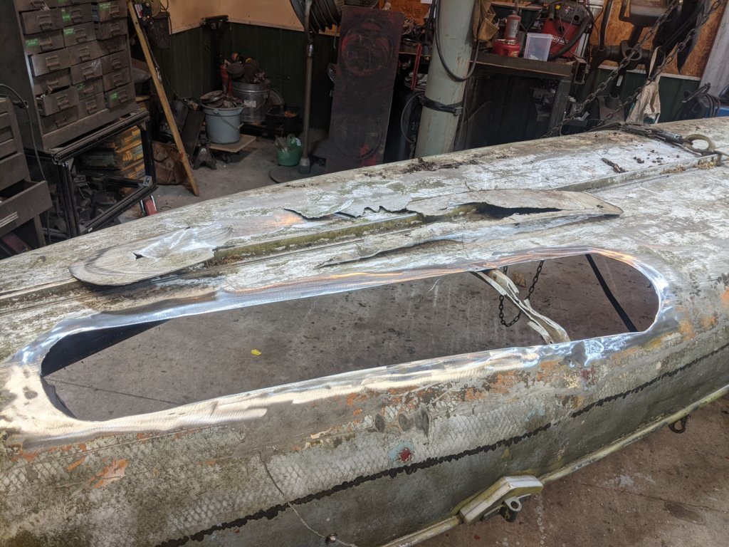

    Used cut off wheel on my hand grinder to remove the carnage.
    Of course the damage extended under the rear seat. Those rivets needed drilled out to make that happen.

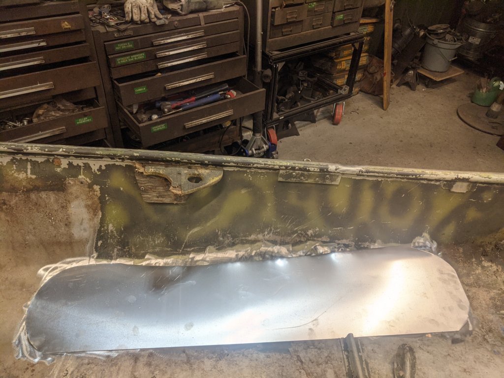

    Needed to make a pattern. Taped some butcher paper to the hull and ran my grimy thumb around edge. Cut a pattern 2" bigger to apply to the new alloy.

    New alloy being test fit. Still need to clean up the base alloy.

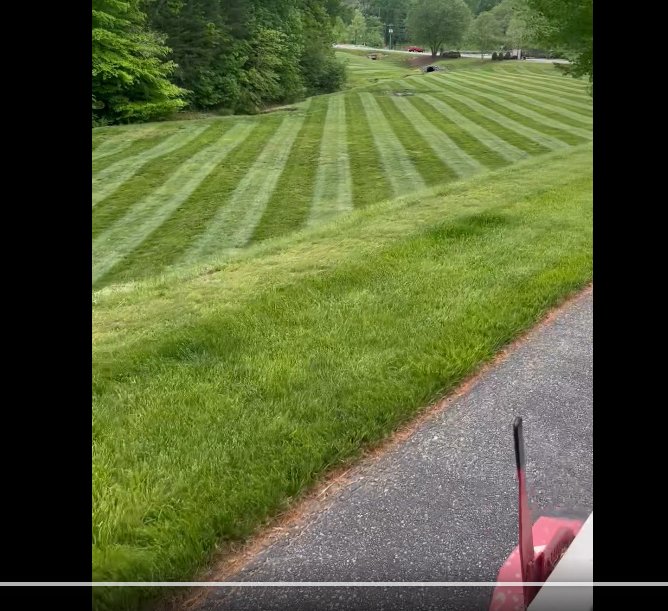

    damn if that thing can’t lay down some stripes!!!
