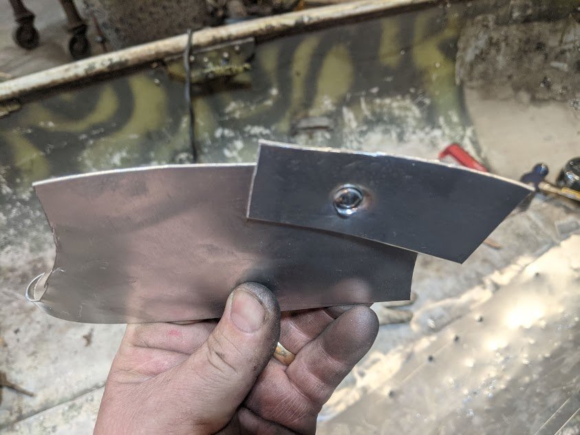

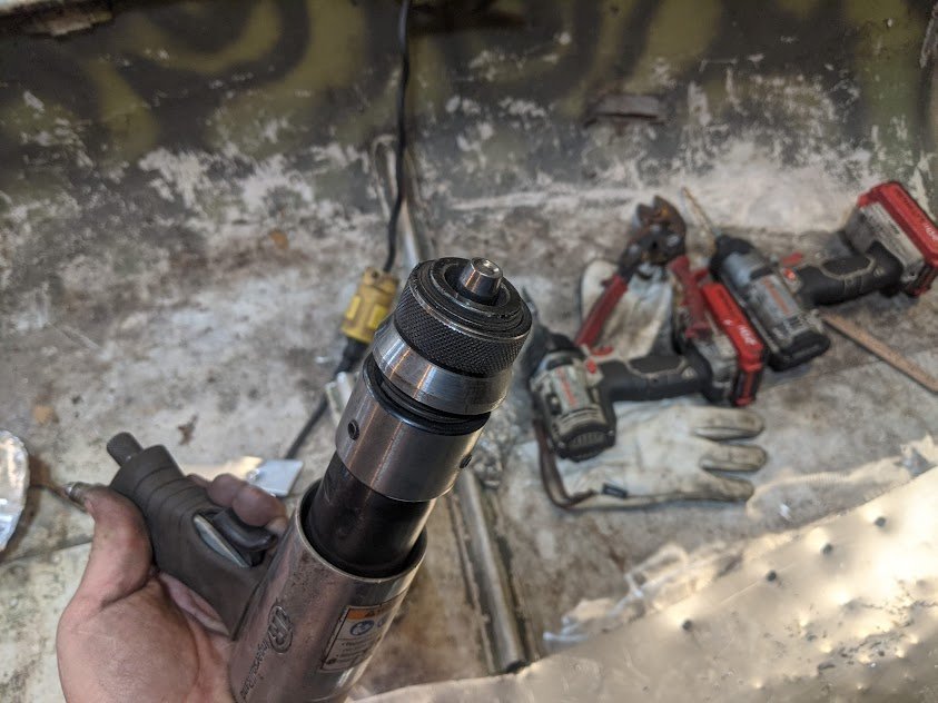

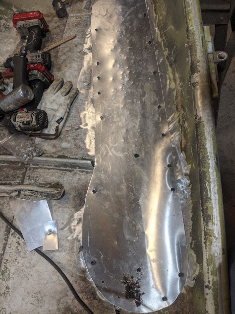

    Reserected from the dead.
    Practicing my solid rivet skills.
    Good enough for this pig.

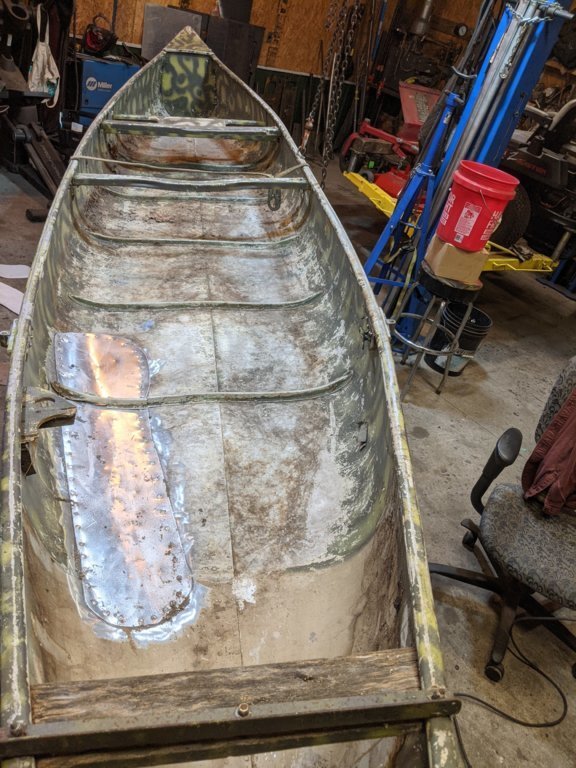

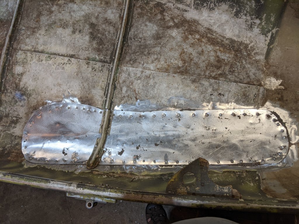

    Patch is riveted in. Sorry no pics of the sealant or the riveting.
    This was a messy job and reaching under the boat to hold the rivet bucket killed my back!
    The only thing that cuts that 732 sealant is acetone. Wasn't touching my phone until I was all cleaned up.

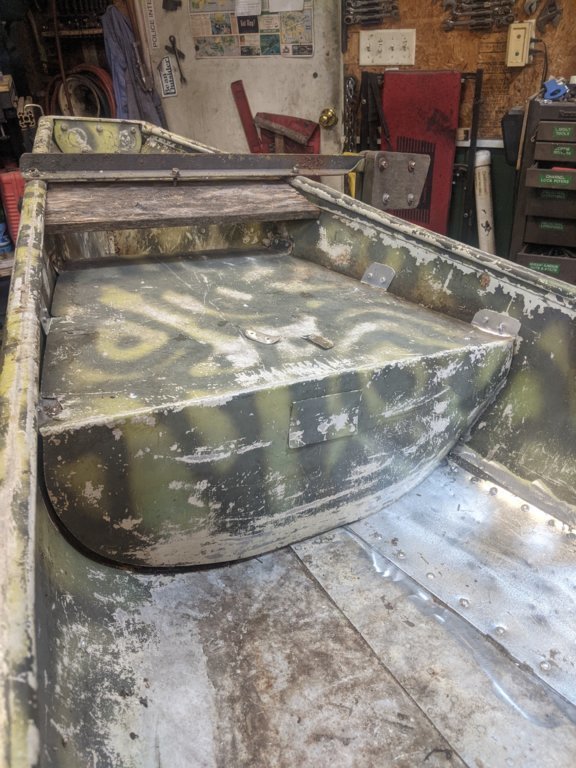

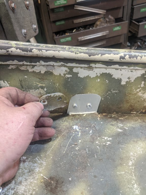

    The tabs that hold the rear seat in position were broken or about to break. I just fabbed straps that run the full width of the seat. Probably overkill, but it worked out great and looks good too.

    Note: the foam floatation under this seat was a mouse hotel!
    As soon as I removed the rear seat, I tossed it out the door! Needless to say, this boat smelled like mouse piss in a bad way!
    The owner can buy his own can spray foam and inject new flotation.

    Love your work efforts!
    But as another posted up there..... That was a job for some flex tape. :)
    Then again, riveting is a great skill set to have.... And totally get the because you can aspect.

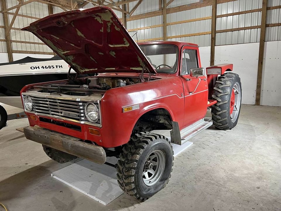

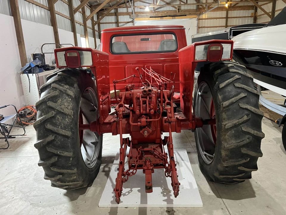

    Awesome lol. 435316897_423637426917321_6859349038331011057_n.jpg 436415718_423632853584445_5864921466550995780_n.jpg 436770693_423632836917780_942377611425641256_n.jpg

    this is so cool. im in!

    So you should call this a TRUCKTOR.... :)
  18. May 8, 2024 at 6:22 AM
    DES2009
    DES2009 Minister of Truth
    Jul 22, 2014
    #134426
    1,000,547
    Southeast Louisiana
    2017 MGM Limited
    I'm a Millionaire! One Million Posts!!
    That's what International Harvester called it . . .
