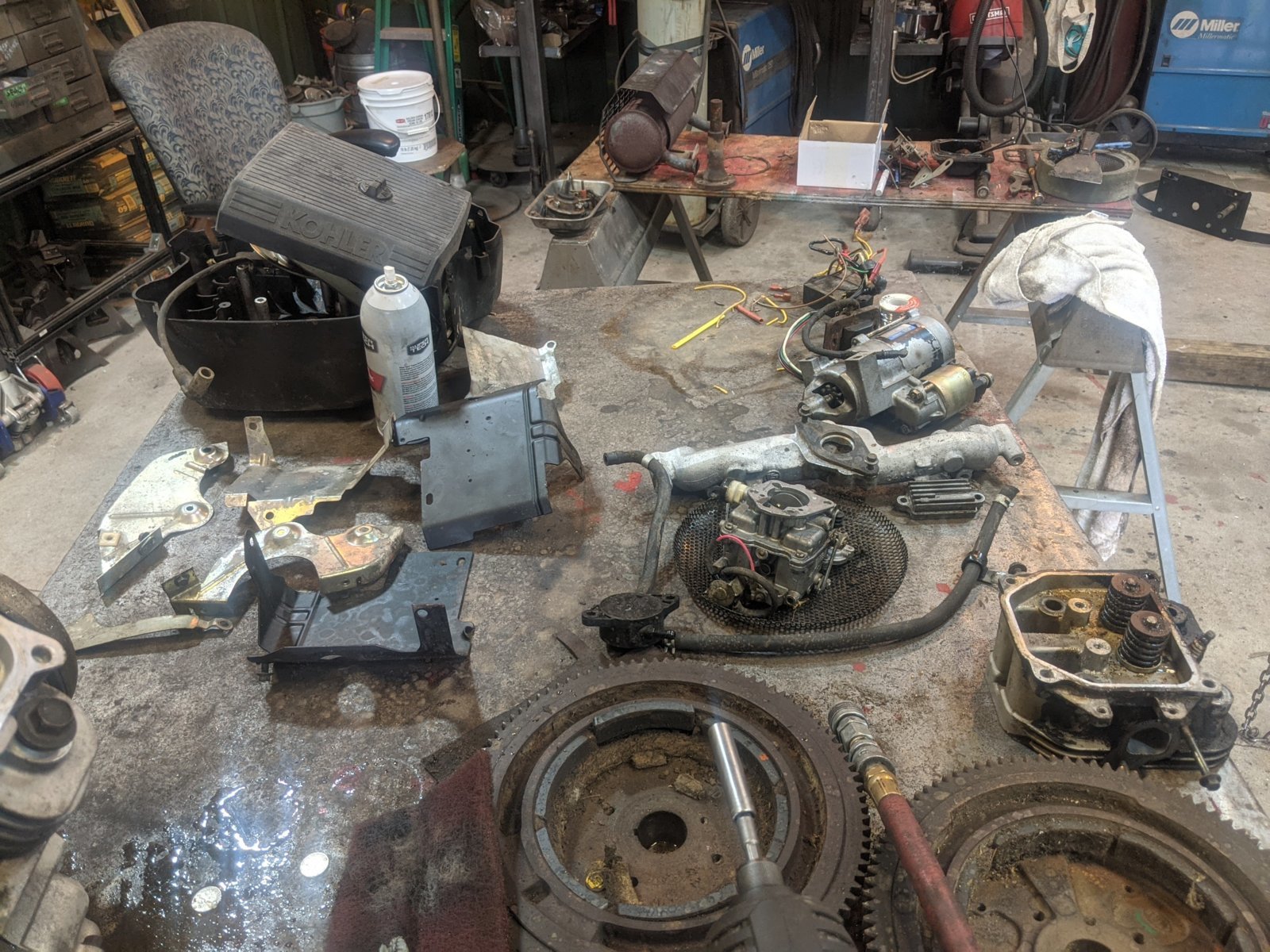

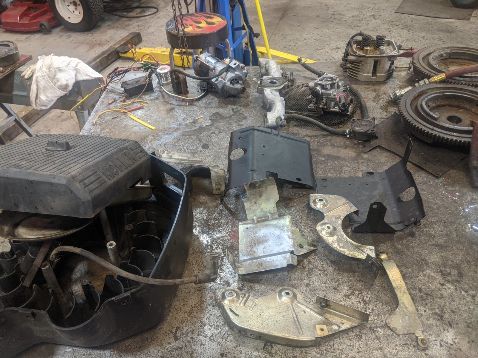

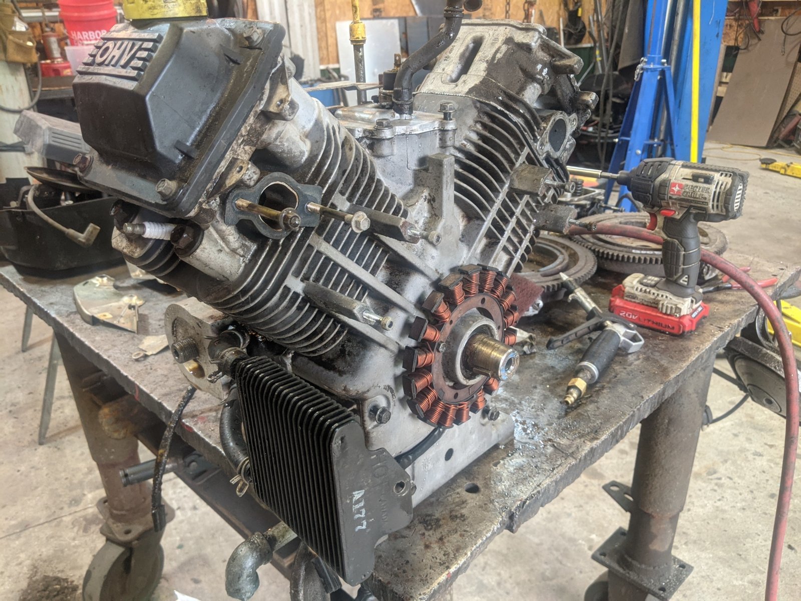

    PXL_20240517_141428283.jpg PXL_20240517_141442782.jpg PXL_20240517_141506565.jpg
    Parts all cleaned up.
    Found 2 magnets in the flywheel had dislodged. Already had a flywheel that was repaired earlier.
    Found vermin damage on a few of the wires on the harness. Easy fix.
    Had to replace head from the side that had a bad head gasket. The thing puked so much oil, its a wonder it never caught fire.
    Will have to cut the muffler apart and repack it. Sounds like a Harley with straight pipes.
    I hope I'm not making a mistake by not changing the #2 HG. That side was bone dry.
    Hopefully I can get it back together this weekend.
