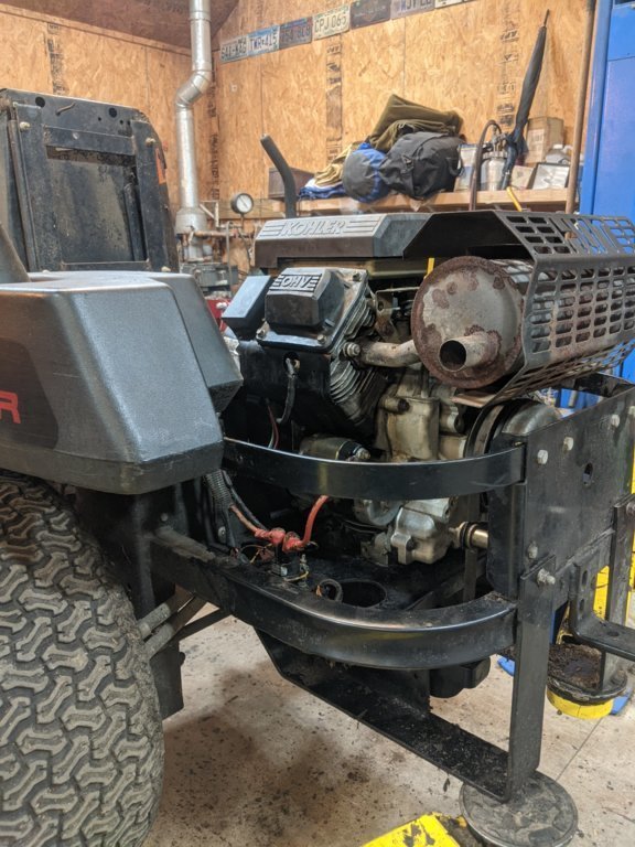

    This is the engine I replaced the head gasket and did a deep clean on. I mentioned that I had an over fuelling issue.
    It was confusing me. It would start great when cold and run great while using it.
    If I shut it down for 10-20 minutes, it would be completely flooded.
    Anyways, I shut the thing down after mowing. It's heavy cotton wood fuzz season here. I wanted to clean the fuzz off the filter. While doing that I could actually see gas flowing out the top of the carb!

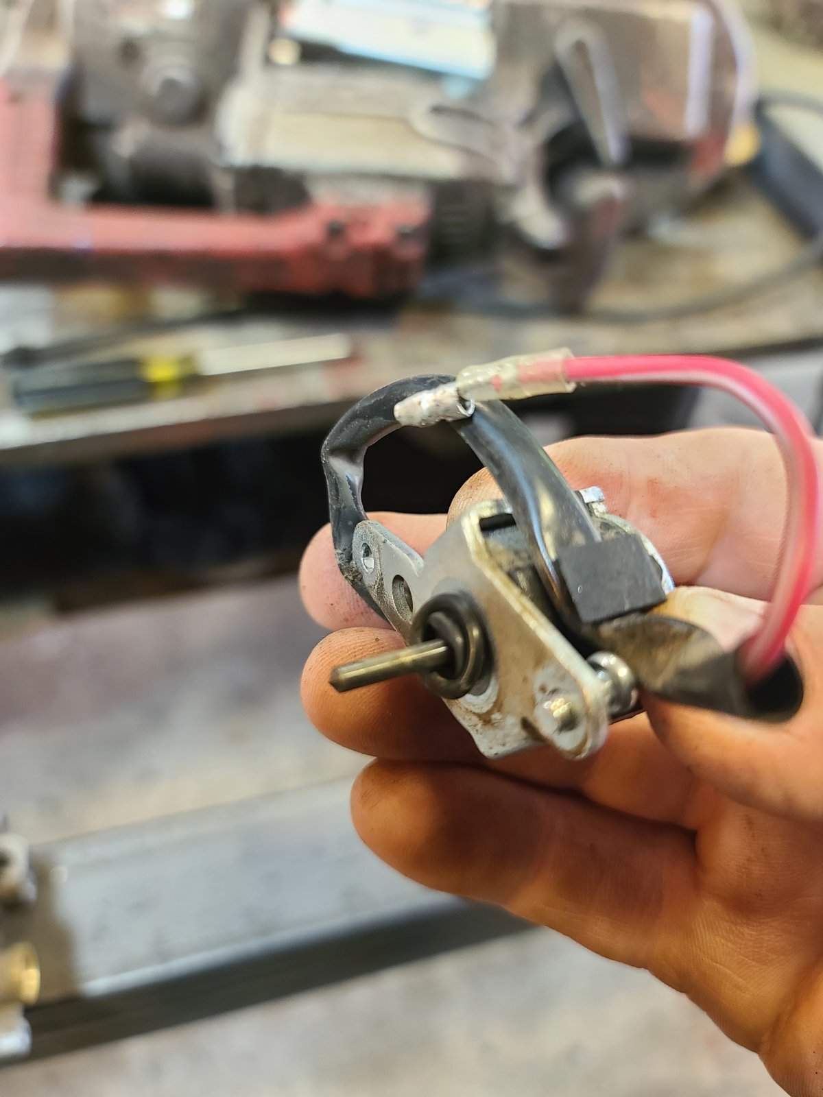

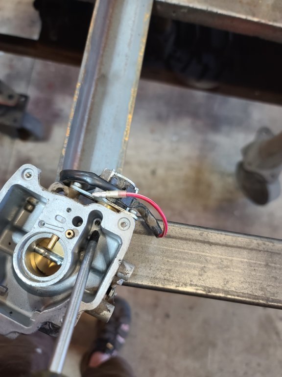

    This is the port for the solenoid that shuts off the fuel to the carb.
    I removed the solenoid and blocking plunger and cleaned the residue off it.
    It now runs normally and starts normally no mater if it was a hit or cold start.

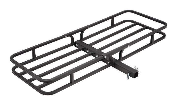

    So could you go from ^^^ that to something like
    this ^^^ and load it with concrete blocks or 5 gallon water buckets if you only need some ballast occasionally?

    In theory yes. Why not? But that might put the ballast too far back for tight movement. Since the B7100 is small I use the scrape blade because it has weight to it.

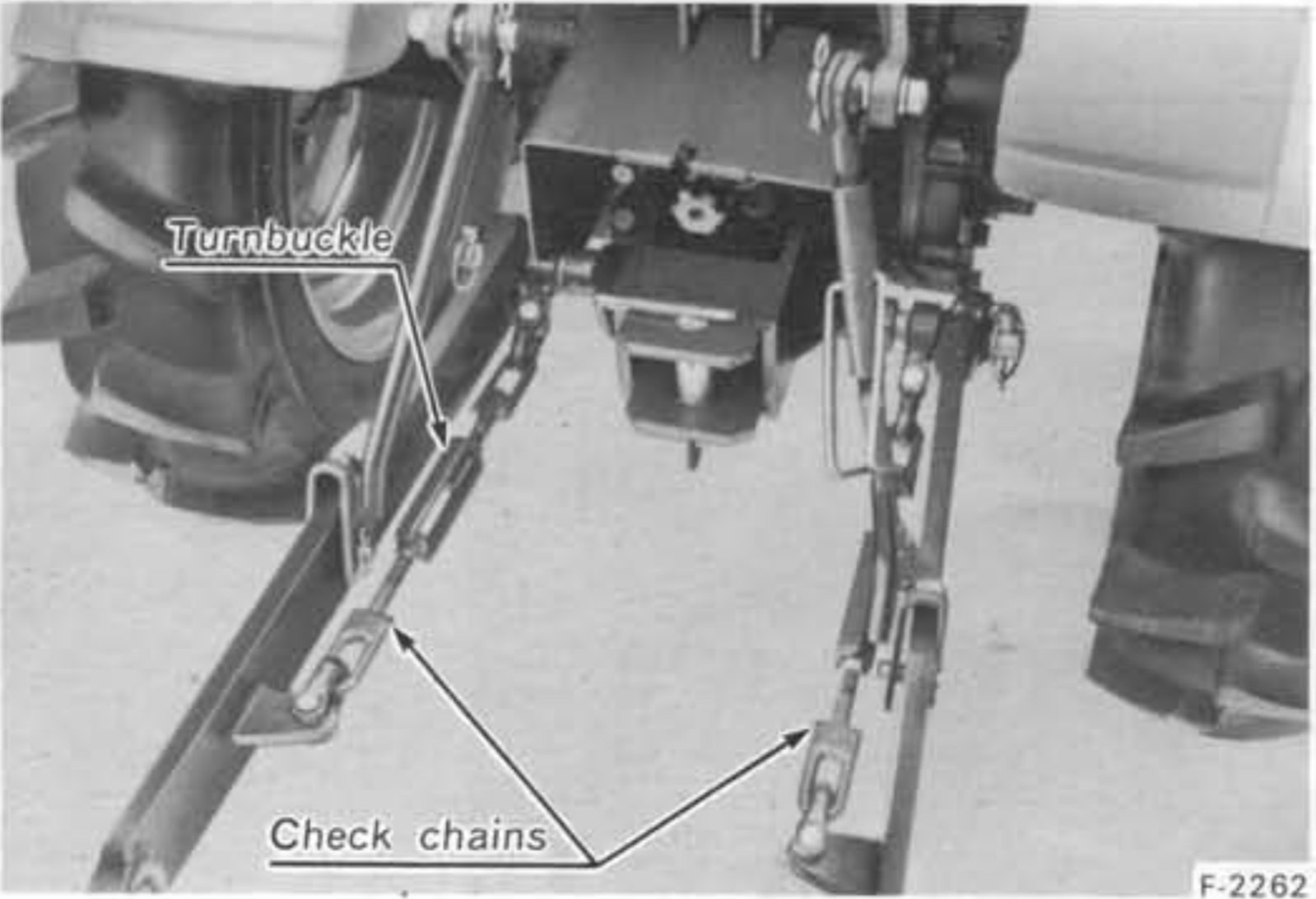

    This is what my PTO looks like with available draw bar attachment
