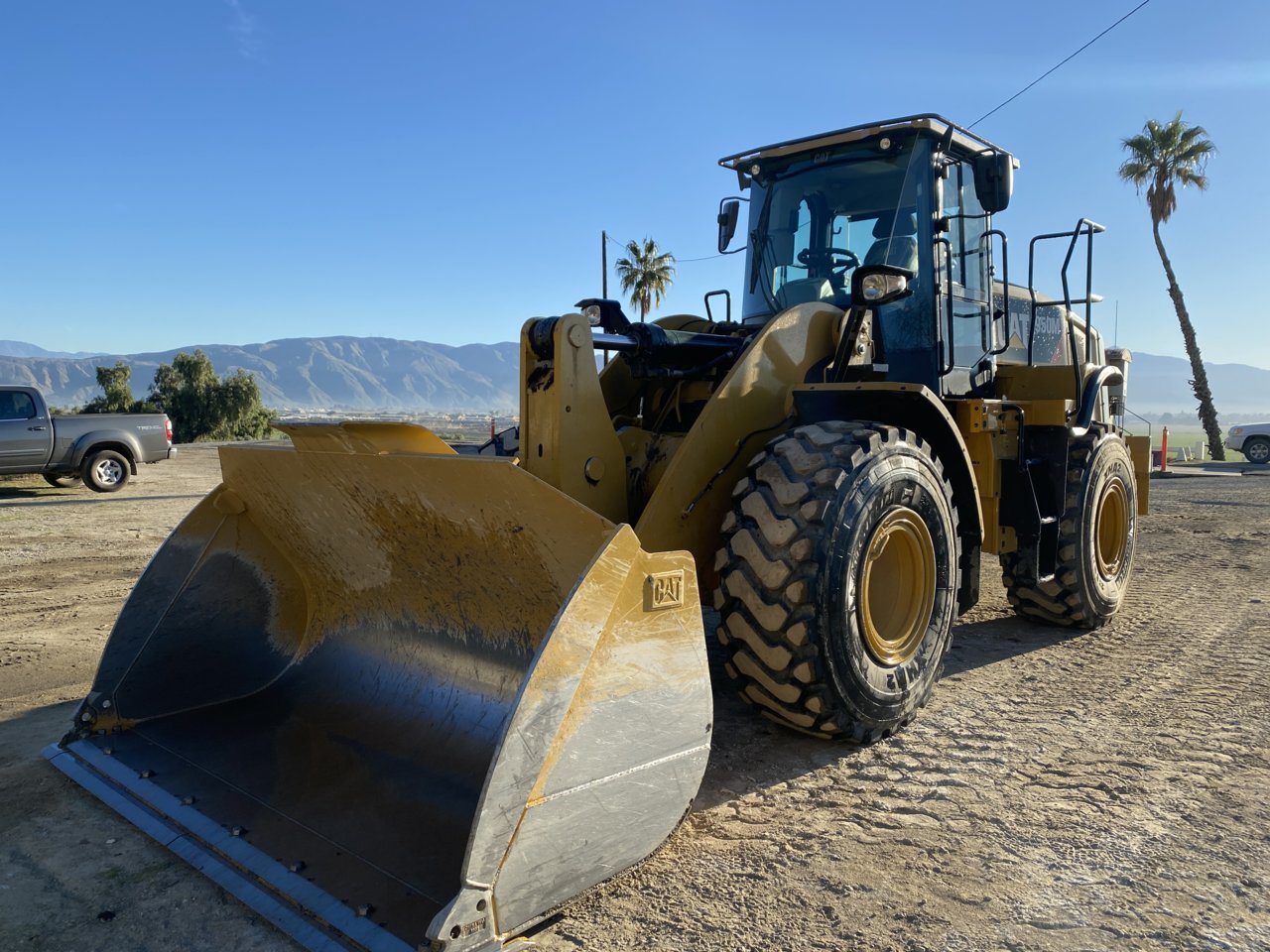

    Are you at a power plant or is that a chiller in the background?

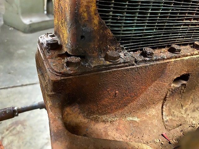

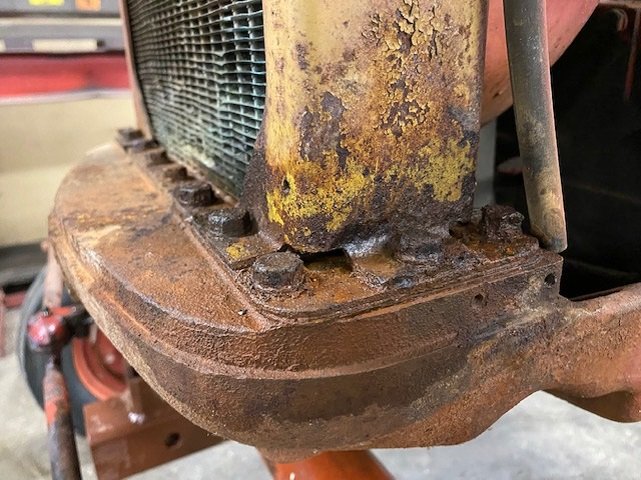

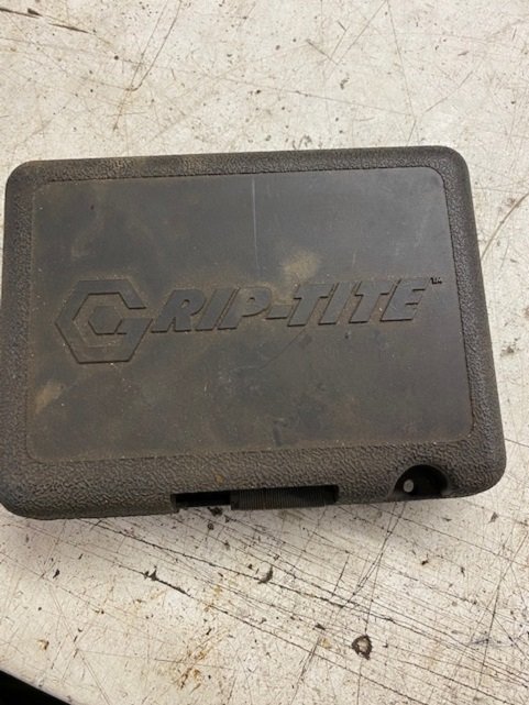

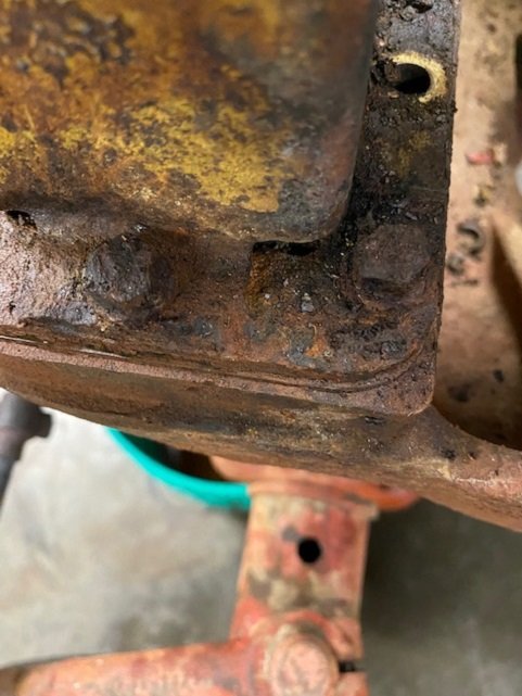

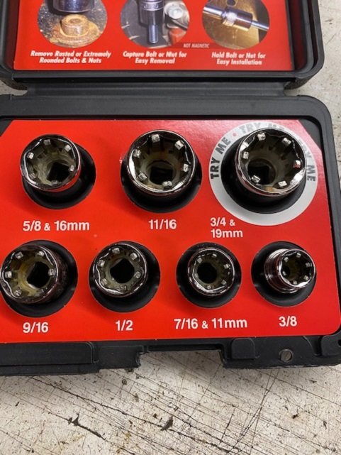

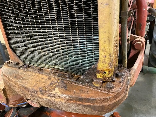

    This radiator apparently has been leaking for a while with all the rust around this side. As much trouble as it to remove I just ordered a new Clancy through A & I. Some of the bolts on this end the heads were almost gone. I remembered last night I had these grip tite sockets and have never tried them, I know why now, they don't work. Wound up using a 6 pt. 12 MM on one, an 11MM on another one and a 10MM on one, had to drive it on with a hammer.

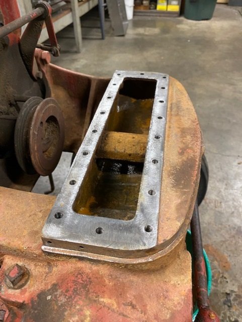

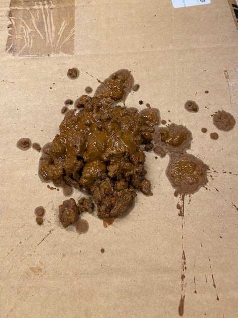

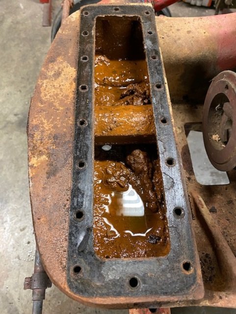

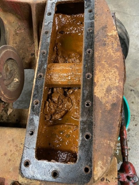

    Got all 18 bolts out without breaking one. Thankful for that! The inside of the bolster looked like a porta-jon at a state fair. It was nasty. Cleaned all that out, re tapped the holes, and sanded the surface. Flushed the engine by pouring hot water through the top radiator hose. Got to go get 18 stainless steel bolts and it's ready for a new radiator.

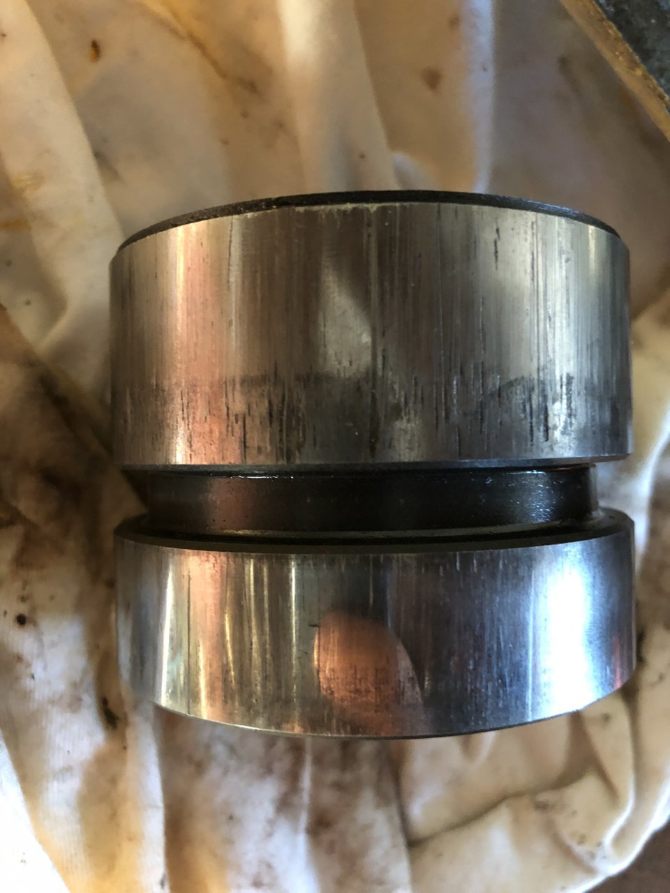

    these two fords are what we have at home. The one with ROPS is a gasoline engine, one without is diesel. Both are 3 cylinder. We recently rebuilt a lot of the hydraulic system on the diesel, and had the top end redone because she was knocking. She runs ok but the bottom end is weak.
    here is a pic to show you just how bad the rear gannon leak down was lol.
    Just a tiny bit scored up.
    Fun little tractors though.
