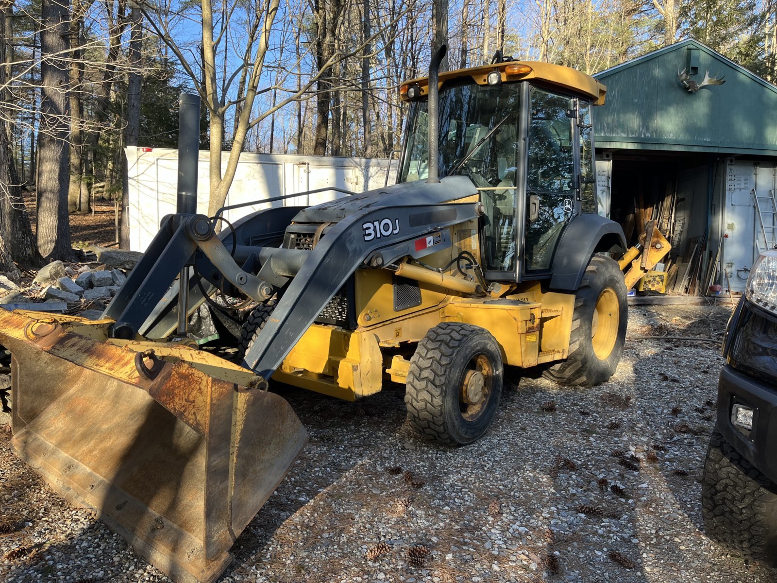

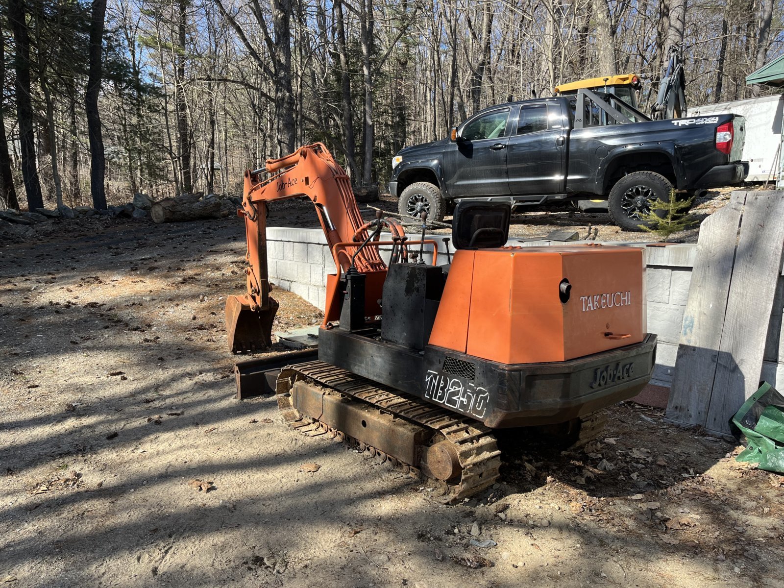

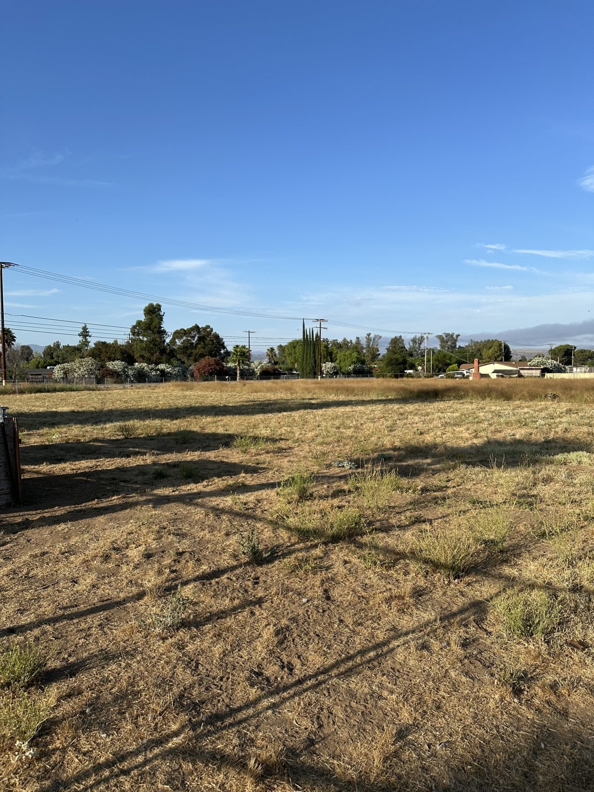

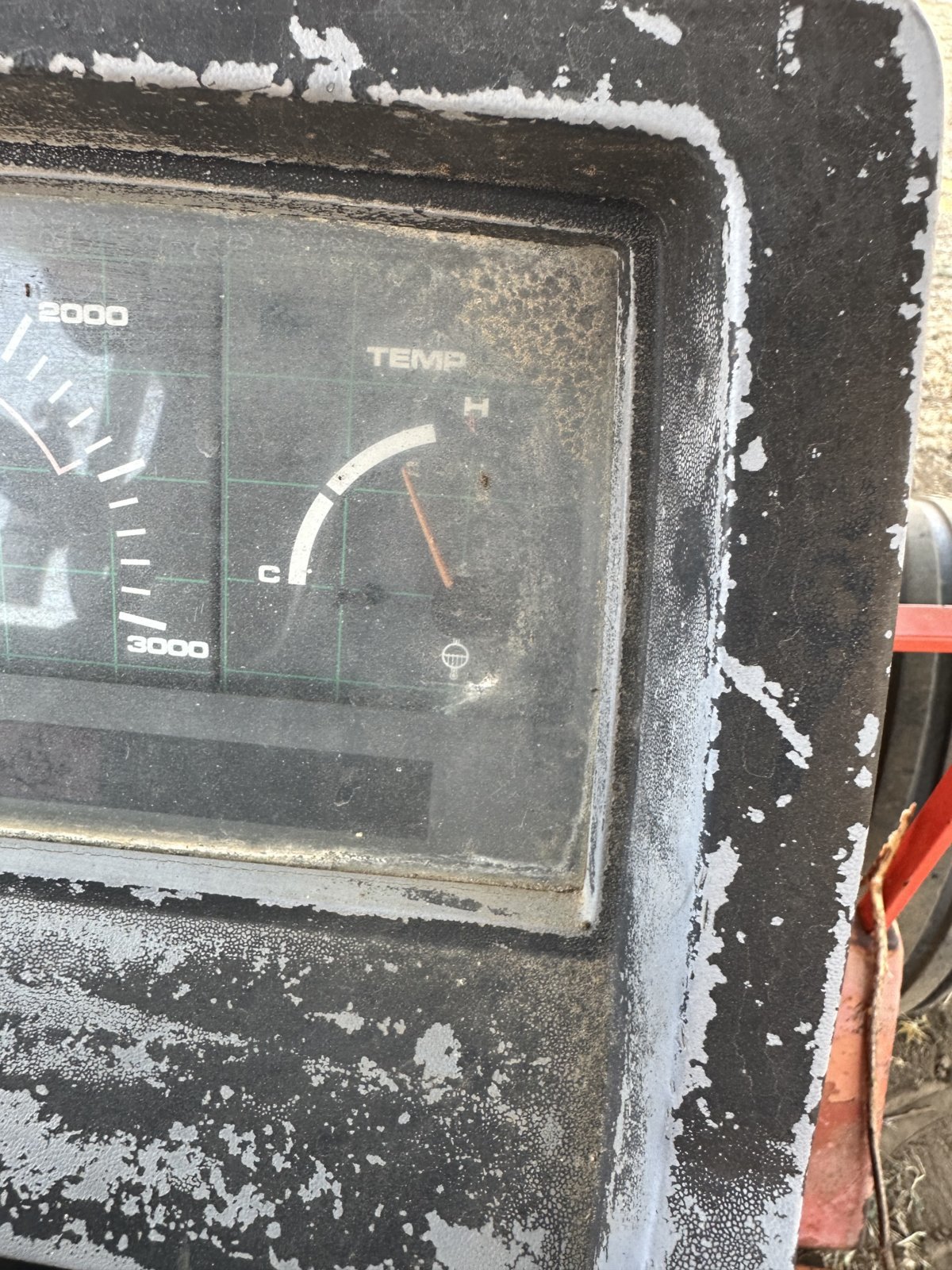

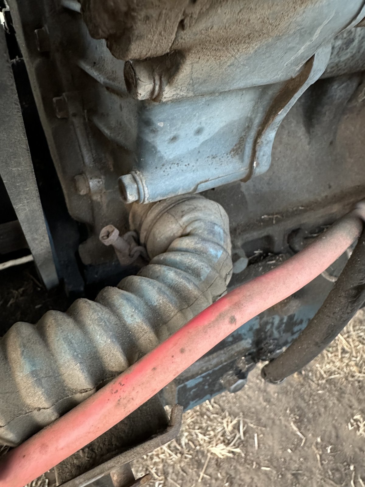

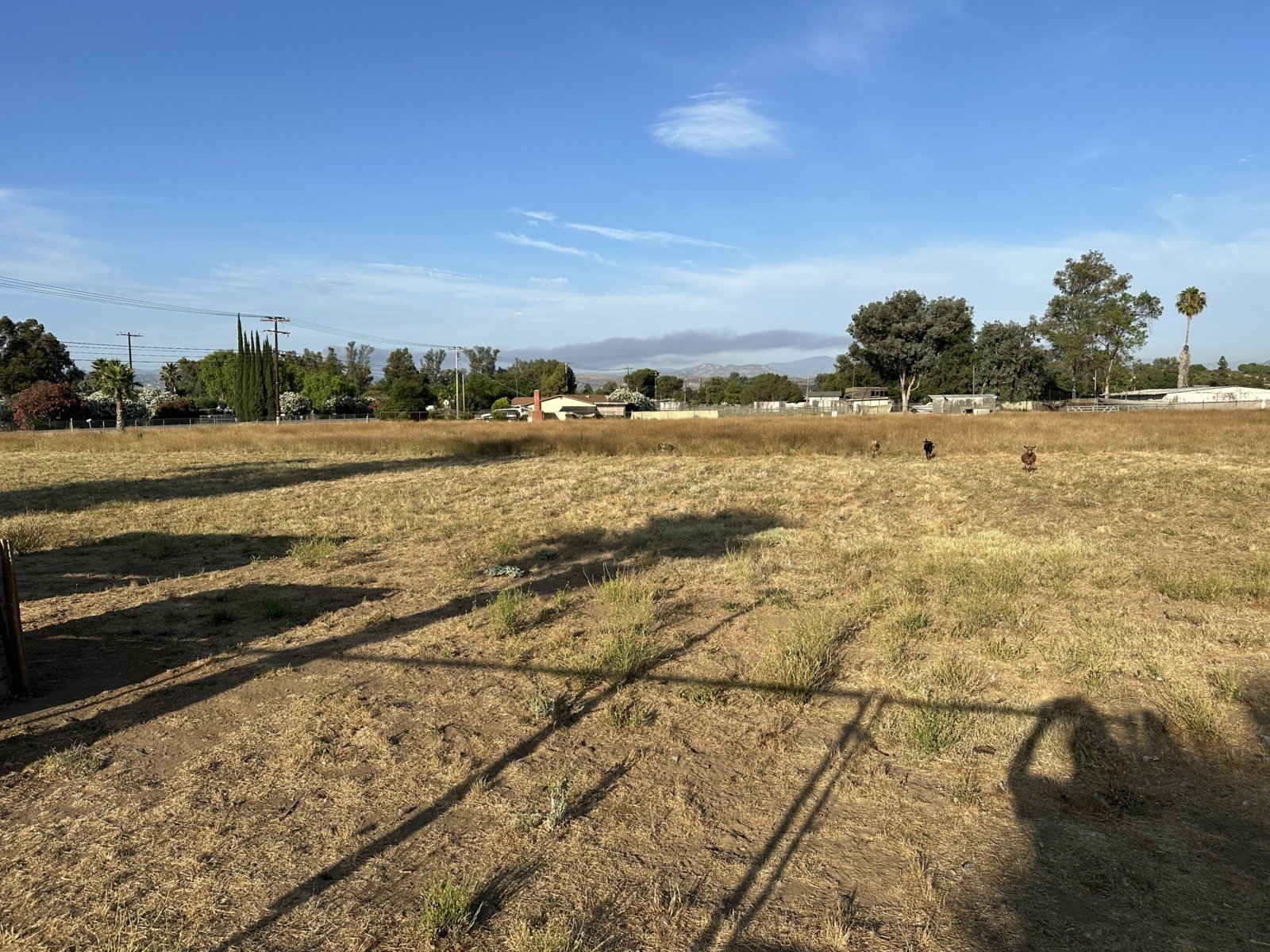

    Used the brush hog for the first time today. Worked awesome, but the tractor was running too hot. Got some new front wheels and 7-16 tires for it too.
    IMG_6420.jpg IMG_6419.jpg IMG_6413.jpg IMG_6424.jpgLower hose looks kinked right here

    Hose does look kinked, it also looks like a universal hose from an auto parts store. Have you tried washing the radiator from the outside? Mine runs warm when it gets a lot of debris and dirt on it.

    Make sure the radiator is clean, fix that kinked hose & above all else make sure you are running that tractor at high enough RPM! If you are lugging it or running it too slow? It will run hotter cause the water pump ain't turning fast enough & moving that water thru the radiator.
    Its a real common thing for guys to "putter" their tractors & then they over heat. Same thing with most equipment. Its designed for a certain RPM & flow.

    Yeah it’s not the OEM hose that’s for sure. Going to do a waterpump, thermostat and new hoses asap

    Thanks for the advice. Going to change the waterpump, t stat and hoses. The waterpump has play in it anyways. I was running about 1500 RPM
