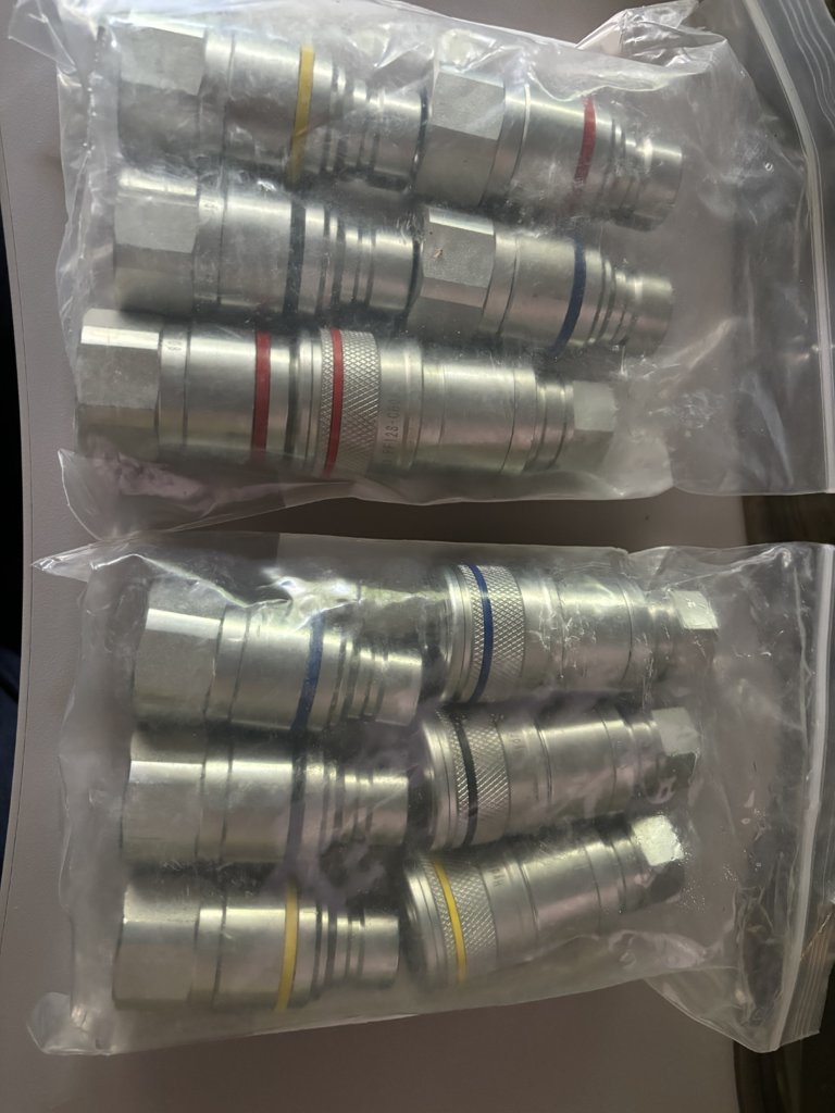

    I have a similar issue with the loader and the standard QC and sometimes with the BH if it sits for a few weeks. Either way, cleaner and I can toss the current plugs and caps which just dangle in the breeze.

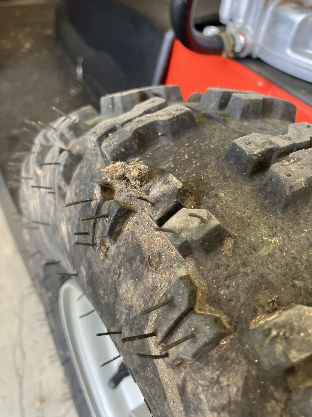

    Alright, any ideas how the hell to get a tire plug to not leak?
    Never in my entire life have I struggled like this. No matter what I do, the plug leaks in the same damn spot. :rofl:
    It like the tire isn’t strong enough to “grip” the plug. The plug is SUPER easy to push in. And every time same spot leaks.
    Don’t say, try another plug. There’s 3 down in the tire now. I tried 2 plugs. Nope. Went to put a 3rd in and the other 2 went down inside the tire.
    WTF?……..
    It’s a slow leak. Just annoying have to seat the tire to the rim when I use it once a month.

    That stuff makes a mess on the inside of the rim. But I’m about to say screw it, and pour some in.
    Hope I never have to replace the tire in the future.

    If you are using normal automotive size tire plugs you can get some big rig tire plugs cause they are slightly bigger and sometimes will work if the normal ones aren't quite big enough

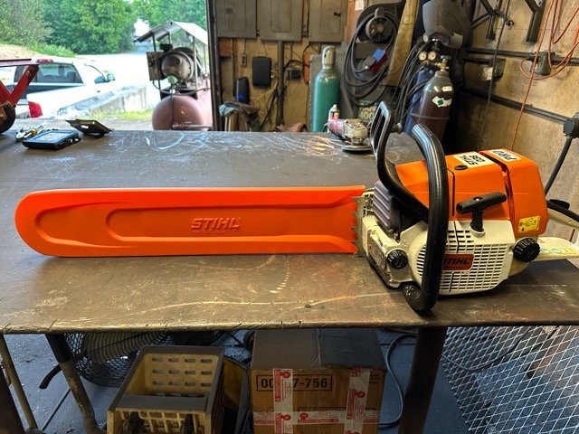

    I swung by the local Stihl dealer yesterday and got a cover to protect the chain, I was expecting a minimum of $25 since it's 25"…..it was $5.39 + tax.

    I like the looks of those longer bar saws.
    But 18 inches of hard maple, or oak will bog most any saw one man cares to lift.

    I'm just using this one to fell trees with, I'll use the other saws with 20" or 18" bars for the rest :thumbsup:
    Or maybe this one will get a 20" bar and I can use it more. I like options.

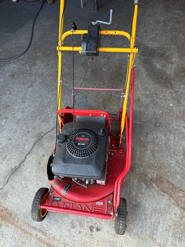

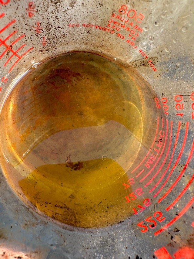

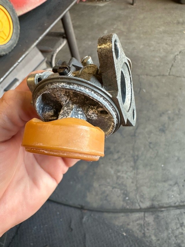

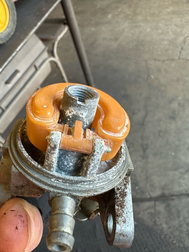

    Friend of mine ask me to look at this mower, he said it’ll fire on ether but won’t run.
    Carb shows signs of water in it, for a while.
    Drained some gas in a container and you can see the water separated from the gas. This is about 1/3rd of it.
    I wasn’t gonna fight with that carb, ordered a new one from Amazon for $18 and it runs like a champ now.
    Delta09, sdk1968, 308savage and 4 others like this.
