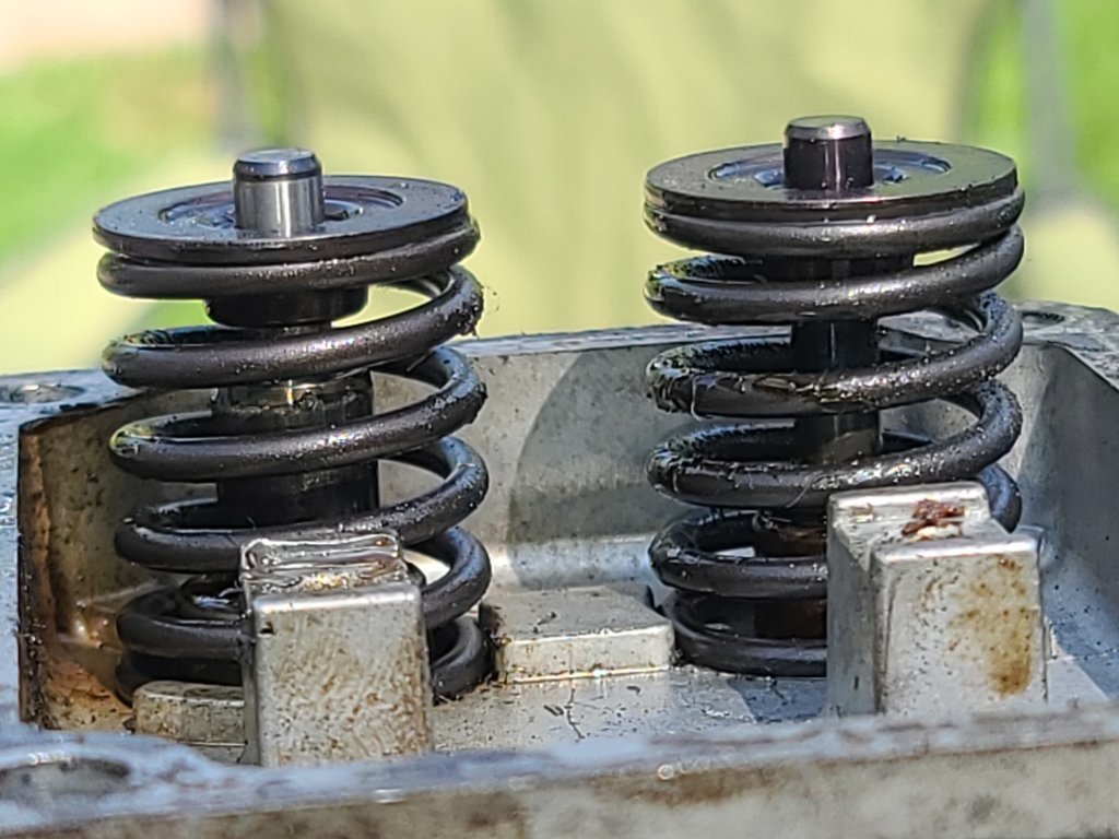

    The valve stem guide is not in its correct position.
    When they do that, the valve can not be pushed down by the rocket arm because the guide is higher than it's supposed to be... Results are a bent push rod...and sourcing a new head, of course .

    I'm confused
    Explain the shiny valve stem if the keepers were not letting the cap slide up and down over the valve stem/

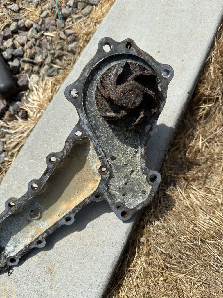

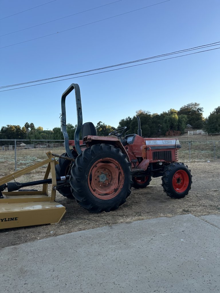

    Slowly making progress on the tractor. New water pump and all new hoses are in. Major corrosion inside the cooling system. Old pump was basically an anchor lol

    One is shiny, true. The other has carbon build up. That one is the exhaust valve keeper.
    The shiny one doesn't see much heat, since it is cooled by fresh intake air.
    The dark one sees a lot of heat from the heat of combustion.
    The valve stem keepers are exactly where they are supposed to live. The spring cap is kept in place by the keepers.
    The problem is the valve stem guide has moved up.
    Now there is not enough room for the spring to compress. The spring tries to compress, but there is not enough room. The next weakest link is to bend the push rod.
    The iron valve stem guides are pressed into the aluminum head.
    The iron valve stems need to slide up and down on the iron guides. On occasion, the iron guides don't expand as fast as the aluminum head, this allows the iron guides to push up out of the aluminum head.
    When this happens, the iron guides that are now higher than they are supposed to be causes the pushrods to bend because the spring can only compress partially.
    Remember, there is a cam shaft that moves the push rods up and down. It doesn't care about froze valves. It's a much bigger chunk of iron and the pushrods are nothing for it to bend.
    I hope this makes some sense.

    Briggs? Same thing that happened to my neighbors mower and it broke the push rod.

    Yes. This one bent the push rod, too.
    Got a complete head and pushrods on the way.

    I read the cooling fins get stopped up from oil, grass, dirt, etc. and it causes the aluminum to get hotter and swell faster allowing the valve guide to move.
    Exactly the problem with my neighbors mower, it was caked with stuff. I pressed the guide back in and sent it. She's been mowing with it all summer.
    I told her if it did it again I would put a new head on it.

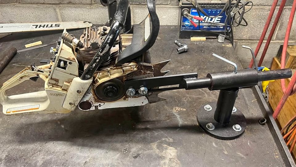

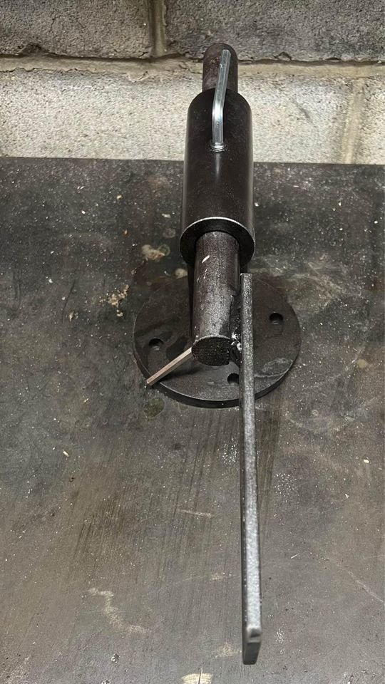

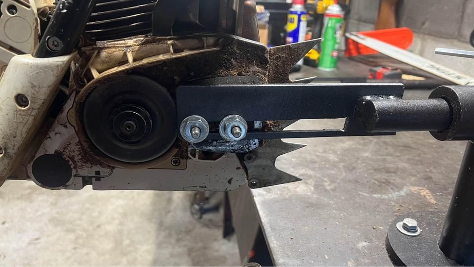

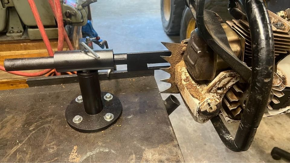

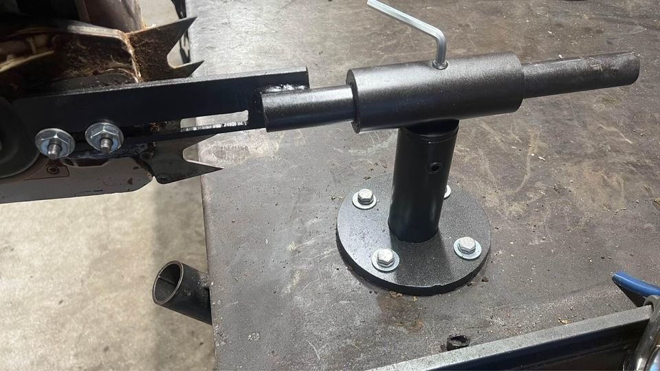

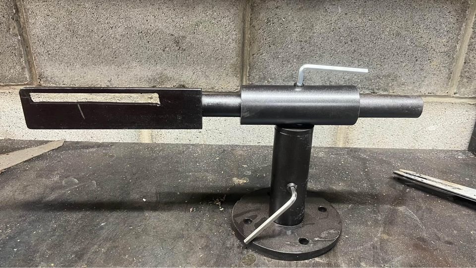

    Saw this online, neat idea if you work on saws a lot. Able to rotate it and keep it held.
  11. Aug 23, 2024 at 5:57 AM
    koditten
    koditten Well-Known Member
    Sep 8, 2013
    #112077
    19,957
    Kirk
    Central Michigan
    04 trd x-cab 4 x 4 3.4l
    Reserected from the dead.
    I'll try that with this one. Can't hurt to try.

    Out of curiosity, was yours caked with stuff on the cooling fins?
  13. Aug 23, 2024 at 6:06 AM
    koditten
    Sep 8, 2013
    #112077
    19,957
    Kirk
    Central Michigan
    Not a bit. It was extremely clean.
    The story I got. She mowed the yard previously with no issues. Started the mower up a week later and she knew right away it was running wrong and smoking.
    I'm trying to figure out why it would push that guide up on a cold start.
    I know this is a common issue when there is a cooling issue, but this mower was debris free.
    I'll probably never know.

    That is weird. Maybe just a defect with Briggs.

    I've knurled the bores of valve guides to salvage wear before reaming.
    It looks like this application needs knurling on the outside! ;-)

    In a pinch, you can remove that solenoid and snip off the shut off plunger. Be aware, if your gas tank is higher than the carb, raw gas will trickle past the float and make it's way into the combustion chamber and cause a hydro lock situation.
    I wish I was down there, I'd get it running for you.

    Can I get some details on this knurling procedure?
    I'm pretty much a remove and replace guy, but do have a thirst for knew knowledge.
