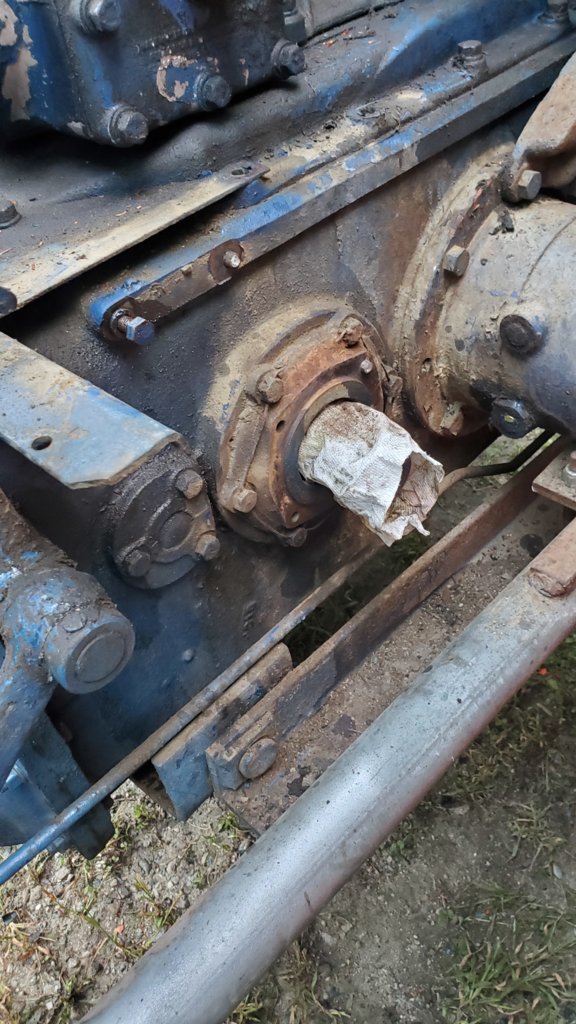

    Well those two broken bolts must have cost me $30 in oxy/acetylene. Had to heat 'em again and again, then weld a nut on for purchase. One was a fine thread, just happened to have a replacement in the bolt tray. It needed to be cross drilled through the head for safe-tye wire. The side wing had to come off for better clearance during assembly. I'm tired from scrambling around so much. Up and down, etc. Better than new now!

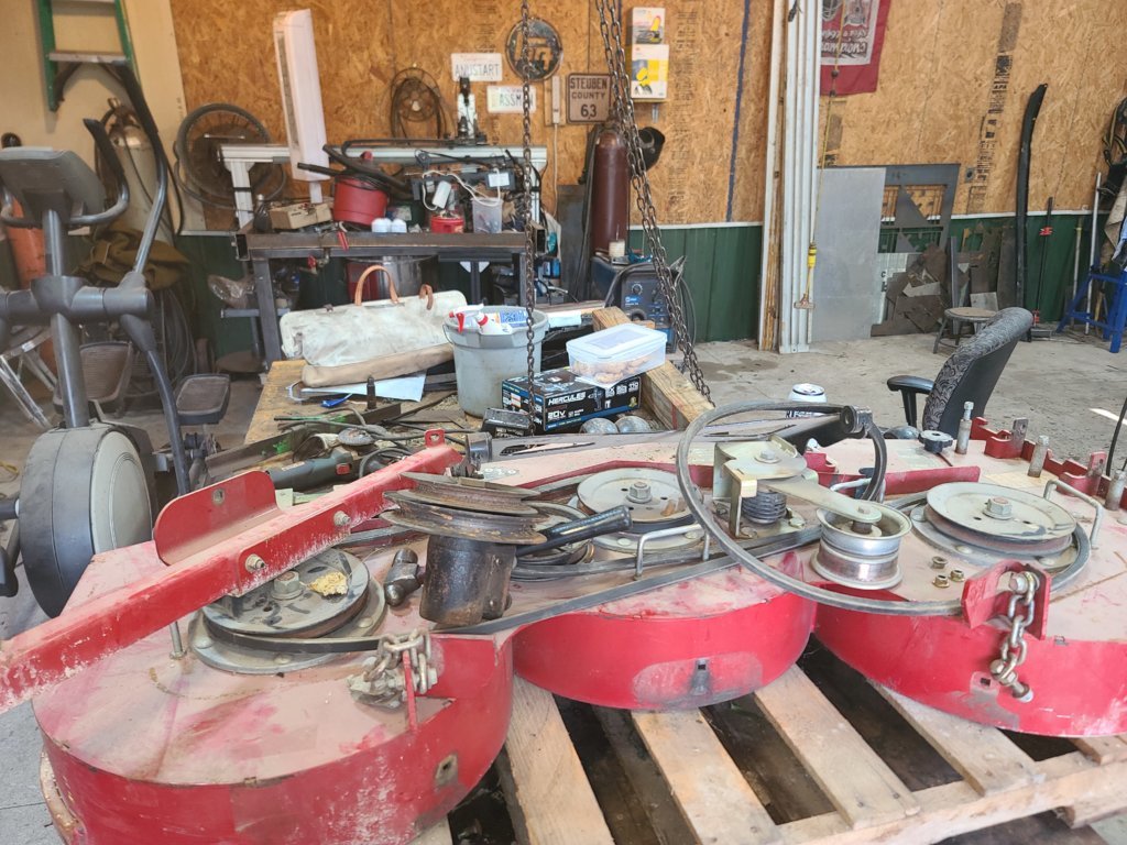

    Trying a new experiment.
    These decks for the 20 year old Toro zero turns rot out way sooner than they should.
    Gonna try grafting the deck support hardware to a newer Toro Grand Stand deck.
    I honestly don't know if it will work, but I'm gonna try anyways. Cuz the original decks are no longer available.
    This is the doner deck.

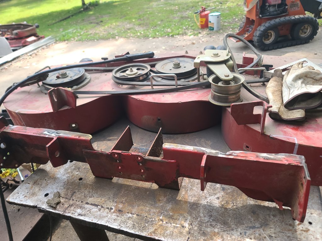

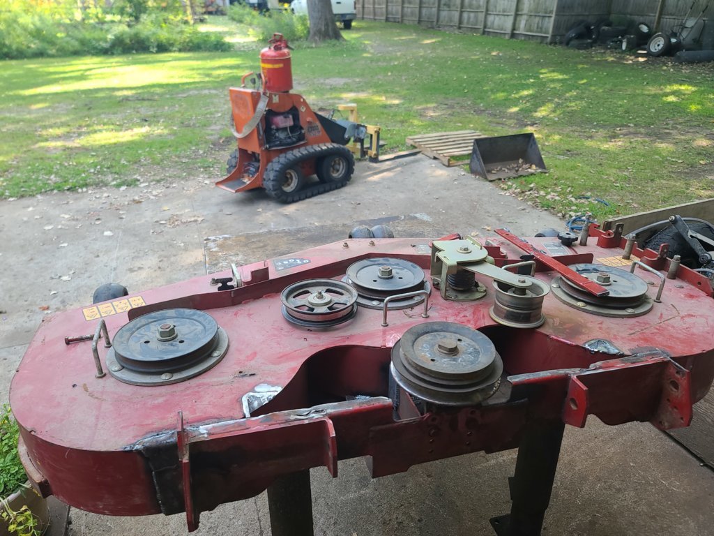

    I grafted the mounting hardware from an Exmark Triton deck. Both are 60" decks.
    Everything seems to be in the correct location.
    Still need to mount the " mule drive" correctly. Some of the bigger decks used a mule drive to run the deck. These used 2 belts. 1 belt from the engine pto turns the mule drive. The second belt from the mule drive turns the spindles.
    I actually like this system the best. They always seem to be a smoother start of the deck. I'm annoyed that the manufacturer recommends the engine be at maximum rpms to engage the deck.

    Just rub it in that you have a little dingo why don’t ya!

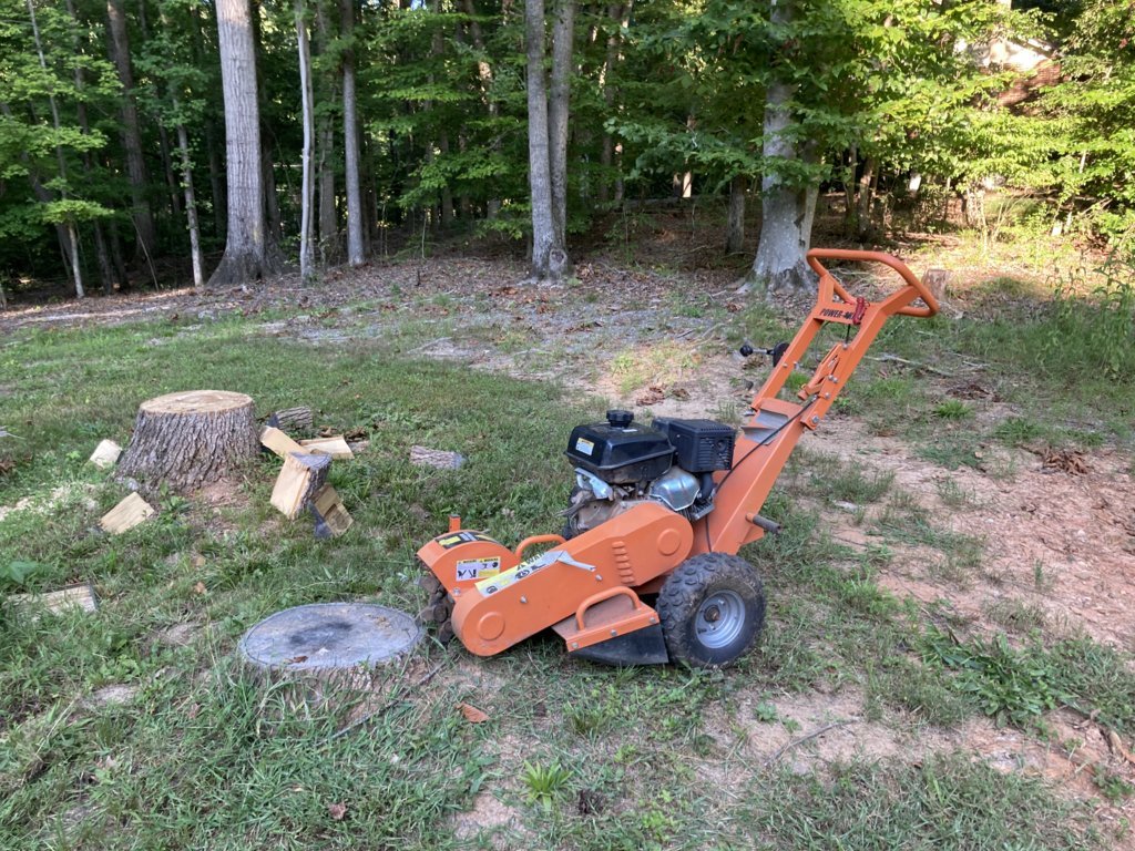

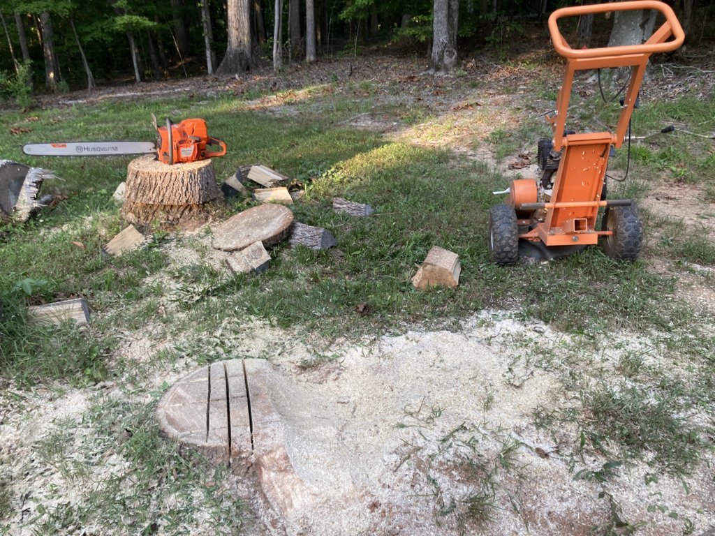

    Got the stump grinder out and went to town. There were a lot of little stumps that the push mower was hanging up on so I ground those down first. Then I attempted to go after this big poplar stump. After 10 minutes I gave up and now the plan is to burn it. Good news is I should be able to mow most of my yard with the riding mower now.
    Cant wait to get the dingo so I can go to town on leveling some land. Slowly but surely!
