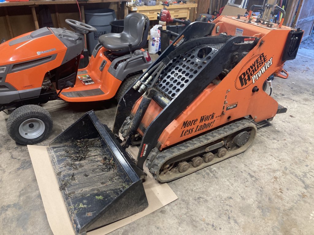

    I have went down the rabbit hole of attachments. What are some good ones to get? I am thinking pallet forks first. Then maybe a trailer hitch attachment and then maybe later on down the road a root grapple.

    The trailer ball is a must! I drilled a hole in the cutting edge of the bucket. I only hand tighten the ball because it's easy to remove with gloves. No tools are needed.
    Be aware, the cutting edge will most likely we AR plate. It just laughs at drill bits. It had no resistance to the plasma cutter.
    The forks are a second must.
    Everything else is fine to get when opportunity presents itself.
    The brush grapple is useful, but the ones above are a must!

    Forks are well worth it. I use mine way more than I thought I would. Especially if you get a pallet or two to load up Even better make a "box" to move around. Do that a lot moving stuff from the big garage around the property. Ive also got a 3 point hitch mount that doubles for carrying "suitcase" weights. Its nice for moving trailers around. My pallet forks do have a receiver hitch but its a pain in the ass if you dont remove the forks.

    Yeah, it was left outside. Going to drain the whole tank and see if I can clean it out some. Then do a full fluid change on the engine.
    Tucked away from the elements now.

    Its all about how you use your tractor.
    If its got a FEL?
    To me quick attach pallet forks on a plate are a must. Its my most used "front" item.
    After that? The non hydraulic brush grapple.
    Then my rubber/alum snow blade.
    Everything else I do with the tractor is on the back.
    Trailer hitch, stump grinder, brush hog, plow, roller, counterweight...

    See photo above your post, it's not a tractor :thumbsup:

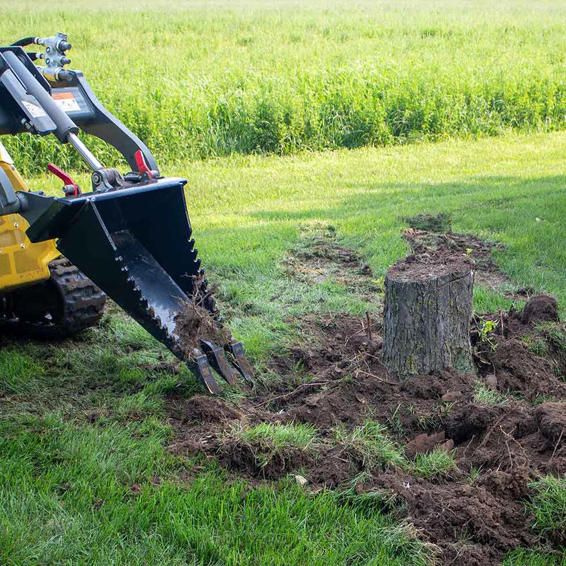

    A root bucket looks really useful for all of the stumps I have. Not sure how well it will work on 16” stumps though.
