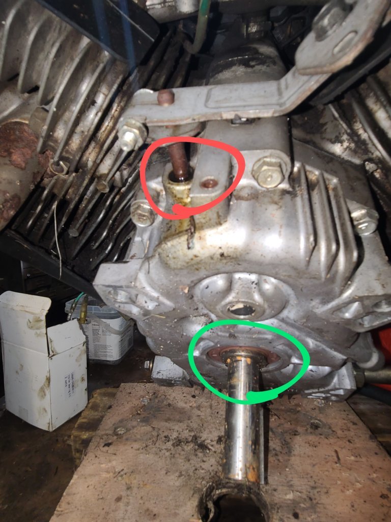

    Pressure washed the shit out of the 24 HP Kawasaki. No pun intended.
    Loosely assembled the housings and filled with 2.5 qts. If used oil.
    Factory oil capacity is 2.2 qts with oil filter, but that's not either here or now.
    Let the engine sit on the bench for 4 hours. I did not bench run it, but was prepared to do a test run if no leakage was detected.
    Prognosis: 20240913_194806~2.jpg the governor shaft seal is FUBAR.
    The main crank seal shows no sign of leakage.
    The 1st pic is of the oil slick on the workbench.
    The last pic is of the oil leaking from the shaft seal down the secondary crank case.
    The circled in green is showing no oil leaking from the crank main seal.
