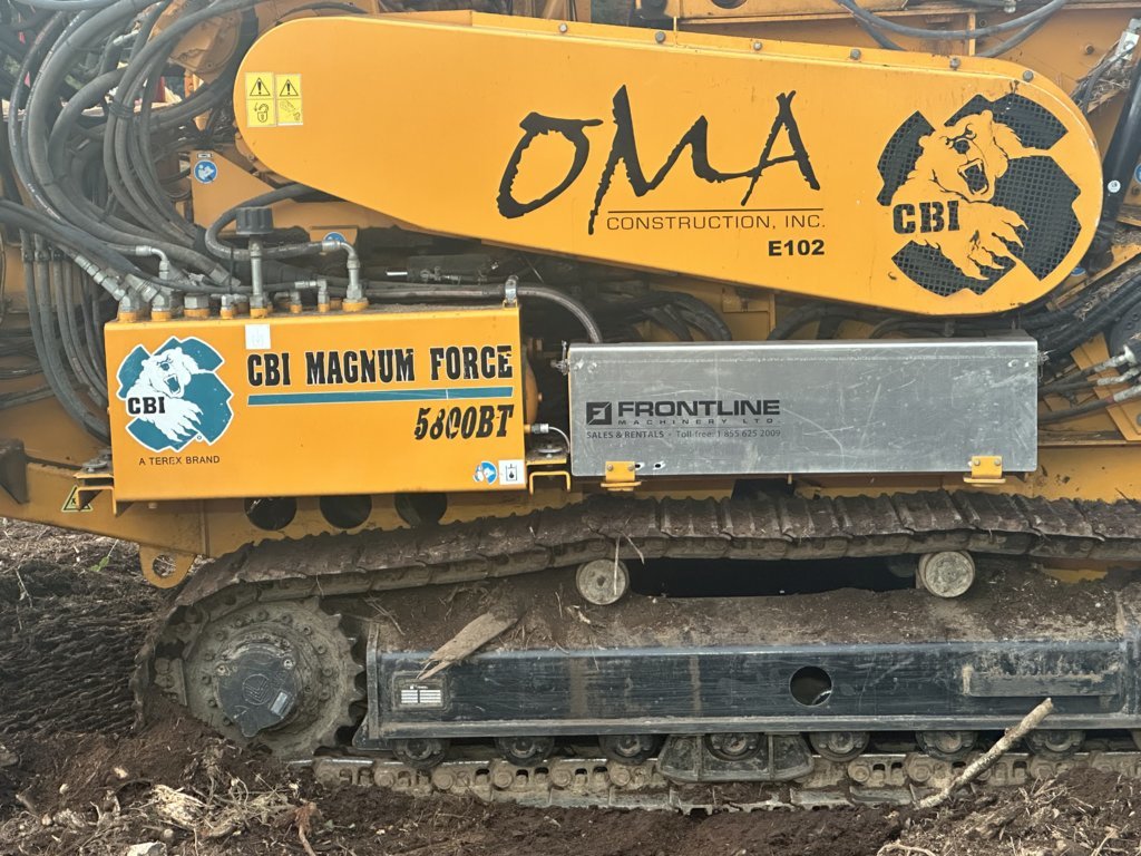

    Sat my fat rear end in it.
    All right, took a while to get in contact with the seller. It’s a 2015 BC2600HM, Honda 388cc engine. I haven’t been able to find a hp rating for it.

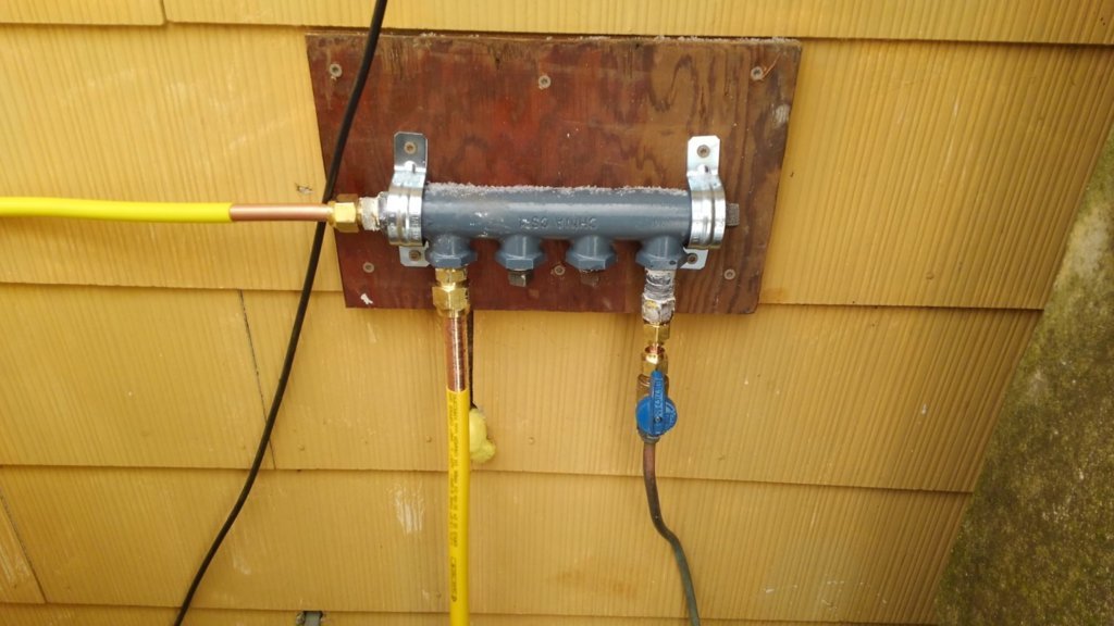

    You can get a black iron manifold on AMZ like this:
    The left comes from the tank (regulator) the center is to the furnace and the right feeds the range. 3 ports available for future devices.

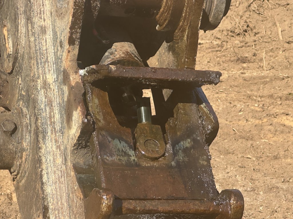

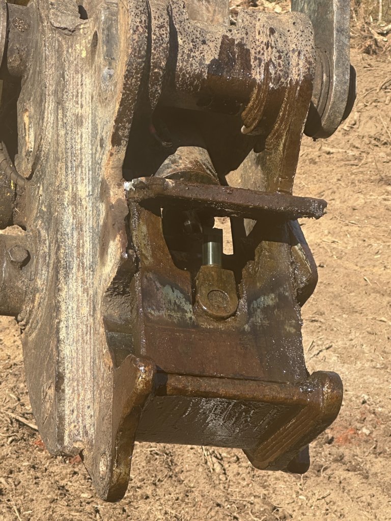

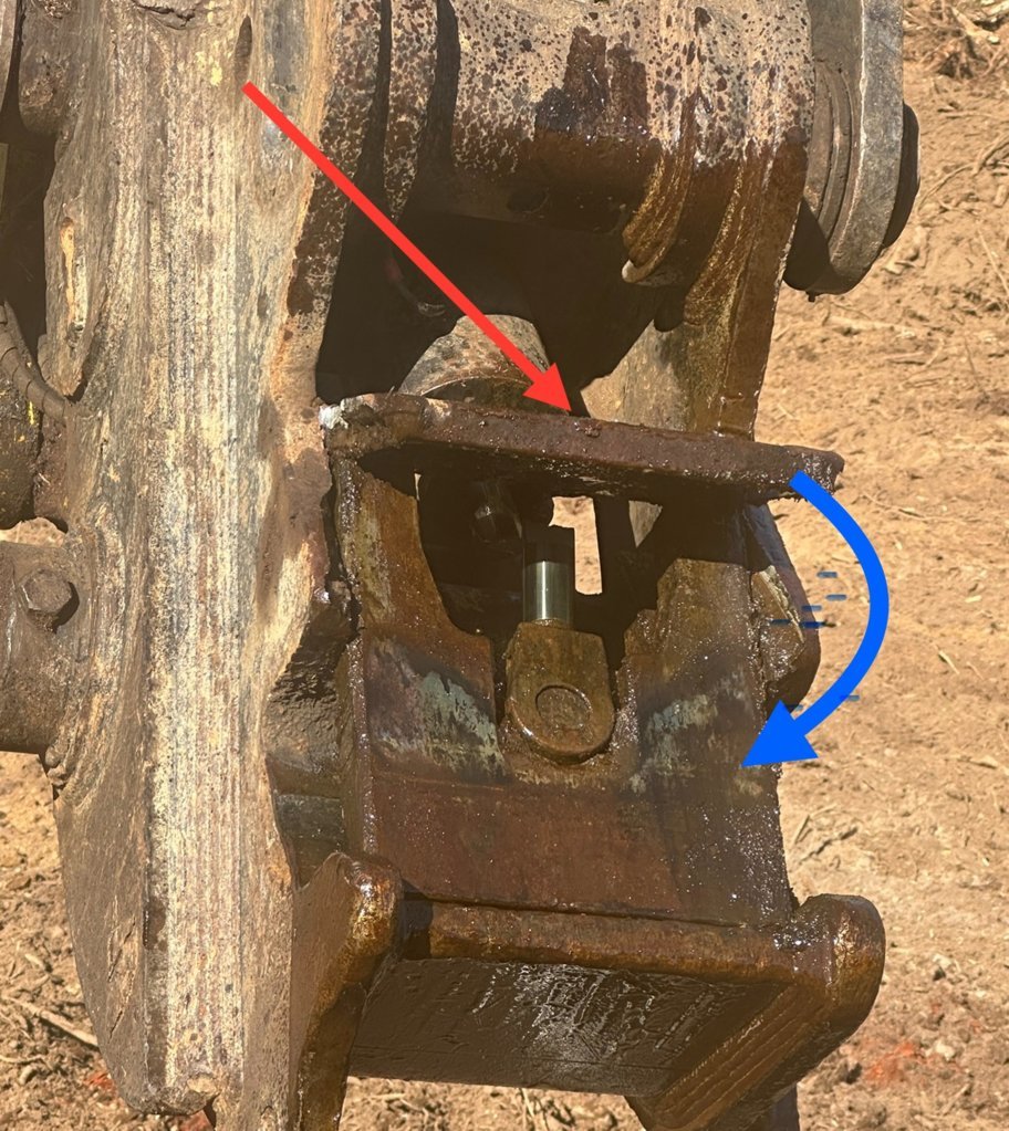

    upload_2024-10-11_5-45-14.jpgupload_2024-10-11_5-45-32.jpgupload_2024-10-11_5-47-50.jpgupload_2024-10-11_5-48-10.jpgBusted the QD on the 490

    must have been really going at it to break parts like that.
  13. Oct 11, 2024 at 6:35 AM
    sdk1968
    sdk1968 Well-Known Member
    Apr 15, 2023
    #422563
    300
    03 Taco TRD
    Your power to size ratio must be real good!
    Quick changers are usually built strong.

    In my defense the he backing plate was cracked when I started it up that morning. Mentioned it to the boss and he said they beat the hell outta it at the quarry so run it till it breaks and we’ll fix it and re weld the plate.
    The plate in question red arrow needs to be brought back down to the face (blue arrow) and re welded. The movement of this plate is what caused the ram to fail.
    upload_2024-10-11_6-49-22.jpgWhen you get into the realm of 400 and up size excavators, things can get sideways regularly

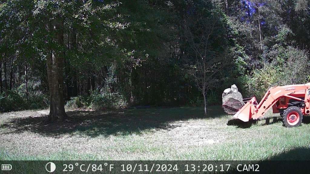

    One of my Trail Cams caught me with some big chunks of an almost 5ft diameter red oak that I had to get cut down last fall because it was half dead. The tree was between my driveway and stable, and if it came down on its own it could have landed on either. I was moving these large pieces (that were not suitable for splitting) about 40ft into the woods.....

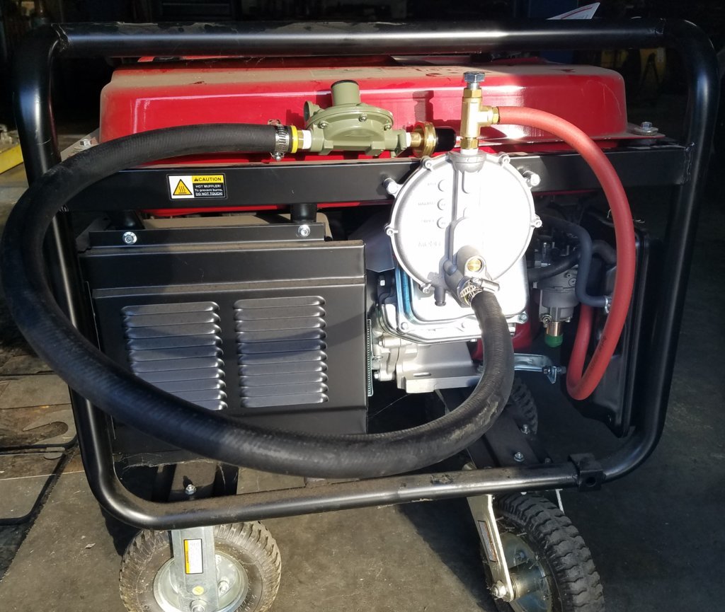

    Thought I'd follow up since I hadn't started the generator last post.
    Hooked up a battery and propane tank this morning. Followed the instructions which say to open the fuel adjusting block wide open, purge regulator by pressing purge spring, start generator. It eventually started but was flooding badly. If you ever hook one up, I'd say the instructions should be close the fuel adjust block, press the purge valve to purge to the main regulator (and again you begin opening supply), start cranking, and gradually open the valve until it runs. Using this method and once adjusted to idle needs, the generator ran really smoothly.
    The bolt shown below is the fuel block to adjust flow volume and instructions say it will need to be adjusted again when full power load is applied.
    Since cold weather outage is my main concern, I think my strategy will be to adjust when the lights, refrigerator, TV,... AND furnace are running, then just make sure not to cause the water well pump to kick on when the furnace is running. Since both are intermittent loads, seems it would be wasteful for the fuel supply to be adjusted to supply both all the time. Frig is also gonna be on/off load.
    Lastly, the total cost of the parts excluding the adapter plate would probably be around $80-100. Amazon price $200. The adapter plate however is not "off the shelf". It was 3D printed with a hose fitting screwed into it.
    The adapter plate is something I (or @koditten) could draw up and cut out on our CNC tables, drill, and tap it in an hour or so. But if you add to that hour the time to accumulate all the other parts, spending that other $100 to me seems easier to swallow.
    For now, I'm going propane but I hope to get ambitious and plumb a natural gas hookup to the generator place....TBD.

    Why does that setup appear to have two regulators on the propane line?

    You're right, it does. For propane, I could remove the bigger natural gas regulator or bypass it. It doesn't hurt anything to flow through it. That's actually how the instruction shows setting it up.
    If I decide to go natural gas, I just remove the black hose and the smaller propane regulator and run feed line in there. Basically, just storing the natural gas regulator there.

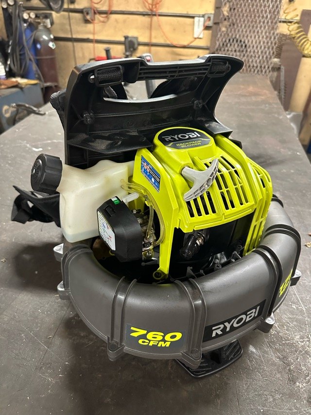

    Stumped on this one.
    Friend brought this by, it was locked up. Got it free pretty easy, drained the gas, added fresh gas. New spark plug, nice spark.
    Can not get it to fire, won’t even attempt to fire with ether.
    Put some wd40 in the cylinder and let it sit to maybe free the piston ring, if it was stuck.
    An engine needs 3 things to run, fire, fuel, and air. This one is getting all 3.
    I’ve pulled it 100+ times over 3 days and I have yet to hear it attempt to fire.
    I’ve tried half throttle, full throttle, no throttle, no choke, half choke, full choke.
    Heated the spark plug with a torch, no help.
    What is wrong with this piece of junk?
